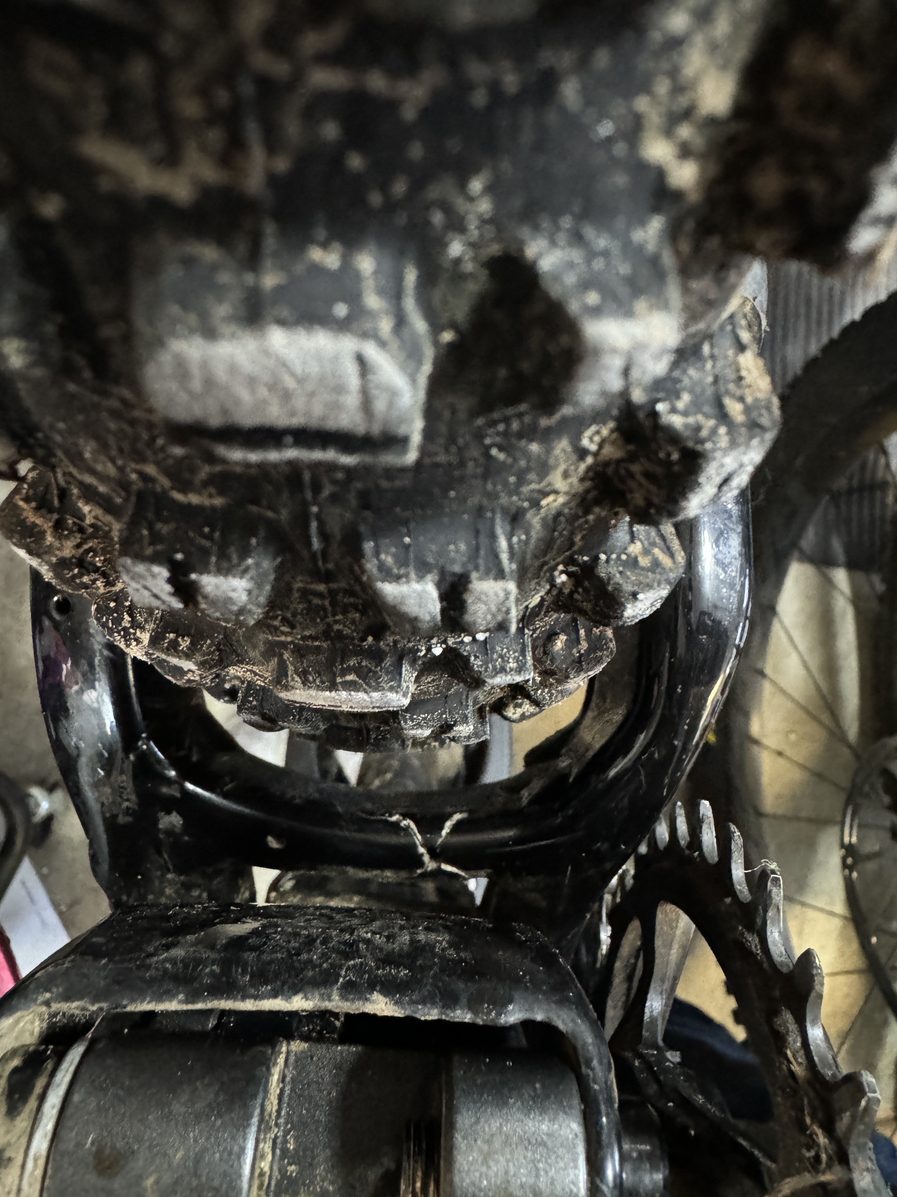

Day after I started this thread… I check my Rise for an ongoing creak, and turns out that I have a major crack in the lower chainstay….. that will teach me to post something like this:(
Hopefully the warranty process is pretty quick.
Pics!
