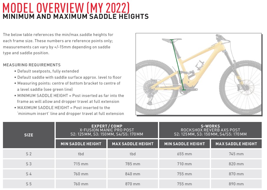

Careful with that advice. Being tall you possibly won't realise that slamming the saddle all the way down on many Small/Med FS frames can cause the rear tyre to hit the saddle just before the rear suspension compresses fully. So always check that first by compressing the rear suspension fully and noting where the rear tyre sits bottomed out in relation to saddle position. to do so remove the coil or air from the shock and compress the suspension fully. This takes a fair bit of force on a coil shock as you also need to compress the rubber bottom out bumper fully. Do this waaaay before buying anything.
Good advice that most will never bother with as my manual lists minimum saddle heights which are easier to measure (YMMV depending on how far forward your saddle is on the rails which affects reach). I would surmise that this measurement is the lower limit of how far the seat post can be put into the seat tube. Unfortunately for me on a medium Kenevo SL, I find this height puts the saddle too high for the kind of riding I do when its in its lowest position. As for seat buzz, going commando is NOT a good idea but going mullet is (once again, YMMV).

that's just based on the suppplied seatpost though.
another brands dropper such as a One-up with shorter overall length will be able to be inserted deeper into the frame offering a lower min saddle height. possibly even increasing dropper travel while still not being overly high at full extension for a shorter rider

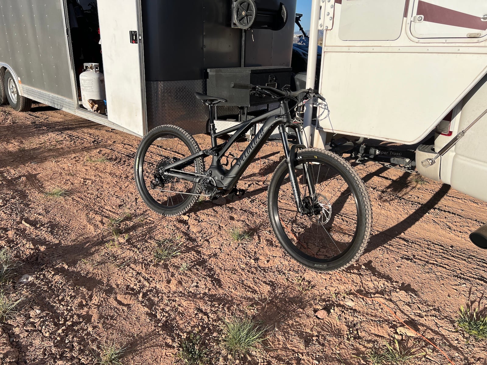

RobG
Apr 27, 2022
62
60
Fulltime RV
I went by the bike shop the other day, as I was passing through the area on the way north. They were able to adjust the seatpost better than I was, and got it down a bit lower. Now it's a perfect fit. No cutting, no welding, no duct tape or bailing wire required. Woo!
