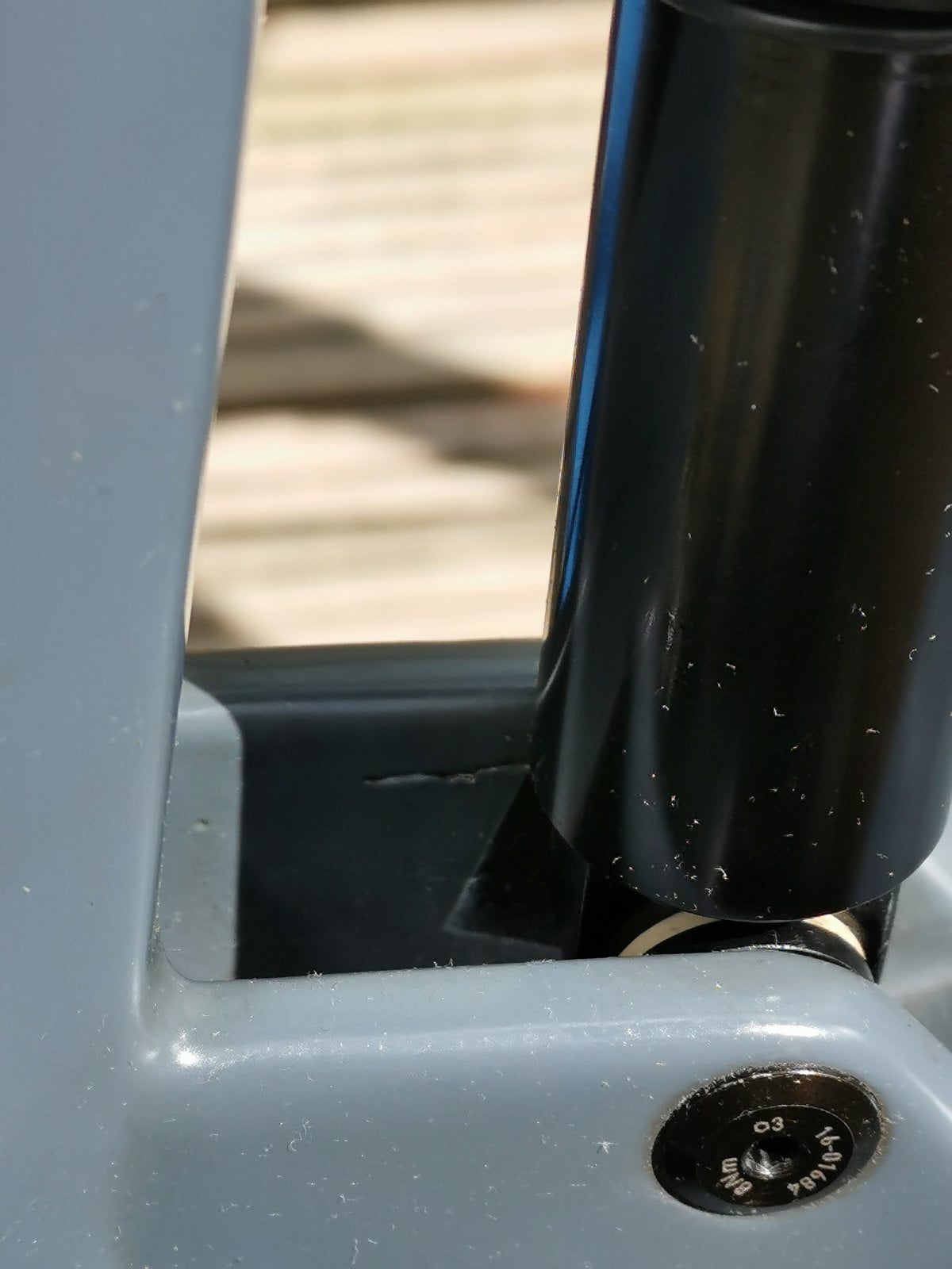

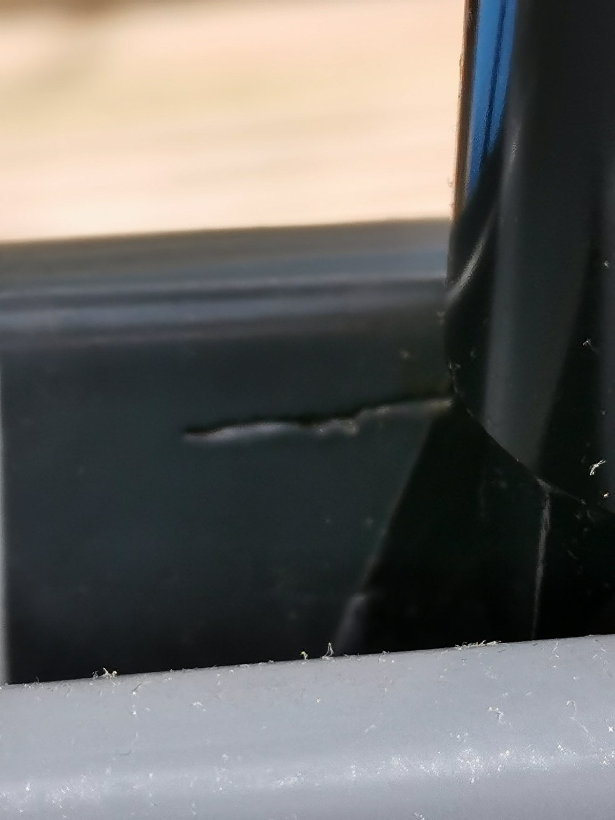

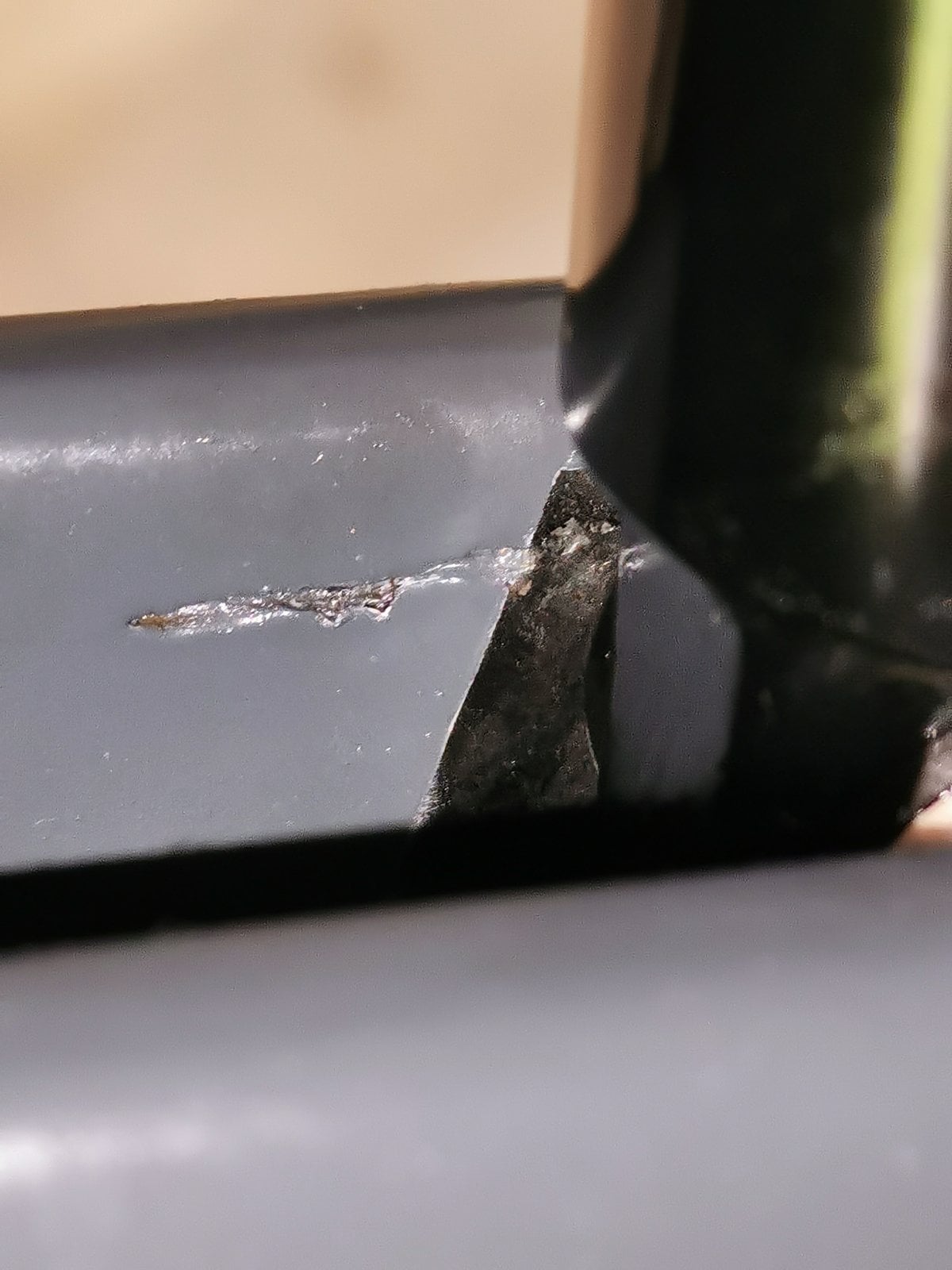

Just noticed this when I was cleaning my cube wot to you guys think
8,936
9,281
How the hell did it get scratched in there? :unsure: That must be one of the best protected locations on your bike, excepting the insides of the tubes.
Unless you have a convincing explanation of how it could have received that scratch in that location, then I would be forced to conclude that it was a crack. :cry:
I would take it back to the to LBS. If you bought on-line, then a photo and an email should capture their attention.
PS: What are all those little hairy white bits all over the frame (last two pics)? Are they broken fibres from your CF frame?

I’m no expert but looks like a deep scratch and not a crack from the photo so hopefully not a structural problem. I’d keep an eye on it to see if any cracks develop however.

I'd be tempted to say it's a manufacturing defect which has always been there (though perhaps previously filled with paint), not sure what that means for your next move though.

Ya I was thinking scratch I reckon a stone got in there and the movement of the suspension crushed it against the frame on the first photo the metal plate has got a Mark on it as well

I was cleaning it with wd40 and a paper towel
This. Or a stick ended up jammed in there from the rear wheel, I've had that before, but assume MsO would've remembered removing it?

Mind you I've just been bouncing up and down on it that part of the shock doesn't move could be done when it was put together from factory maybe when they were putting in those metal plates for the shock to get attached too
8,936
9,281
Crack or scratch, what do you have to lose by talking to the shop?
Tell them you believe it to be a crack and wait for them to convince you it's a scratch. Until they do, you won't be happy. And if it is a crack and they tell you it's a scratch, and it all goes bad later on, then your claim has been registered.

It's a scratch I'll have to send it back to tredz will be a month till I see it again so gonna wait till after Xmas when things die down a bit then I'll send it back

I put a market next to it to see if it gets bigger been out twice now and no change

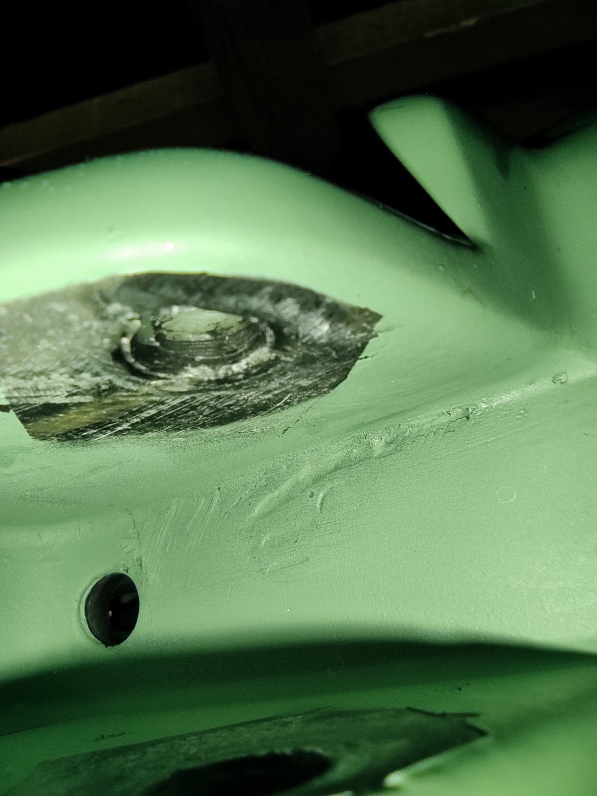

that is no scratch. Its a lay up defect that has been crudely filled and the filler has sunk.

The Green photo. That lug is bonded onto the other part of the frame and then epoxy filler used to provide a cosmetic finish. In this case very badly.

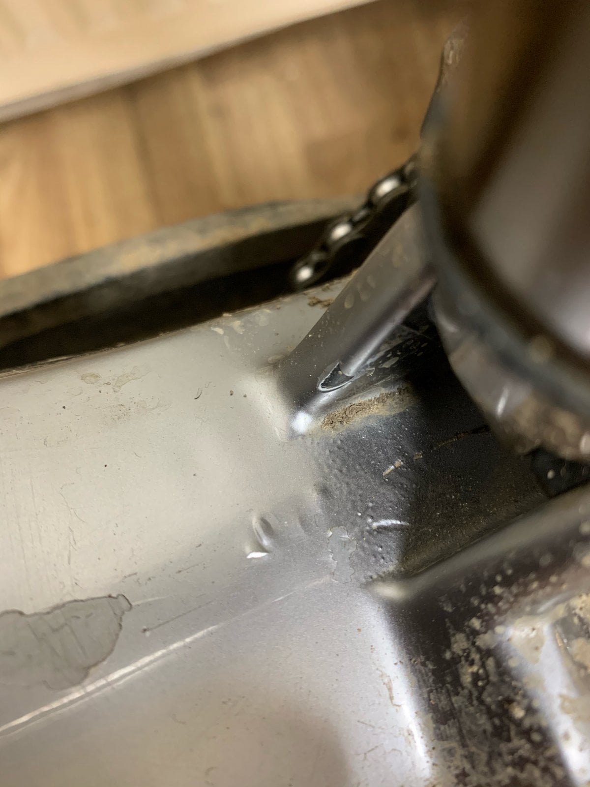

The grey one looks more like a scrape which must have been done during the original handling of the frame in the factory or possibly during the bike build because I cannot see how else it could occur during use.

Just sent mine back with same problem , paint started bubbling, done 1300 miles @ mainly bike park & ride it pretty hard
Other than this had no problems
