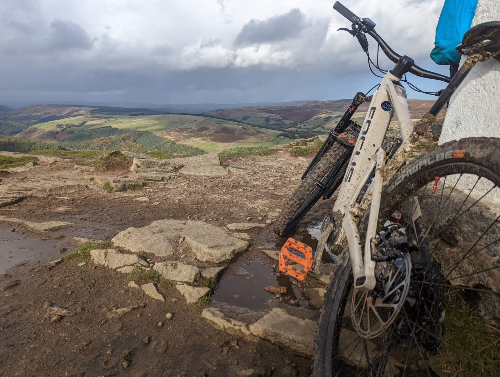

I live and ride in the Peak District in the UK, where it is very rocky. Lots and lots of loose rocks getting kicked up by the front and wheel and smashing in to the battery (I'm on my 3rd cover because of this), down tube and motor. I bought an AVS bash guard...
