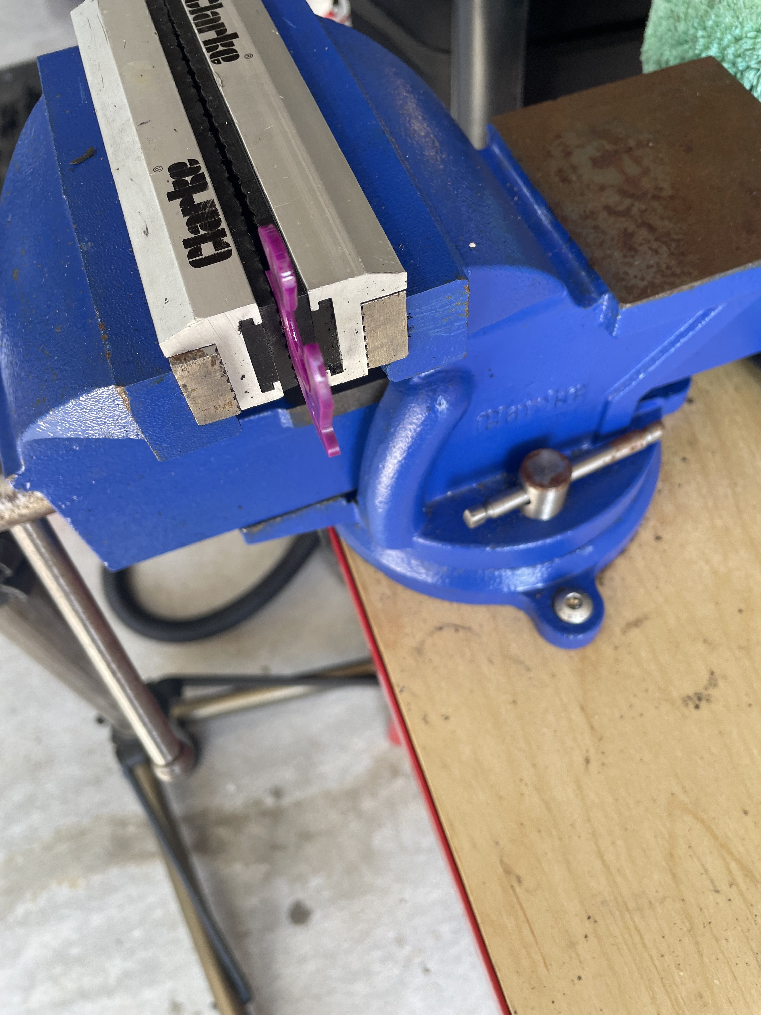

Installation kit which SRAM customer support suggest is wrong. Inside diameter of the original bush is 6mm and in istallation kit diameter is 8mm. I had to use bush from old shock.
You have also remove lower bush from lower side of shock. That can be done with piece of pipe, socket with outside diameter 14,5mm and vise.
