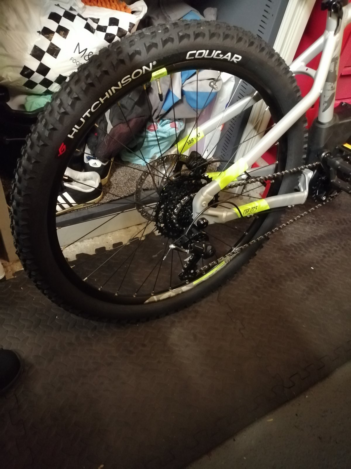

All in all I'm very pleased with the tyre choice and going from 2.8 to 2.4 seems to be better on this bike.
I think this is much the same on any bike. 2.8+ was the "big" thing .. There are probably lots of circumstances when they're fantastic.
It also has to be said, when you see a bike in the shop with 2.8's - as a man, for some reason it says "buy me" .. :)
You see them less and less now on higher end bikes. I think I have a load in a garage I should try to give away quickly whilst someone might still want them :)

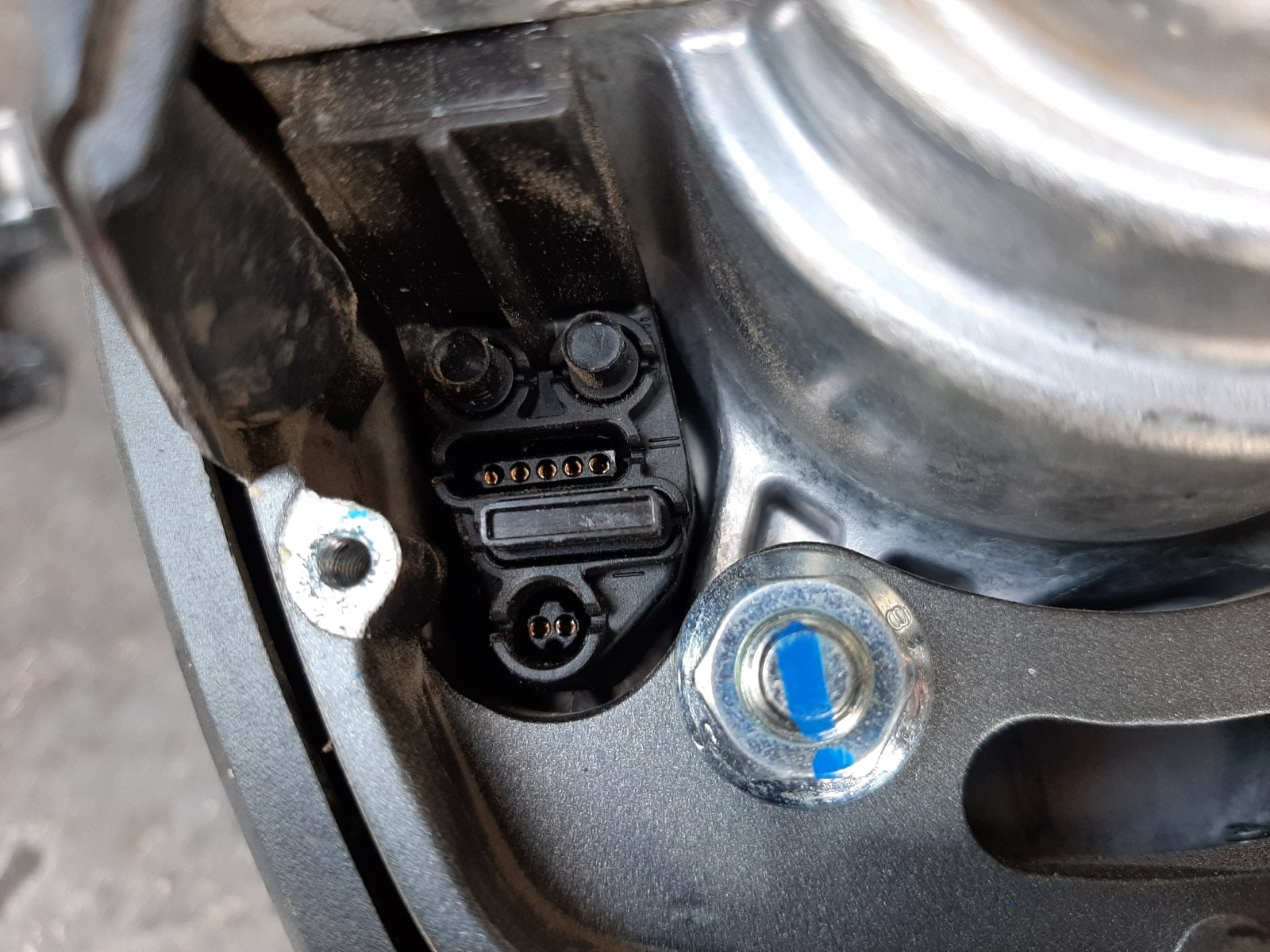

Here you see the connections of the Brose-T engine.
2-pin wheel sensor below.
5-pin for HMI somewhat higher.
Anybody knows what the other connections are for ?
It think, the 2 above are 6V for front- and back light, but there seems to be another 5-pin (?) below.
does it help? https://www.decathlon.co.uk/p/brose-c85440-101-front-bike-light-cable/_/R-p-200096
https://www.decathlon.co.uk/p/brose-c86130-100-rear-bike-light-cable/_/R-p-200097 see the diagram illustrated
from dedicated decathlon page https://www.decathlon.co.uk/p-a/e-st-900-electric-mountain-bike-grey-275/_/N-0?mc=8487240

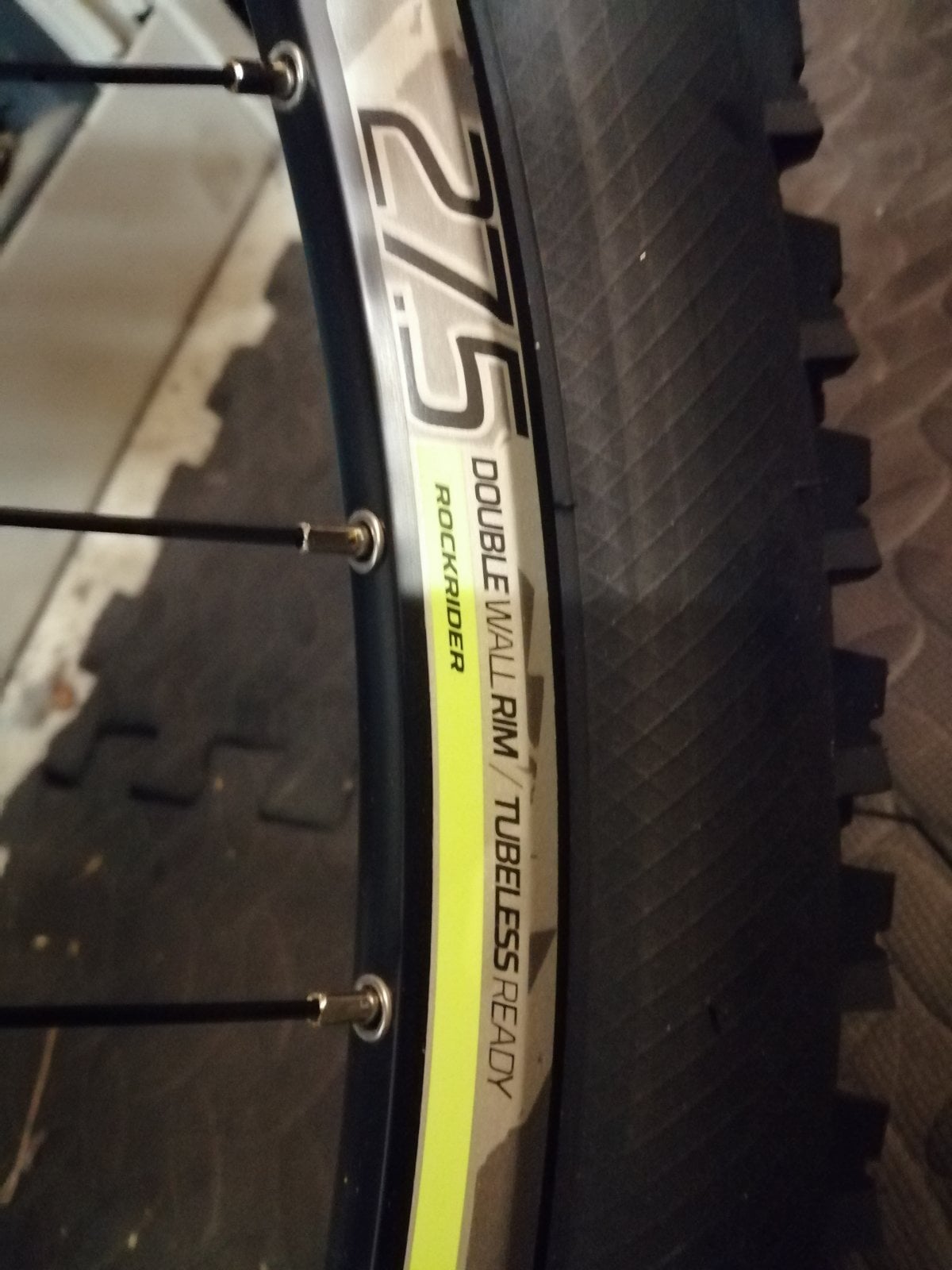

Has anyone ever thought of using the wheels of the e-st520 to fit thinner tires. Indeed, they are 23c and therefore they allow widths (ERTRO) between 37 and 62 compared to the original ones (60-75)

I think this could work. I have a 520 here and the rims are noticeably thinner.
Back wheel is fitted with 9 gears on the 520.

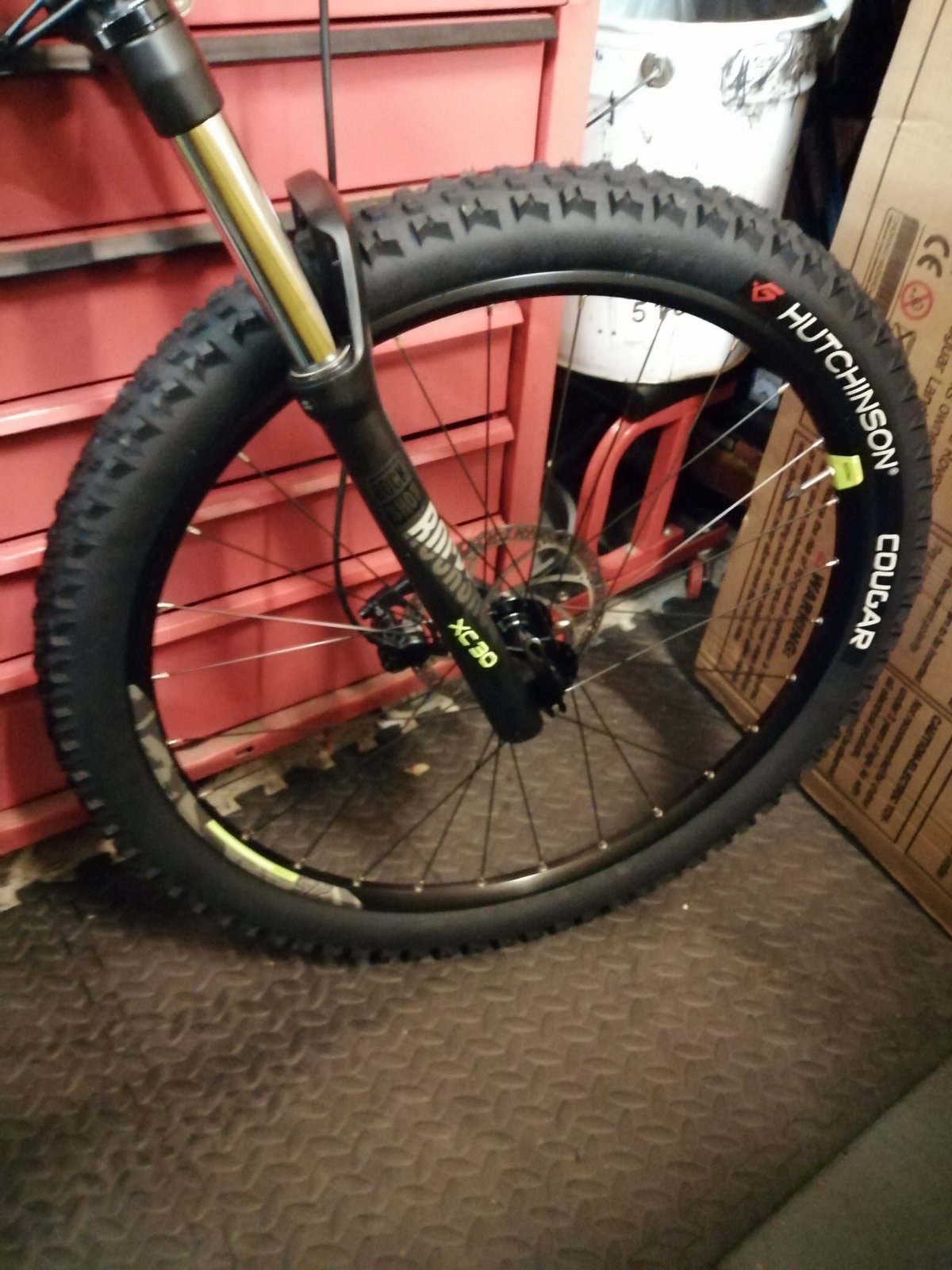

Front wheel has a quick release fitted, but the bottom of the forks (Rockshox XC30) has lugs at the bottom, where as the Rockshox Judy fitted on the 900 has a through bolt/maxle.
However, that said, I took my bike over some heavy stones and through low river beds yesterday and the 2.40 tyres were fine on the original 900 rims. Totally understand what your saying if you want to go smaller again, but this 2.40 combination seems to match ok and definitely performed well for my riding standards. Note: this is not very high... :)

Thanks. I hadn't noticed that the front wheel was not boost type. Too bad for a spare wheelset with different tyre profile

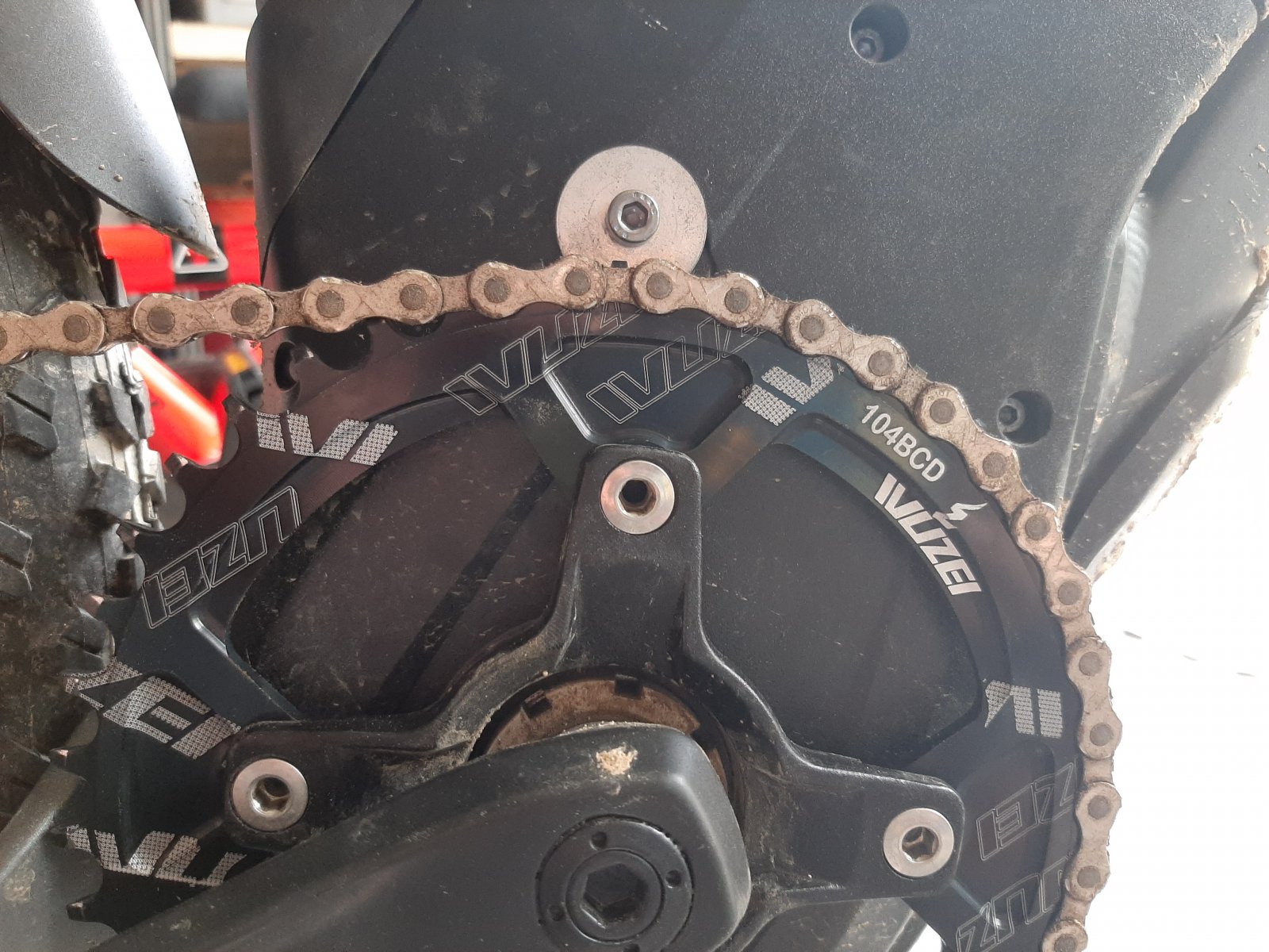

The Rockrider e-st 900 has a 34t chainring and a 11-42t cassette.
This 34t is much too short.
(Official: I drive sometimes very long asphalt downhill where electrical assistance isn't needed but where I drive faster than 27 km/h)

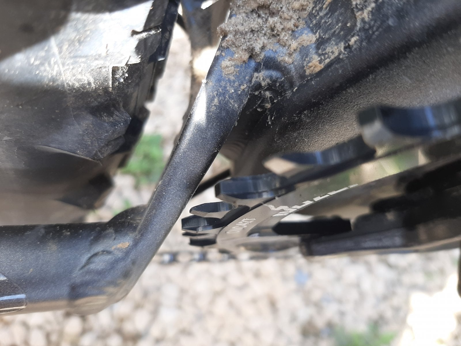

I measured around somewhat. The original 34t chainring has long teeth, so the new longer will have that too.
It seemed a 42t could fit.
The 34t came off without dismanteling something else.
It needs some positioning and some minor force, but it works.
The 42t is a cheapo Aliexpress thing. I prefered to spend 6eur instead of 50eur for this compatibility test.
You see the result: 1mm clearance.
The plastic chain guide doesn't fit anymore. I will have to 3D-print a similar one.
The 114link chain is too short now. I will not use the biggest ring of the cassette till the new E10 - X10E 136link chain arrives.

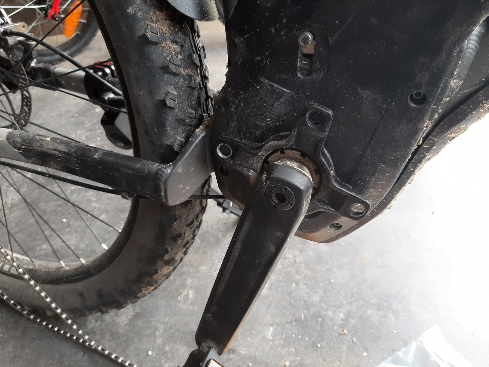

Hi,
I tried to disassemble the original chainring but I finally gave up. When you say "minor force" you mean it can bend a bit ? I felt like I was going to twist it. I understand what you mean about positioning. it's annoying because the one from aliexpress seems so much easier to assemble/disassemble.
I know what you mean, but unfortunately the positioning is impossible to explain with only a keyboard.
It felt like bending, but without being bent permanently when it came off...
In the worst case, you can cut, saw or disc the chainring away, you won't want it anymore.
The bigger one goes on without effort, like you already saw.

I couldn’t do it with ‘minor force’ either! So I bought a SuperB TB1069 lock ring tool to do the job properly. :)
I couldn't get the chain ring off and didn't have the tool to pull the crank arm off. I had it changed by a local repair shop near where I work for £5, which was cheaper than buying a puller.
I didn't consider that the new chain ring would slip on easier though. If I did, I think I would have run my disc cutter through the old one.
The 38t chain ring is much better when fitted. We did a 13 mile ride yesterday and at no point did it negatively affect me on steep hills. I have a 200m, very steep hill at the start of our ride that I can still pull in 3rd gear, which I also did on the 34t chain ring.
Speed on a long flat road used to max out about 22mph, now I'd say its about 27/28mph.
