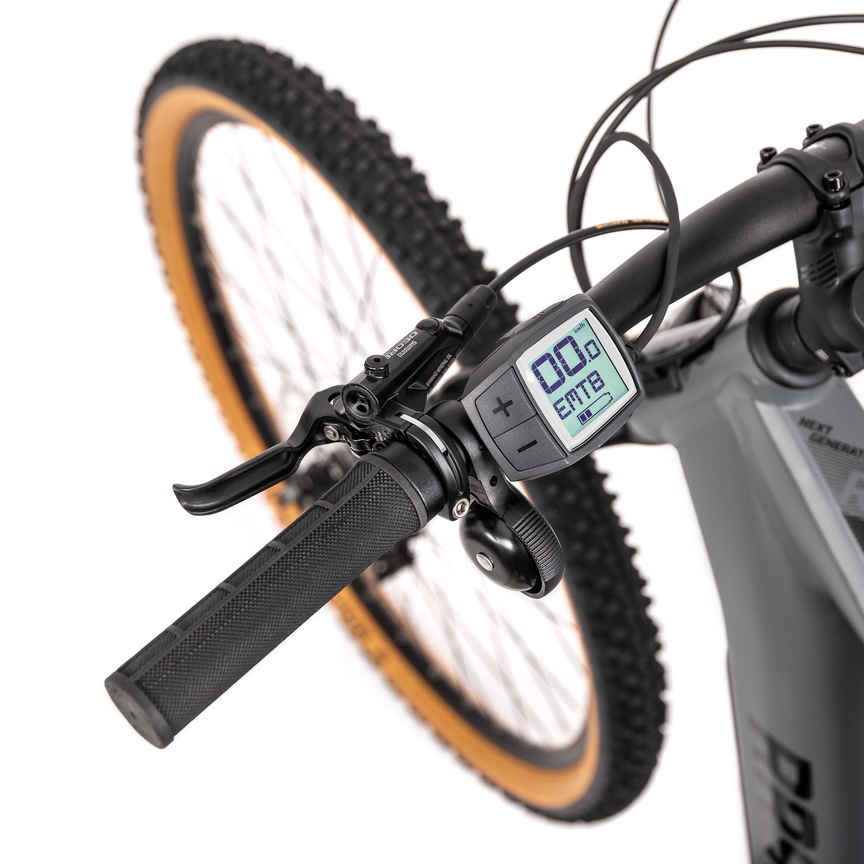

I am looking if our levers our compatible with both 2- and 4-piston calipers.
This youtuber talks about his new XT 8100, and at 1:04 he shows the box that indicates the XT levers are compatible with the corresponding XT 8100 2-piston and XT8120 4-piston calipers.
And at 2:42 he shows that Deore 6100 levers are compatible with the corresponding Deore 6100 2-piston and Deore 6120 4-piston calipers
Could our "Rockrider Tektro TKD32" levers fit the Deore 6120 4-piston calipers ?
Hi, I'm pretty sure there will be a compatibility issue with brake hoses. This happens even between some brake set into shimano brand itself. And yes, 6100 brake levers are compatible with x120 calipers

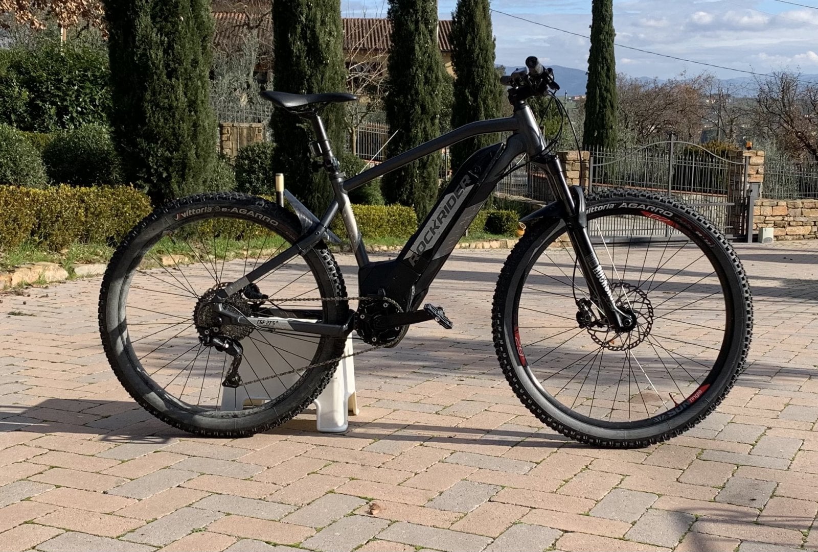

With the 29x2.25 mine is officially a Mullet now.
745mm at the front, 725mm at the back

The fat front 27.5-2.8 ennoyed me a bit, so I changed to 2.2
But that made the front too low.
29"-2.2 put me back at the same height as original.
I found the 27.5-2.8 at the front only rideable when very hard inflated. A bit less pressure made them comfortable, but extremely Left-Right instability.
The 2.8 balloon was slower to react, and cut less in the riding surface than a 2.2
You can deflate a 2.2 much more to gain comfort, wirhout getting seasick. Both on 27.5" and 29"
Still happy with the Rekon 27.5 2.8 at the back. Both inflated and deflated.
If there would have been choice, I would have taken a 27.5-2.6
