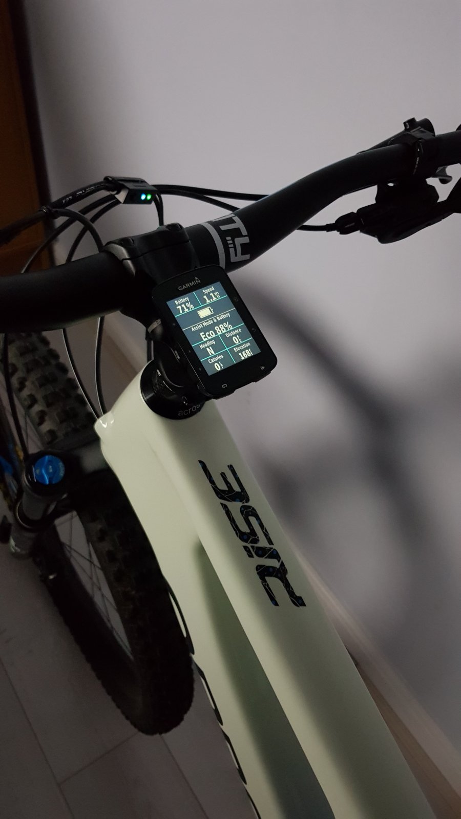

I have the Garmin 530.... for me, it's the best option, and I'm very much in the Garmin ecosystem.
I've just recently been able to finally get some rides in on my new Rise, and have been getting used to an Edge 830 that I purchased recently as well, and I agree with all of these comments. Setting up the RS Toolbox on the Garmin the first time was cumbersome and fiddly, but once set up it works quite well, and pairs with the bike quickly after starting up when beginning a ride. The only things I would add to Bigkatoomer's notes are:
- The battery % on the RS Toolkit usually does not display a value until several minutes into a ride; this is less than ideal if you are hoping to see the battery % in the garage before deciding if to charge the bike, and for how long. Anyone else noticing this?
- The refresh rate of the estimated range is pretty slow, and can lead to some spurious readings depending on the terrain of your route; for example, predicted range will go way up if your route is flat for a while, but takes a bit to correct once you start climbing. Accordingly, range is somewhat useful for reference, but keeping an eye on battery % in real time and being aware of the terrain on your planned route is more important.

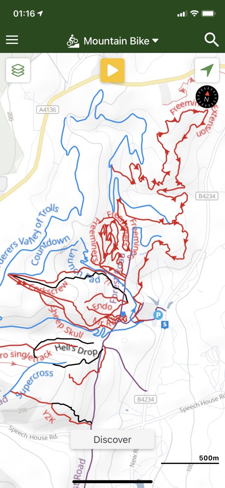

I’ll give my garmin fenix 6 and the Apple Watch a go next……I can’t for the life of me imagine using garmin for helping pick out trails at big places, Trailforks is king of trail hunting I’m finding so atm Im having to use my phone way too often and next best thing would be the Karoo 2 but sound problematic, they do a 30 day return though….
me and a pal only came to Forest of Dean because I happen to glance at it nearby where we were staying and then once we got upto the main off piste bits we didn’t need it much but was fairly handy upto then. TF on connect/garmin is comical

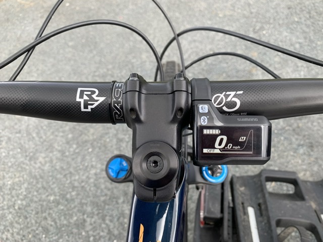

Managed to get the LBS to complete the installation of the Shimano display whilst I was away.
Shakedown ride yesterday was much better being able to see battery state and how much assistance it was providing...
Full colour and different colours per mode. Much better and recommended...

Yes but the mode switch was also replaced with a new one (different) as the original must have been over-torqued at the factory as it had a small crack in it. Wiring was changed to correct type for new switch and display (only £25). Switch and display cost well over £200 and then labour on top, £100.

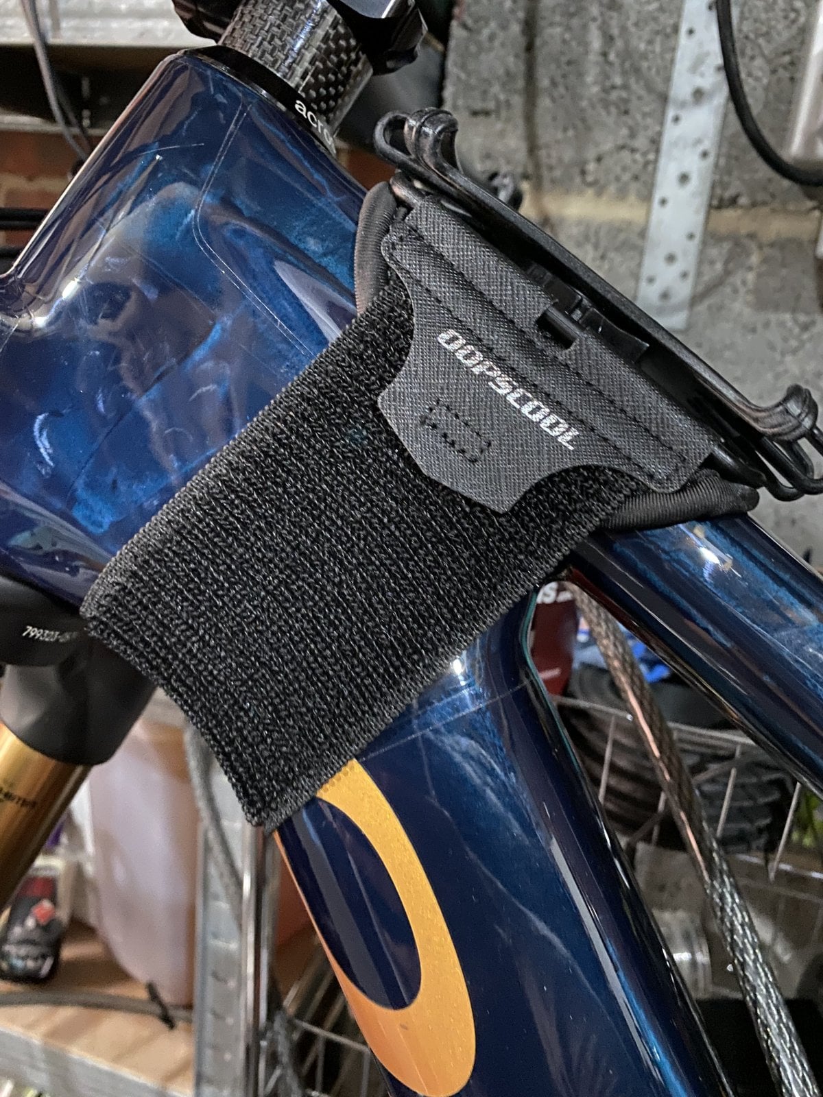

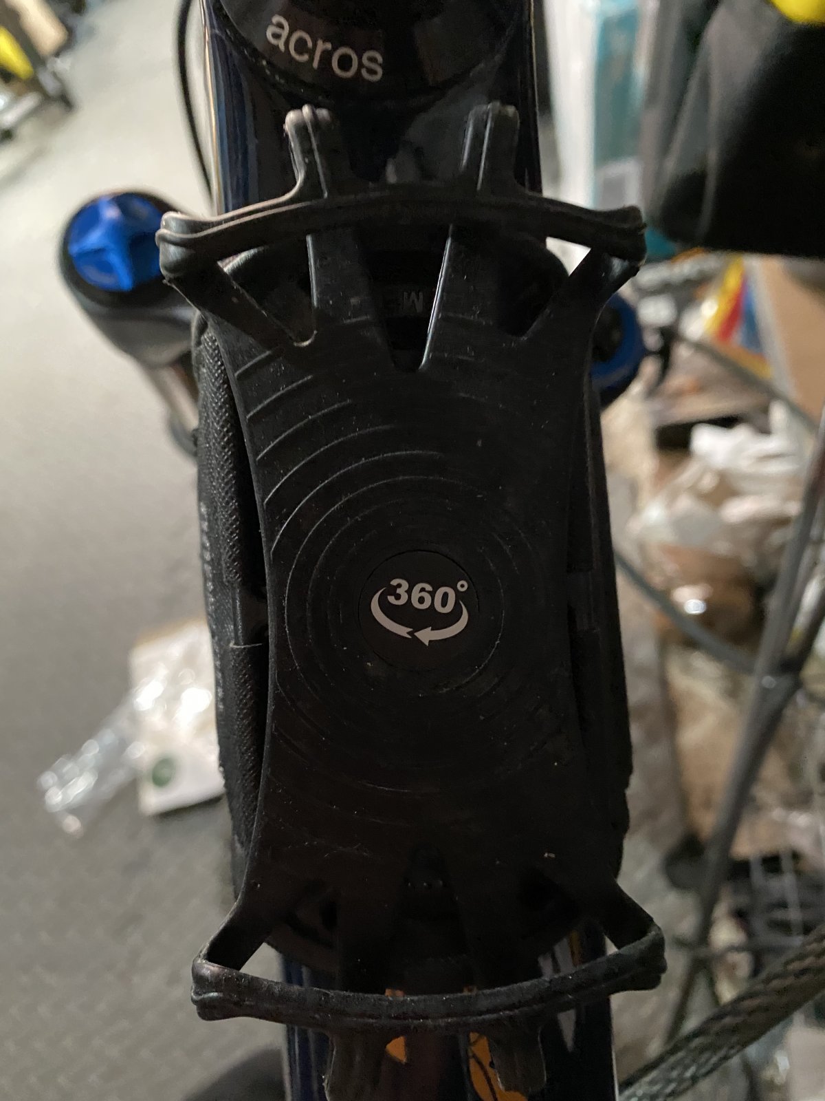

I always take my phone so figured might as well use the damned thing!
Nothing compares to phone apps, Trailforks, OSMaps, ViewRange and the typical Strava, Komoot, I do wear a Garmin 6 pro watch although the Apple Watch features a much better life saver if your on your own since it can call emergency automatically after a crash to come rescue your ass with its cellular features….
mines in a protective case already, it’s heavier than I’d want really but protected well, what I’ll never understand is people sticking expensive stuff on the bars! Soa better place is the toptube where it’s much safer. I would advise to add a lanyard as a backup also and just clip something f to the bars it can attach too.
Under £13 and then you can have anything running whilst your riding, if battery’s an issue there’s loads of cheap lightweight banks you can add onto it also, you would just stick it under the holder and make it tight then loop a tiny wire into the phone etc. My battery lasts always on all day multiple apps running….
