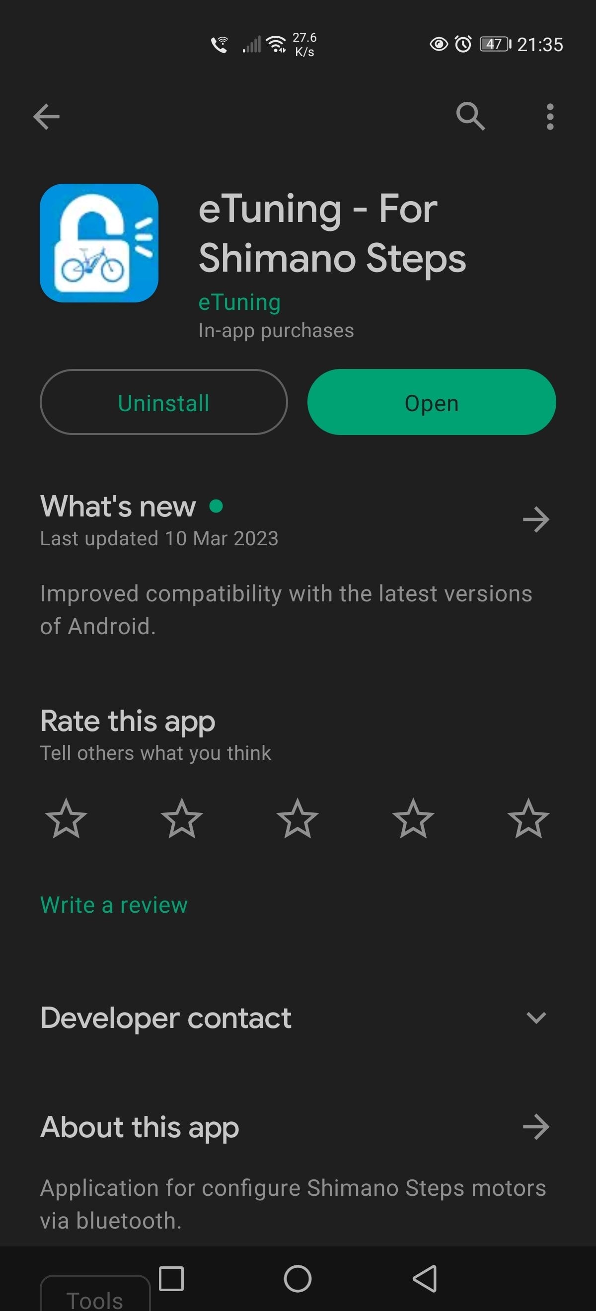

It cost 20e with other app and functionality is same

"If your firmware is marked with 4.1 or higher, not all functionalities will be available. You need to downgrade the firmware. It is a relatively simple process that takes about 10 minutes and you only need a PC and your mobile."
can you elaborate as a user? My reading of https://etuning-app.com/downgrade_ios.pdf is that this software doesn't work with up to date firmware on the EP8 motor

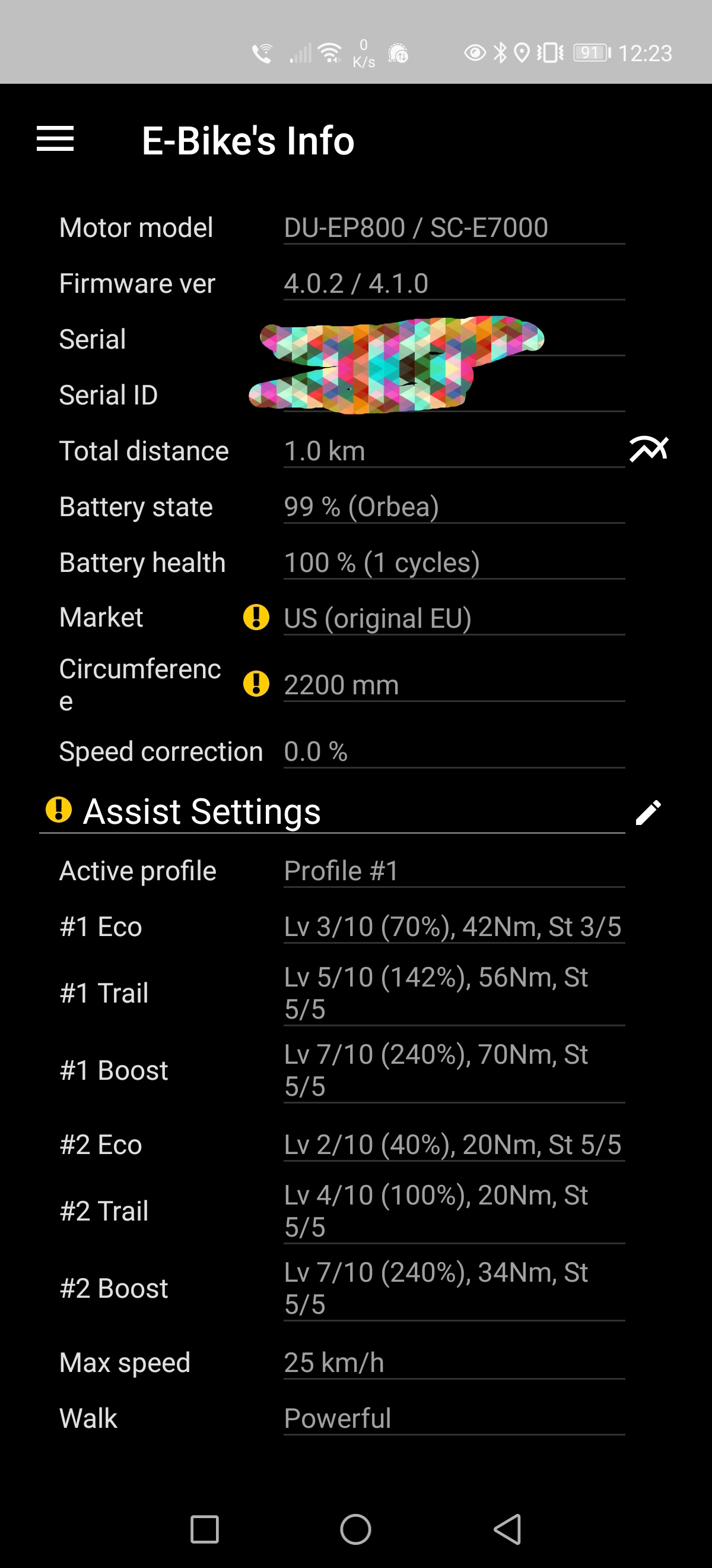

This app works same way as others apps posted on the forum. It connects to motor via Bluetooth and change settings. But there are 2 things that some people mess. First to do this you need to go back to older version of shimano motor firmware like 4.0.2. that allows to make that changes. Second thing all apps only allow to change basic settings in free mode. To change region, Tyre size and other advanced settings you need to buy premium version of the app. And last thing for RS version of the EP8. You can go back with motor firmware to older version and change premium sertings via bluetooth app on it but after that you need to go back to current version of firmware. Reason for that is because RS motor with older firmware (at least with 4.0.2) shows error e35 until you go back to current firmware. But bluetooth app work as usuall even when error e35 is displayed. My orbea settings below.

Hi, thanks for posting. I am slightly confused though. I have a later version of the firmware, so I understand I need to roll back my firmware to an older version, buy this app and connnect it, change the region, and then what? Can I update to the latest version of the firmware but it stays on US region? does it all work then? A bit confused. Thanks.
Correct. Make change on old version and go back do new. I guess and I think it is right that when that old firmware version was the current one ep8 RS was not release yet so it is not included in the code.
