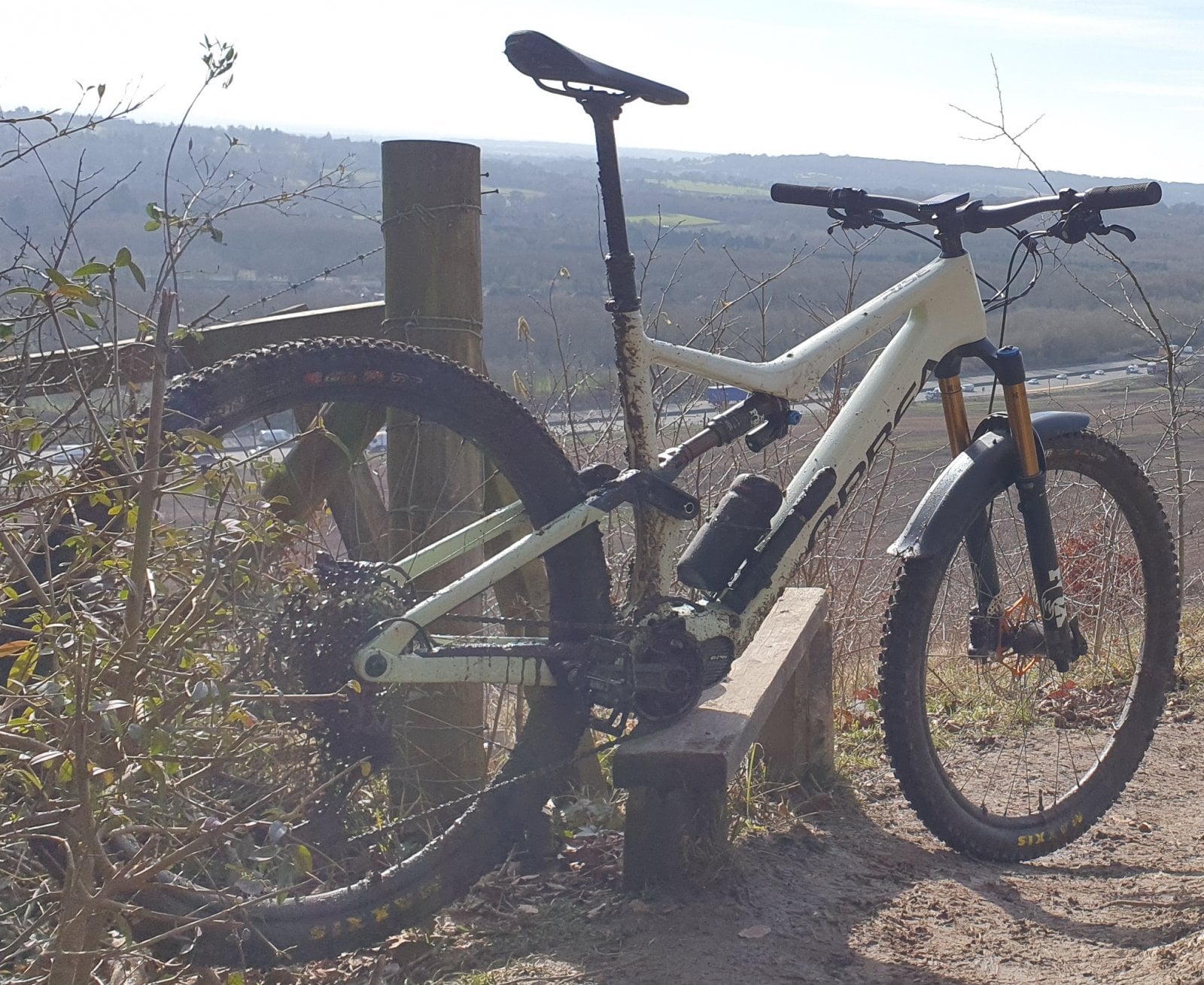

Hi all,
Would be interested to see what people are upgrading on their Rises, and why. A dangerous thread for my wallet I feel....
What I have done on my M10 Size XL:
  • Tyres: Maxxis Assegai Front and DHRII rear. Not fitted but ordered with bike as reviews said standard tyres were poor. Still at Bike shop, waiting for the.....
  • Range Extender - Bought with bike in mid-feb. Still no sign. Not ever needed it yet though!

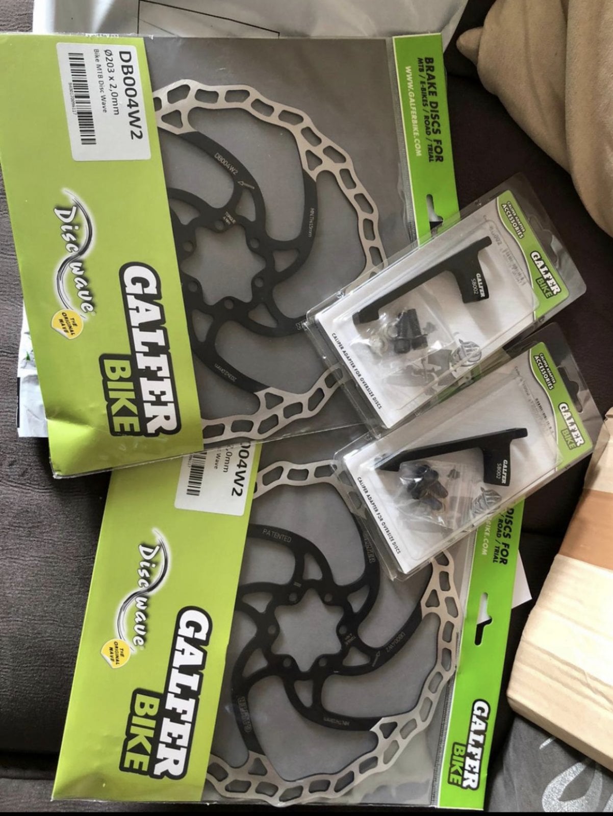

  • Front Brake Disc - Swapped out 180mm Galfer for Hope 220mm and adapter for more bite. Straight swap and very pleased. +100g -£60.
  • Grips: Brendog Thick Deathgrips - Not a huge difference, but a more comfortable grip for me.
  • Garmin Top Tube mount - Can mount the Garmin 530 straight onto the steerer. Clean, light look.
  • Additional volume spacers for 36 Factory forks - Currently unfitted. Aiming to smooth the chatter but not bottom out on small jumps and drops. Not a big deal, so haven't bothered yet
  • Tubeless conversion - LBS did this as bike prep for the sale
  • Pedals - DMR Flats. Have always had SPDs but not missing them at all. Flats are kinder on my old knees for twisting, more reassuring through sketchy technical bits and while those around me clatter around to get clipped in before a run, I'm straight in there! - Paired with some FiveTens for maximum grip
  • Cheap toolbox waterbottle - Short rides I don't need water, long rides I take a backpack/Camelback, so I keep my spare tube, levers, Stans tubeless repair, CO2 cannister in there
  • OneUp Pump and Multitool - Really good pump. Totally overspec'd and perhaps in hindsight unnecessarily heavy - but a lovely bit of kit and multitool.
  • Front Mudguard - RRP Proguard - Large f. Mounts to back of forks with screws, not zip ties. Ugly, but stops my face getting covered in sh*t.
  • Invisiframe - LBS didn't want to do it, so I fitted it - Takes HOURS when all I wanted to do was ride my brand new toy. Obviously worth it for the long run, but needs patience. Full gloss version for my bike.
What I'm thinking about:
  • AXS Rear derailler - One less wire. Simple install. Still split on swankiness vs another battery to charge.
  • Saddle - People mention the Ergon saddles, but I've never found this standard saddle uncomfortable so far....
  • AXS dropper - Well, since I've started.... but then have to find a place for the little LED block to go, possibly along the handlebar, but it's grown on me as I've got used to the mode colours, and it's useful having it out front.
  • Aftermarket Fork inserts - My wrists are a bit knackered from falling a lot of motorbikes. I rode a friend's DVO and it was smooth like butter on the trail. I would like to try to get the Fox 36 Factory to be more like that using insertable widgets into the fork leg. No idea if that will have the desired effect.
How about other Rise owners or those 'expecting' - What's planned?

  • Front Brake Disc - 203mm Ice Tech I had lying about, had to buy a mount

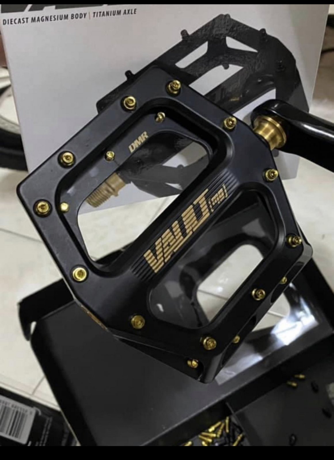

DMR Vault V2 pedals
Brake caliper adapter for 203mm disc (disc not ordered yet, not sure if I need center lock or 6 bolt)

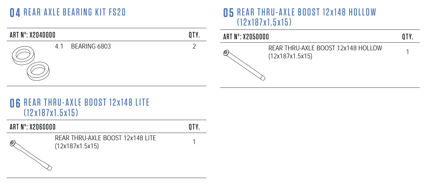

  • The rear axle appears to be the road bike axle but stretched out to Boost spacing. It looks a lot like this one: REAR AXLE 12x165(2P1.0x15)LITE. It seems a bit flexy to be honest, the brake rotor rubs the pads depending which way you lean the bike.

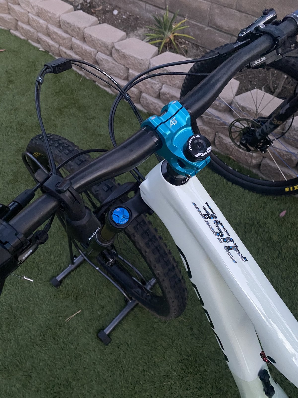

Purchased a M20 back in March but after a few rides I decided to upgrade the suspension. Luckily, I found someone on PinkBike selling a Fox 36 Grip2 and DPX2 coming off a Orbea Rise M10.
Upgrades - - >
Fork: Fox 36 Grip 2
Shock: DPX2
Stem: I9 A35 50mm
Handlebar: Yeti 780mm
Decals: Stckrd for fork and shock
Dropper post: 175 mm Kashima
Tires: Front DHR / Rear Dissector “tubeless”
Invisiframe
Bottlcage: Fidlock
Grips: Ergon GA2
Saddle: Ergon SMC Sport Gel
Pedals: Shimano XT
Any suggestions for a replacement?

I don't think all Rise's come with the "LITE" axle, just the LTD. So presumably we can buy the "regular" one that goes in all the other bikes? If you look in the manual it lists both options:
  • LITE = X2060000
  • Regular = X2050000

M20 Medium,
saddle: WTB Volt (have the same on all my bikes apart from the DH bike)
Tyres:std at the mo (have a years sponsorship from Hutchinson, just waiting on delivery, will be griffus front and rear)
Wheels: Hunt enduro wide with Rimpact inserts (might have gone for the Trail Wide in hindsight)
Forks: The std 34s are holding up quite well, was thinking about going to Pikes but holding off at the moment
Shock: Monarch Plus rc3 210x60 gives 152 rear travel (off a 2016 trek slash) have also got a cane creek inline coil but not yet tried
Seatpost: std but I do have a Magura Vyron wireless to fit, just deciding where to fit the button.
