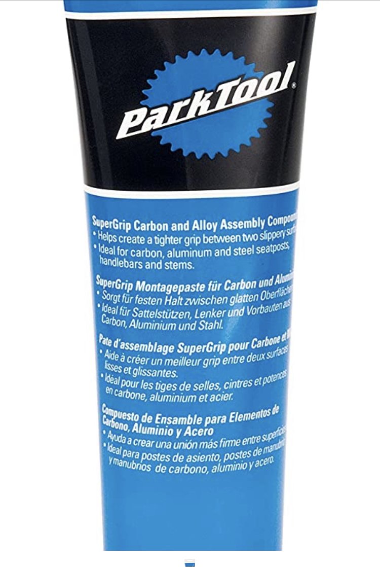

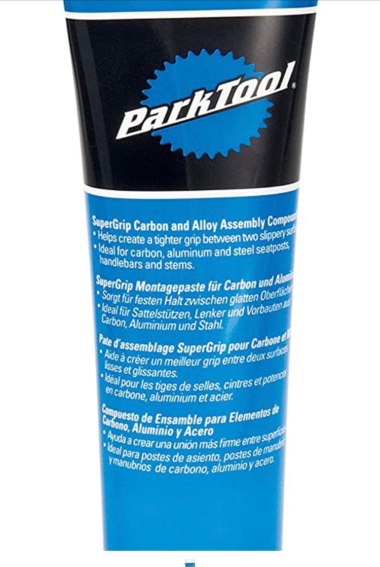

Is it rotating at the clamp? If so you can use some of this stuff.
