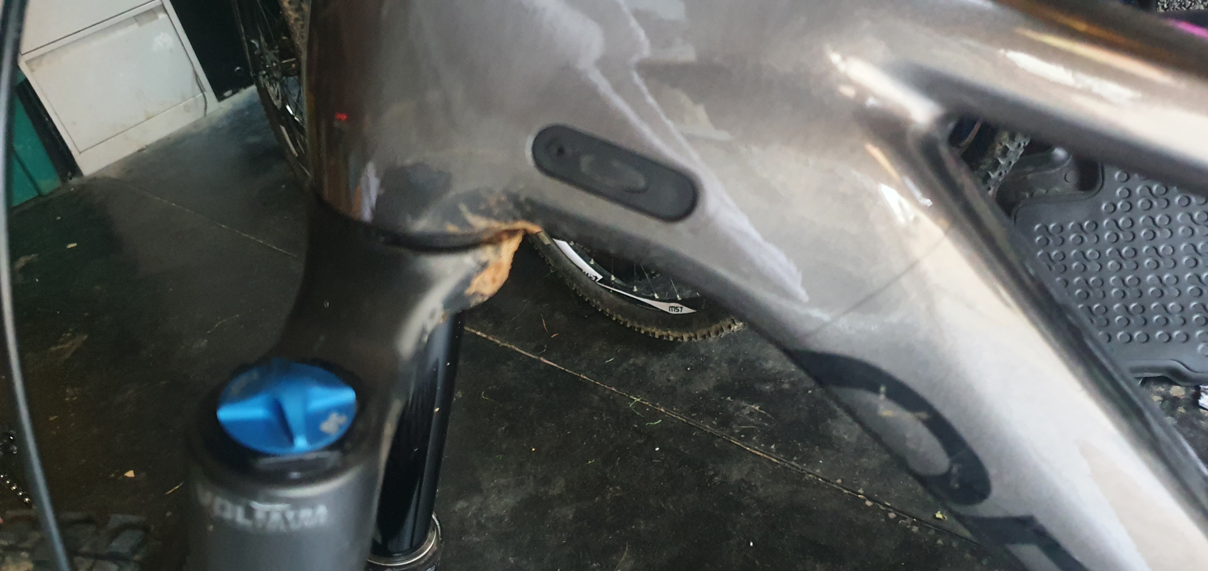

I am planning on removing my Fox Transfer dropper and installing an AXS dropper. Upon removal of the dropper cable, I was hoping that the rear brake hose would fit and could be routed thru the dropper cable's port on the right side of the head tube where the display wire also lives.
I have already swapped the hoses on the brake levers, moto-style and running the left brake hose (which is now the rear brake) through the port on the right side of the head tube would be less stressful on the hose.
I'm planning on dropping the motor to make this change, as I believe it will be easier and more efficient to properly remove and re-route the cables/hose as desired. It appears the brake hose is about 5mm diameter, which is slightly larger than the dropper cable, which is about 4.2mm - just don't know if the hose will fit the dropper cable's port along with the existing display wire.
Has anyone run the rear brake hose through the "dropper cable" port or if the brake hose diameter will fit along with the Shimano display wire in this port? Thank you!

To follow up, removing the dropper cable from the right cable port on the carbon frame does allow for re-routing the rear brake hose through that same port along with the Shimano display wire. Dropping the motor and fork made it a simple task to properly route the rear brake hose through the internal guide and right headset cable port.
Now with the full AXS upgrade of shifter & dropper, there are no cables/hoses running through the left headset cable port.
