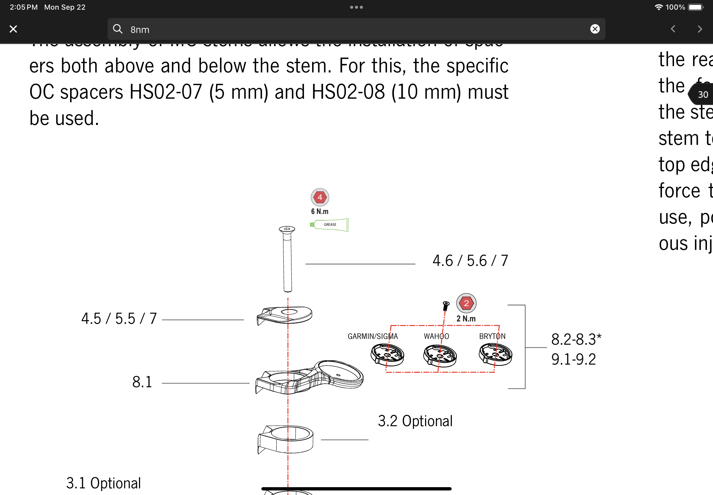

Check the blue paper, but I saw a post elsewhere that gives 10nm for the head set bolt due to a binding head set seal that presumably needs to be compressed or the head set is loose.
Certainly I’ve had issues with my 22 model knocking on the brakes even though the head set bolt “feels” tight in the traditional sense
Seems unless it’s done up to 10 nm it will be loose no matter what. This applies to the oe arcos head set only by all accounts

Thanks for this - I think it's solved my creaking noise! I took my bike to mechanics at two different shops to check the headset because of a creaking noise, and both said it was good. The Orbea Blue Paper for 2023 M models says 8Nm, so I tightened to that (it was only about 3-4Nm before) and after a quick test ride it seems good!

Rise 25 - 8nm (not 10 as up thread) but that seems to have solved it. There was a lot of turning and creaking beyond what I’d considered “headset tight” before it reached the torque setting.
