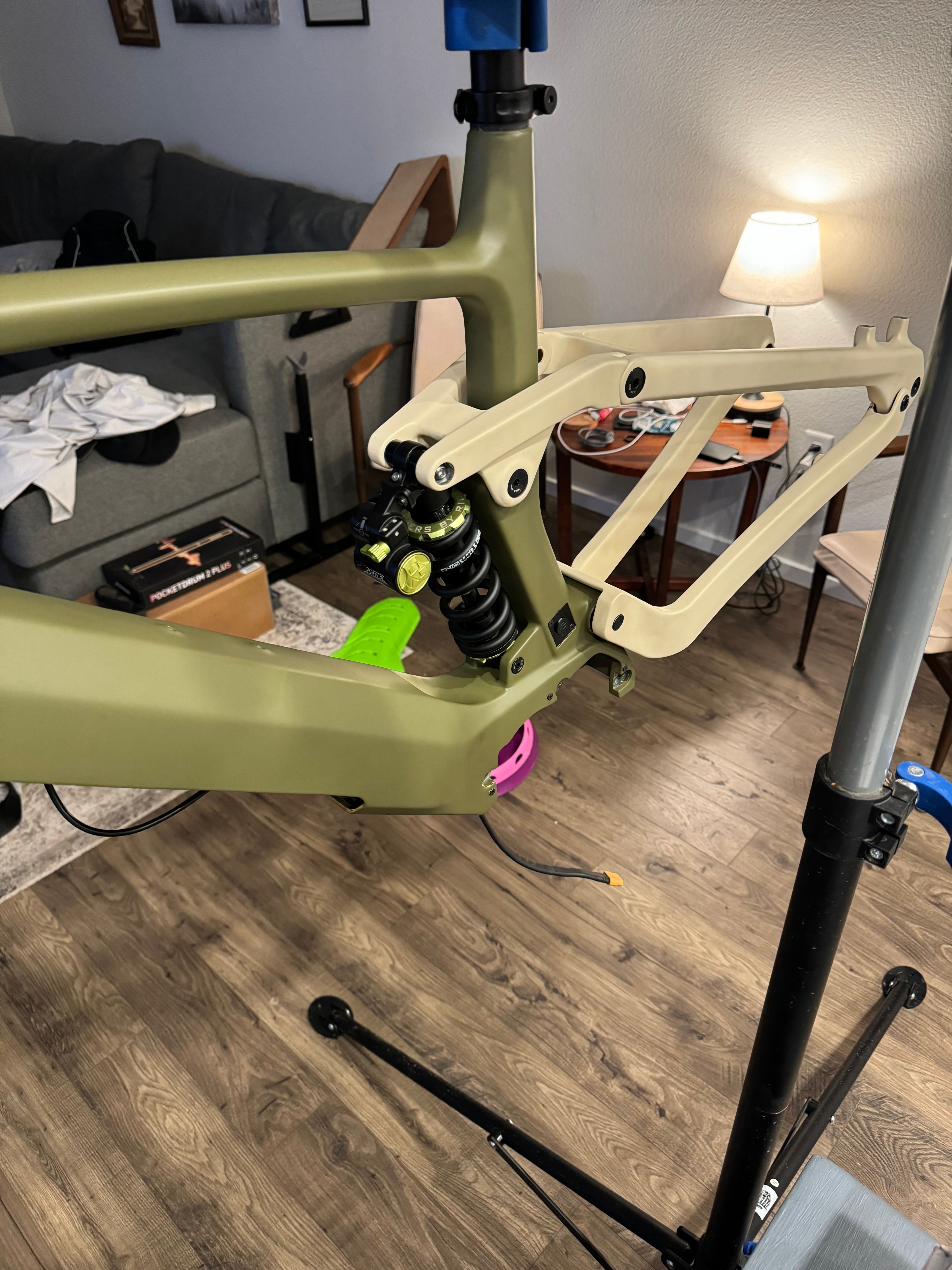

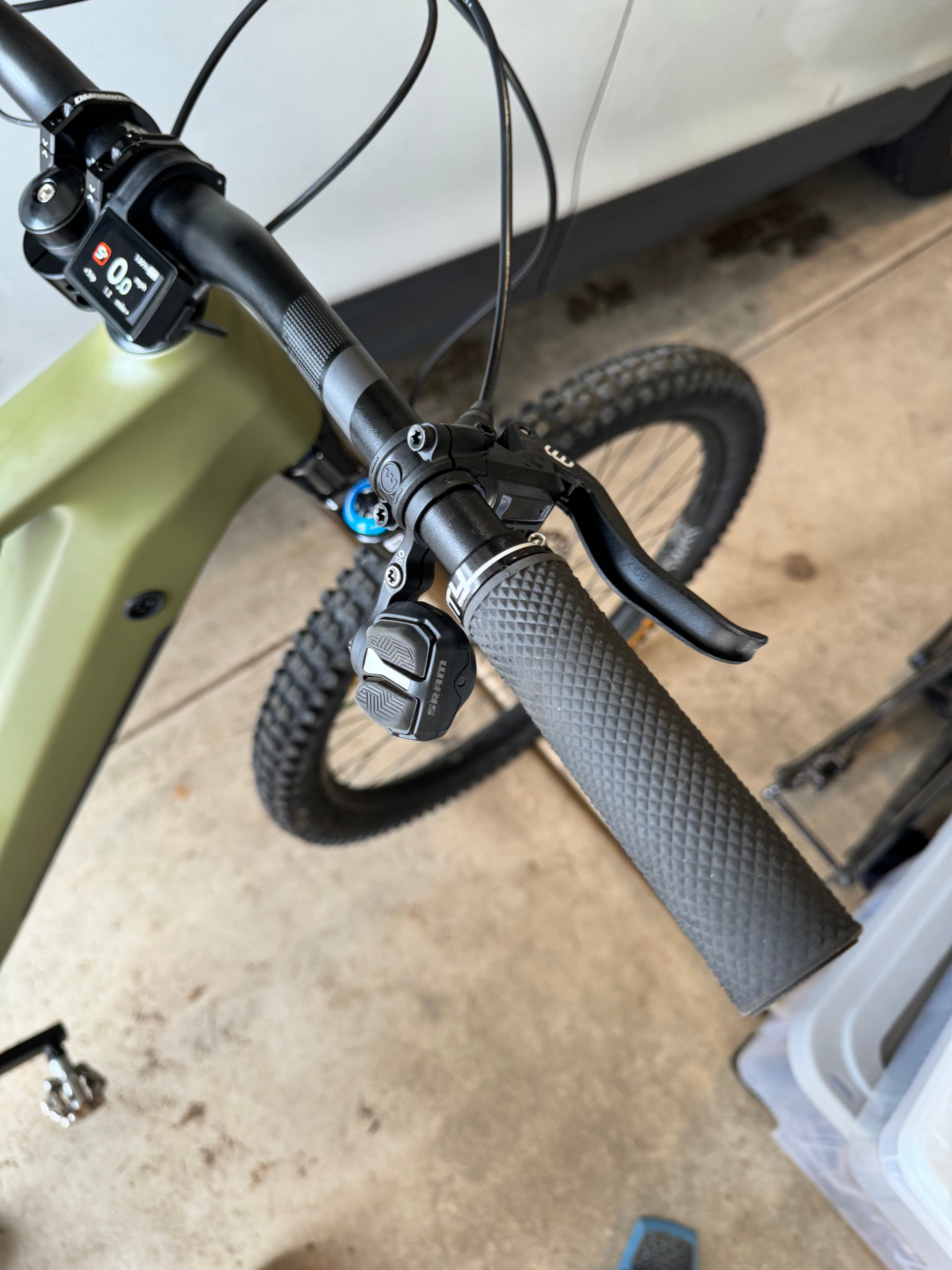

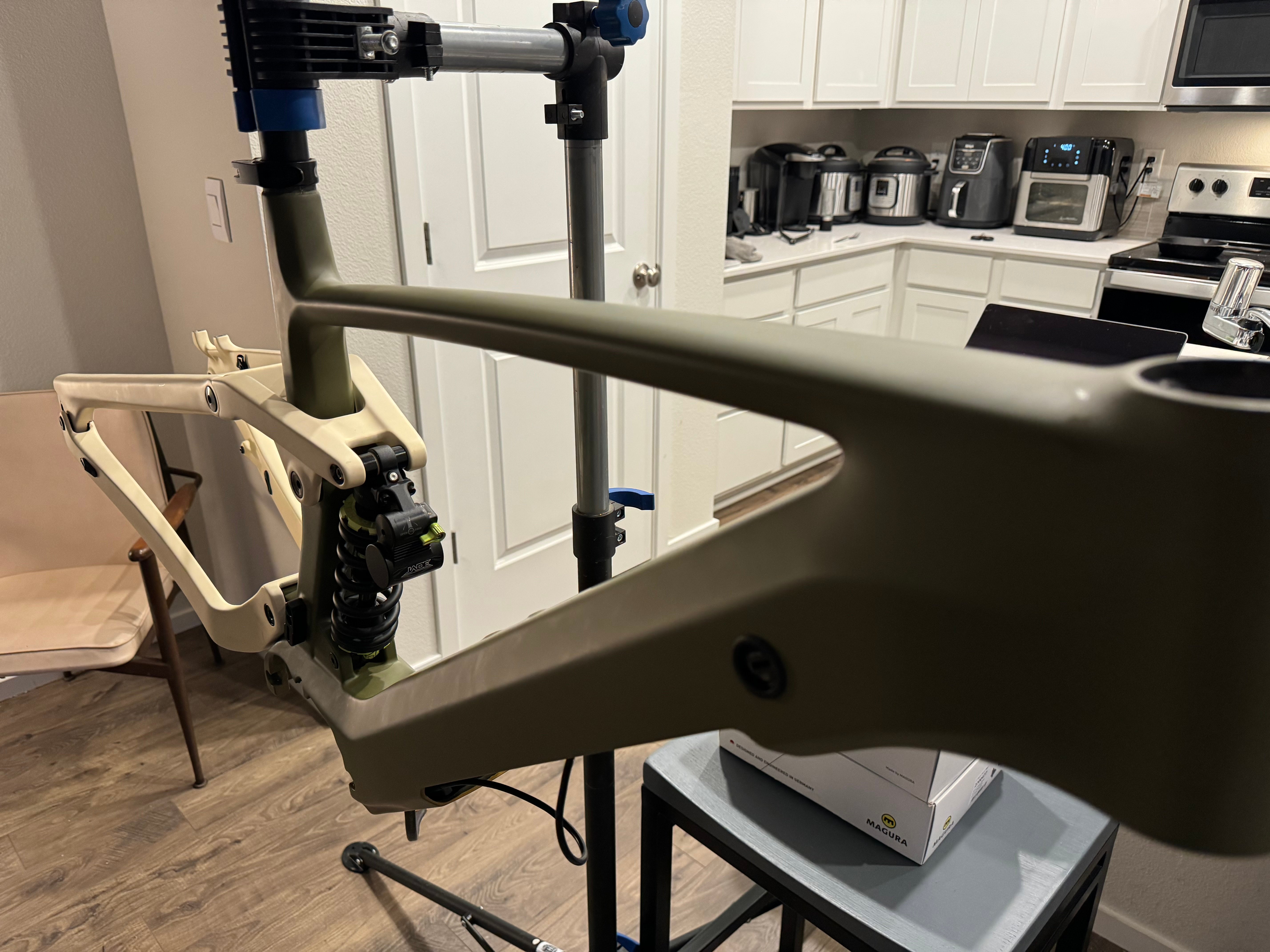

The Build:

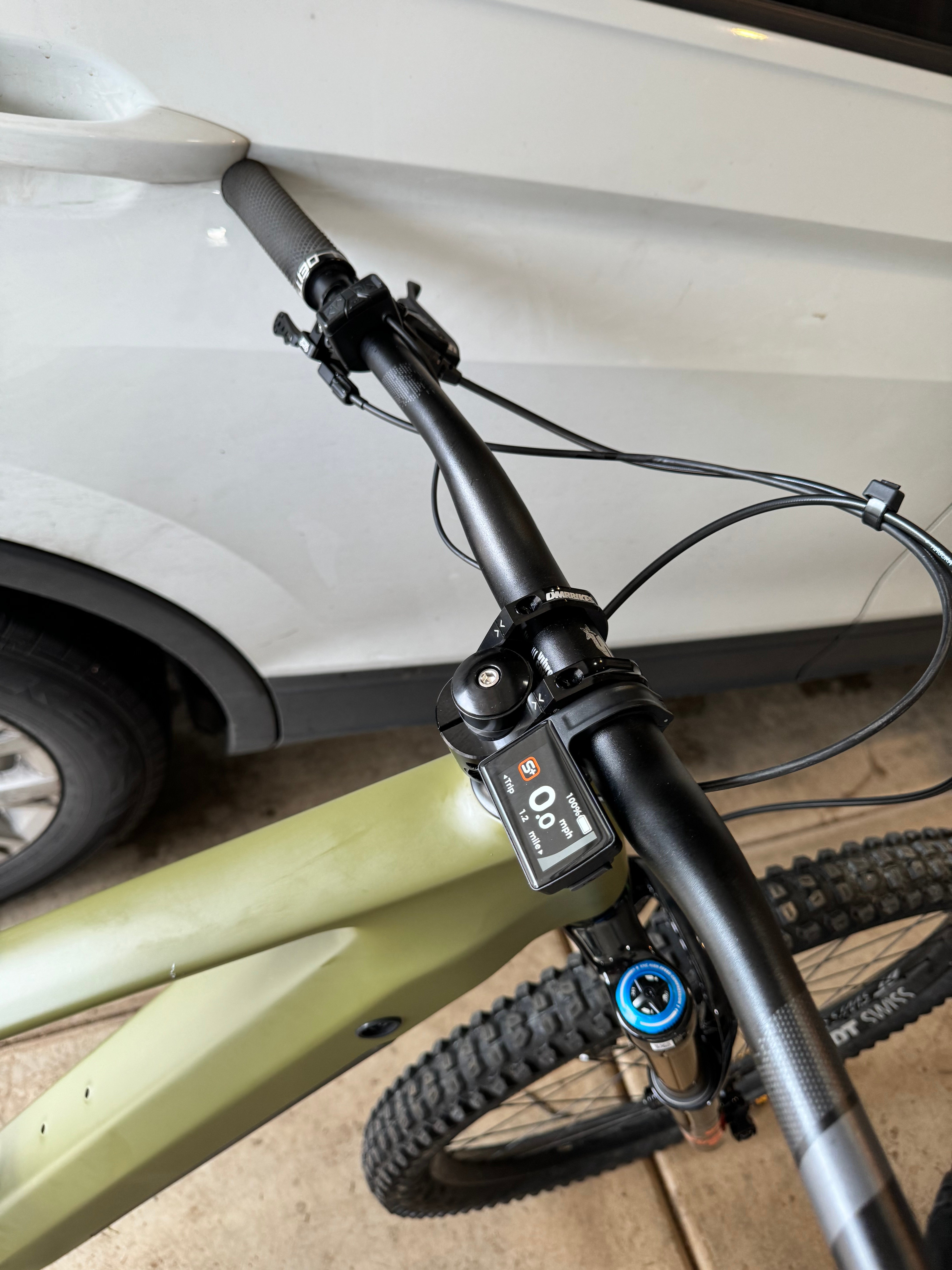

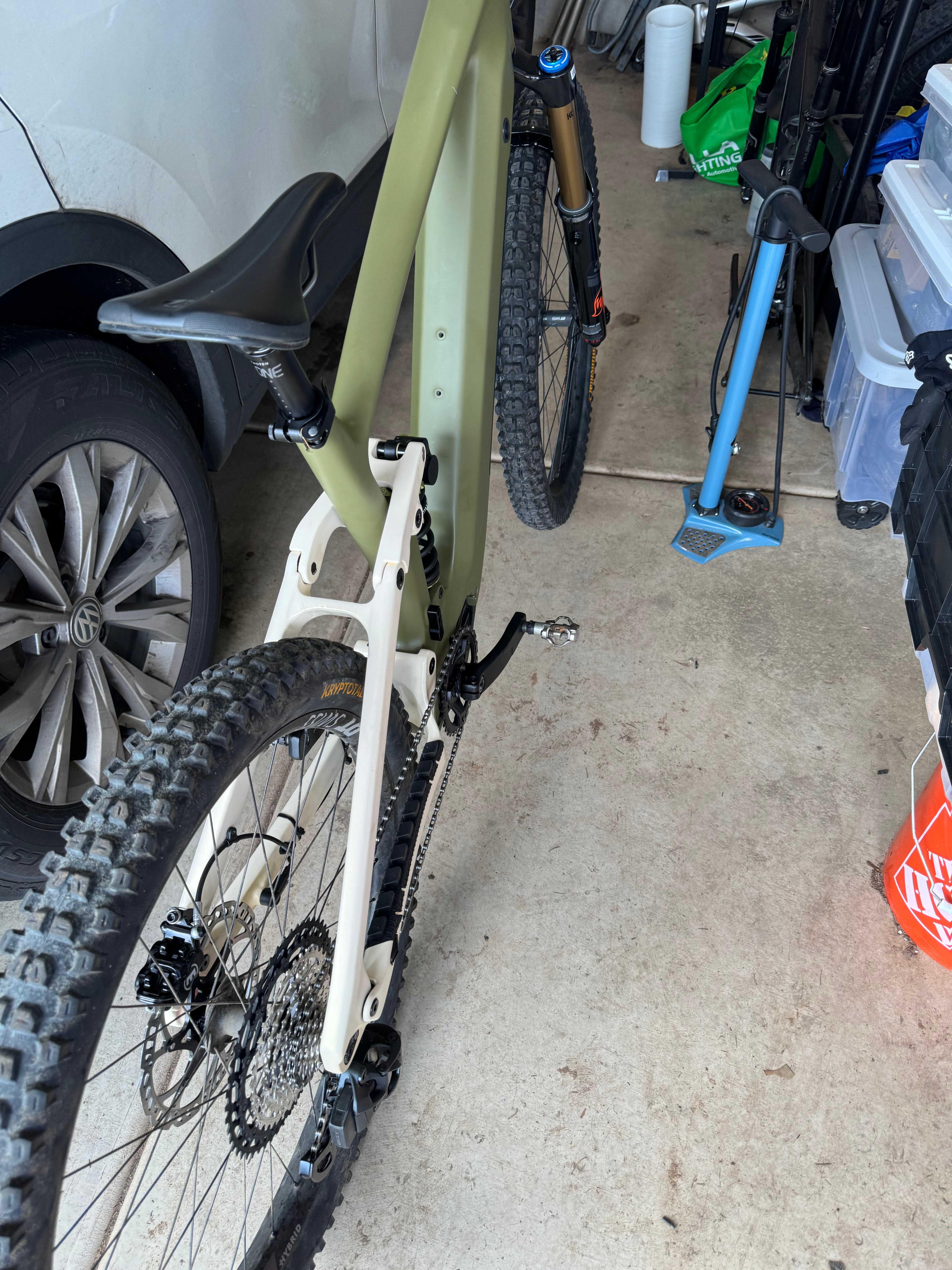

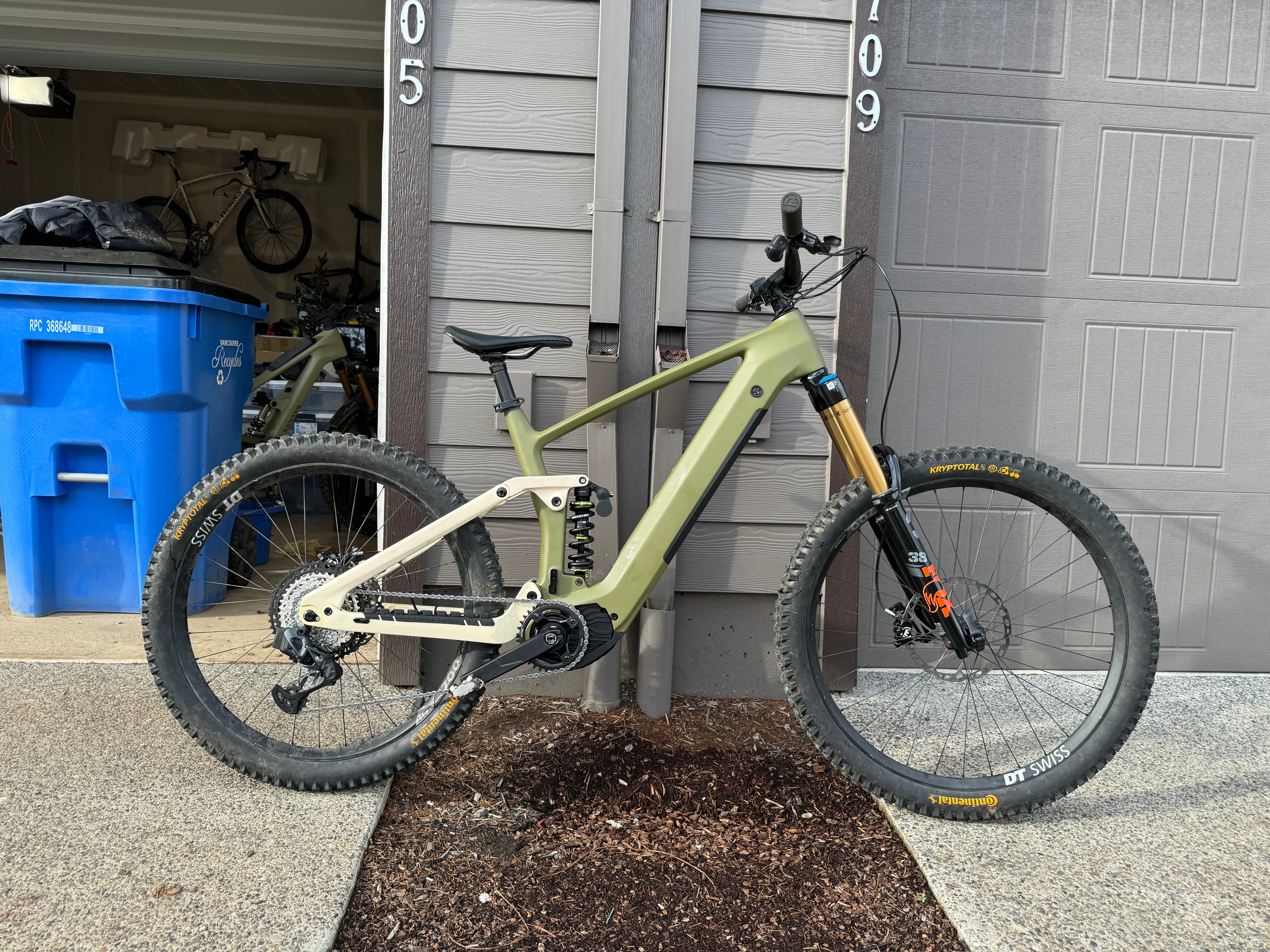

I was worried that they didn't have an extra-large frame, but the large frame turned out to be a good fit for me. It's nimbler than my other bike, a canyon torque: on in an extra-large. I put a coil shock on it and ran it 160 in the rear and 180 upfront. This made the geometry slack, around 63° with a mullet in the rear. I'm very happy with how the bike and the motor perform. I changed the tire size to get past the 20-mph limit. This speedometer accuracy is not an issue since I track my rides with an Apple Watch.
The ride is nimble and fast. I don't feel as in control at high speeds as on my canyon, but I can handle trails and steep tight sections just as well or better. This is because of the slack head angle and the mullet in the rear. This bike pushes me to improve my jumping skills and technique. I'm still adjusting the suspension, but I don't think the 160 mm in the rear is a problem compared to my current 175 mm on the canyon. I haven’t bottomed out on the same trails and jumps i normally ride.
M510 and battery:
I'm impressed with the M510, it's my first full fat Bafang motor and I like it. It has enough power and range for me. I use an 840 Wh battery and I don't worry about running out of juioce. I used to have range anxiety on my M820 build, but not on this bike. The bike weighs 57 pounds, which is average for a full fat bike. But it rides lighter, and I can toss it around on trails better than the M820 extra-large build.

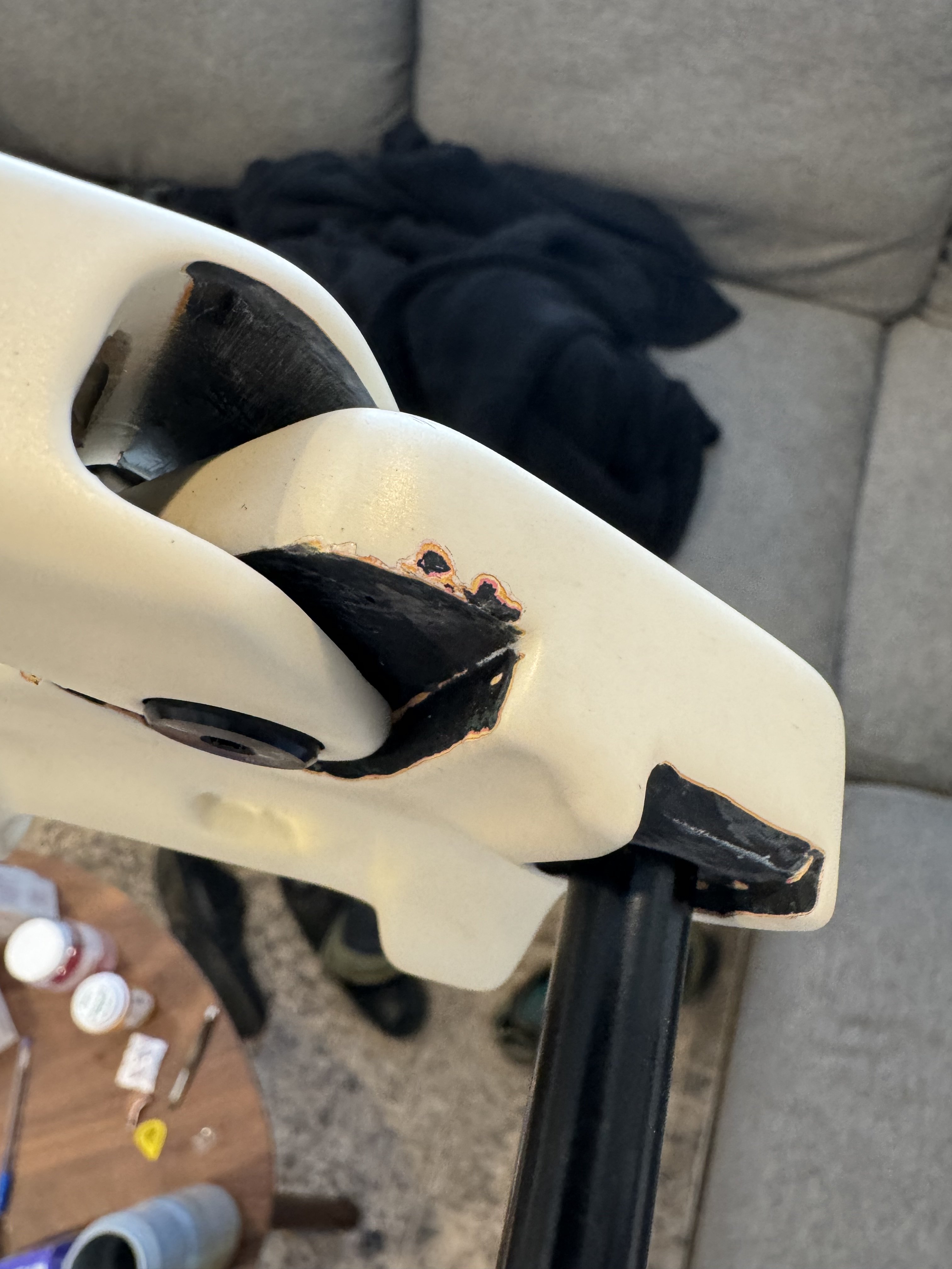

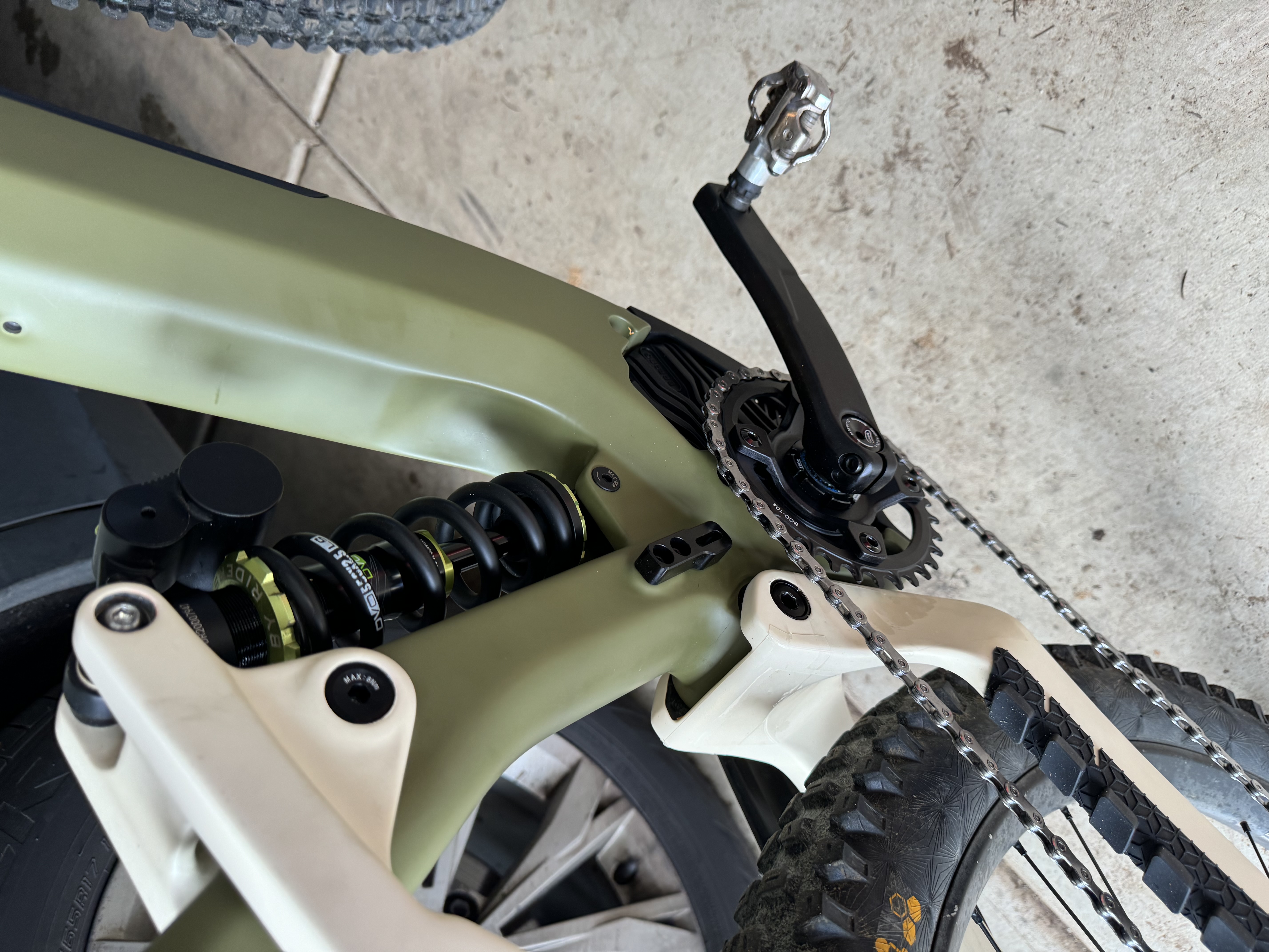

Paint quality:

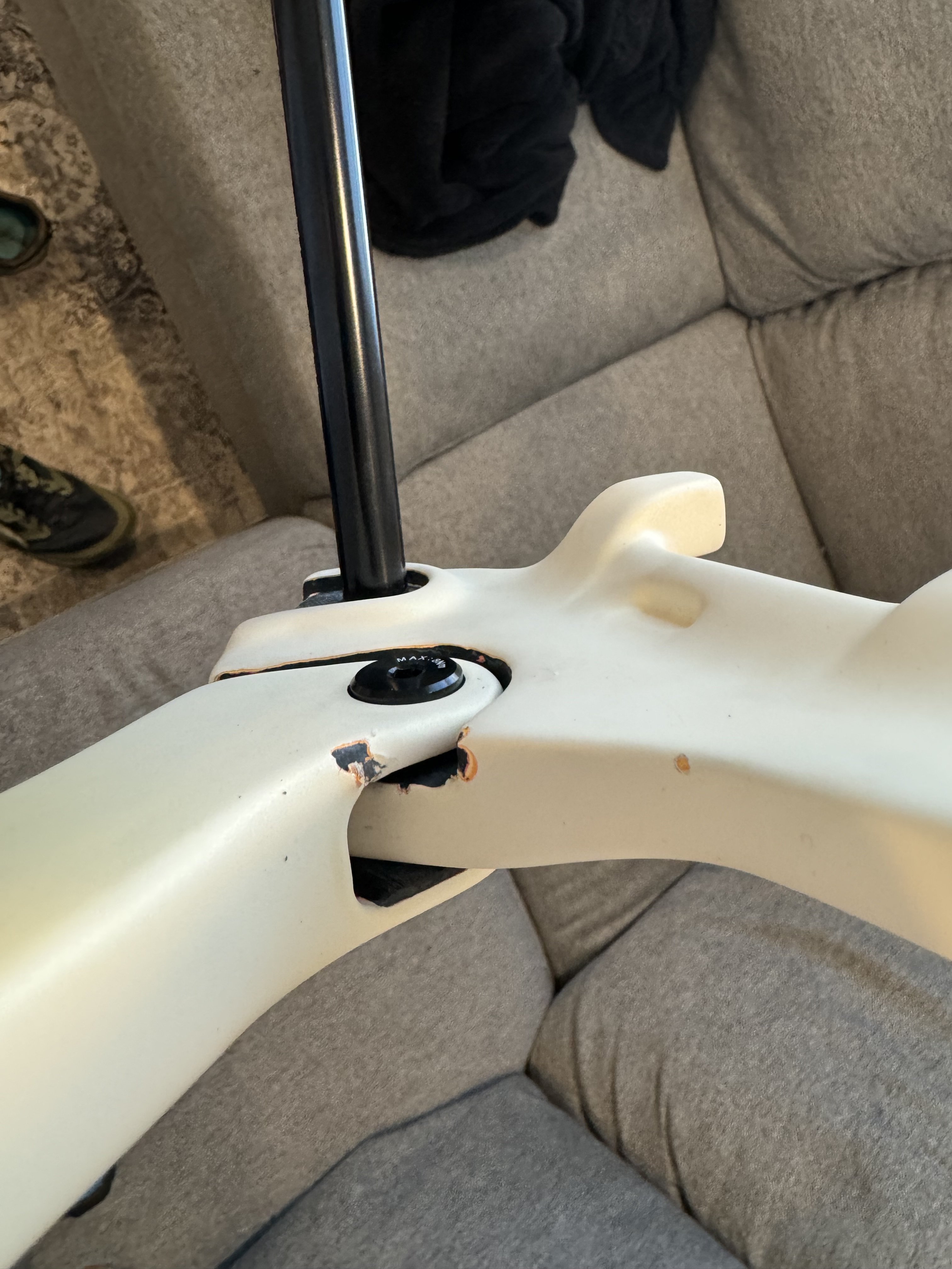

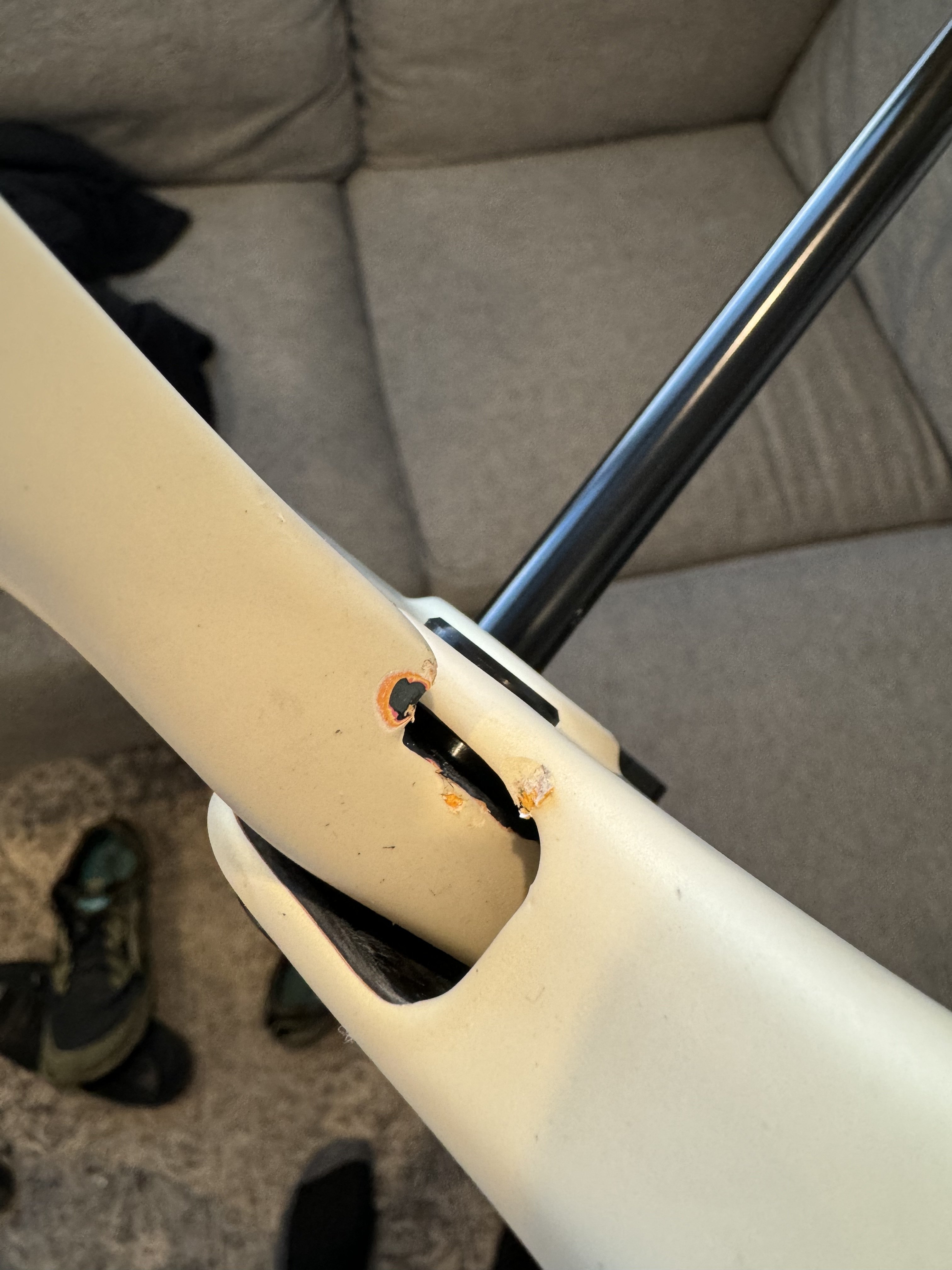

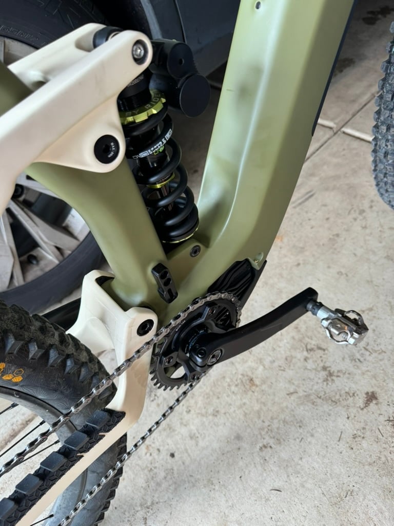

The bike came in pieces and had some paint chips around the pivot points. But I didn’t mind too much about the free or near free paint job.
Final thoughts:
I would buy an extra-large if they offered it, which they might if they get 100 orders. I highly recommend this frame motor combination; the frame quality seems good. I think the bike feels more solid than the M820 frame I have. The only thing I would improve is the paint quality, it could be a bit better. Beyond that I'm very happy with the bike and the overall build.

Paint quality:

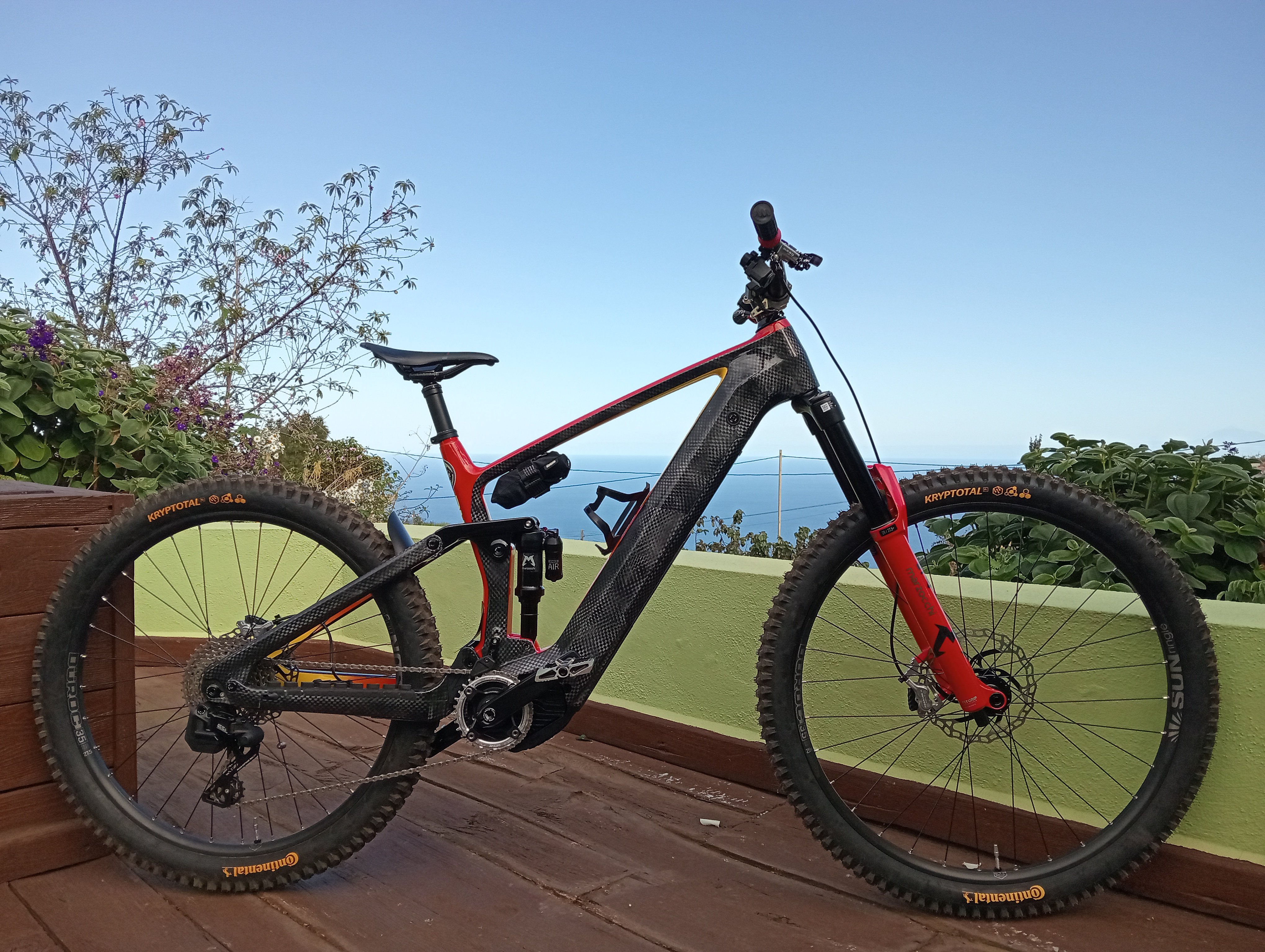

Myalteregohamish
Jan 4, 2023
294
240
Vancouver, WA
Looks nice! I like the 840Wh battery.
I'm just converting my M600 to 1000 Wh battery and looking forward to hitting more mountainous terrain in the near future.💪
Yea the power on this M510 is so efficient. My buddy on his specialized Levo was getting like 20% less range than me, but the gap seemed to keep growing by the time we hit 7K ft, he was limp mode and I still had 35%.
Myalteregohamish
Jan 4, 2023
294
240
Vancouver, WA
What can you say about M510 engine? Is it powerfull enough for you?
Why not M560? 😀
Great question, from all the feedback on the V2 of the M510 seems to be the sweet spot between consumption, noise, support and output. This seems to be the motor that's getting the most attention right now so I assume it will get the lions share of the manufacturer support from Bafang as well.

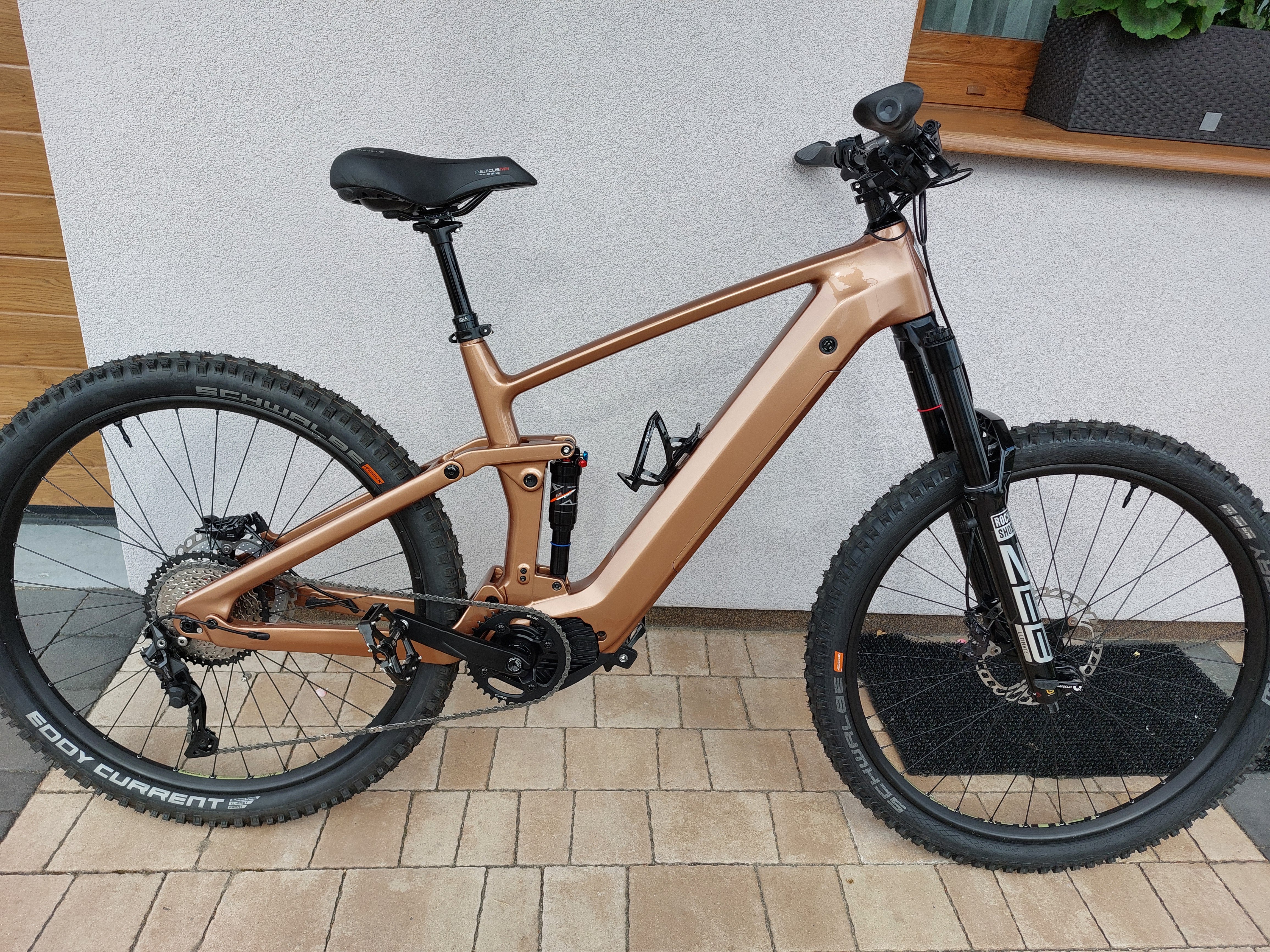

I also ordered such a frame from them, but with an m560 engine. The frame had just arrived, it had been sailing for quite a long time (I chose the ship). I regret that I didn't take up painting, because in Poland painting carbon is very expensive.

I noticed that shipping was much longer than I was expecting. I assume it's because they're bundling orders to the US and that takes time. 🤷‍♂️ Painting, for whatever reason is much less at the factory, again it's likely because they're buying paint in bulk etc. btw I was told by the factory the paint issue was due to a weather issues and they've resolved it.
geerbil
Apr 7, 2023
Poland
[COLOR=var(--YLNNHc)]If a private company painted the frame like this, no one would pay for such a service. Maybe it's good that I didn't let the Chinese paint the frame.[/COLOR]

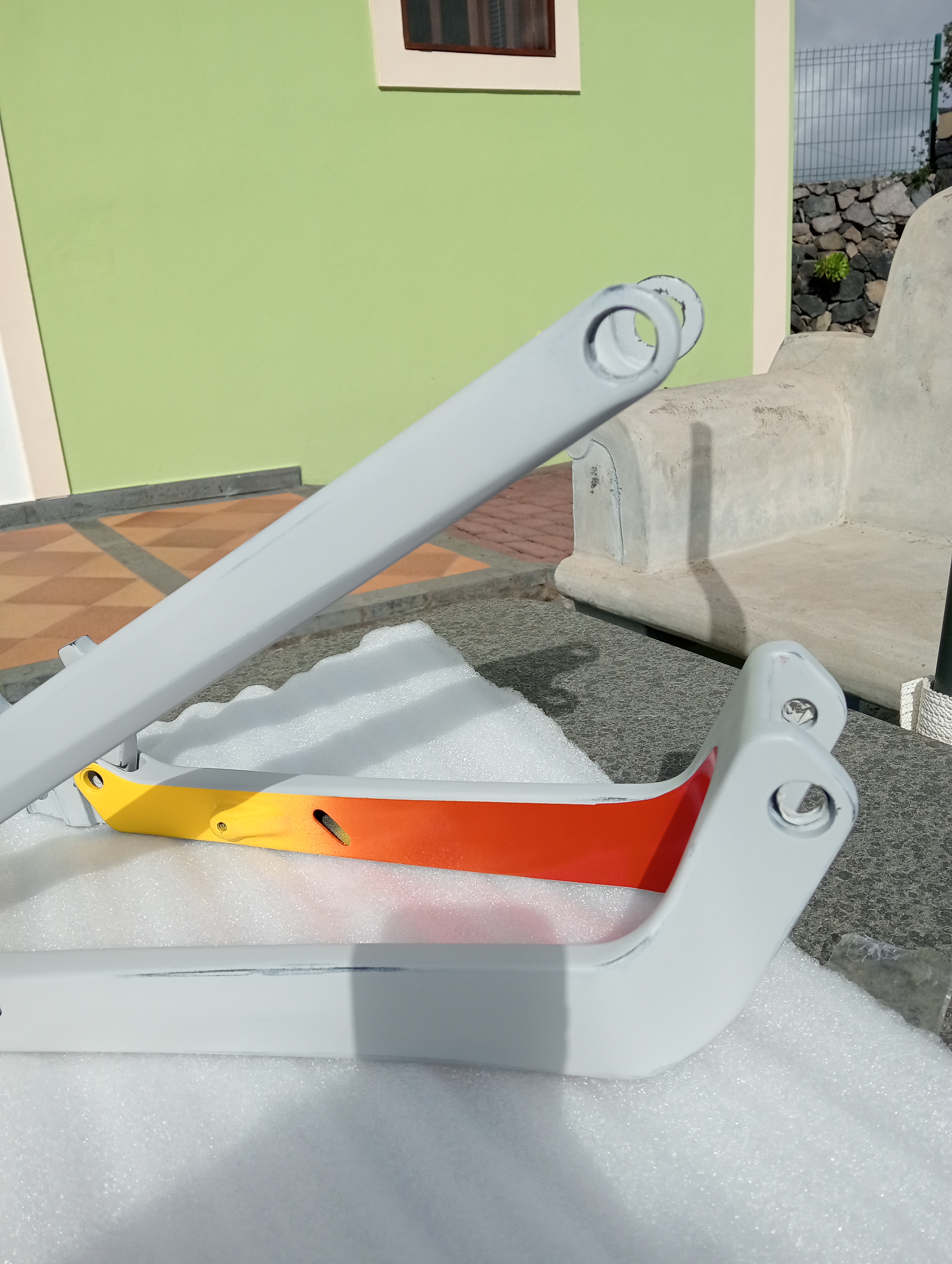

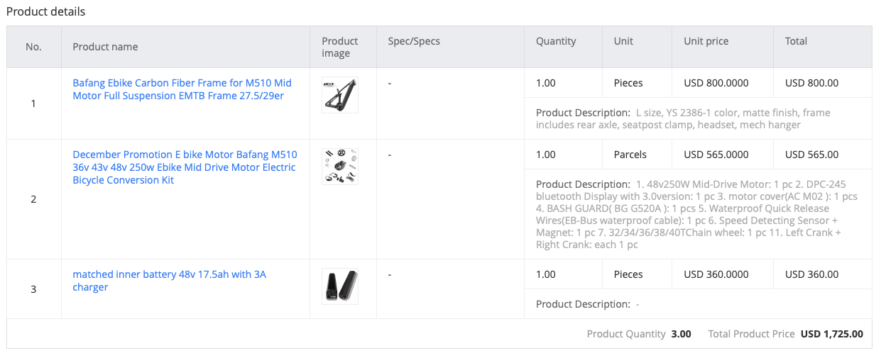

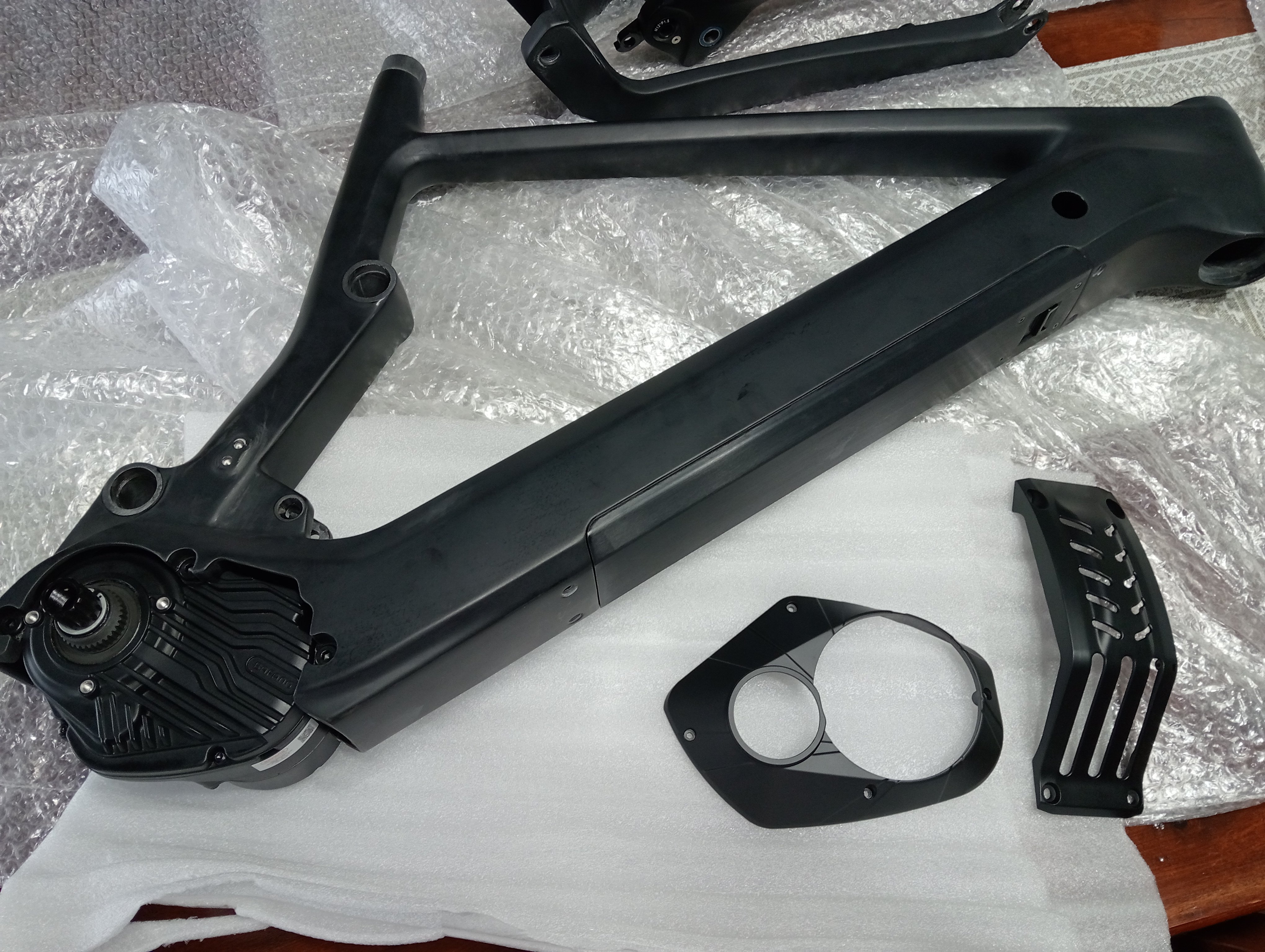

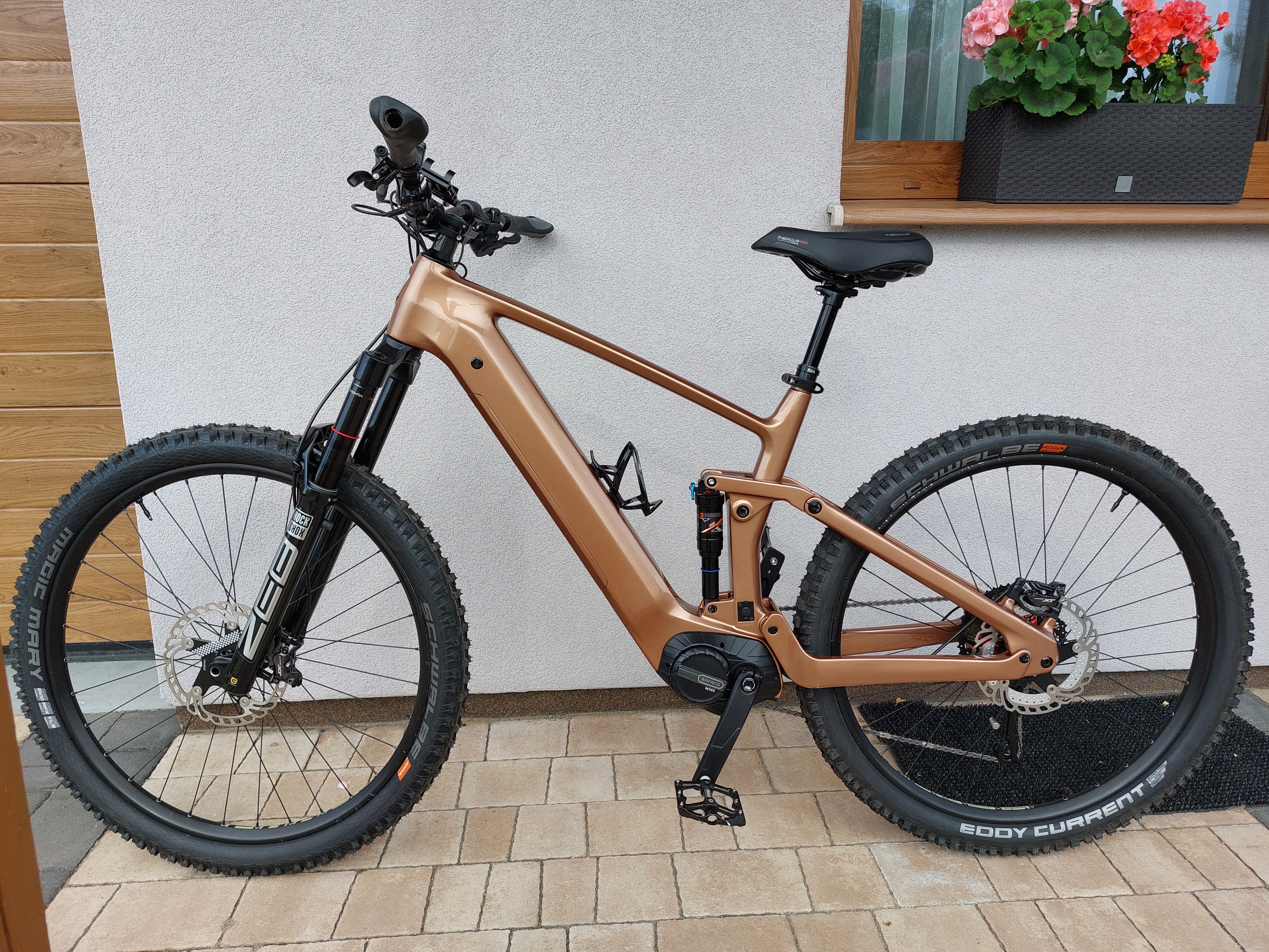

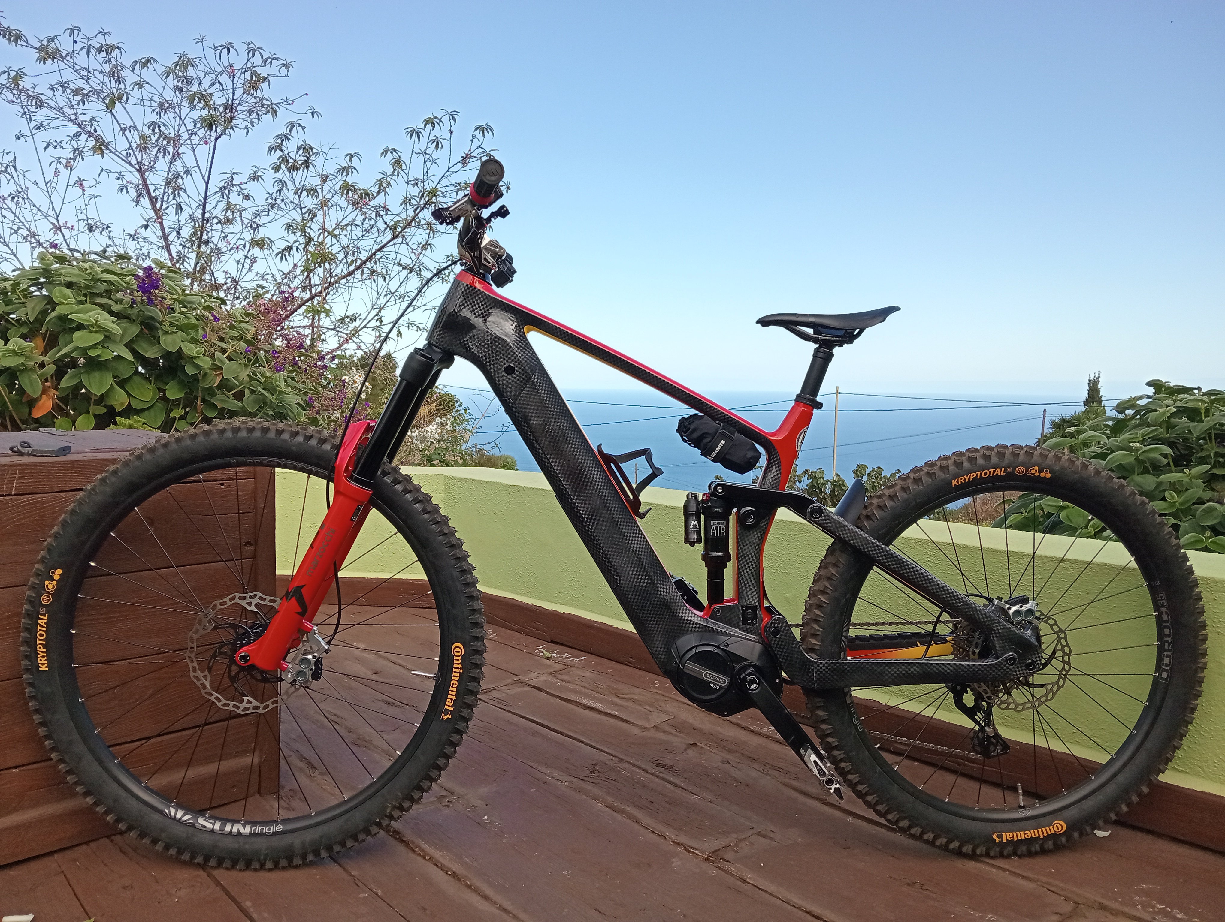

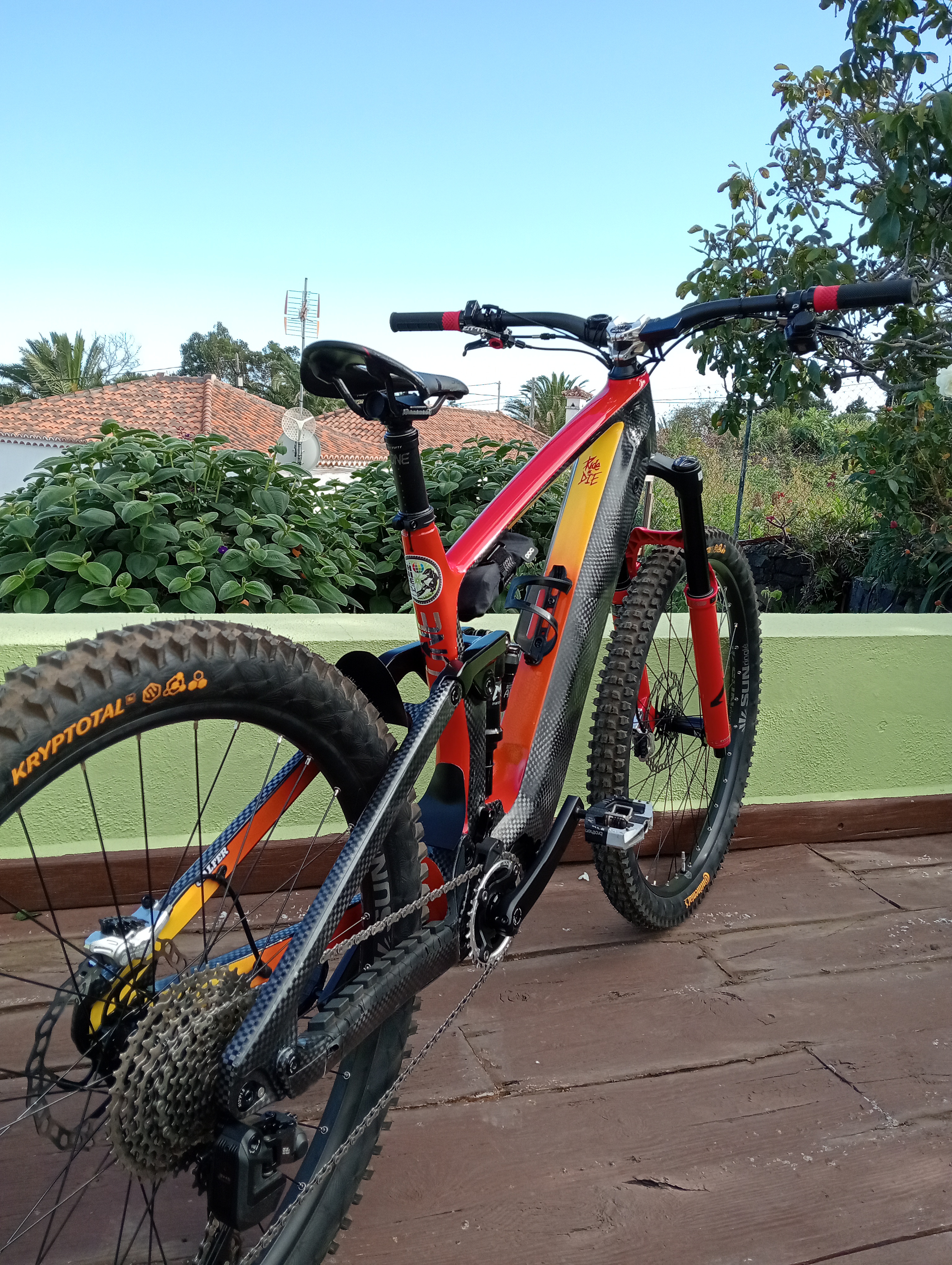

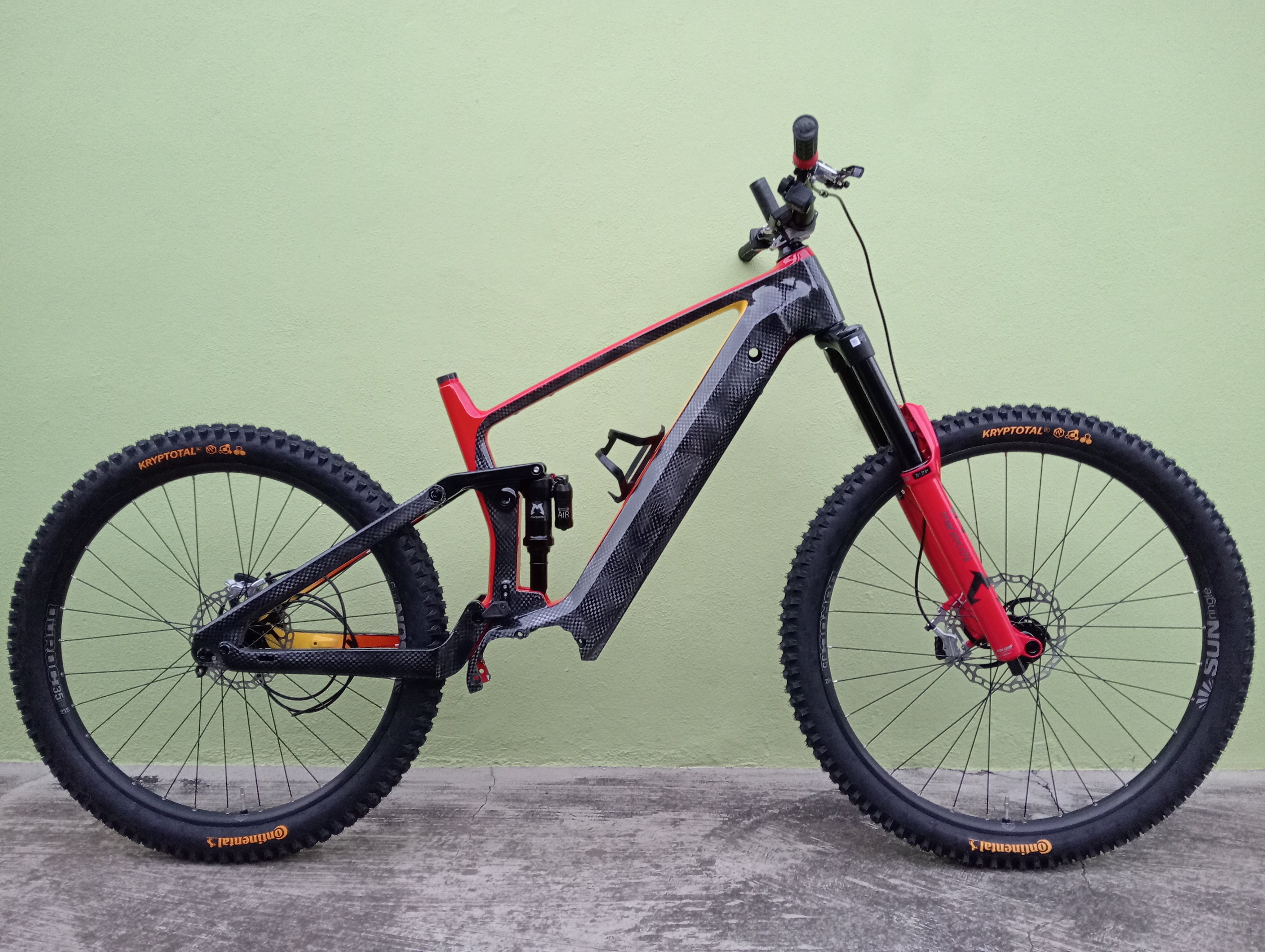

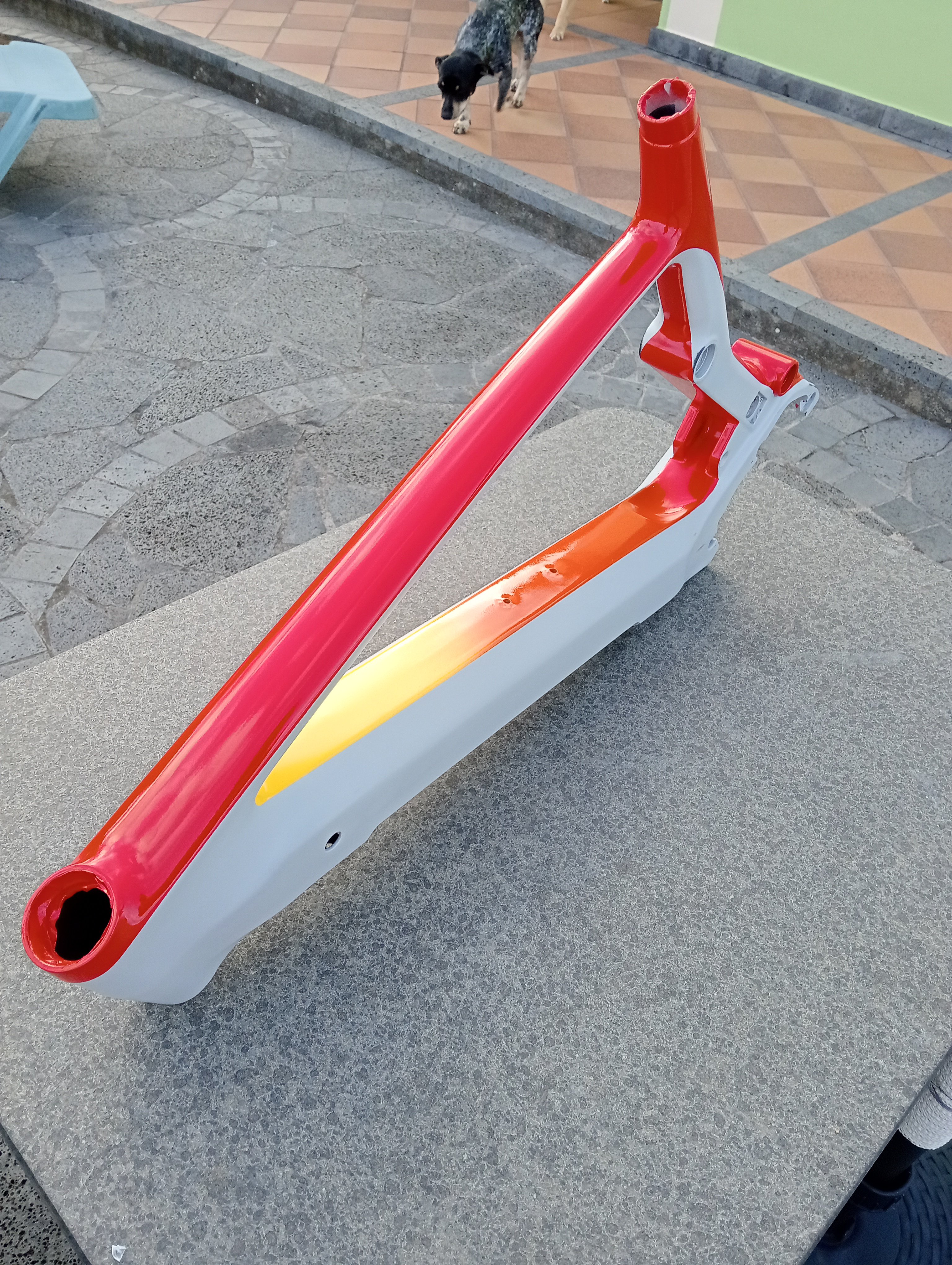

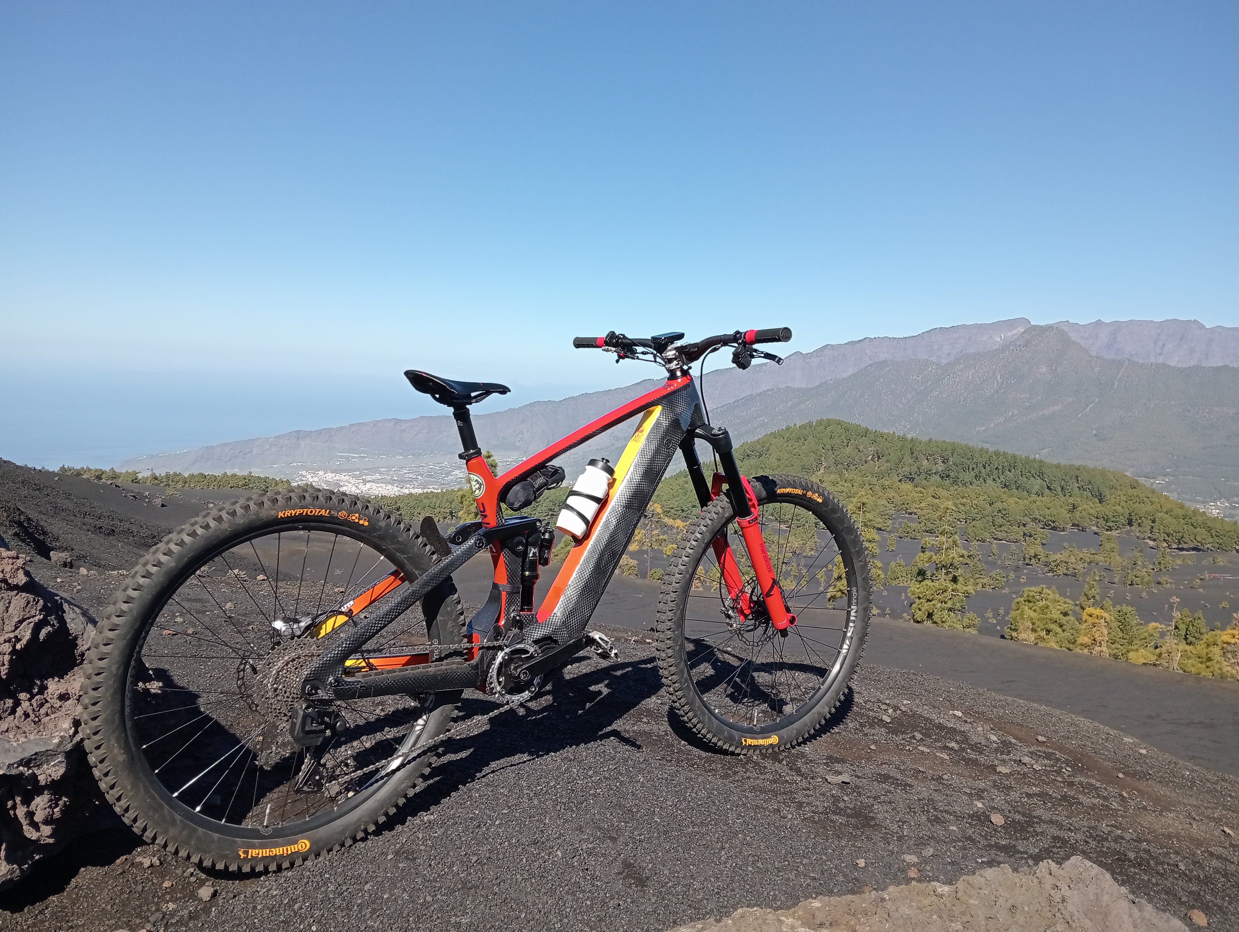

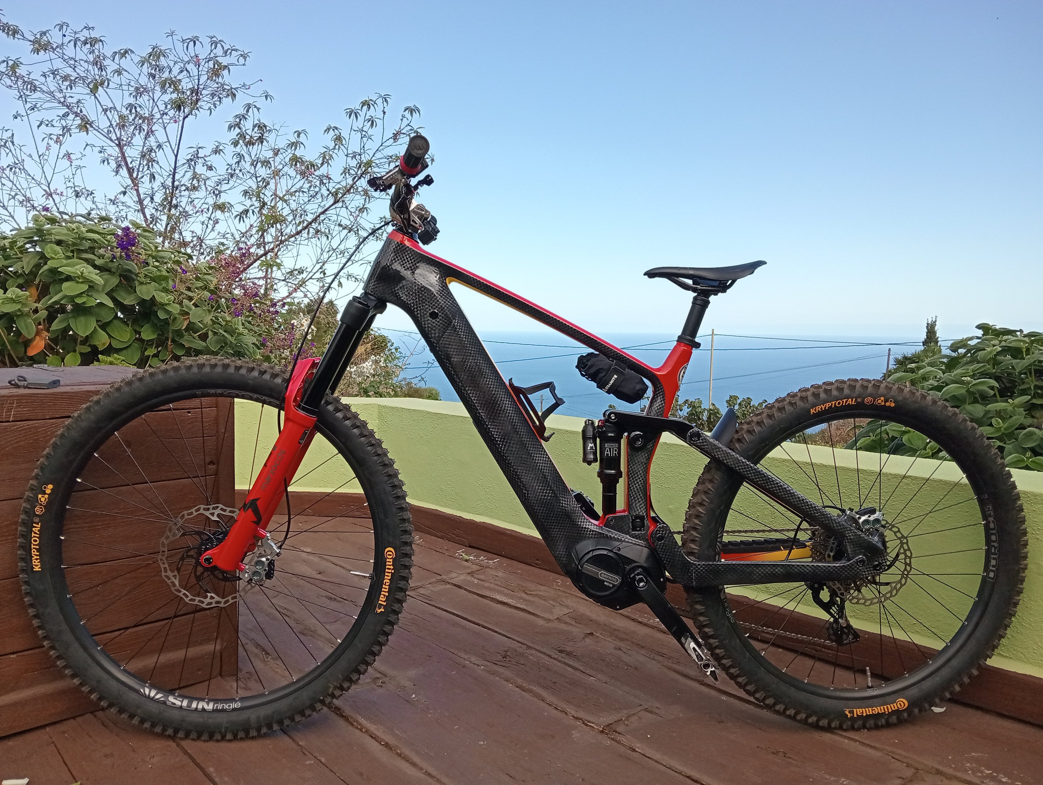

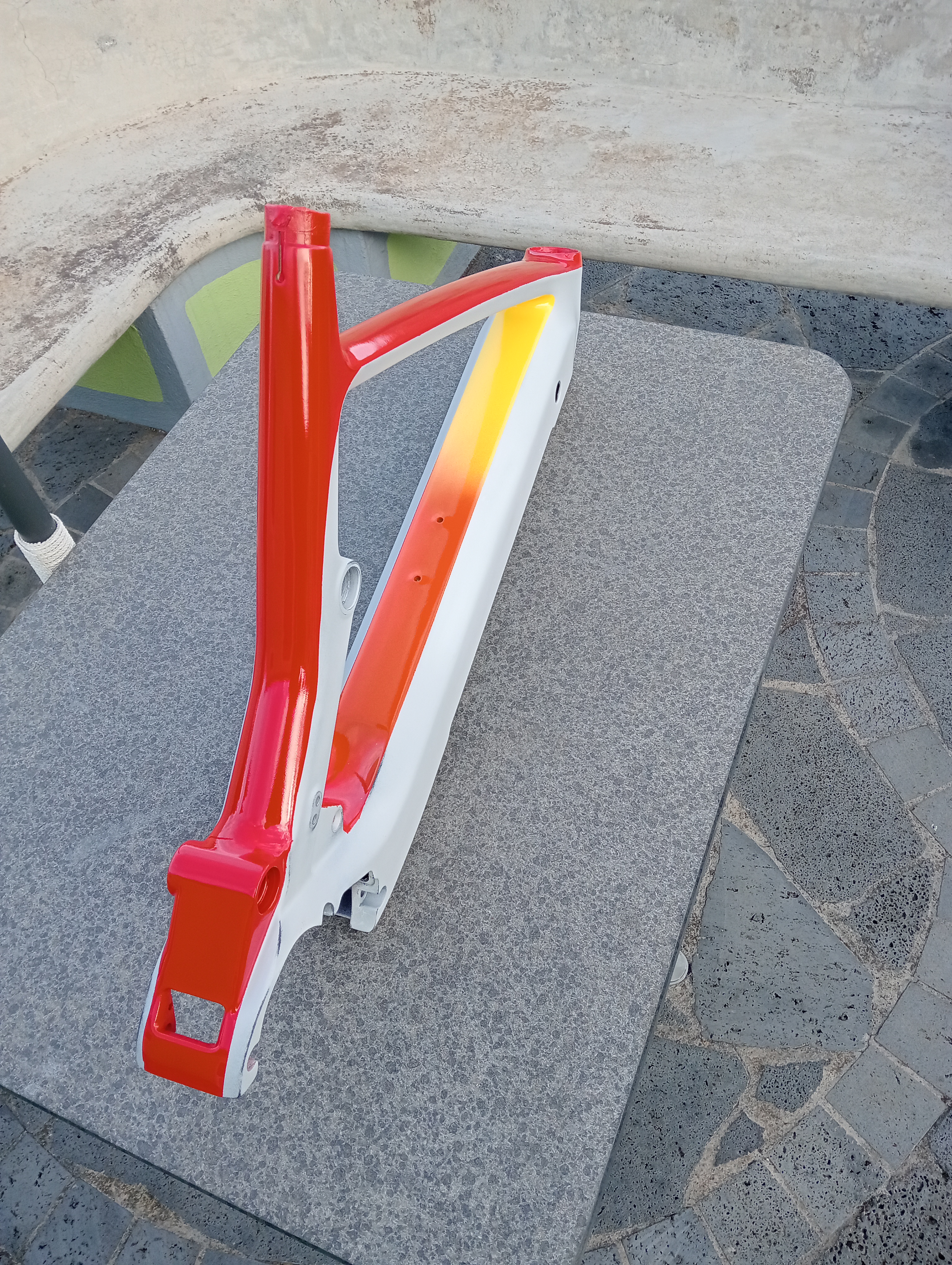

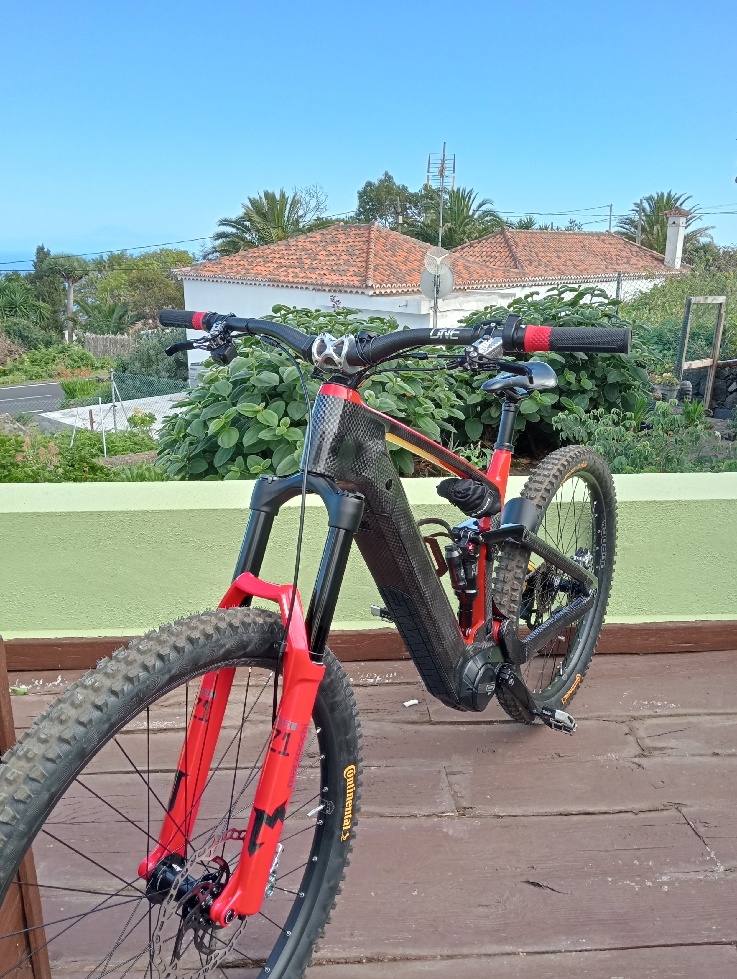

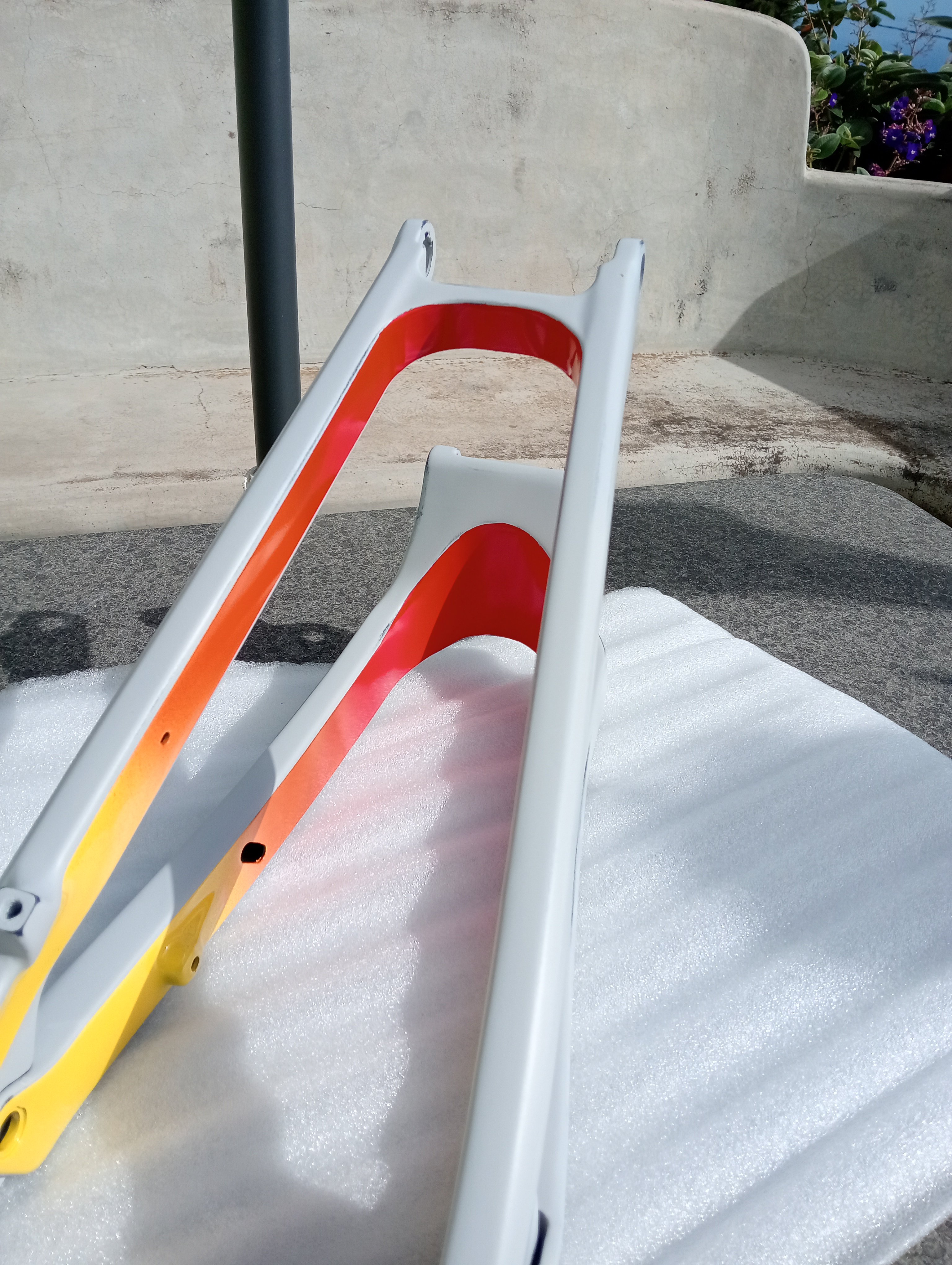

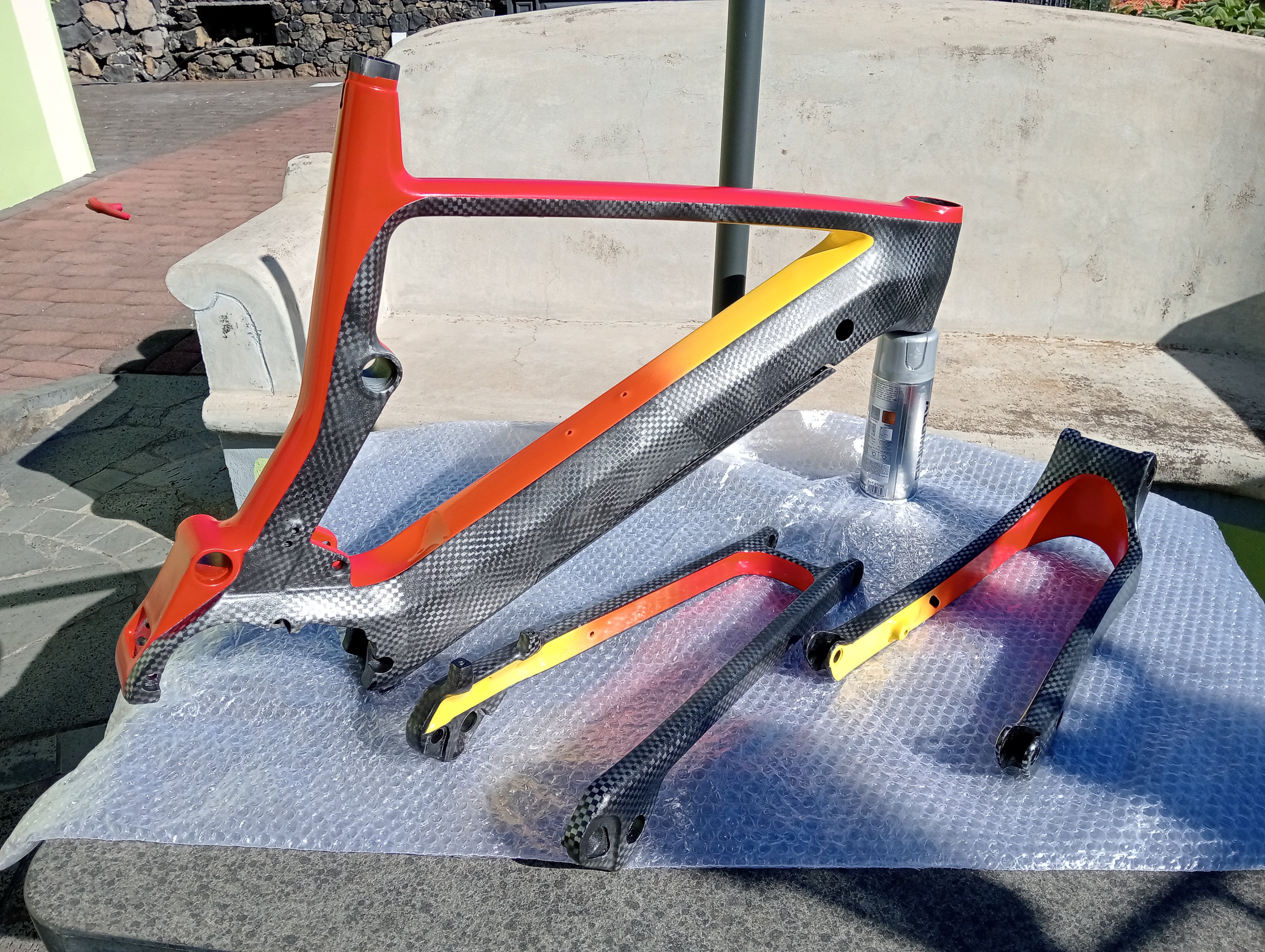

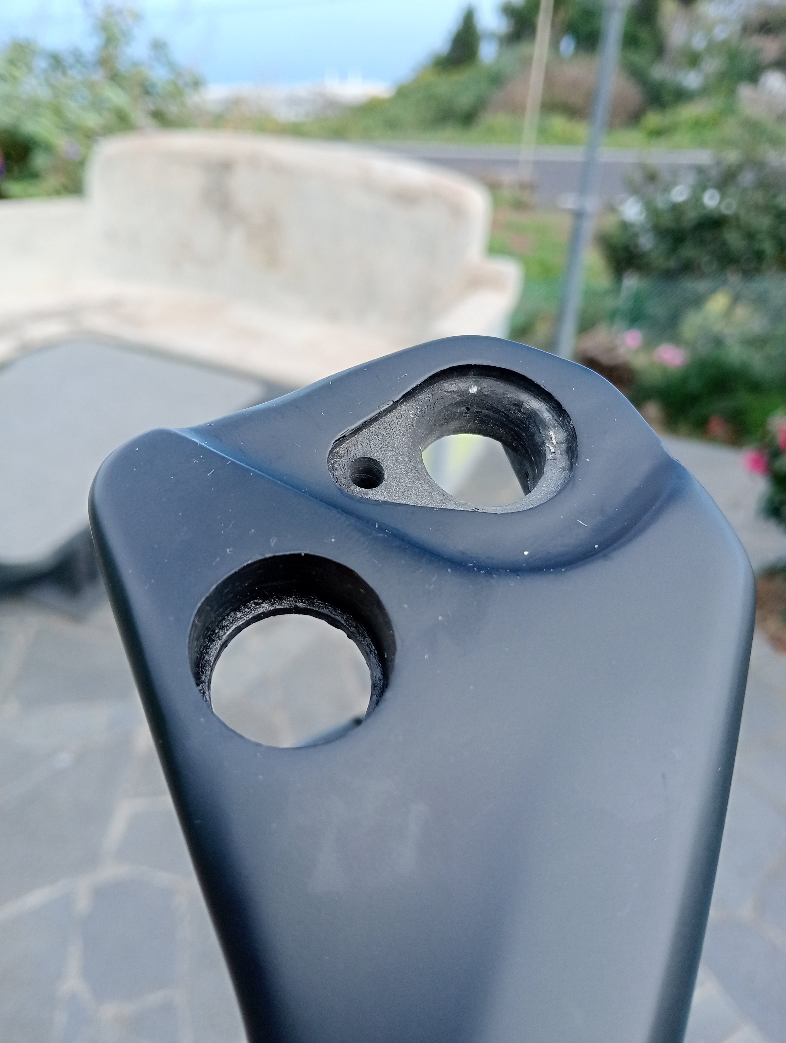

Just placed an order for a large size frame; dealing with Tars @Fieldebikes was smooth.
Now I'll have to wait about a month for them to ship it because it's out of stock, plus a 40/45 days to deliver it at my front door.
Will build it with Marzocchi Z1 170mm and Bomber Air shock in a mullet configuration, IIIPRO brakes (really want to give'em a try), M510 motor and 840Wh battery.
Ordered in raw finish and I'll paint it by myself.

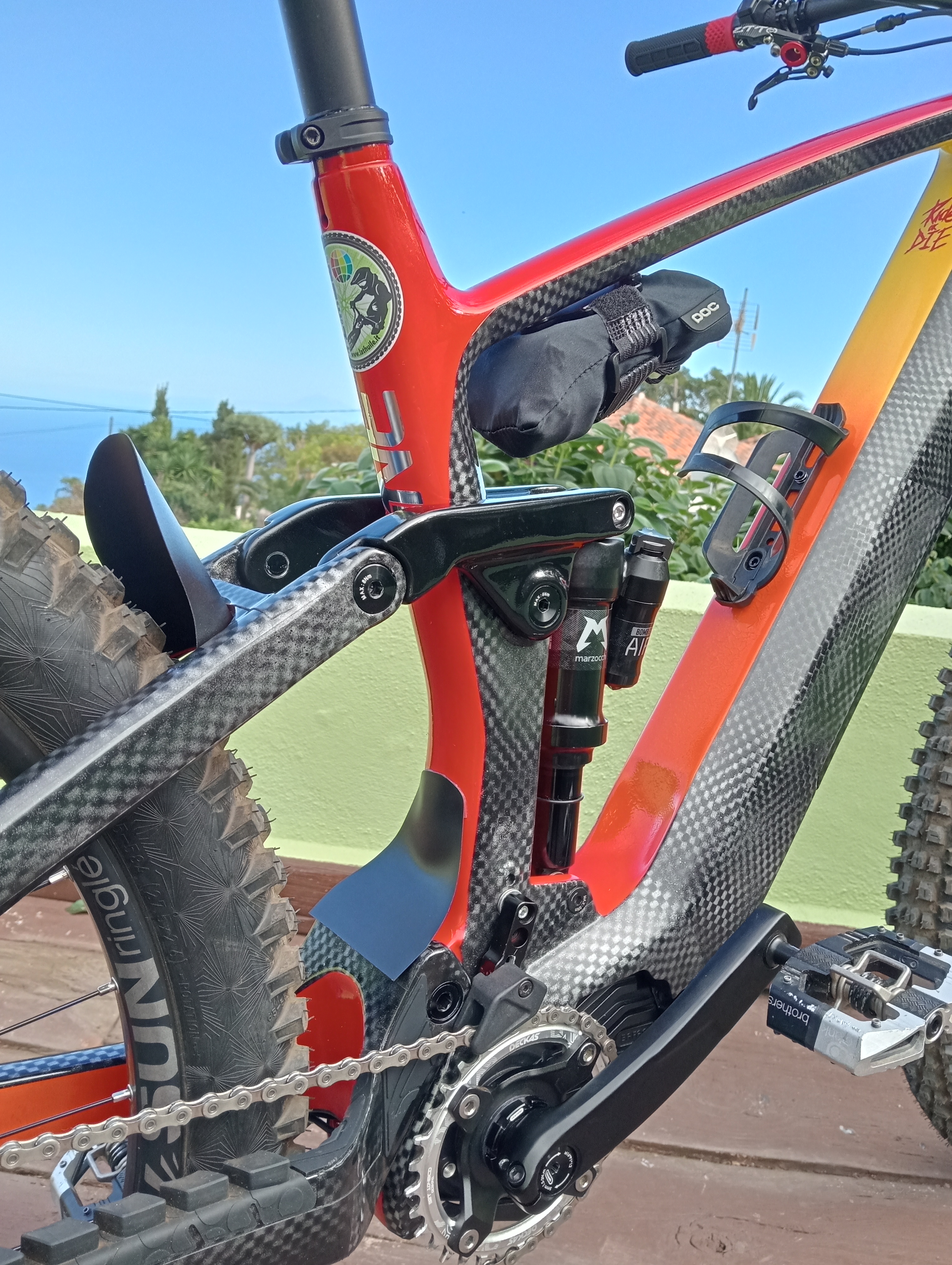

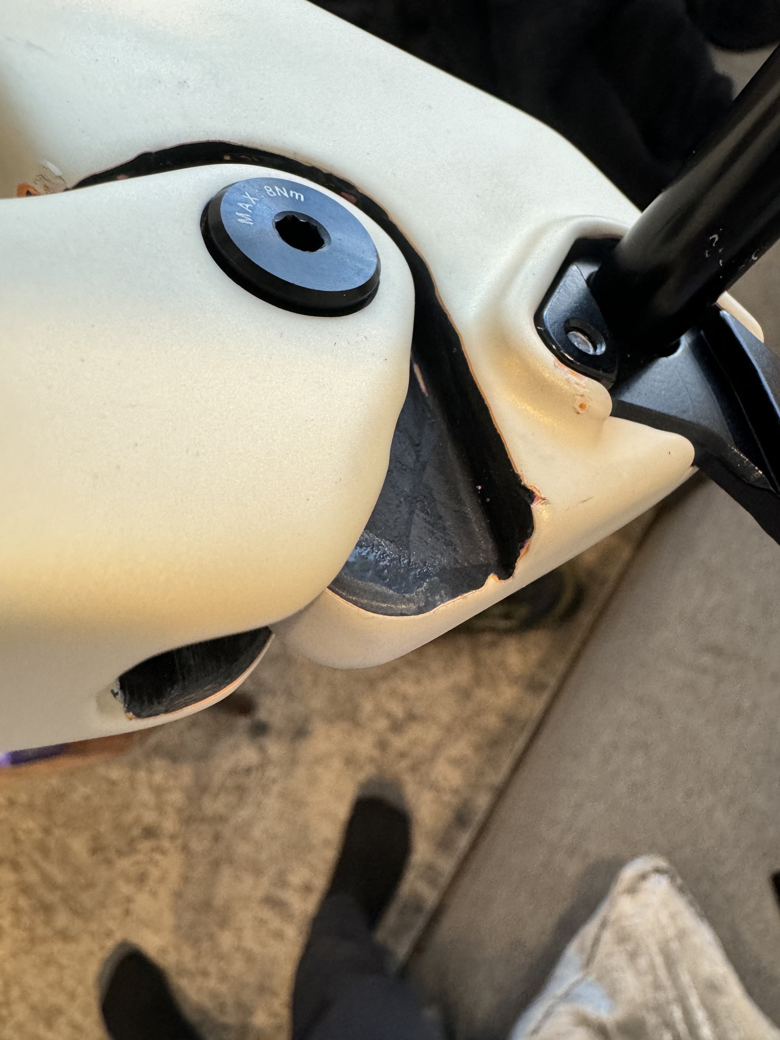

The paintchips around the linkage points look sketchy tho, did you overstroke the frame? because it look like it hits the frame / linkage
