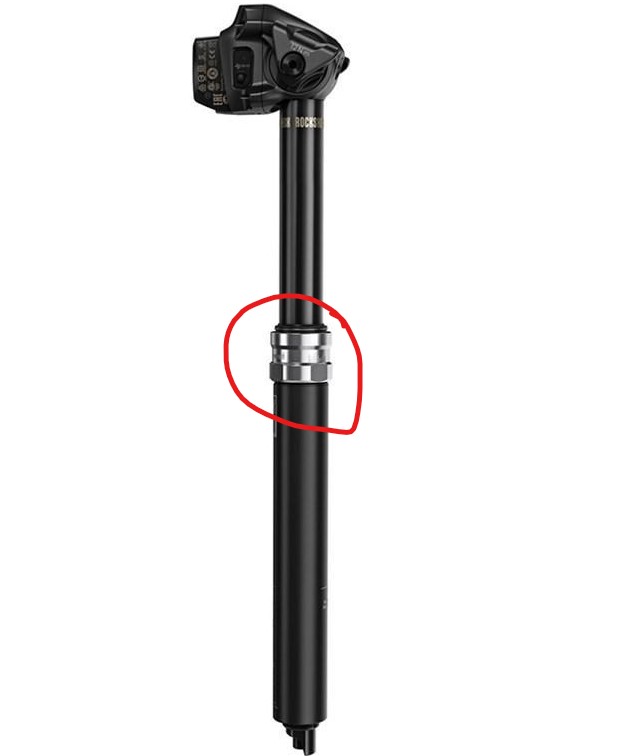

Again. I once got this away by cleaning and greasing every parts of that section.
Now i have done the (seat collar is one i haven't touched yet) same things as before, noise don't go away.
It only happens when sitting and pedalling. Stops if i move my butt forward. Sitting on the nose of saddle and it's quiet.
Pedalling off the saddle and it's quiet.
Could it come from the dropper internals? 9 months old dropper, about 4000km ridden.
What is also strange is that collar comes loose from time to time:

The noise coming only when sitting and pedalling, and then going away when you shift your weight forward, sounds to me like its just a loose seat post clamp. Remove the reverb, clean it out down there, and then put it back in and re-torque the clamp would be my suggestion.
I cleaned everything and lubed. Again.
Seat post clamp was tightened 7Nm, it opened at 5Nm. So it was little loosened.
I started my ride after that and bike was quiet. After an hour noise was back! :LOL:
When i got home the AXS top cap was loose. So i opened it, put some threadlock. I put threadlock to the seat post clamp bolt also.
This morning i rode 1h and 10mins, quietly. Let's hope sound of silence carry on..(y)
I think the noise was coming from both; seat post clamp and AXS top cap.

I might be late to the party, but my post developed a creaking noise very quickly, and I feel it would be helpful to share my experience with others.
The creaking noise occurs with every bump or weight transfer. In my case, the noise isn’t coming from the saddle, seat collar, or the aluminum collar of the Reverb. Instead, it seems to originate from inside the post itself when force is applied to both ends, as if simulating the pressure your body exerts on the saddle.
I can reproduce the creak even with the seat post removed from the bike and the saddle off.
Initially, I thought the noise was coming from the Reverb collar, but even after unscrewing it, the creaking persists. It’s definitely coming from the internal tube assembly. I expected much more from such a pricey dropper post.
The post was correctly installed and used, and I weigh about 70 kg, riding mostly on soft and jumpy trails.
