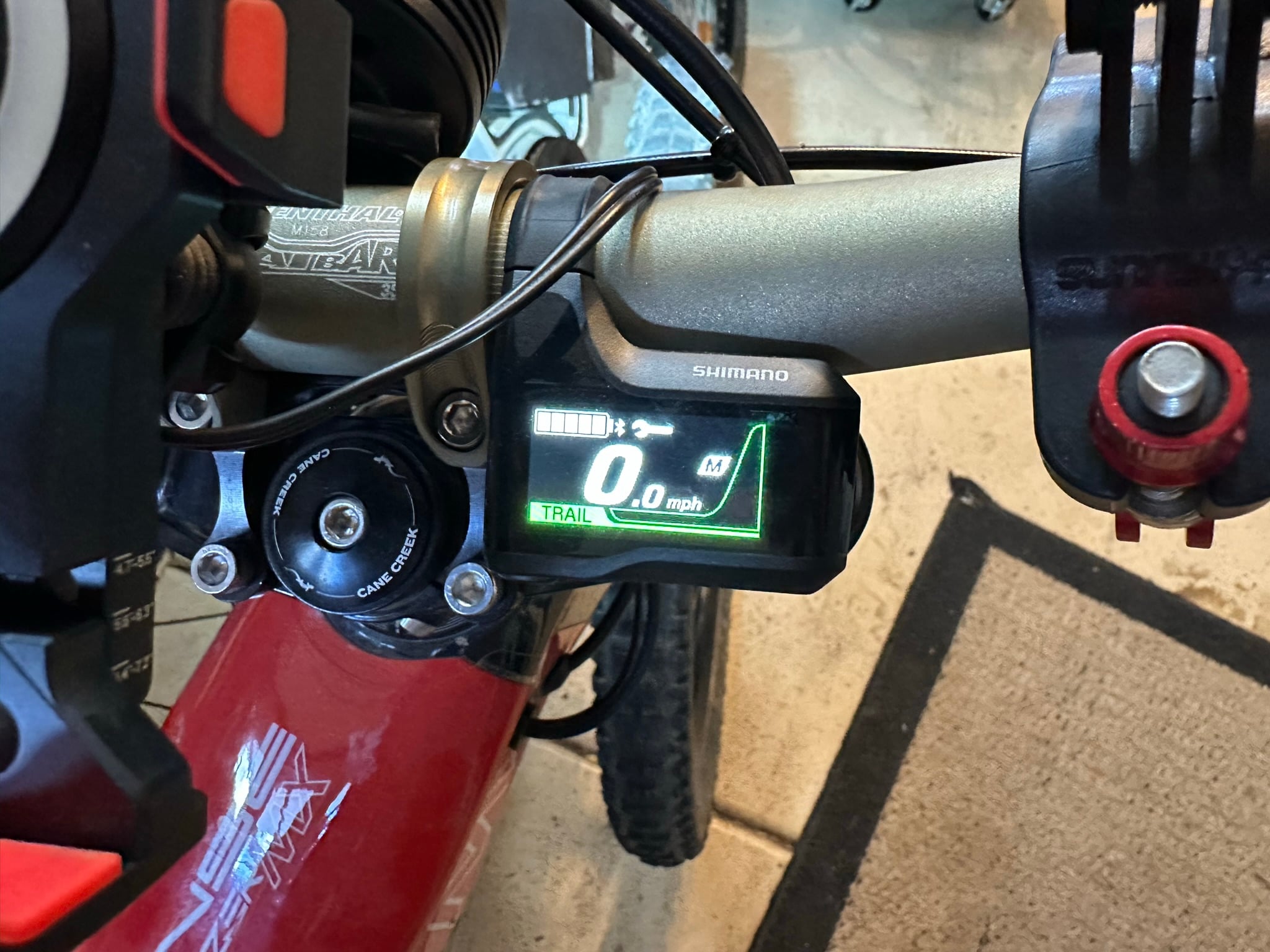

This is either a total secret, or dealer only. The latter seems ridiculous. I'm at 250 miles, and the little wrench icon appears around 13 miles ago. I can't find a way to clear it. Google it, read the user docs and dealer docs, looked through all the menus, tried various button press and hold ideas, nothing. The user doc says "visit your dealer for maintenance." The dealer doc barely references it, and makes it sound like you can only clear it using the PC interface and software.
Any other ideas?
I should say that I actually do own the PC interface, but it's horribly unreliable and it can take ten attempts before it connects at all. Windows crap. This should be something you can do with buttons, like any service indicator in a car or motorcycle.

First thing I would do is fire up E-Tube and look at any existing faults. That might provide a clue. The second thing would be to fire up ST-Unlocker. It will also show you faults, but I'm not sure if you can clear them.
Last thing I can think of is to remove your battery, let the bike sit for a bit, and reinstall it. That might clear the fault. But if you clear it without knowing what it is, you'll never be able to spot if there is a pattern developing. There is a battery in your display, so maybe it will maintain the fault log. If that battery starts getting low, that that would be a problem that only the dealer can fix.

This is not an error or warning. It is merely a maintenance minder. Think of it like a car's oil change reminder, not a check engine light. Battery removal for a day has done nothing. I've looked through the phone-based E-Tube app, and there are no errors, only the maintenance minder. In the E-Tube ride app, you have to acknowledge the reminder often, which is annoying.
I haven't done anything with the PC connector and E-Tube dealer app since it's always a huge pain in the ass. And 99% of end users don't own this, so the whole thing seems crazy to require a dealer app.

I saw a reset procedure for the other Bosch displays, are you sure there isn't one for yours?
The interval on mine is too short, and too long. At 250 miles I will have done the basic services at least once anyway, our environment is harsh in some ways. But I won't be doing major services for a while.
I may have to fight the stupid Windows drivers again and see what I can set with the dealer app. Any day I'm forced to fire up a Windows machine is a bad day.

I have a linkage device and it took me awhile to figure it out, it’s in the settings tab, there is one option with the motor to change the profiles and another that has the maintenance reminder options, my EP801 has a range and date, I just turned them both off.
Shimano definitely doesn’t make it easy to figure out there systems, there website sends you in circles until you click something that gives you more information.
