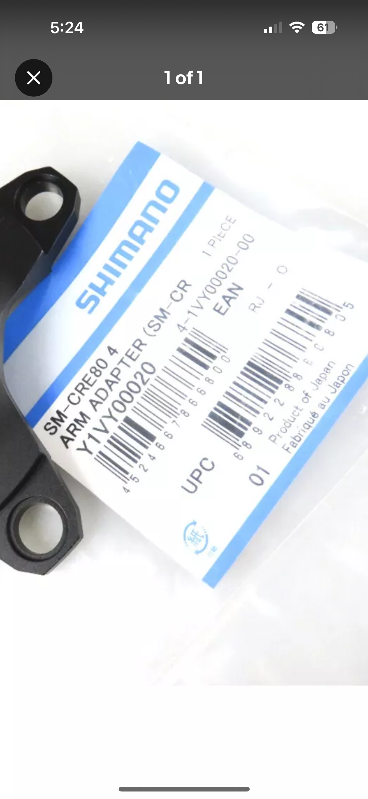

For people wanting to buy non Shimano chainrings, the spider part number is
Shimano Spider for 53mm chainline: Y1VY00020
FSA Spider for 53mm chainline: CR1770 (Manufacturer Part # 380-0455000050)

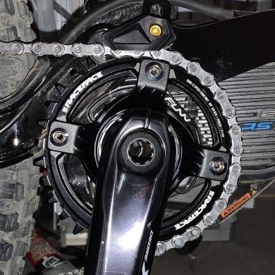

Has anyone fitted the RaceFace 104BCD 32T on to the Shimano Spider? I read in another forum that they are not compatible. Would really like to know. Thanks.
It will bolt up (104bcd), it just looks weird as the shimano spider's inner wings only look flush when using a shimano chainring. The RaceFace 104BCD 32T chainring for Shimano 12speed has a different profile on the tabs so looks like there's a gap.
Here's what the RaceFace 32T Shimano 12s chainring looks like on the FSA Shimano EP8 spider. Lighter too - 136 grams vs 176 grams).

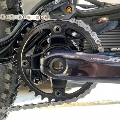

Shimano spider with 34T Chainring for Shimano 12-speed (SM-CRE80-12-B)
FSA (W0154) w/ 32T RaceFace chainring (104 bcd, for Shimano 12-speed)
I kept the FSA setup as replacement chainrings for Shimano are unobtanium (Y0KJ34100) right now and it's lighter.
