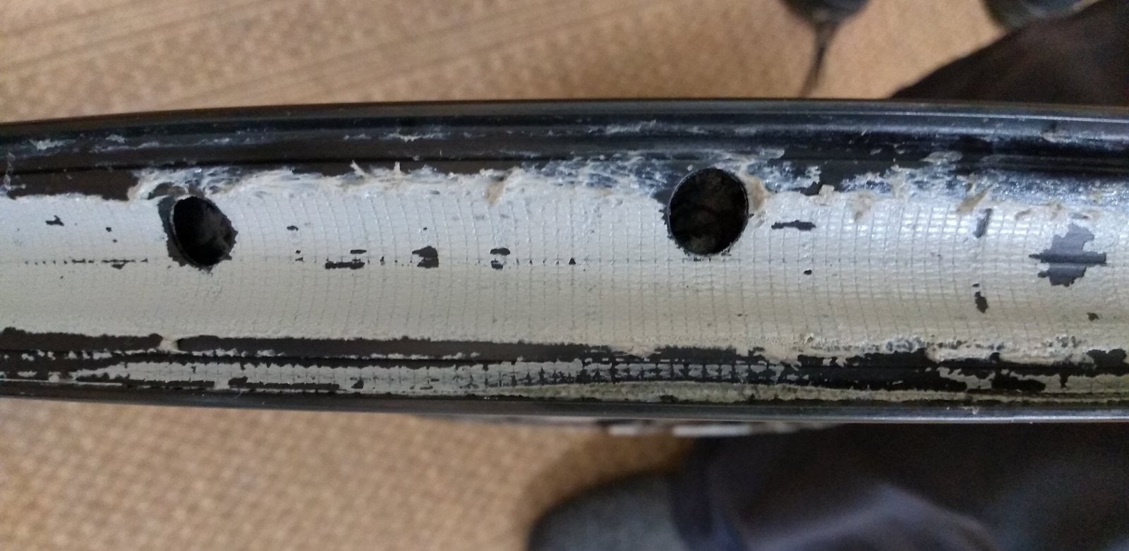

I thought you might be interested to see what I'm on about.
I have already made a start on removing some of the adhesive residue from where the tyre bead sits at the top of the picture. But not at the bottom. You can see that the offset spoke holes in the RaceFace AR30 rim alternate from just a bit off-centre to almost breaking through into the gully where the tyre bead goes. Not sure how I can seal that close spoke hole without also laying a layer of rim tape on the bulge between it and the gulley.

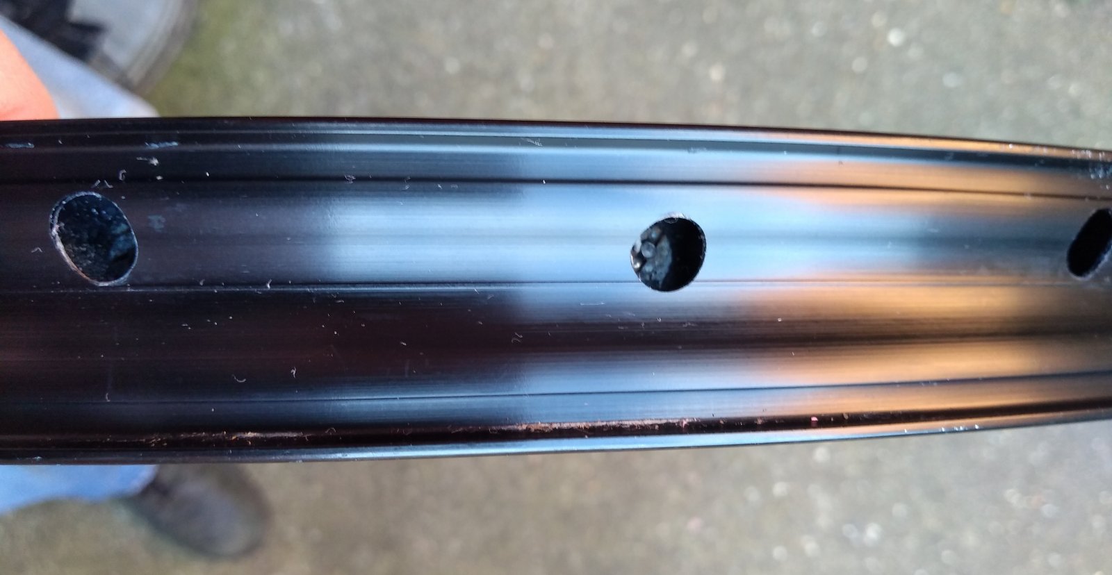

Wow! That petrol and rag solution that @Cisco proposed really worked! (and @#lazy later, which I didn't see until this morning).
After 90 mins laboriously picking it off with Sellotape and only managing less than 25%, it took me 20 mins to do the rest with petrol and bits of old cut up Terry towel. At first it doesn't look as though it isn't going to work, but keep rubbing and keep the towel wet with petrol and suddenly, off it comes!!!! Yey!!!!!!
Here's before and after pics.
Those tiny white bits are just fluff from the towel. I haven't wiped over with iso-propyl alcohol yet.
Do it outside though, I feel a bit sick from the petrol fumes - can't imagine how bad I'd feel if I had done the job in the garage.
Oh, and wear washing up gloves, the vinyl ones are too fragile. I think the petrol affects them.
Now I have to wait for the proper rim strip that Rob and others recommended.
Many thanks everybody for your help, without it I'd probably still be picking away with Sellotape.
