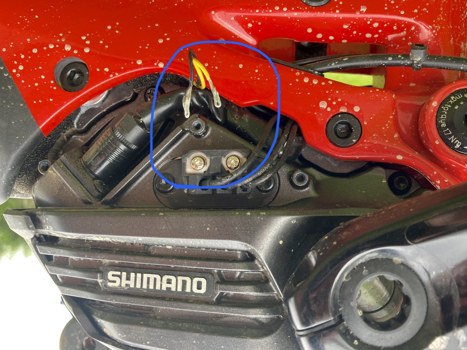

It’s not a hard job, but you do need to loosen the motor bolts, as its the yellow and black wire that is screwed into the left side of the motor under the plastic cover.
Also loosen the 4 water bottle frame bolts as the cable runs through some cable keepers held by them, easily seen if you remove the battery, and its all one cable that goes from light to motor.
I flipped my Bike upside down and removed the 4 forward motor bolts, and loosened the rear two to allow the motor to pivot as the wires are wedged between the frame and motor. All up takes about 15 minutes
PS you may need to remove the chain ring to allow you to get to the right rear motor bolt.
Hope this helps

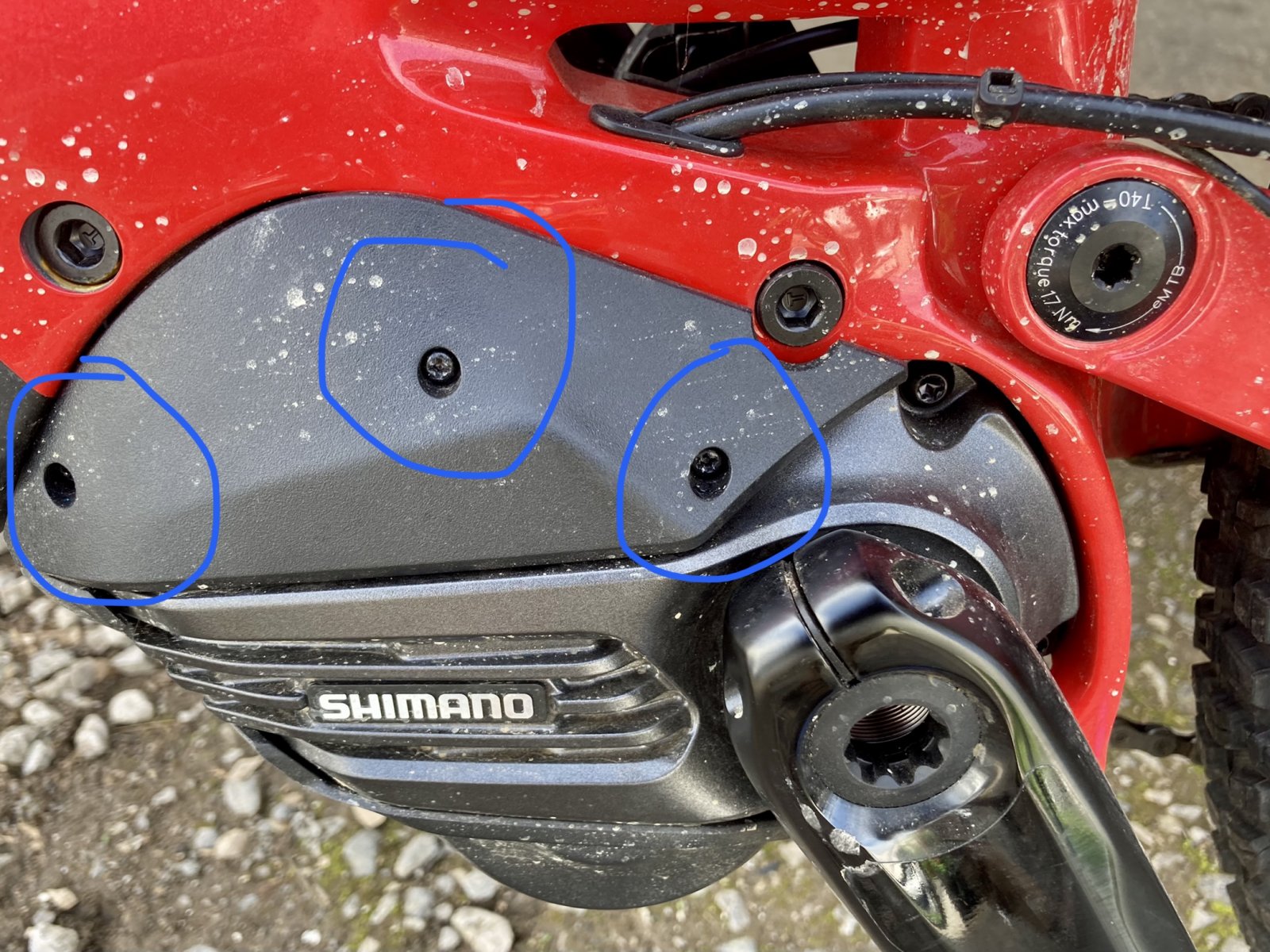

I did this today and it was easier than I thought. Just remove the small plastic cover on the non-drive side of the motor, then undo the 2 silver screws holding the cable. Pull the cable back through (you’ll need to loosen the 4 bolts holding the cables on the inside of the downtube). Put it all back together, job done!

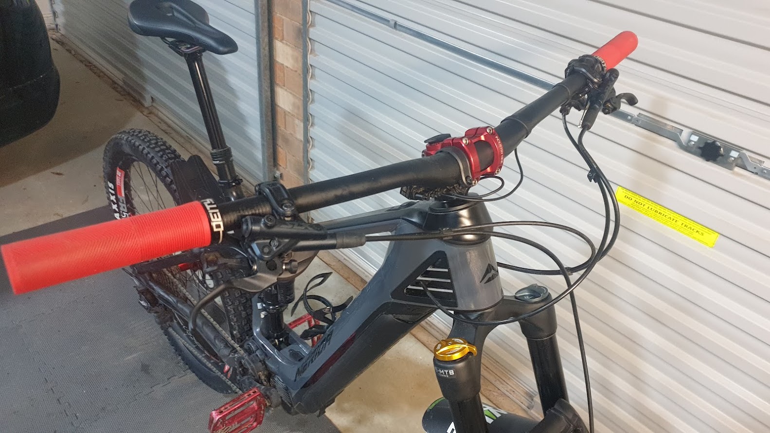

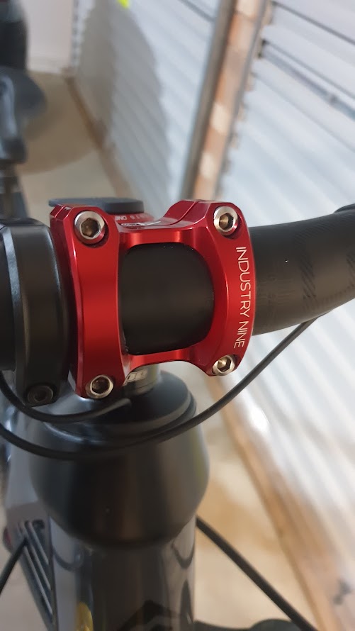

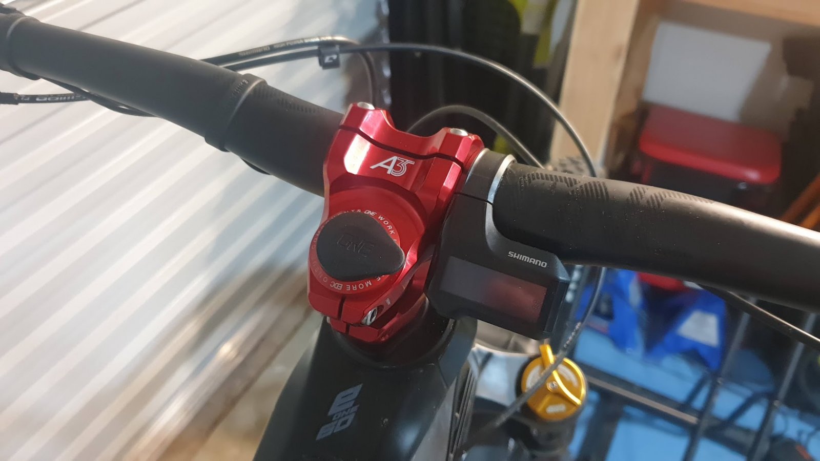

Finally the light, stock bars, stem and spacers are gone!
Hope stem spacers
Industry nine 40mm stem
Oneup Carbon bars 800mm
Shimano cable holders for the mode switch
