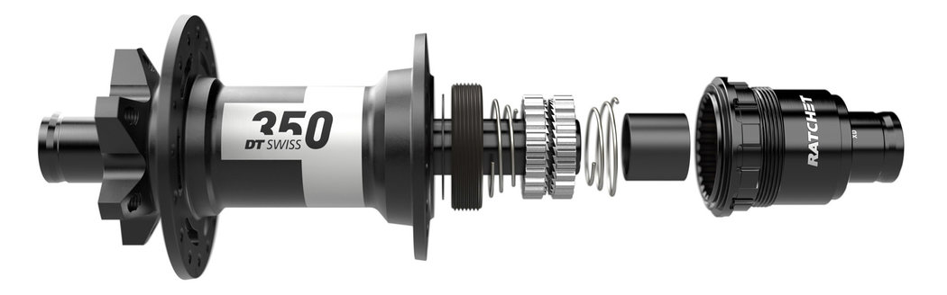

It's been my experience that D.T. Swiss hubs and the star ratchet design on the D.T. Swiss freehub/driver is pretty much bullet proof. The 350 hub can take a lot of abuse. I have one set of wheels with D.T. Swiss 350 hubs which have over 9,000 miles on them. Lastly, I like that you can find good deals on 350 hubs which won't break the wallet.

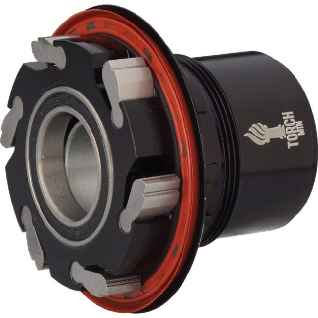

Industry Nine uses an alloy freehub housing with pawl pockets machined into the alloy freehub carrier. Both the Hydra and 1/1 freehubs hold six engagement pawls. The freehub pawls rotate in pawl pockets and engage the hub drive ring when you pedal.
Industry Nine Hydra Freehub Industry Nine 1/1 Freehub

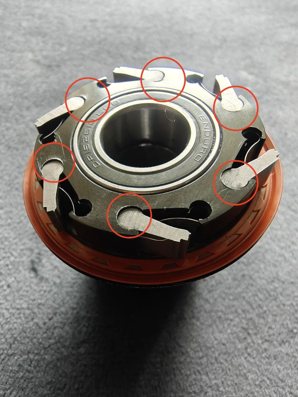

It's been my experience that after about 2,500 miles of hard riding, the pawl pockets in the alloy freehub carrier will start to deform due to the stress which the motor places upon the freehub and pawls. Gradually, the deformation of the pawl pocket will allow the pawls to shift and not engage the drive ring properly, i.e. your bike won't go. The deformation will eventually strip the pawls and or the drive ring and the freehub will need to be replaced.
Deformed pawl pockets

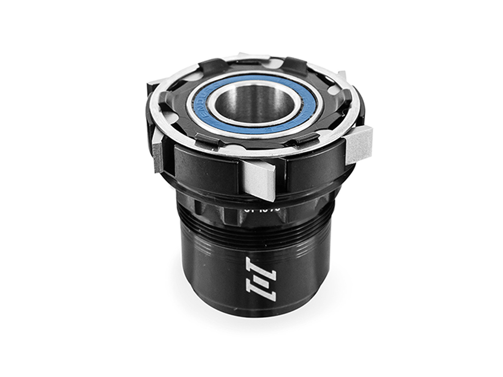

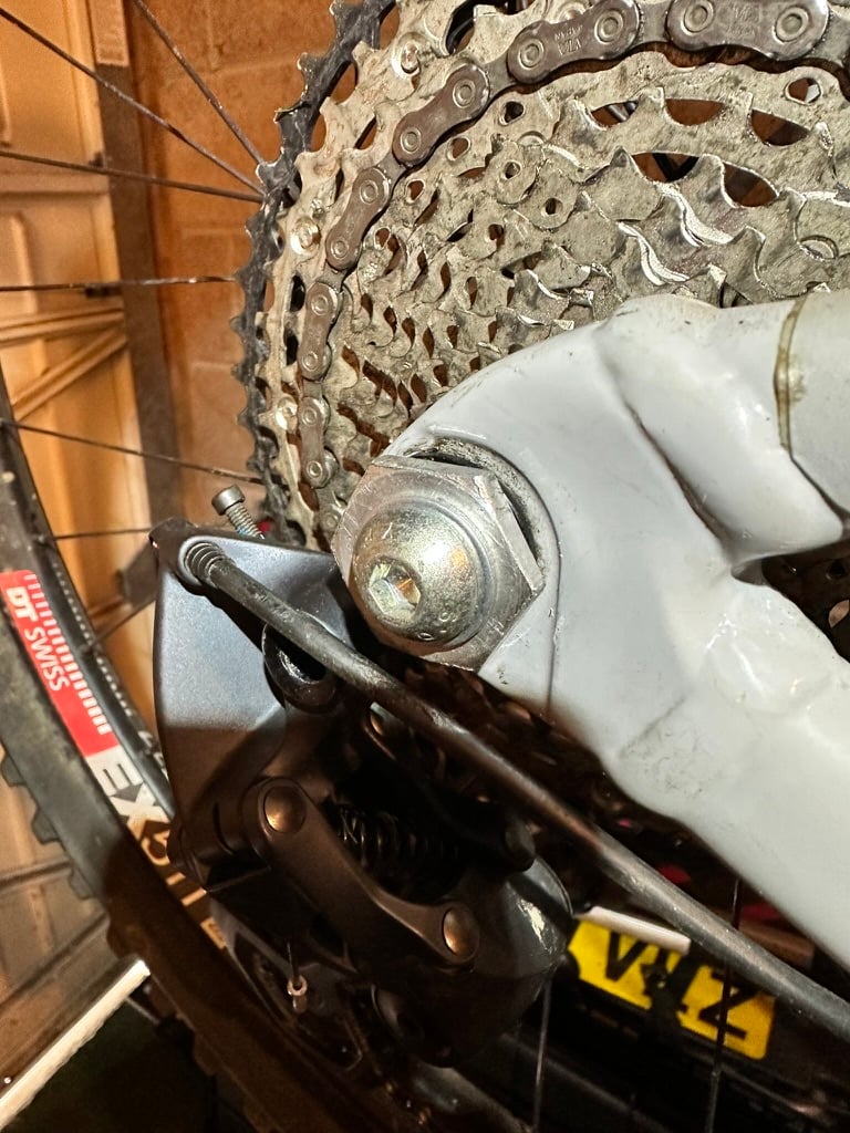

Only way I've found to ensure a reliably reliable rear hub is to have a custom machined solid bolted rear axle to stop the flex. Solid Stainless steel preferably, or solid alu as a backup. Currently have said axles in my Pro4 and Pro5 Hope hubs as they shat themselves spectacularly on many occasions over the years. Held with M8 bolts.
Bolts for most recent caused some headaches as hanger is UDH, but we found a way.
It's the flex that kills freehubs/bearings mostly I believe.
I'm very interested to try Xeno Hubs | King of the Mountain , but proprietary discs and cost put me off.
I have broken every single hub i have ever used on any bike, normal or E, mostly freehub/pawl/ratchet ring or freehub bearing failure related. Mavic, Hunt, DT Swiss, Hope, Nukeproof, Stans, Formula, etc etc. Failures just happen faster on the eeb. I'm not THAT heavy (115kgs), but me + quite strong legs + tall/long cranks = lots of leverage and it seems to cause issues that my riding colleauges don;t have of similar size weight. I must pedal wrong!
As above, solid axles stop the flex and prevent failures, but you do need to keep an eye on the drive side hub and inner freehub bearings as they are taking the abuse. As per Rod B.
View attachment 140776 View attachment 140771
Those itty-bitty pawl pockets that hold the itty-bitty pawls showed serious deformation on my Acoustic Bike. It was considerably worse than in your picture, but the hub still worked when I sold the bike.
I'm not a fan of the Industry Nine Philosophy, where only one pawl engages at a time. They claim their "one pawl engagement" is superior because their hubs are noodly and deform under load so that all the pawls engage. Maybe I'm too old school, but I still believe that rigid, precisely machined hubs are inherently superior. The Noodle Hub Concept could be the cause of broken axles on Industry Nine hubs.
