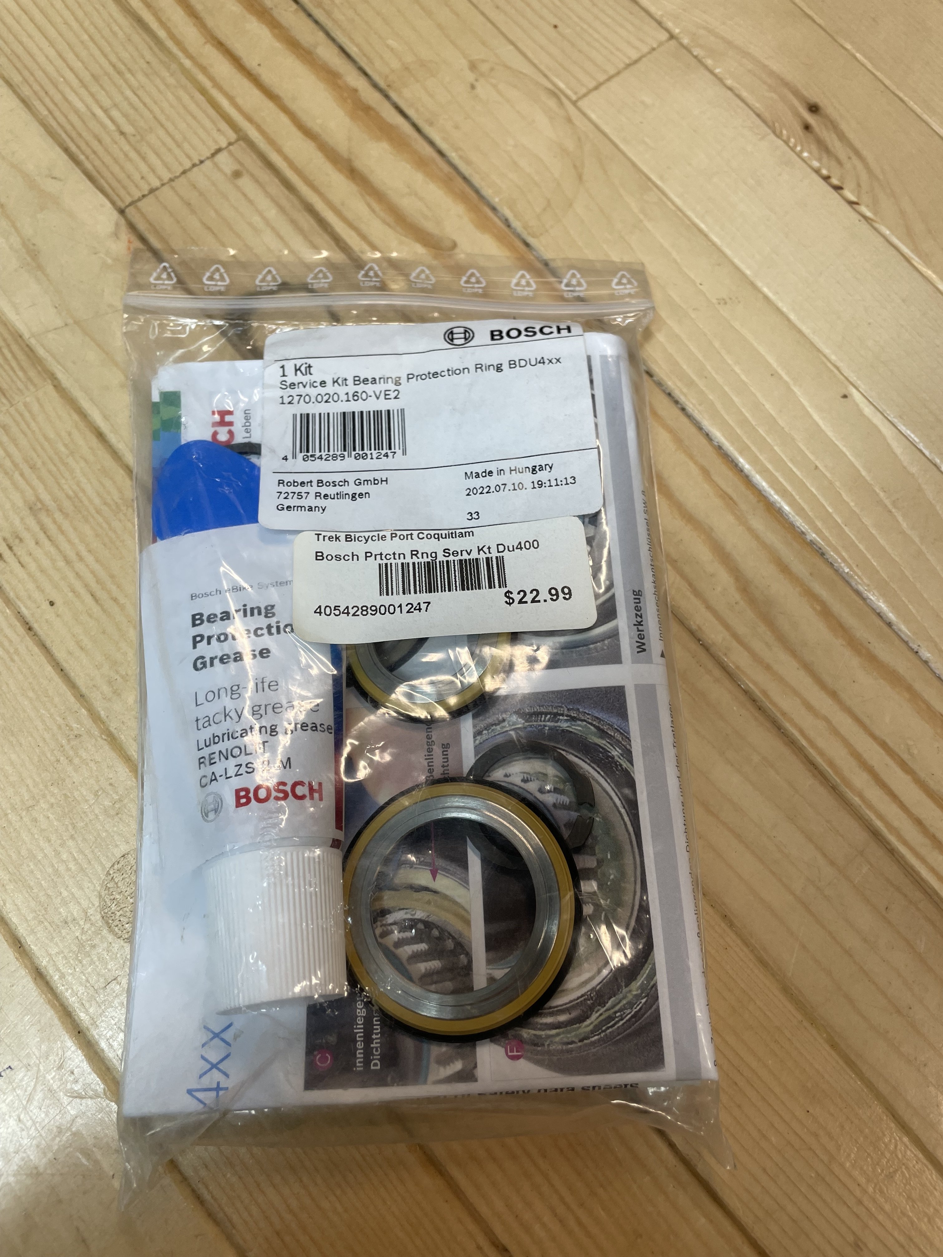

I recently installed the bearing seal kit which provided some waterproofing grease. The crank bearings seemed good at this time so I didn’t/couldn’t repack grease into those. I hope I can ride a few more thousand miles before this motor fails, but when it does I’ll go to plan “B”.
I probably could’ve installed a bearing seal kit earlier. It’s not too difficult if you have the right tools and I don’t think it would be too expensive if the LBS did the job. (1/2 hour to 1 hour labour, plus parts).

I have a bearing seal protection kit to fit as soon as the warranty on my motor runs out next month.
It is both rocky and can be very wet where my mates and myself ride in the Peak District/Derbyshire Dales and I guess that may account for the high motor mortality rate (almost fifty percent of us) in the last few months.

Good idea for a bearing seal protection kit. I’ll probably get another kit to hang on the wall.
