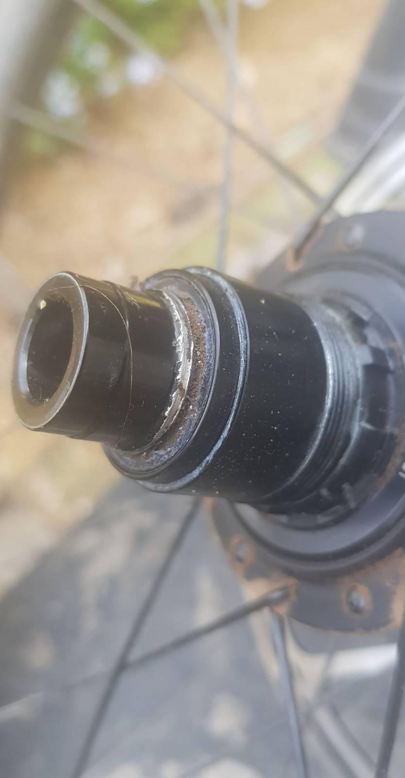

  3. rear wheel hub seems getting shredded ( see my hub pic, I checked mine as a friend with Rail got his completely broken and replaced under warranty )
To me it seems a lot of stuff going bad, not due to crashes, comparing to my old bikes. So, Is this what to expect, some part to break every month ? or is this only my bike ?

That rear hub looks like possibly your rear axel came loose. An issue reported by many here. i have been checking mine and no problems. however I did have it happen on my 2020 Trek Fuel EX 9.7 that has basically the same hub?
Did you replace it under warranty ?
So, Reliability not so high, If axle getting loose and hub fail is common ?

My FUEL EX hub/axel did not need replacement. During my normal 1 min. hardware check i noticed a little play in the rear wheel when i was pushing on it. I just tightened the axel.

Well, went to Trek dealer to check the Hub.
He claims "someone" (looking at me) connected the cassette wrong. No warranty, as the hub is still usable. Always nice to visit Trek, makes you feel good.
O, also I got a lecture on "don't kick the paddles to hard, as this can make the Hub go bad", cool.
BTW, I did not connect the cassette, only took it off.
