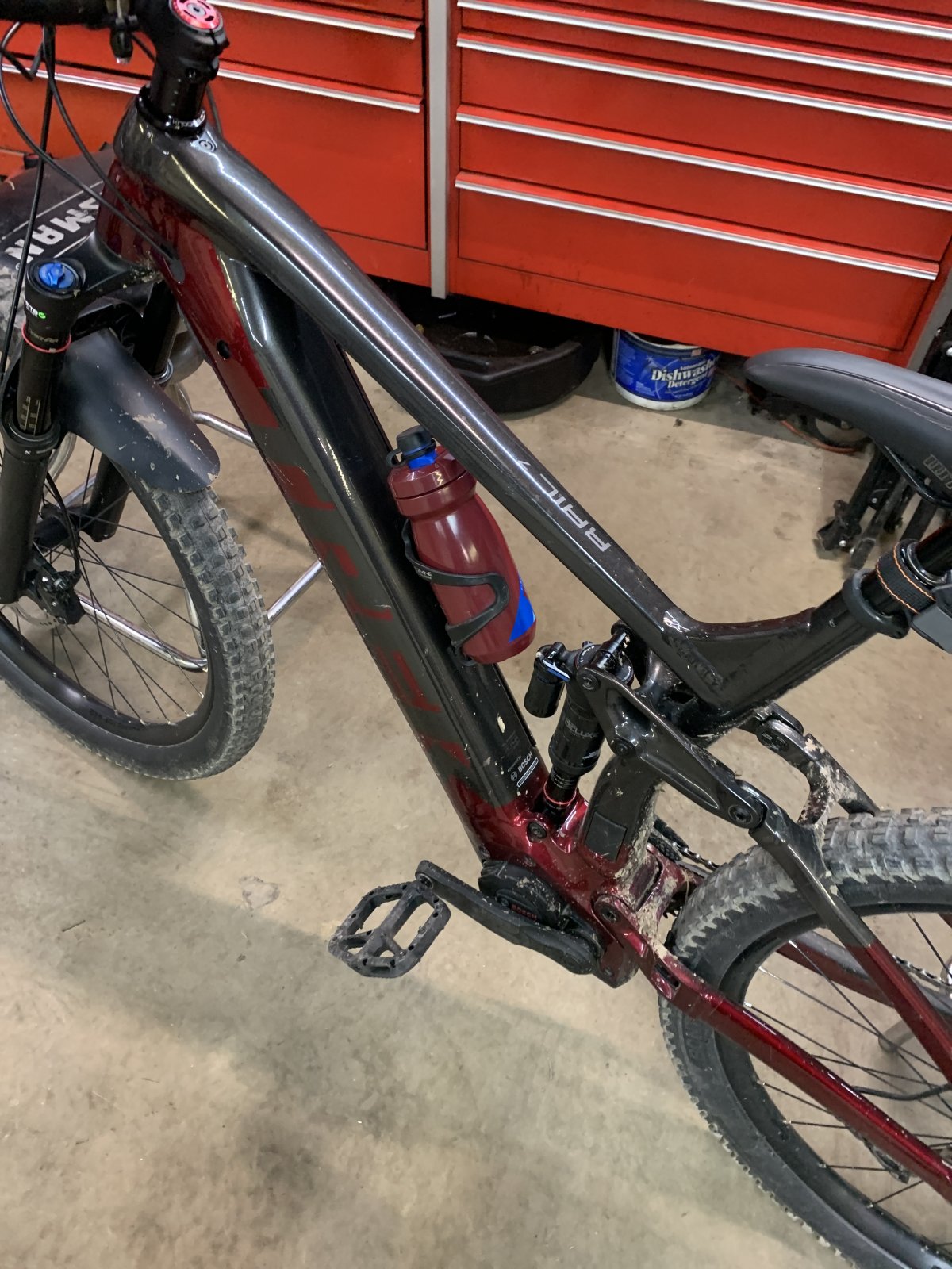

25 miles with 3 bars remaining today ?

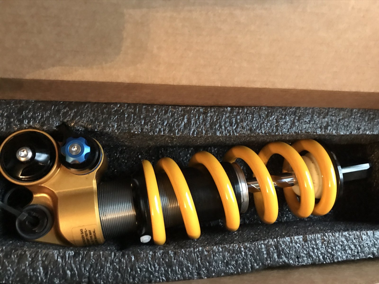

Found a new downside today; if you ride a medium or small Rail the only coil shock that fits without the reservoir clouting the frame is the Ohlins TTX 22M at over £700... :oops:
Doomanic
🛠️Wrecker🛠️
Jan 21, 2018
8,768
10,469
I guess Cane Creek Inline coil without piggyback would work?
Nope, they don't make one the right size.
230 x 60mm fits and increases real suspension travel to 156mm.
The longer stroke will increase the likelihood of the reservoir hitting the frame. Possibly OK on a Large or above frame.
TFTuned, for it was they who broke the bad news to me, have two Rails amongst their staff bikes so they should have a pretty good idea of what fits. Unfortunately, none of the conventional coil shocks with the vertical reservoir fit a Medium, only the Metric Ohlins with the horizontal reservoir, like this;
Doomanic
🛠️Wrecker🛠️
Jan 21, 2018
8,768
10,469
Oh, I'm sure I'll like it, what I won't like is paying for it! :ROFLMAO:

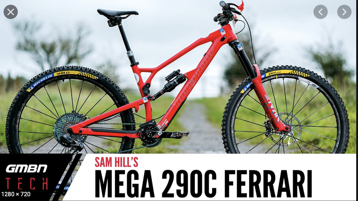

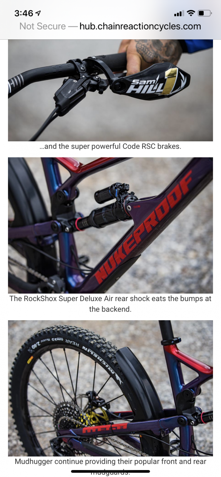

If this is what Sam Hill prefers !!! What’s with all the coil shock rage. No thank you
A lot of the RS the pros run Meg Neg cans on there Super Deluxe now, including Sam Hill and Yoann Barelli
