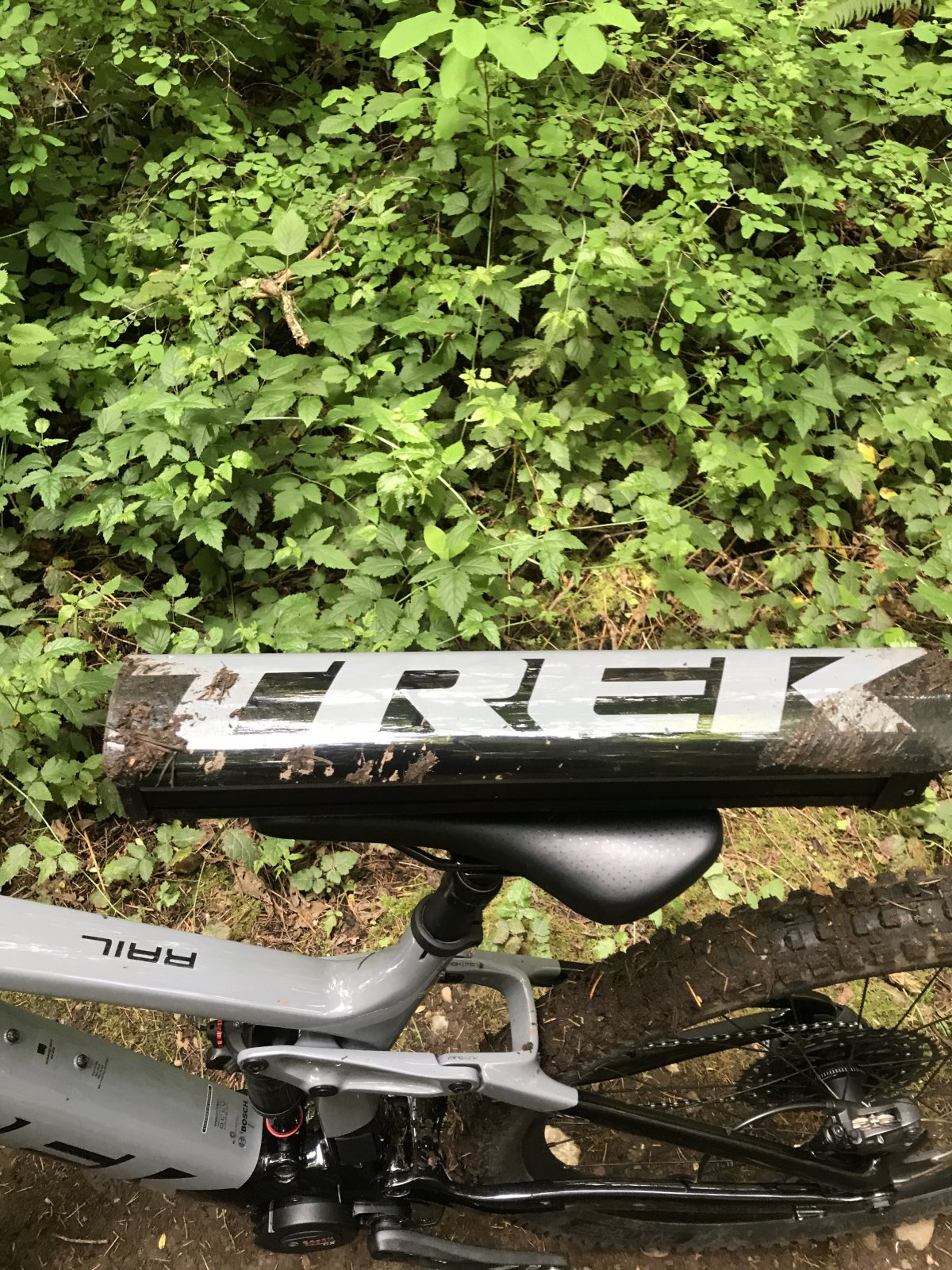

cjwally
May 23, 2020
Camano Island, WA
This happened to me as well unfortunately on my Rail 9.7. Super bummed as the battery is pretty scuffed up. Hoping that they will replace the cover. Going into dealer for warranty.
Has this happened to anyone with AL frames?
