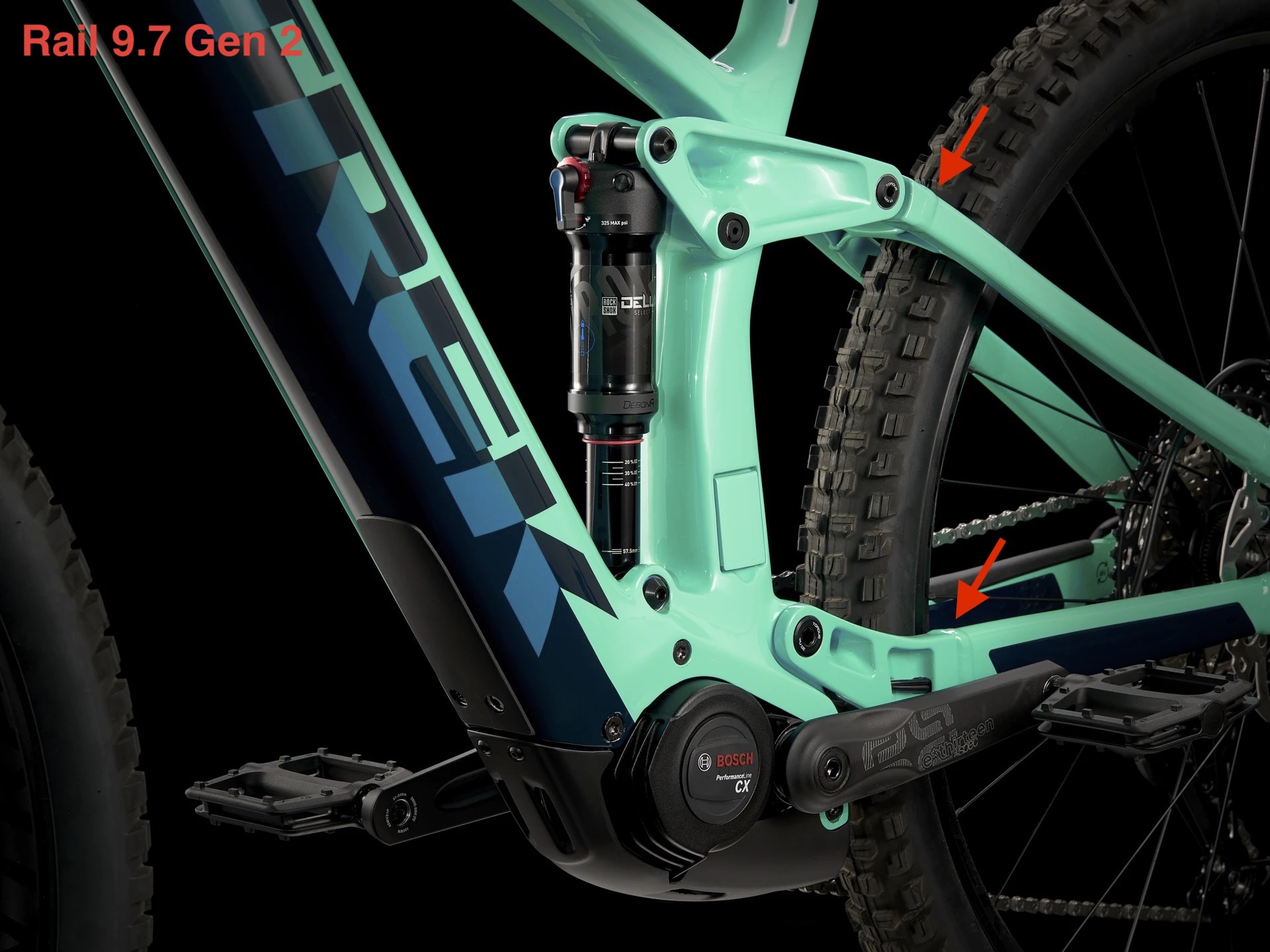

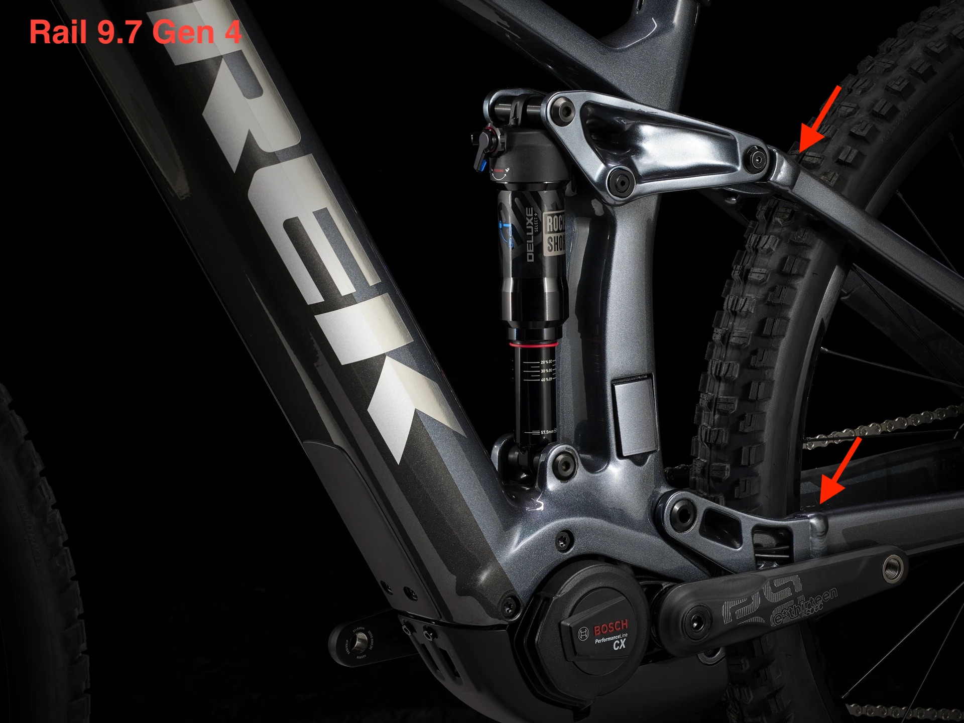

Not sure what to trust now. Could the images on Trek's own site be wrong or have they moved to alloy rear triangles at some point post 2020? Here's what is shown on Trek's site for the two 9.7s they have for sale (gen 2 and gen 4)

Yah, both of those look like alloy triangles because of the welds.
I’m not sure what the process could be for the pivot points or bearing pockets on a carbon triangle. ??
View attachment 130766 View attachment 130767
Specifications change all the time so pictures may tell a thousand lies.

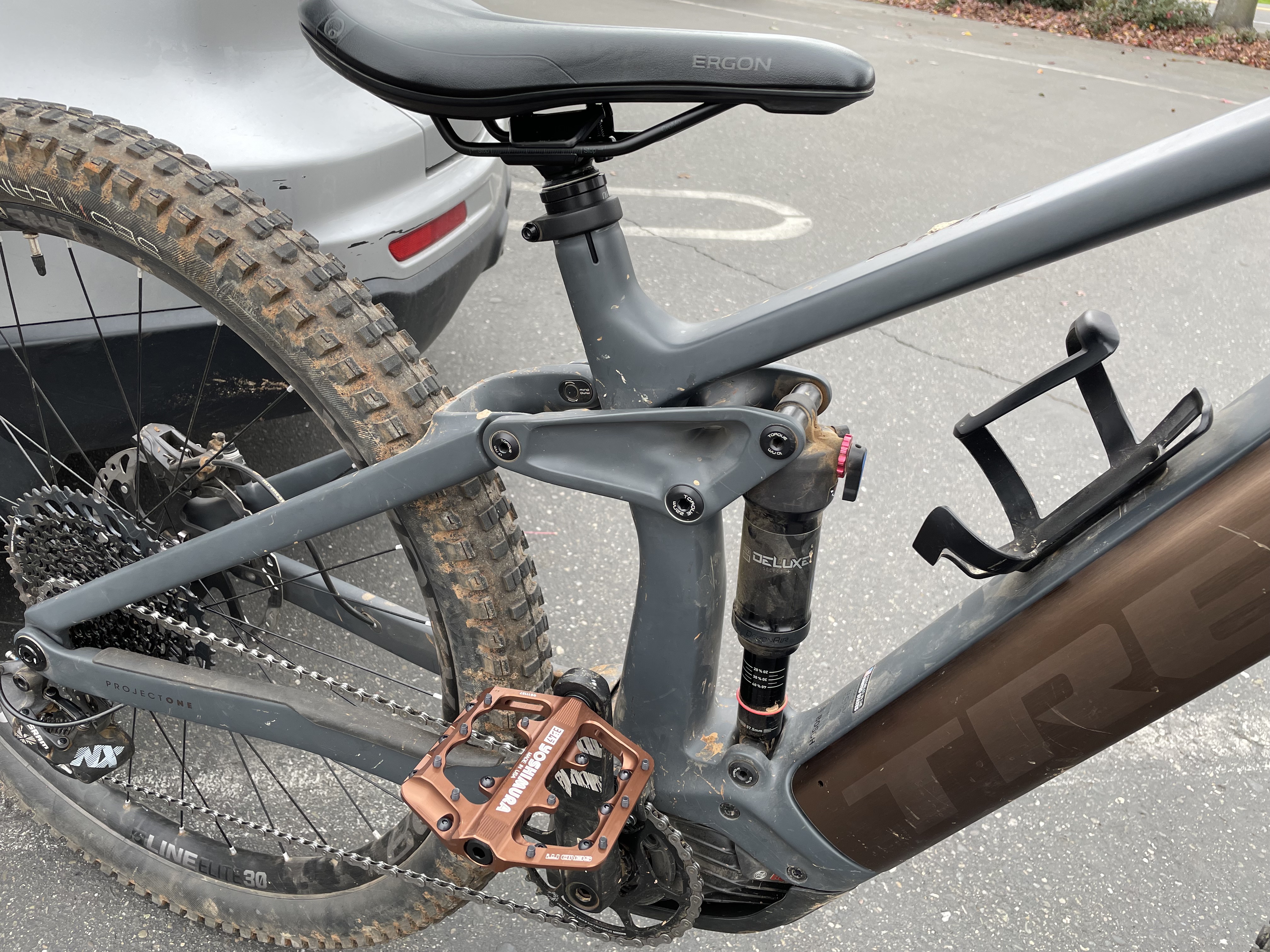

My carbon Rail 9.7 needs to be handled, or inspected, properly. On the non-drive side of the lower triangle I once used zip-ties to hold back the hydraulic brake line from rubbing in the spokes. Over a few months the zip-tie had wore thru the paint and into the carbon. My fault. Replaced that with another carbon triangle. Lesson learned.
There are some benefits to carbon frames though.

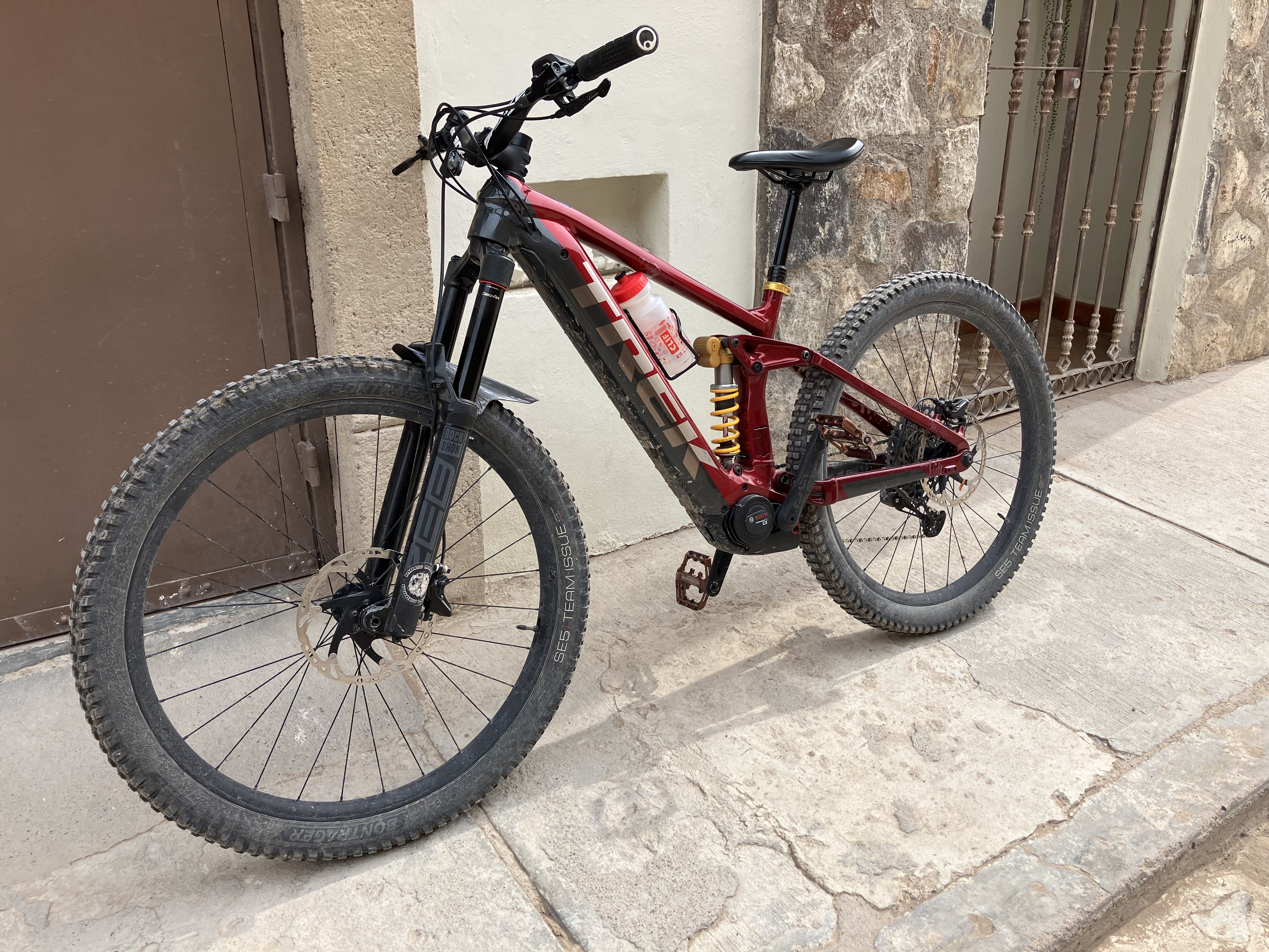

I bought a used 170 Zeb and 165 Ohlins coil for my 23 Rail 5. (from a Slash with a broken carbon frame in fact) Buttery smooth and just a tad slow steering, but I soon adjusted. :cool:

I figure I paid half price retail with installation by suspension shop - and my Rail 5 was instantly transformed from a RAV4 to a TRD Tacoma truck (!!!!!!!!!) using a Toyota analogy.
