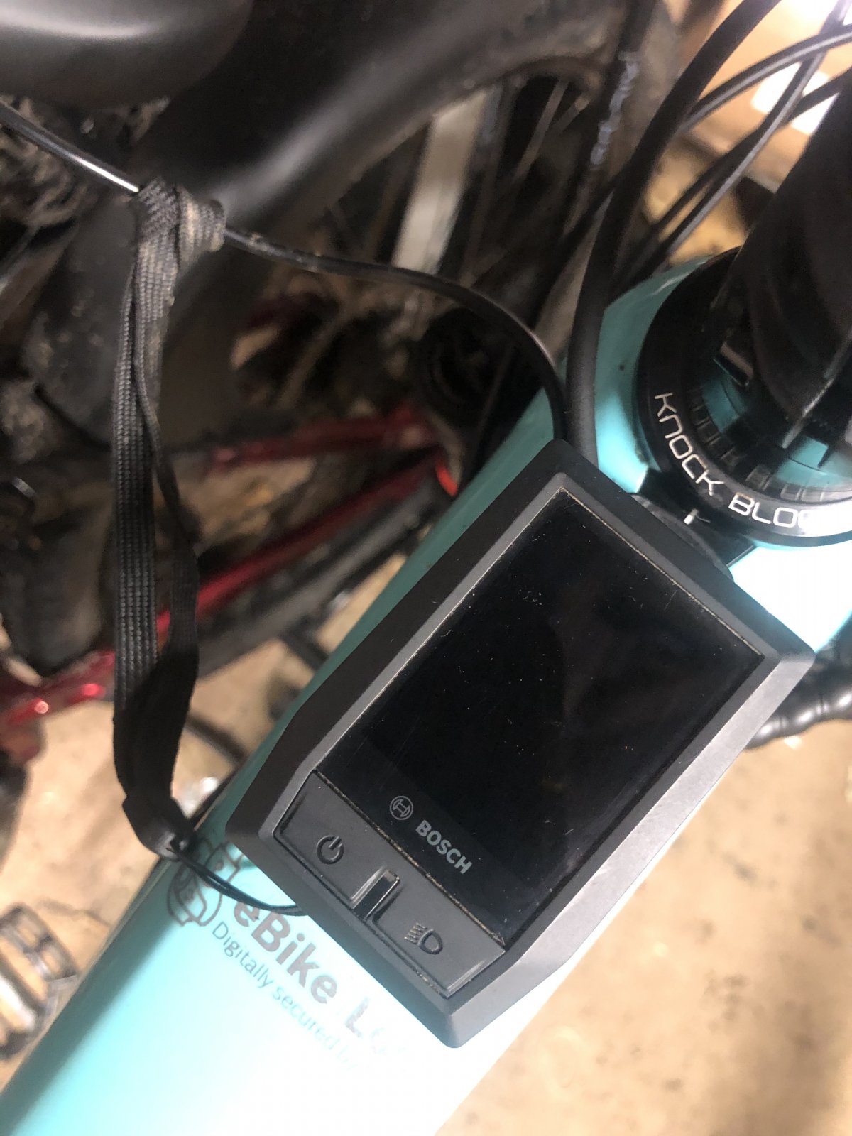

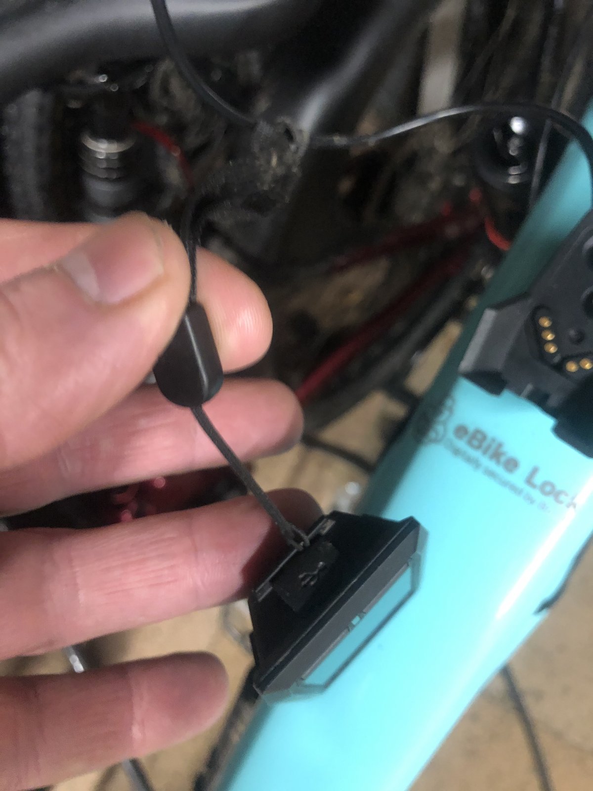

Just got my rail 7 after months of waitng. So far i'm impressed, except the display is very minimal. Speed, distance travled, and range. Are many of you adding a computer ?
Knox is the way to go. I had my LBS supply & fit it for me. It’s well worth the added extra but add a lanyard to it before your 1st ride. I’ve read a few have fell off during rides.
