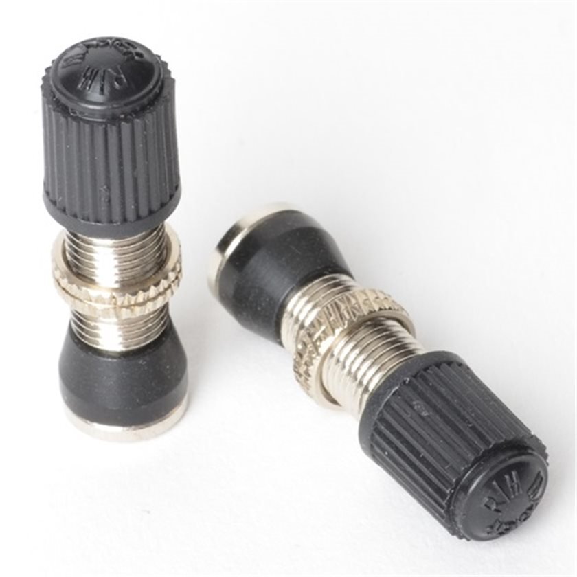

125 miles on new bike.1st front brakes terrible.Feels like they need to be bled.Power awesome.Hills no longer exist.Back brakes seem ok.Been cleaning after every ride.Quite challenging not to get motor and battery wet while washing.In all of my rides haven't used more than two bars.Tires seem to grip ok.Still have tubes.Little skeptical to go tubless.Dont like presta valves,pain using adapters.Wish they were Schrader valves.Was going to drill out rim's for Schrader valves but LBS can't get tubes in 2.6 with Schraders.Might have to upgrade front brakes.Other then small problems loving bike.Most fun I've had.

Don’t drill your rims , you will want to go tubeless , and if they are drilled out you’ll have no chance you shouldn’t need an adapter with presta , sounds like you’ve got the wrong pump fitting . Or maybe look at one of the tannus type systems not sure about the 7 but the 9 was tubeless ready set up by the shop .

Stans makes a Schrader tubeless valve if you decide to go that way. The stock brakes work great if the pads are bed in properly, hydraulics bled correctly and calipers are centered on the rotor.
