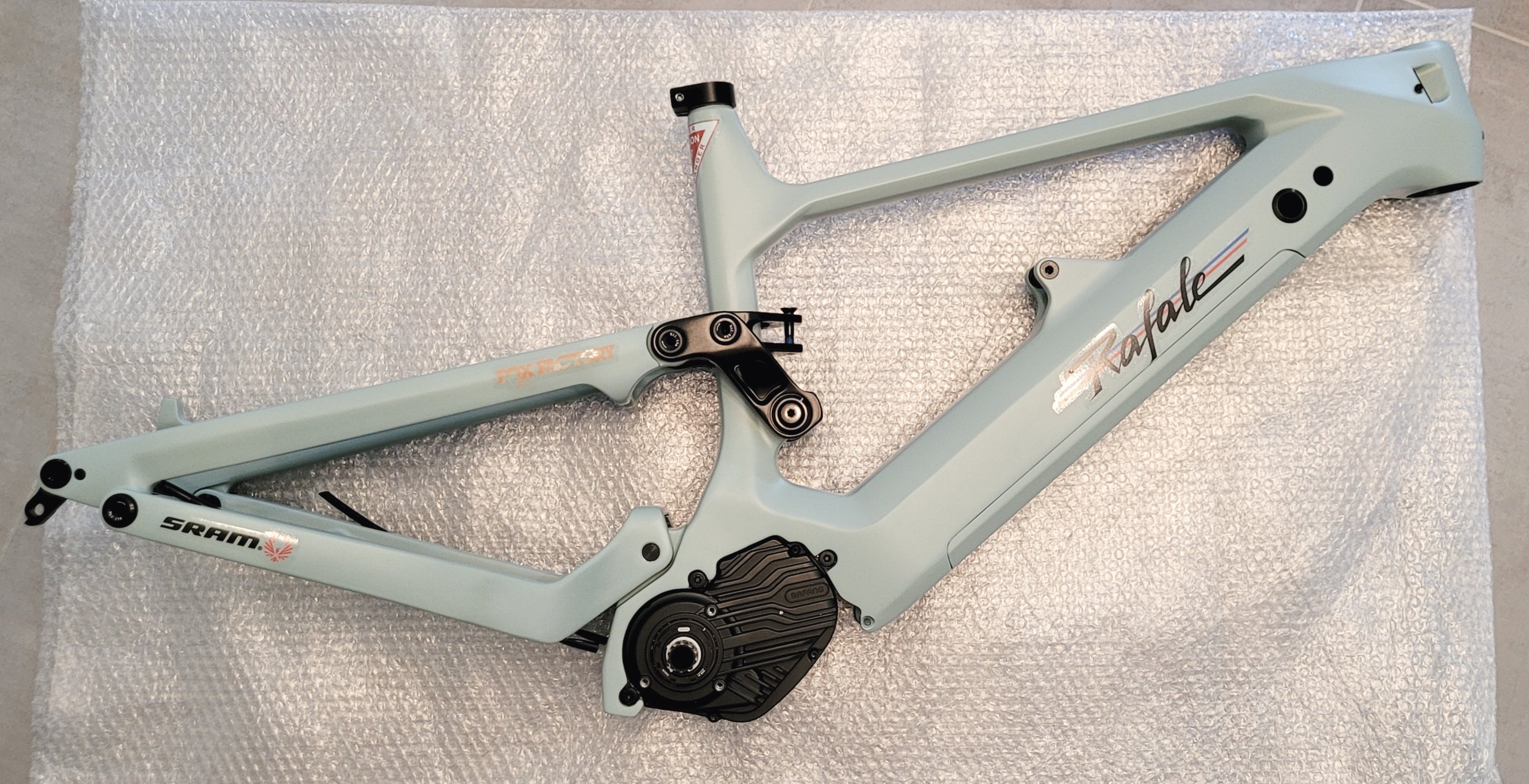

1684718797039.jpeg I would like to assemble the frame with fox kashima components (Fork, Shock, dropper post) to get this look :

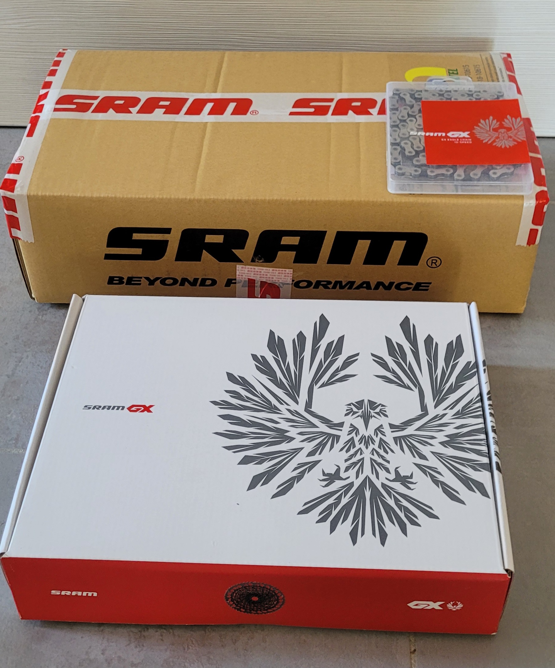

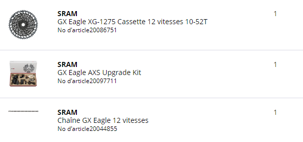

I have ordered the GX Eagle AXS + Cassette + Chain separatly to surprisely get a better price than a full set.
On Bikediscount: 580€

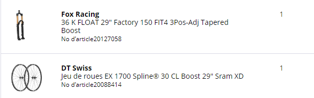

After hesitating, I finaly went for 29" wheels.
So, according to the E10 geometry I took the fork 36K 150mm [561,0mm]
Main components are now ordered.
Ancilary components will be decided when I will get the frame to be sure to order the right size (Seat post, stem, etc.)
ORDERED
Drivetrain : SRAM GX EAGLE AXS Upgrade kit
Casette : SRAM GX EAGLE XG-1275 12S 10-52
Chain : SRAM EAGLE 12S

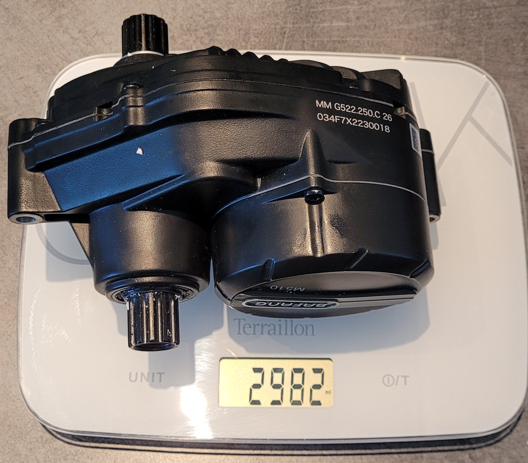

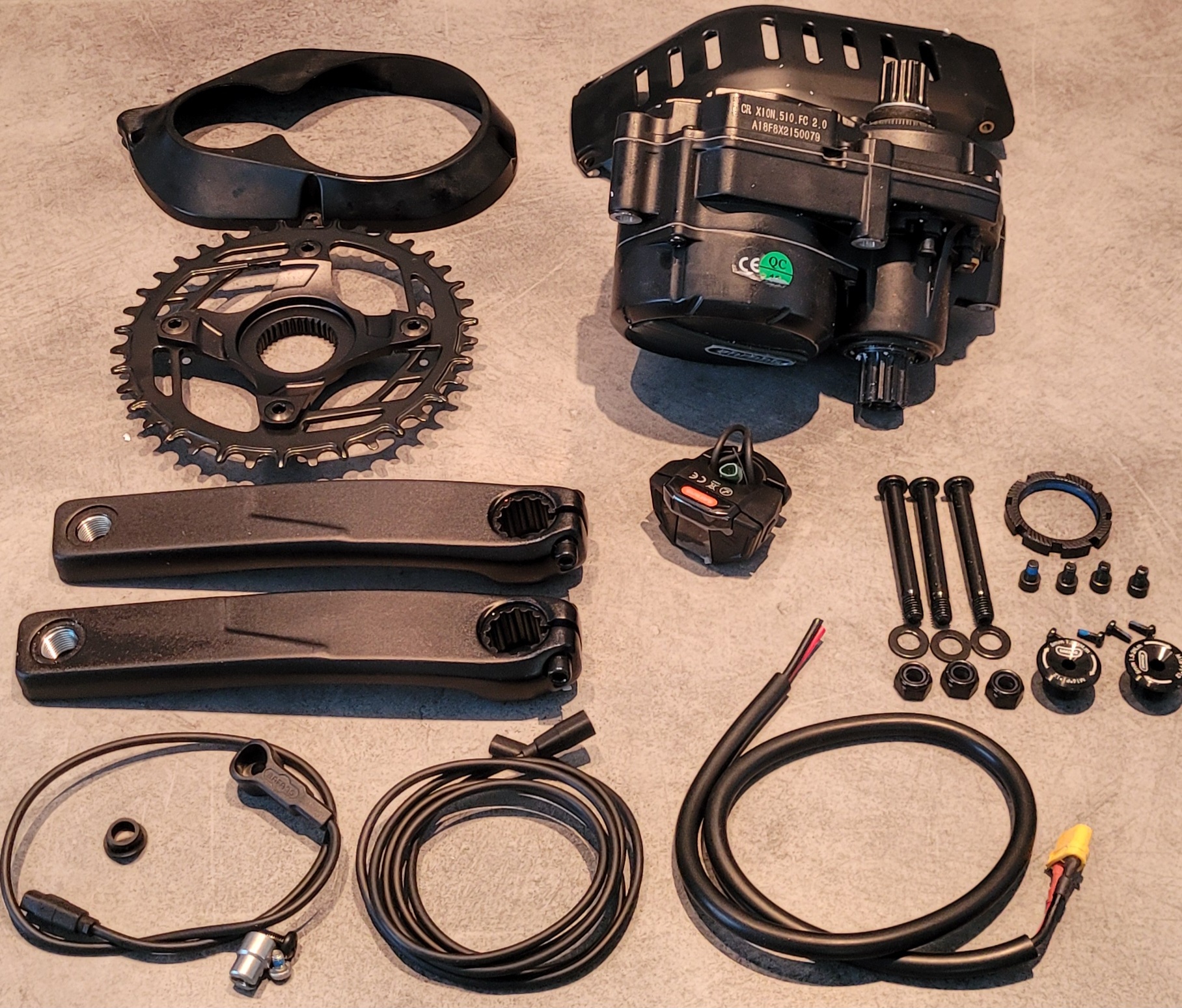

Ordered the 8th recieved today :cool:(y) delivered via UPS not requesting more taxes.
636,49 € Motor cost all included (Delivery, taxes, etc.)
Thanks to « Chili Shen », who's « Anna Shen » on Alibaba > Changzhou Fieldebikes Co., Ltd

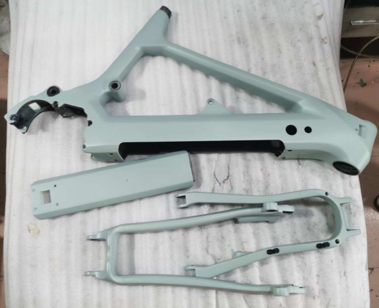

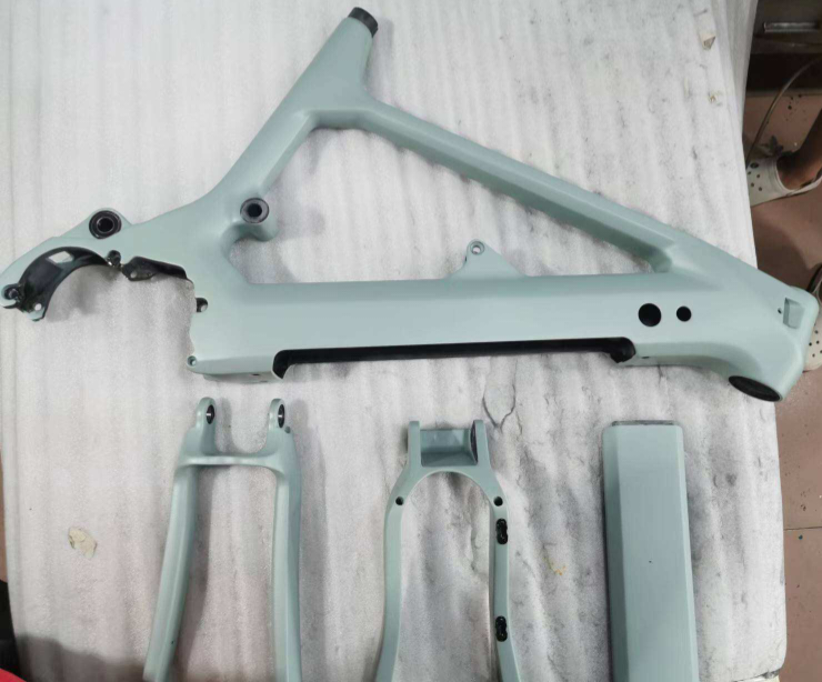

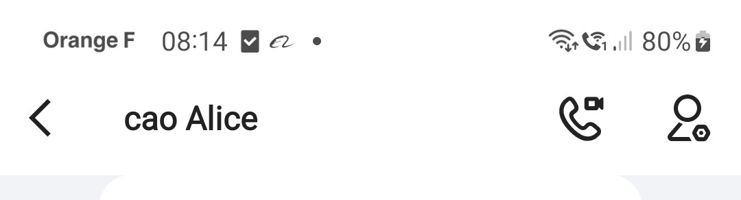

Info from "Ben Rides" > « Cao Alice » on Alibaba > Dengfu Sports Equipments Co., Ltd
(For information, it is better to communicate with her via ALIBABA than via the forum)
"The frame has already queued up in the painting workshop. As long as the painting is done well and the quality inspection passes, we can ship it to you. Next week at the earliest. The normal schedule is to complete the painting within 2 weeks."
Great! (y) I'm like a little boy waiting for his gift! :ROFLMAO:

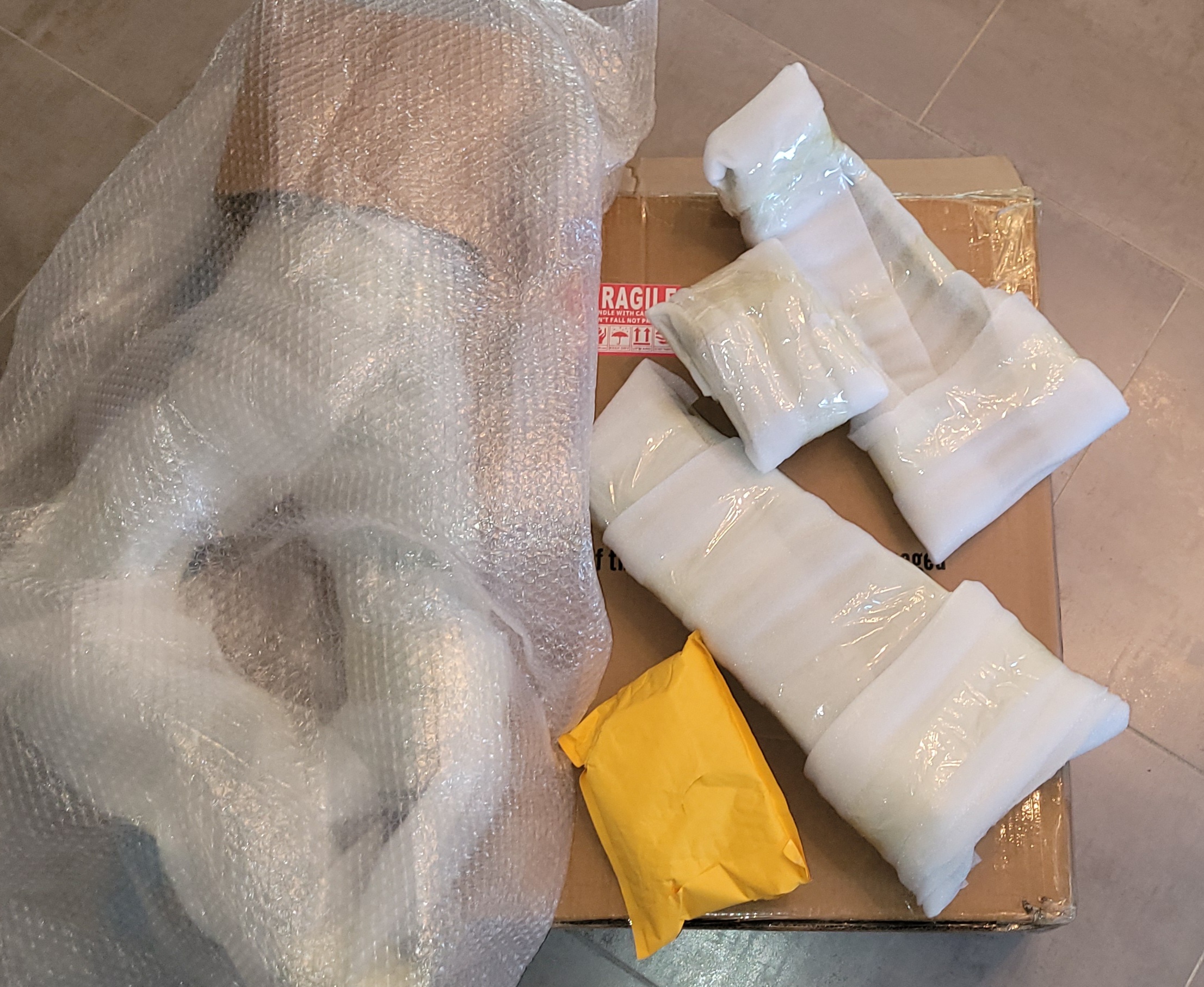

I always found unboxing stupid.
So I confirm; I'm stupid! :ROFLMAO::ROFLMAO: I could not resist!

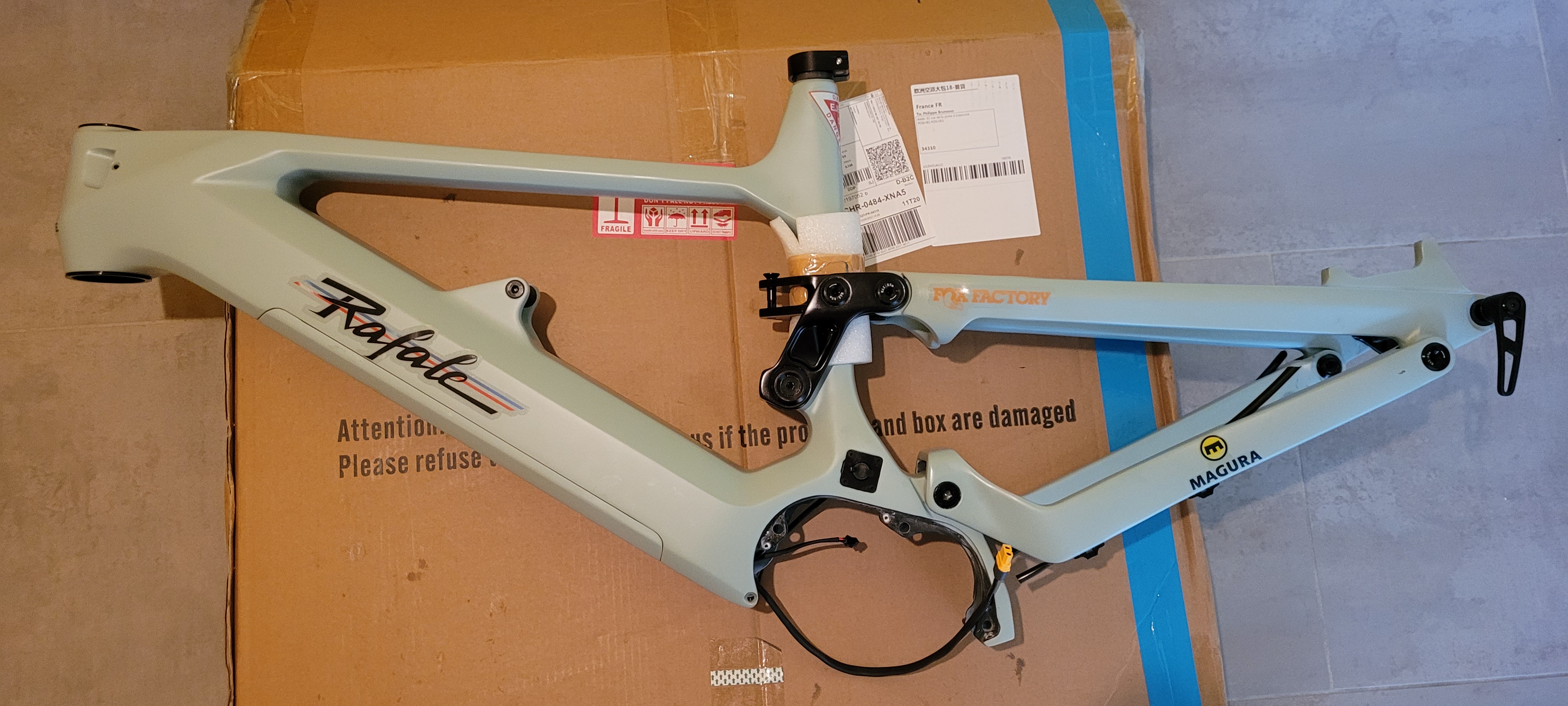

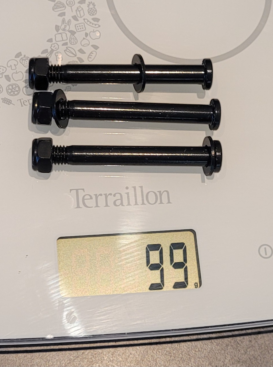

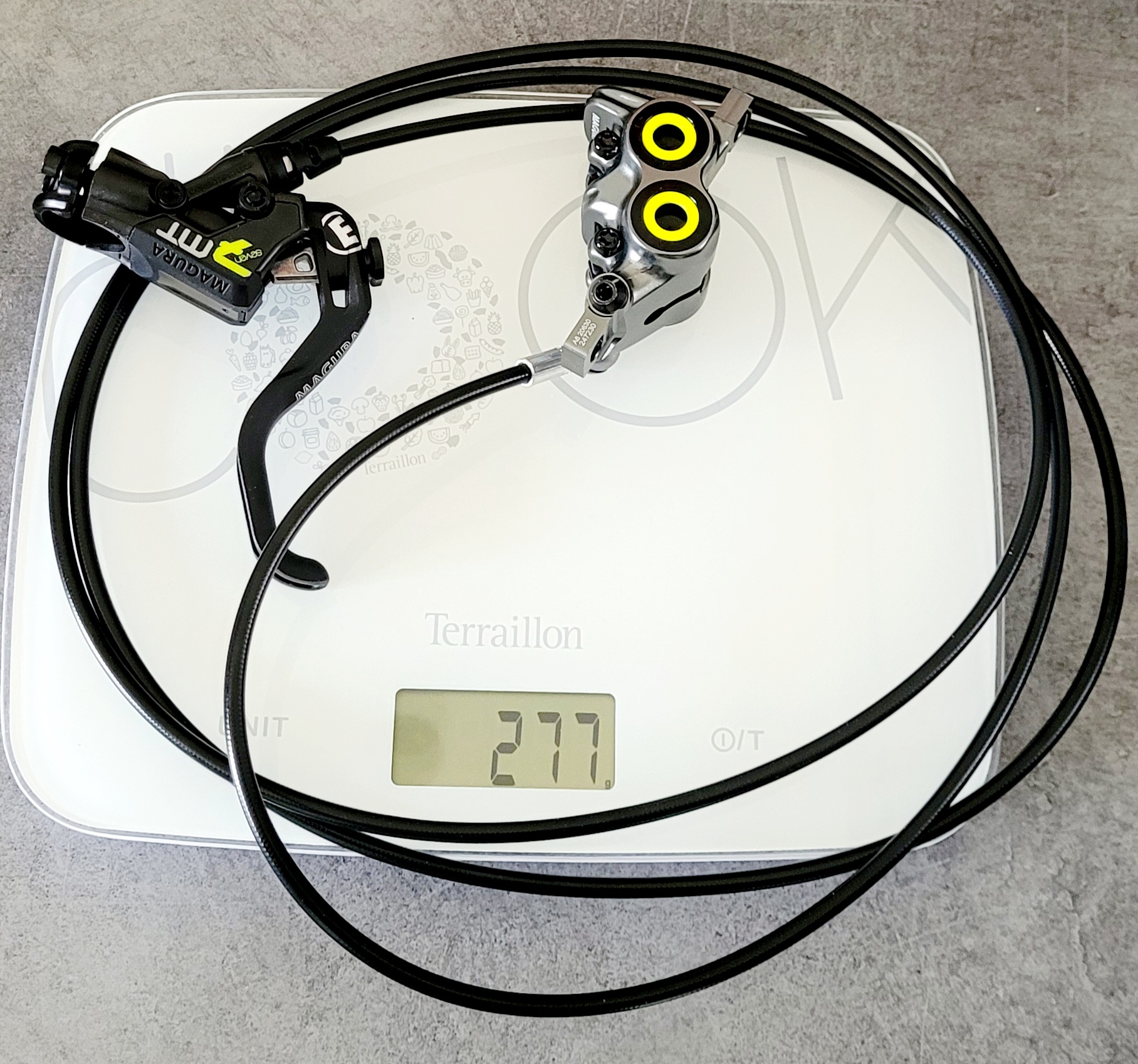

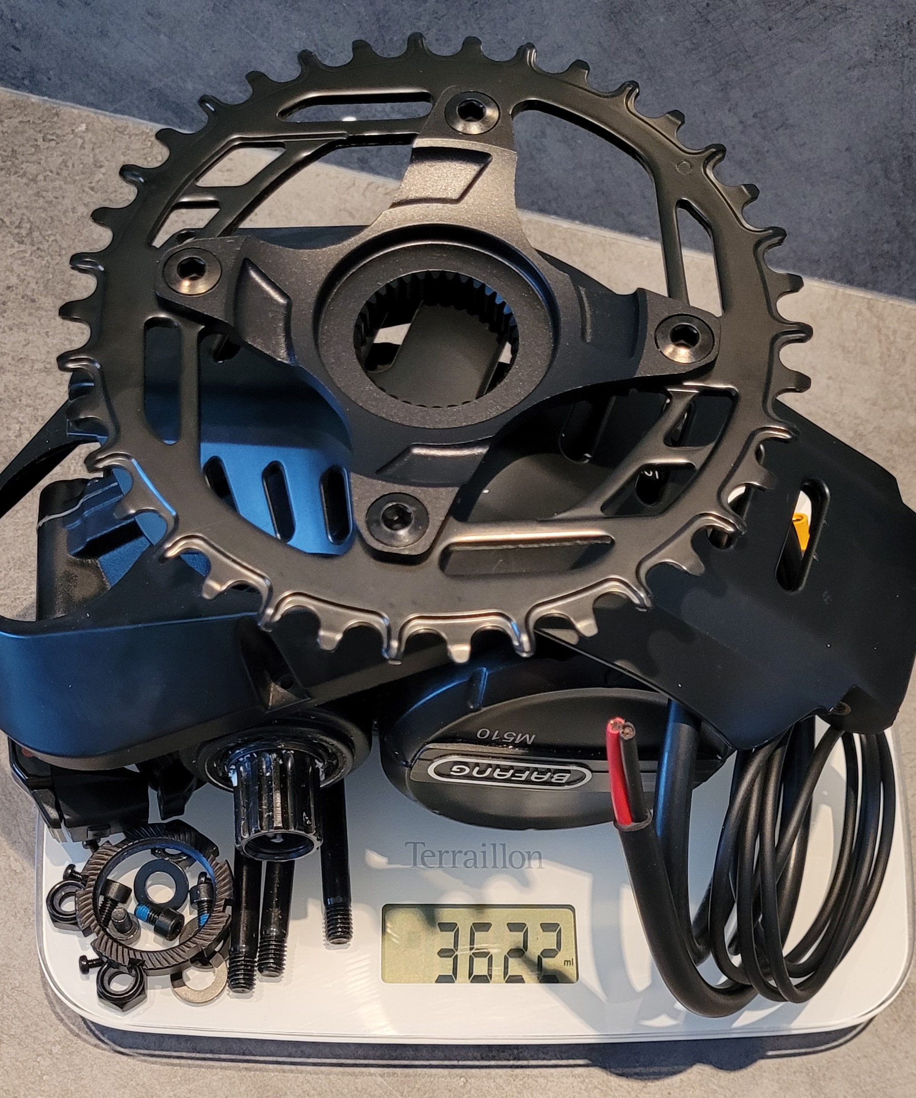

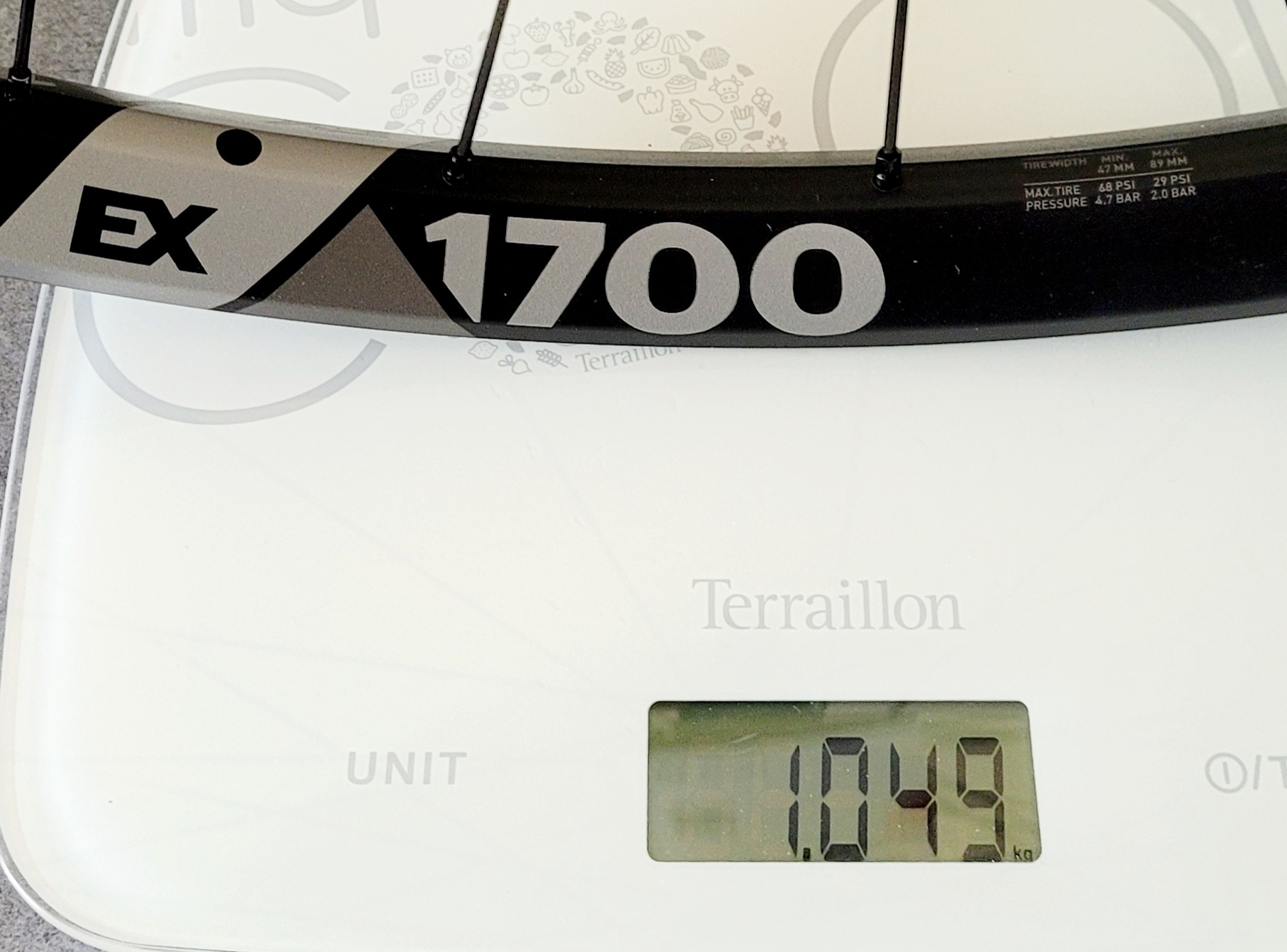

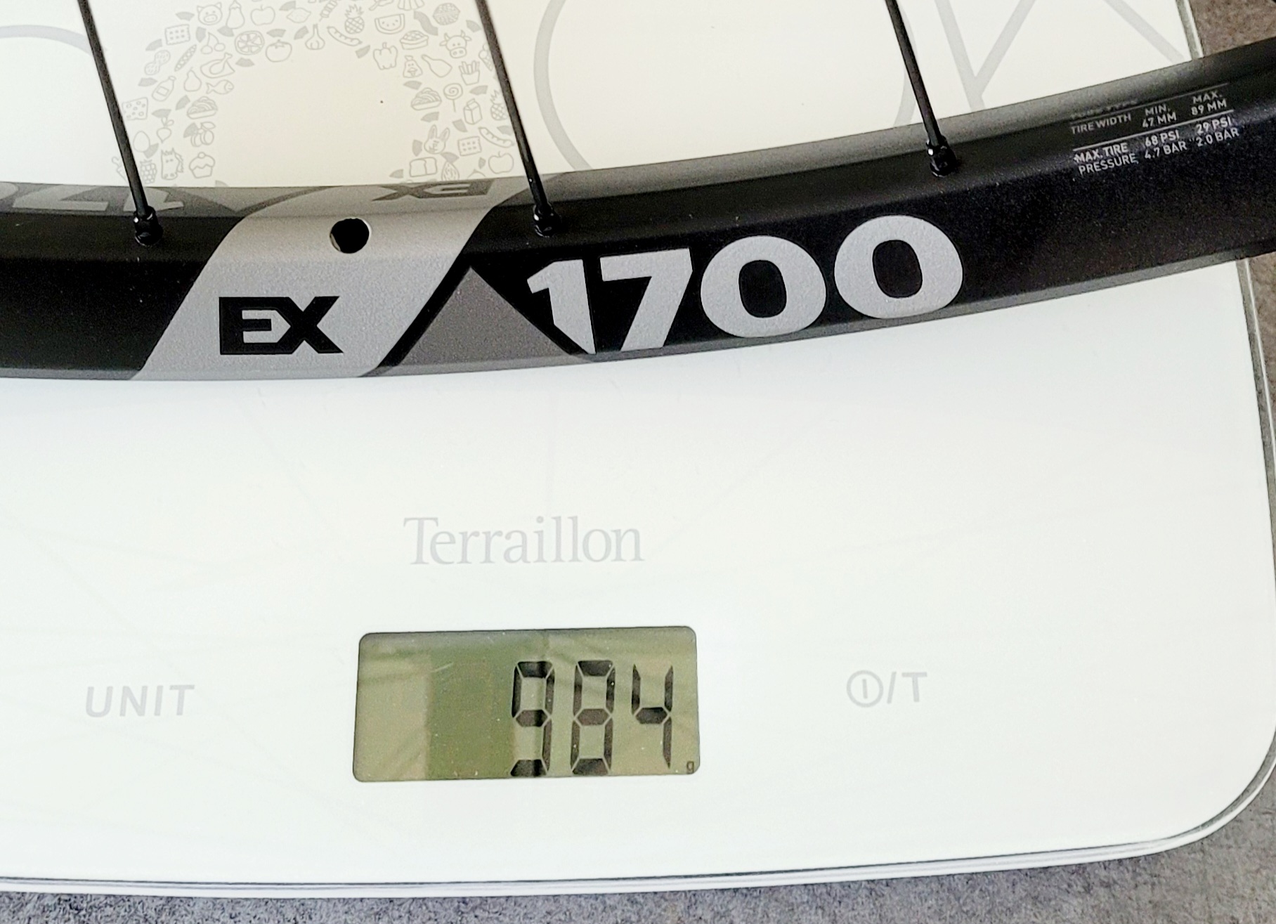

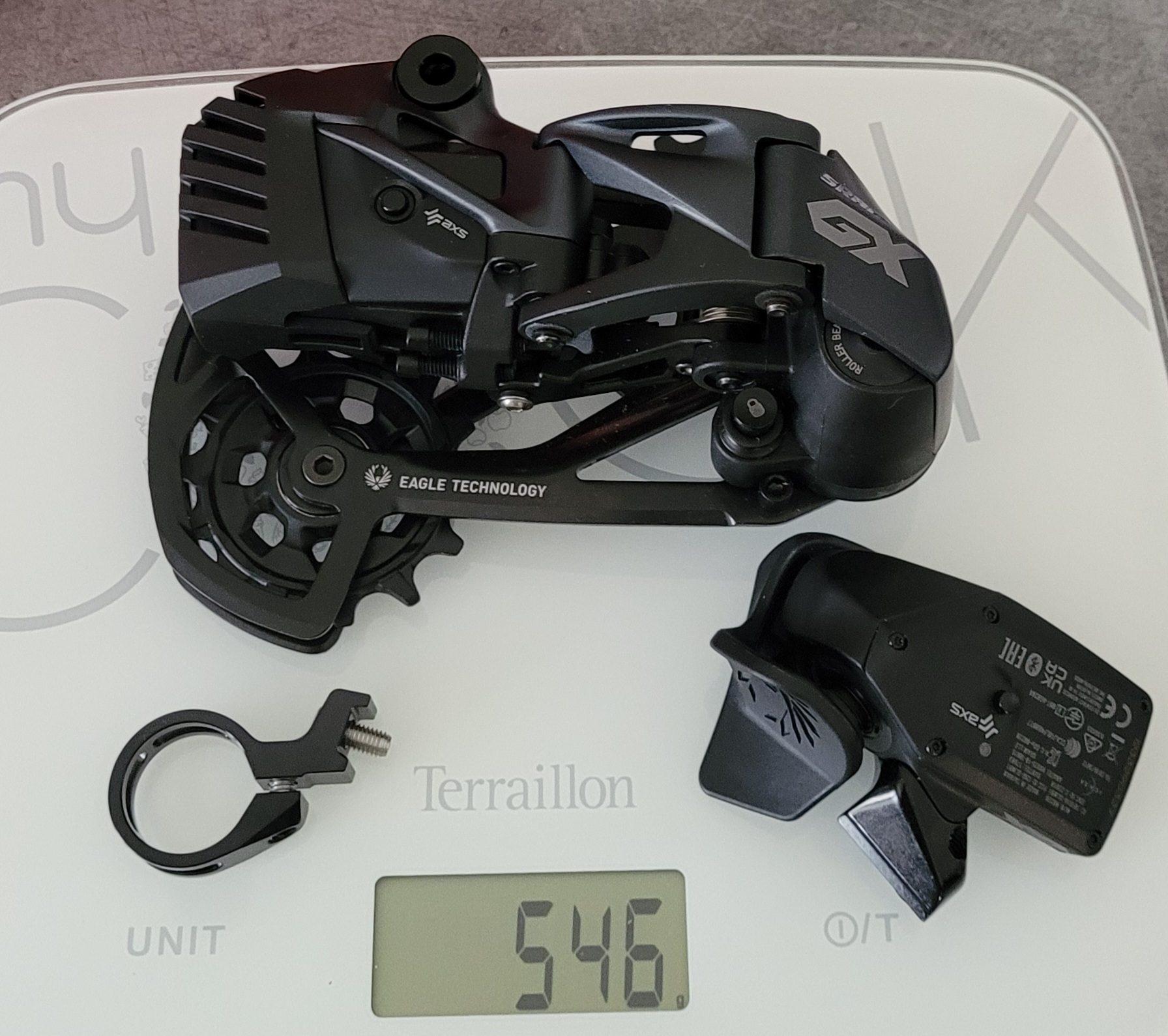

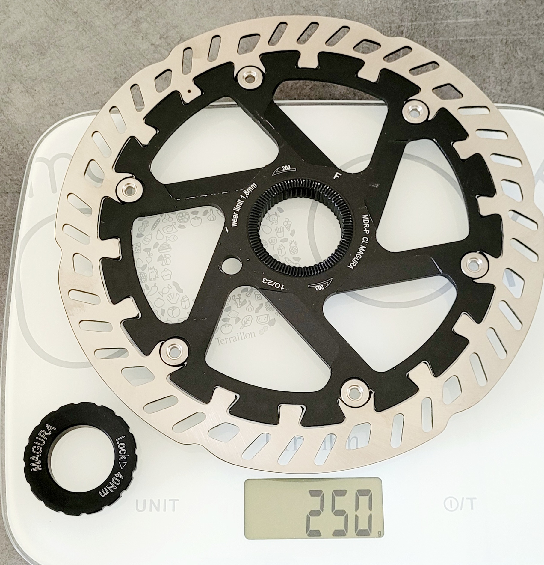

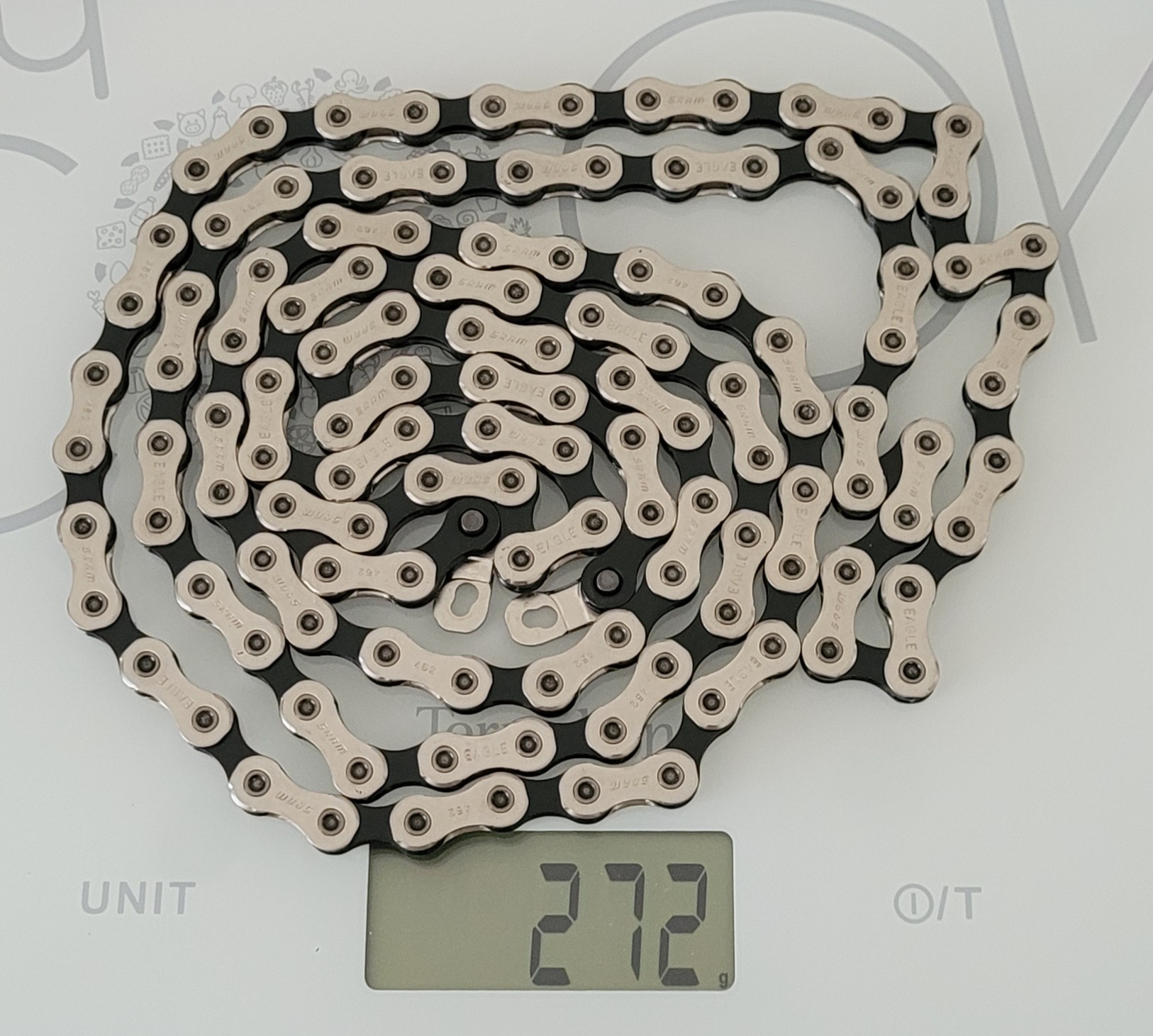

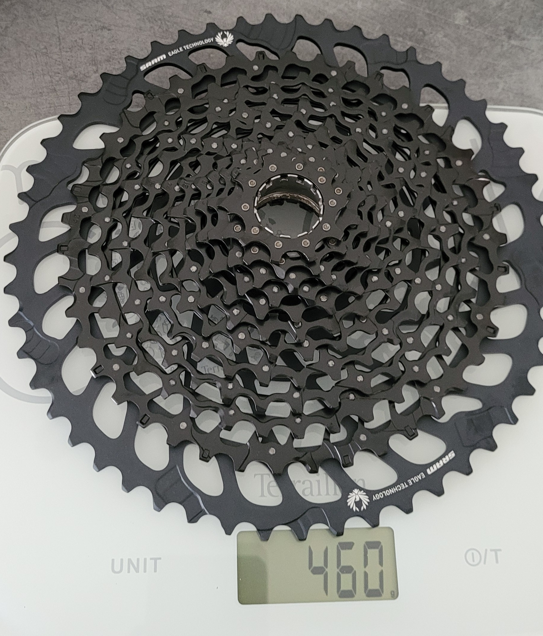

Second delivery: 😋
WEIGHT: 3087 grams
DT Swiss-Front
DT Swiss-Rear
Magura MT7

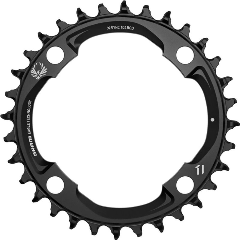

Arrrg!!!😳 Which Sram cassette and chain would you recommend?
For information: To complete the drivetrain set, the chain ring is a "Sram X-Sync 2 X01/XX1 Eagle 104mm 34T"

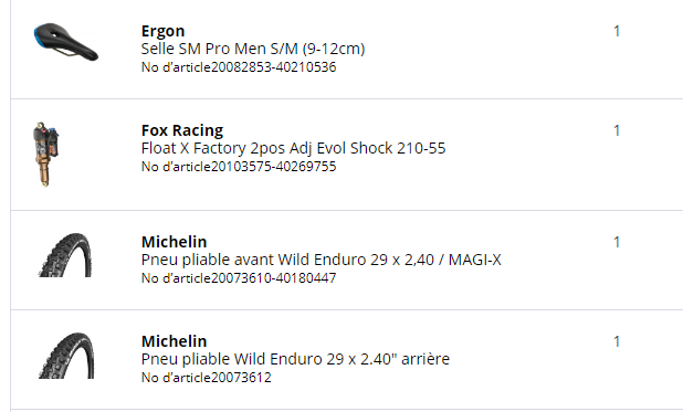

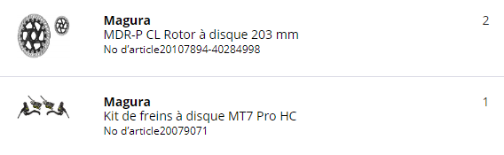

France

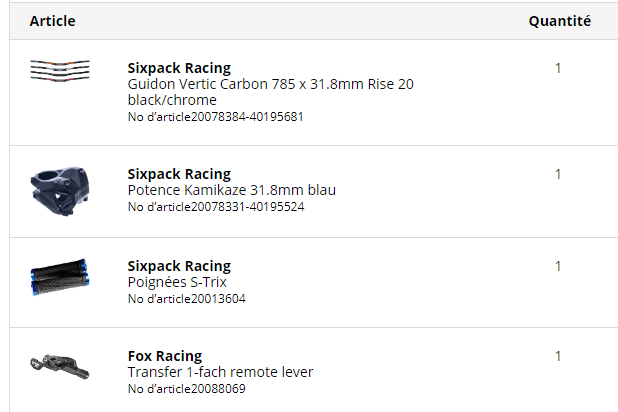

Few days remaining before receiving the frame... I hope :)
Last order today. It will remain the seat post rod. I wait for the frame to be sure of the inner lenght possible.

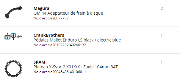

Previous orders:

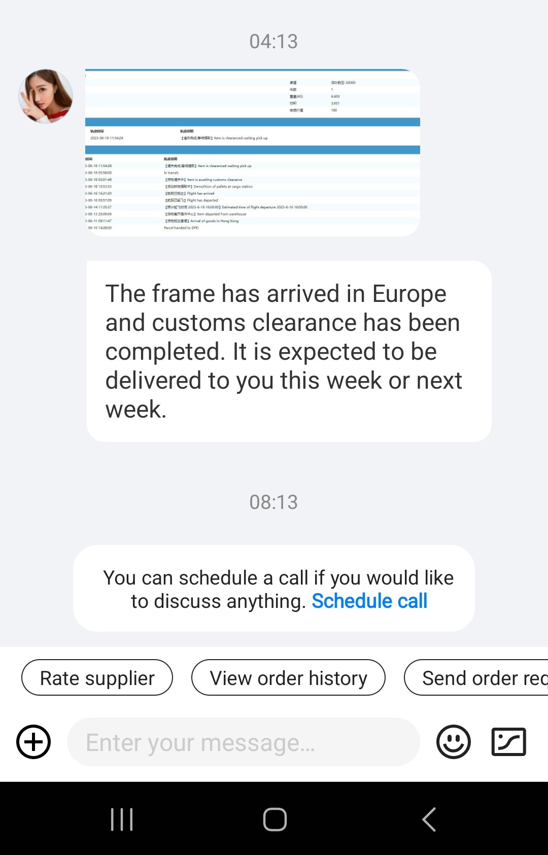

PH1L1PP3
Apr 27, 2023
99
56
France

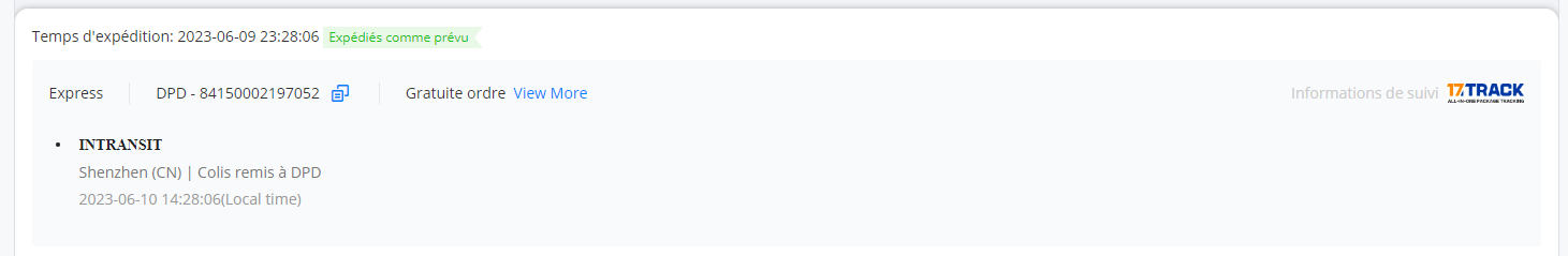

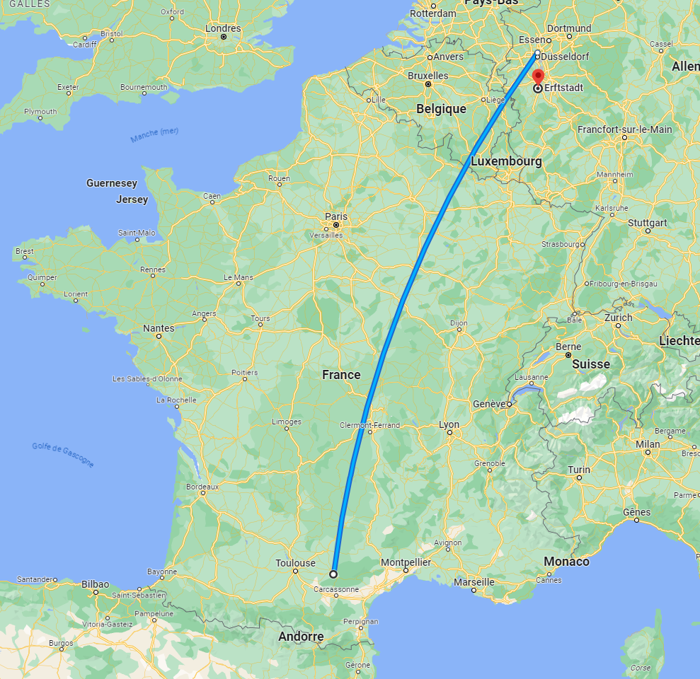

Should travel to South of France tonight or tomorow, or may be it's travelling now!?🤩😍😎😂
Then delivery!!! Yesssss!!! 😀

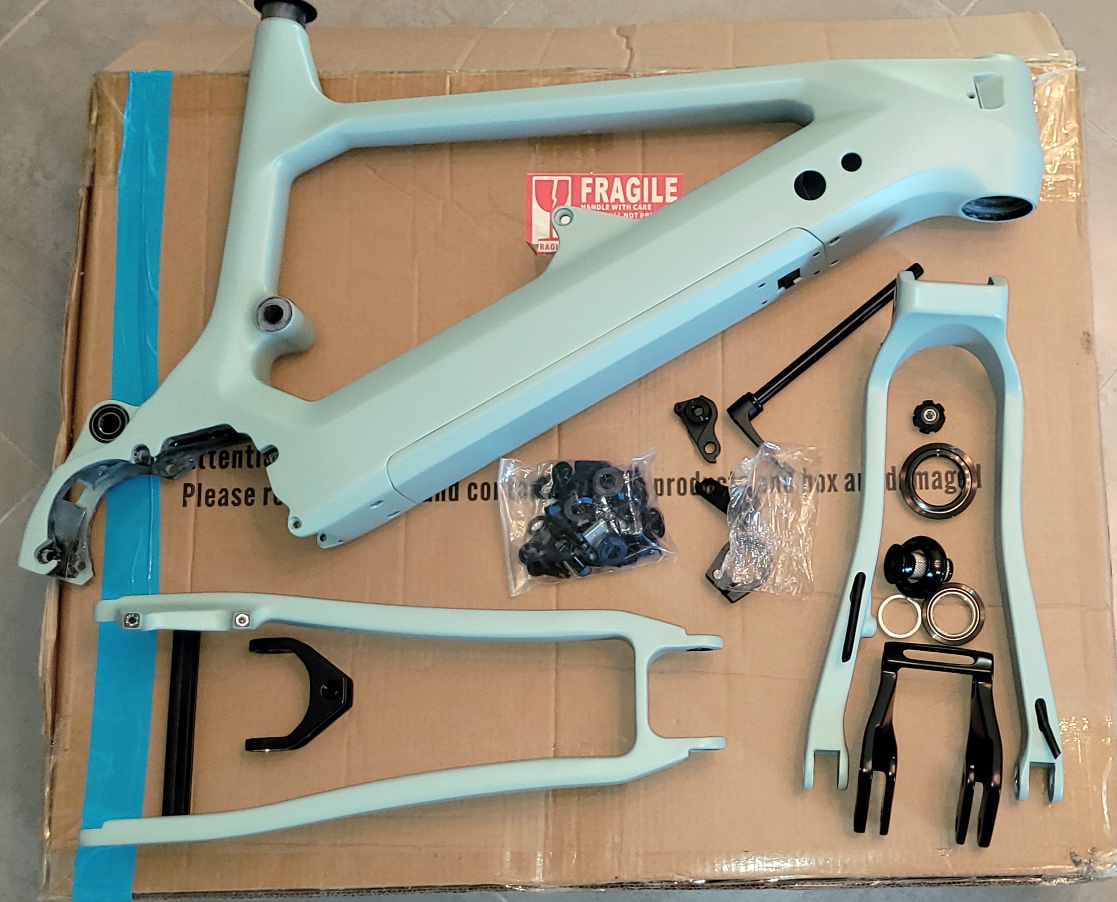

Frame assembled with assembly grease and torqued according to the information stamped on the bolts.
