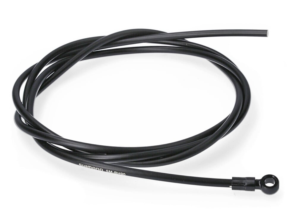

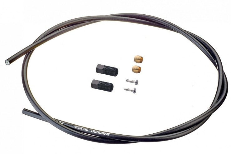

Those M20's which come with M6100 two piston calipers use Shimano brake hose, SM-BH90-SS. The "SS" signifies a straight fitting at brake lever and a straight fitting at caliper. The only four piston Shimano caliper that accepts a BH90-SS straight fitting brake hose is the Deore M6120 caliper.
All four piston brake calipers above Deore level, i.e. SLX - M7120, XT - M8120, and XTR - M9120, use a SM-BH90-SBM "Banjo" type brake hose. The "SBM" signifies a straight fitting at the brake lever and a crimped "Banjo" type fitting at the caliper. There are non-Shimano brake hose adapters that will convert the BH90-SS straight fitting hose to a banjo type fitting. Personally, I'm not comfortable experimenting around with my brake lines. It's one of those things you don't want to fail.

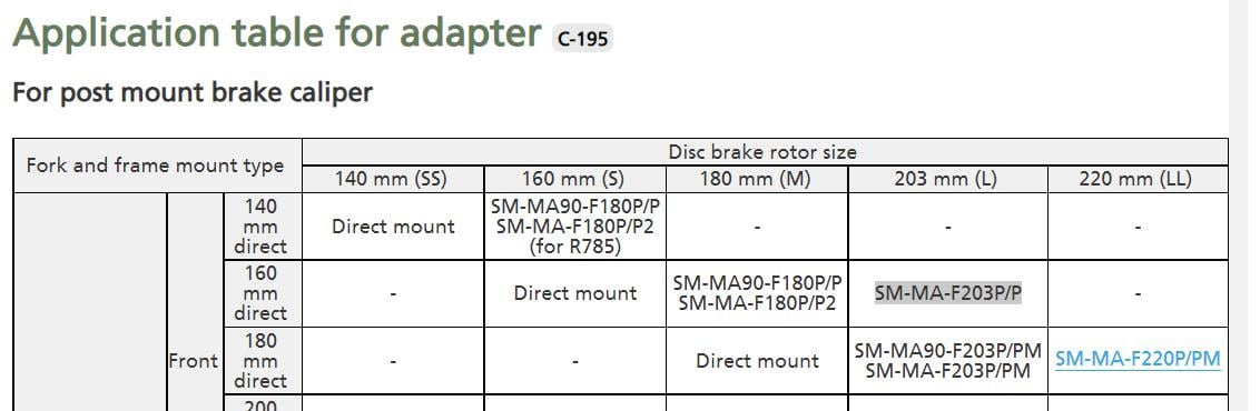

Shimano has a great compatibility chart which details what works with what components. I learned the hard way to review the chart before buying anything.

If you decide to go with a four piston caliper that utilizes a banjo type fitting, i.e. brake hose SM-BH90-SBM, you will be faced with the dilemma of either using an adapter or replacing the rear brake hose. Replacing the rear brake hose is a real treat. Orbea does not provide a separate cable/hose channel inside the frame in which to push cable/hose through. You will need to fish the brake hose through the head tube, down the down tube, past the battery, transition from the down tube up over the top of the motor, out the top of the frame housing, through the black rubber hose guide and into the rear swing arm where the hose exits near the caliper.

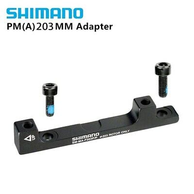

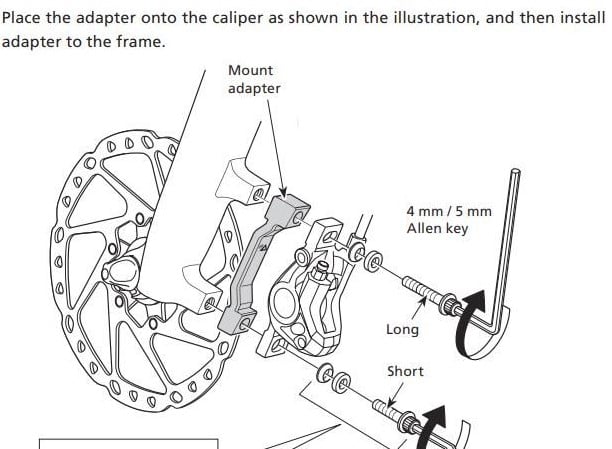

Fox 34 forks have 160mm caliper post mounts. If you go with a 203mm rotor up front, you will need to use a 160 post mount to 203mm rotor adapter. According to Shimano's compatibility chart you will need adapter SM-MA-F203P/P for the Fox 34 front fork. The rear of the Rise is set up with 180mm post mount. If you go with a 180mm rotor, no adapter is needed. If you decide to go with a 203mm rotor on the rear, you will need adapter SM-MA-F203P/PM.
I switched out the Fox 34 on my M20 and went with a used Fox 36. I found I was pedal striking badly with the Fox 34,140mm travel fork. I weigh 205, so go figure.... When you get tired of pedal strikes, buy a Fox 36. I converted the Fox 36 travel from 150mm to 160mm. I also removed one of the two volume tokens that come with the Fox 36 150mm. According to Fox, the 160mm travel fork comes with one token from the factory. It costs about $35 for a 160mm air shaft assembly and the conversion is easy to do. The travel conversion greatly reduced pedal strikes and the bike handles technical downhill beautifully.

Shimano Deore two piston caliper "SM-BH90-SS" straight fitting brake hose

Shimano Brake Adapter Chart
Example of a Fox 36, 180mm post mount to 203mm rotor adapter
An example of the Shimano SM-MA-F203P/P 160mm post mount to 203mm rotor adapter.

I also plan to switch to galfer 203mm rotors so it’s really useful to know that I will need a 160mm adapter for the front. I will either get shimano or galfer adapters.
