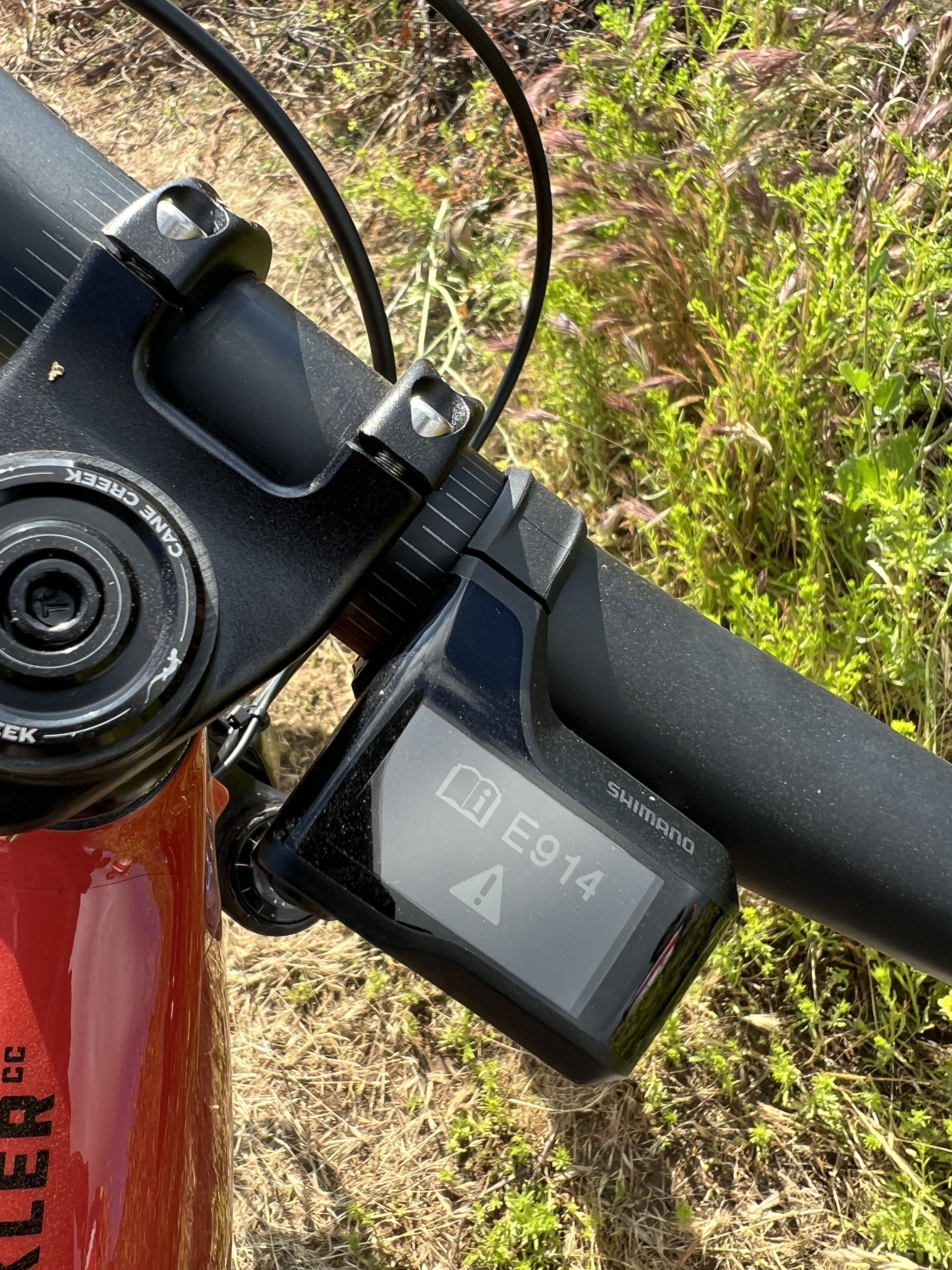

E914 appeared on my display 5/6/23 on my very 1st ride roughly ten miles in; are you kidding me?! Why?!

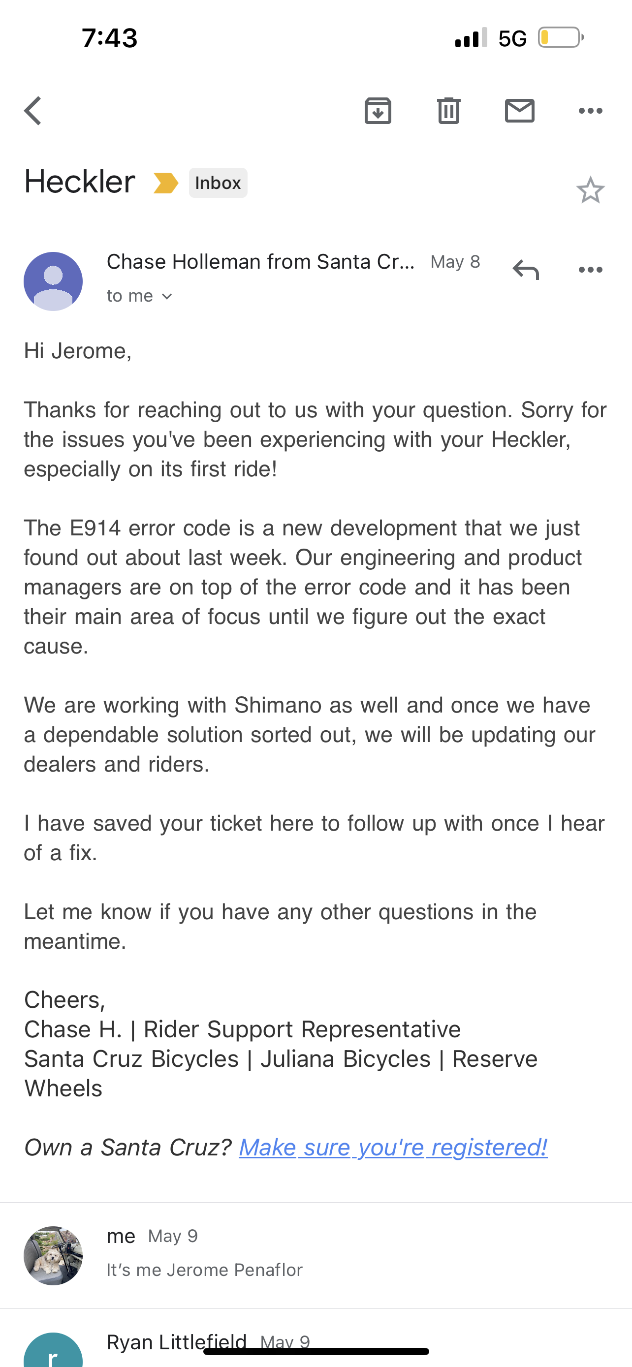

My experience with Santa Cruz regarding this issue has not been pleasant. The feeling I get from an initial response is I'm being hung out to dry.
Don’t get me wrong. I love the bike, I still want it and it pains me to have to send it back to the dealer for further diagnostics.
Only time will tell. If it’s meant to be, I’ll have this bike back soon!!

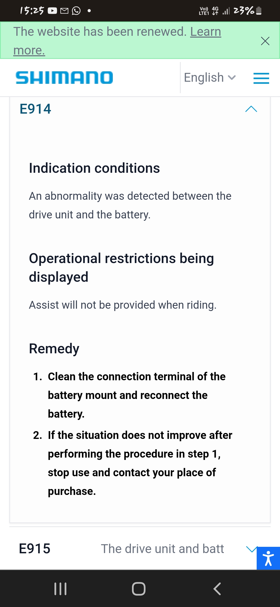

From the shimano website
E914
Indication conditions​
An abnormality was detected between the drive unit and the battery.
Operational restrictions being displayed​
Assist will not be provided when riding.
Remedy​
  1. Clean the connection terminal of the battery mount and reconnect the battery.
  2. If the situation does not improve after performing the procedure in step 1, stop use and contact your place of purchase.
