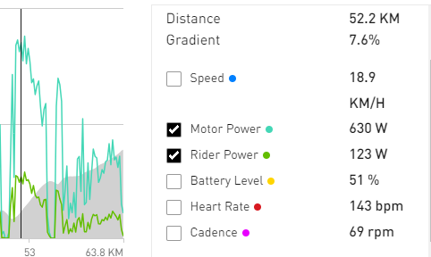

I saw it once by one strong 600hm, 10% road climb in 100/100 microtune mode (shuttle to hotel). Outside was just below 30°C.
The first 200hm went well, then suddenly Brose started to drop the power down to ~350W.
After some short flat section the motor recovered but up to the end of ride anyway struggled to give full power.
The mytos, that Brose does not overheat is just mythos. Anyway, i use ECO almost all the time, so not relevant for me.

According to your graph, your input (rider power) decreased significantly over that tour – and so did the motor output. Does not seem to prove a point here.
Ah, you are so smart, was you on my bike or I? In spite it might look like that on the graph, it was not a case, and motor power loss was almost instant and heavy.
