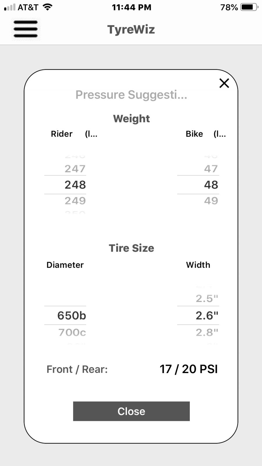

Al Boneta
Dark Rider
Jan 18, 2018
1,351
2,602
California
D
Deleted member 1275
Guest
Hi Al.
Do you use The Tyrewiz app with the actual sensors or just standalone to give pressure suggestions?
I laughed when the bike weight range on the app maxed out way before the weight of my bike! ??
