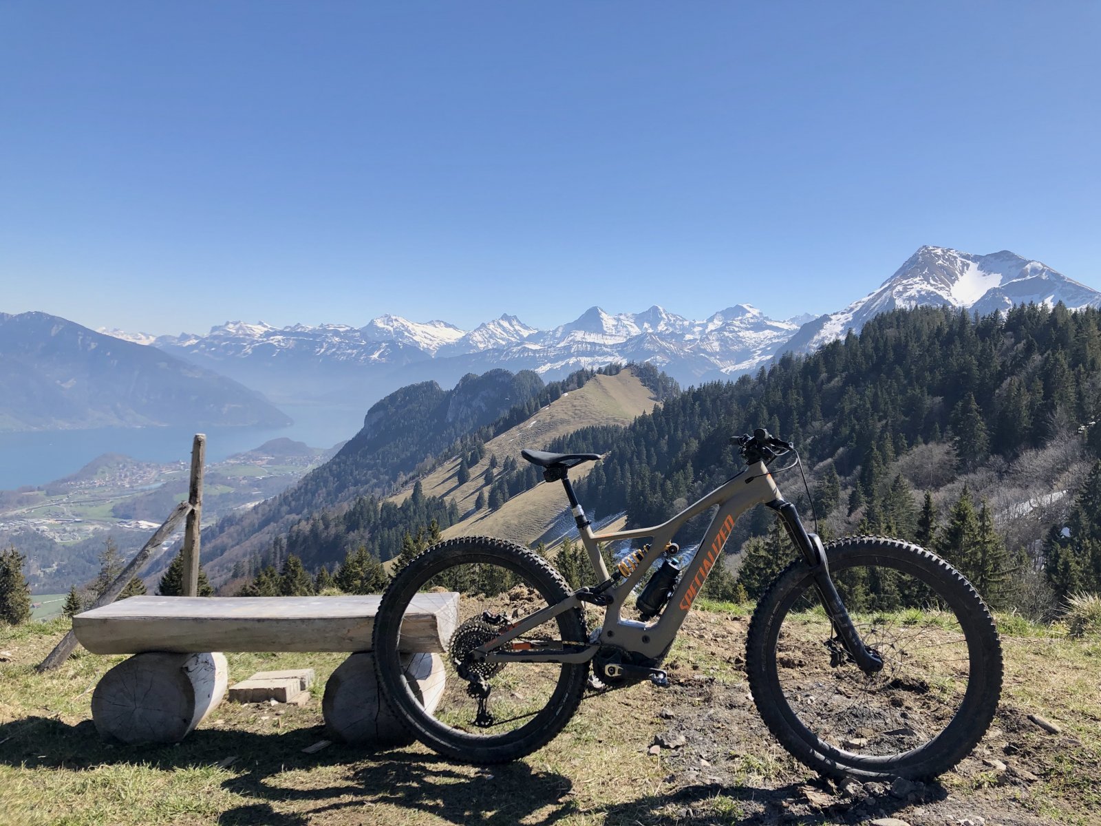

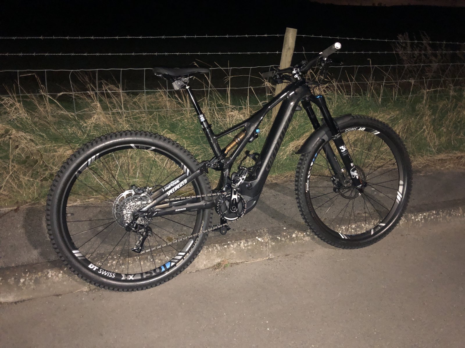

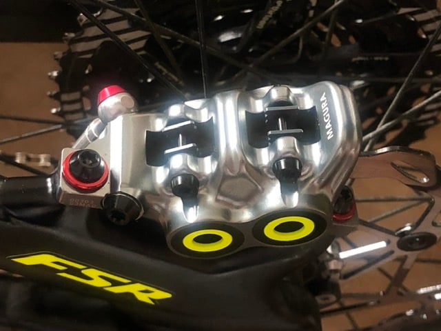

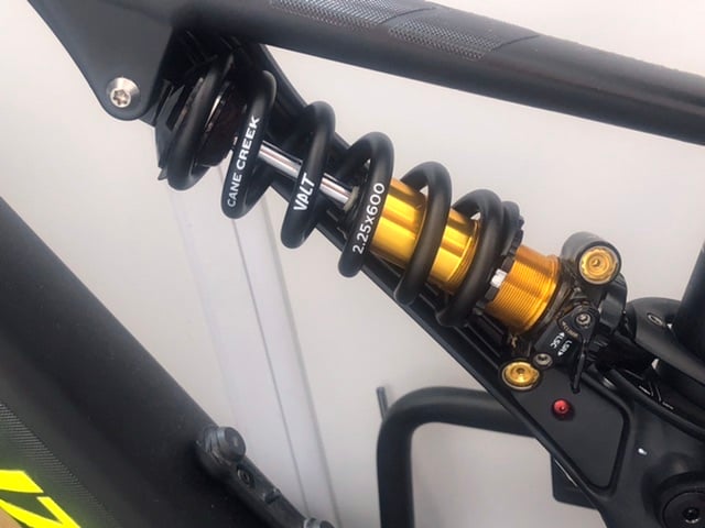

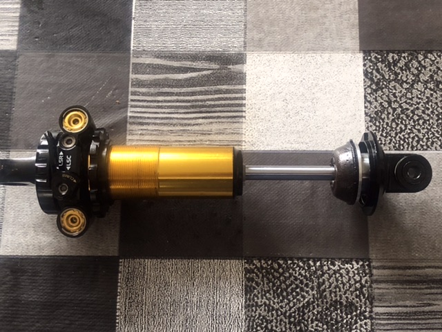

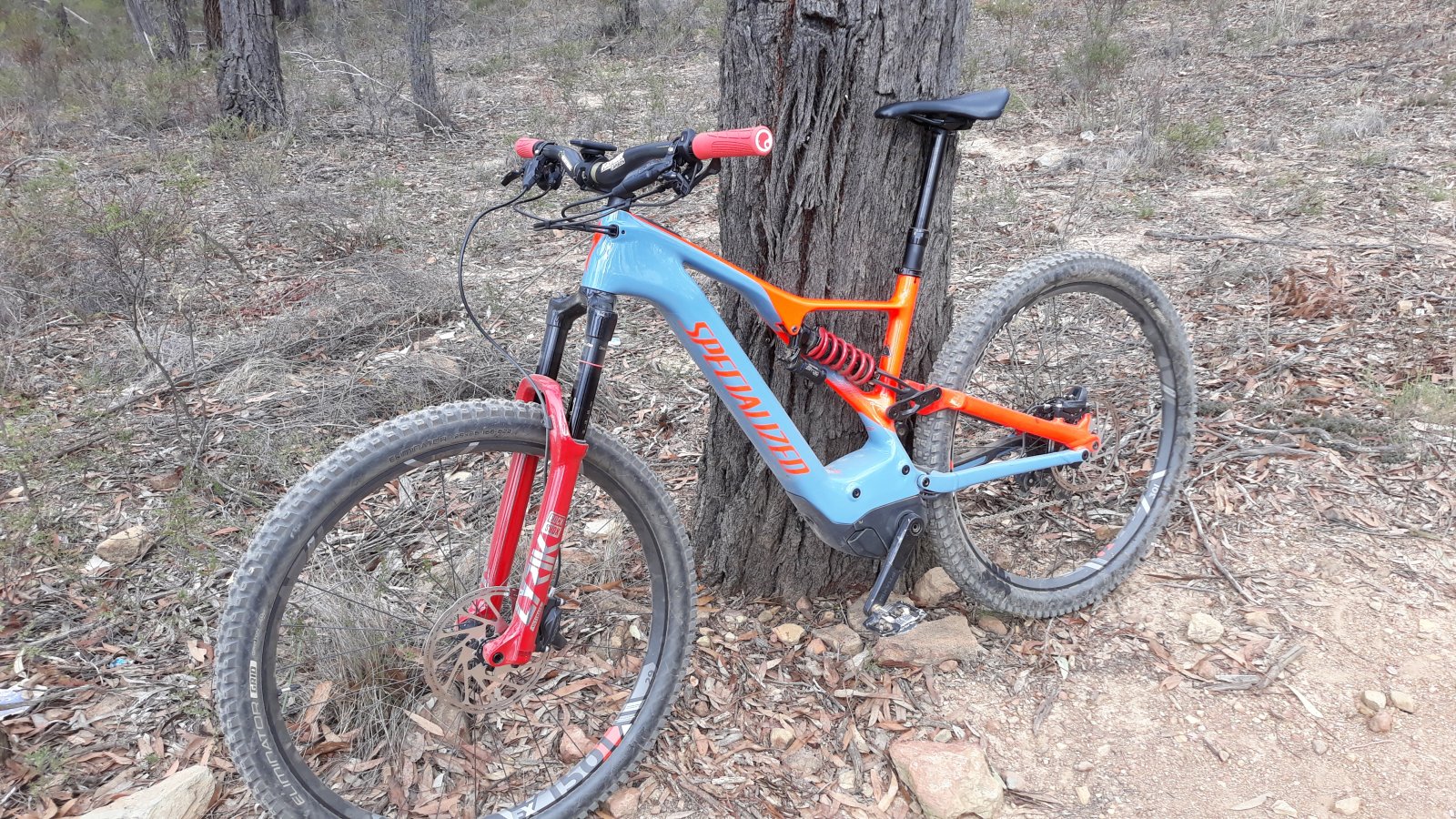

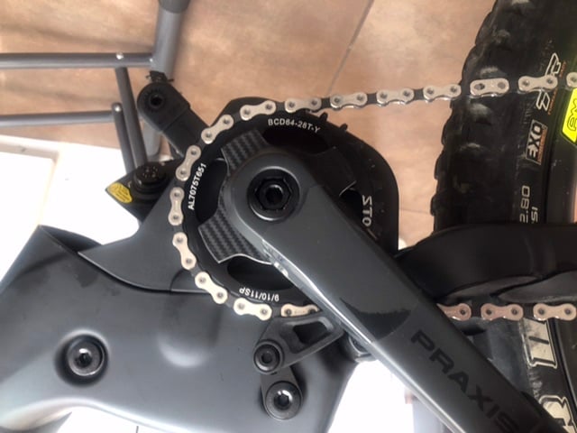

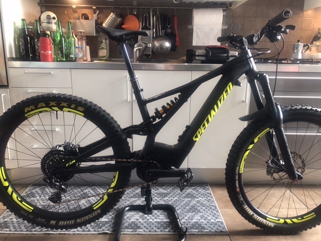

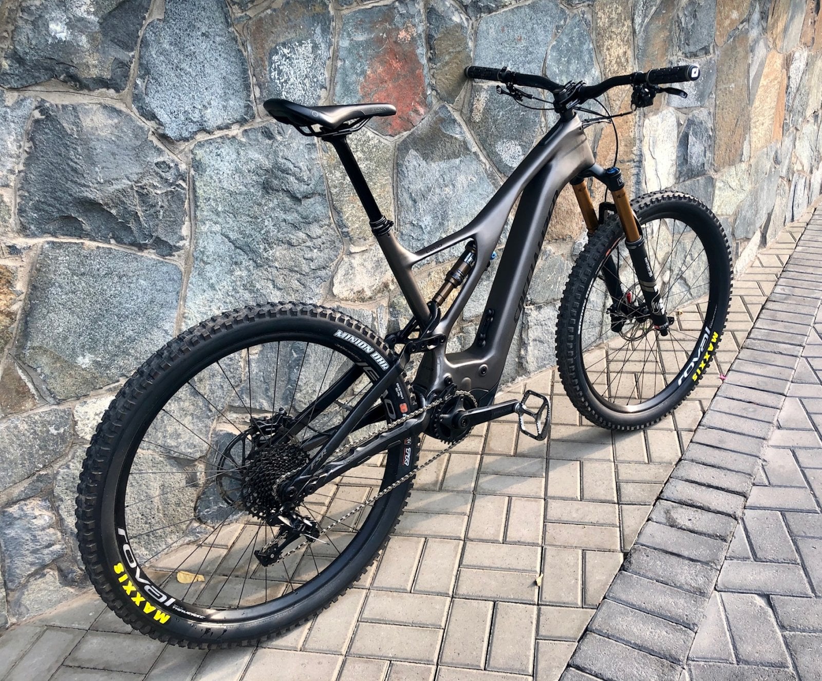

My Levo.

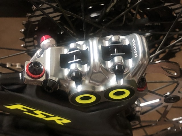

Base model changed almost everything:
Fork: yari debonair Air shaft 170mm, Novyparts Splug compression cartridge, oneup edc topcap, Novyparts axle
Rear shock: cane creek dbcoil il modded e2e from 200 to 213 57mm travel, titanium custom fixing
Brakes: magura mt7 aluminum and titanium hardware Braking 200-185 batfly discs
Stem: answer atac ame 50mm titanium hardware
Handlebar: funn carbon 25mm rise 780mm
Cranks: praxis carbon 165
Spider and chainring: custom made spider 64mm bcd 28T chainring
Rear mech: X1 titanium and aluminum hardware, XX1 cage, 14t lower pulley
Shifter: gx for ebike
Cassette: e13 9-44 11s
Wheels: custom made on 40mm asymmetrical 27,5” carbon rims, 28 holes, dt 350 hubs (the front one is modded with continuous ti axle)
Tires: maxis dhf/dhr 2,8”x27,5”. Tubolight front and rear inserts
Seatpost: bikeyoke Revive Max 34,9x160mm
Saddle: ec90 (specialized power clone)

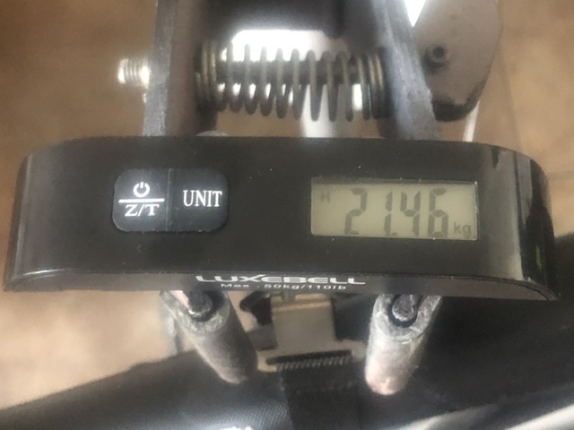

Weight 21,46kg (500wh battery)

why the cc IL is mounted ”upside down”?

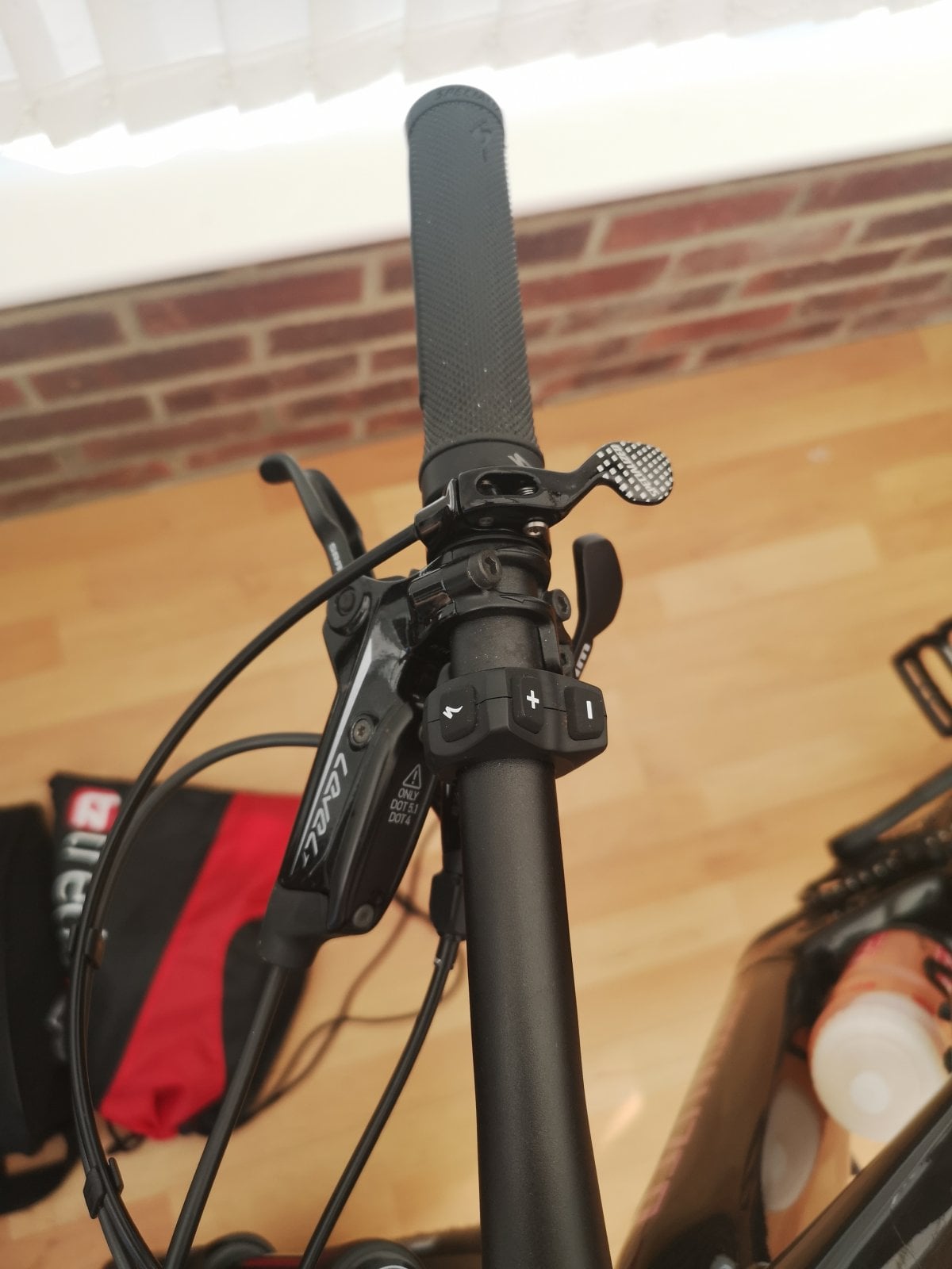

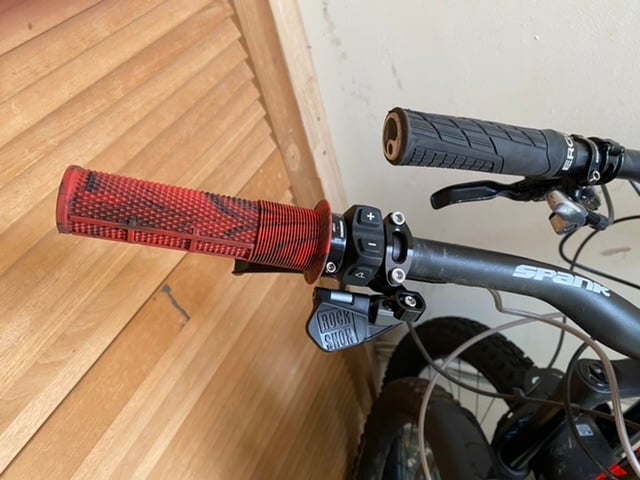

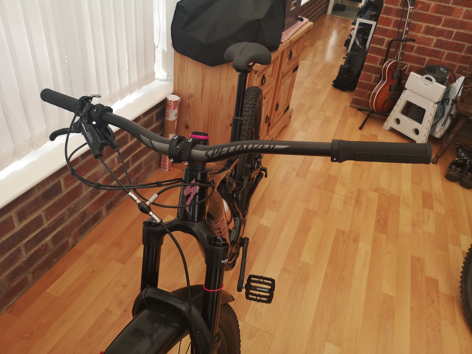

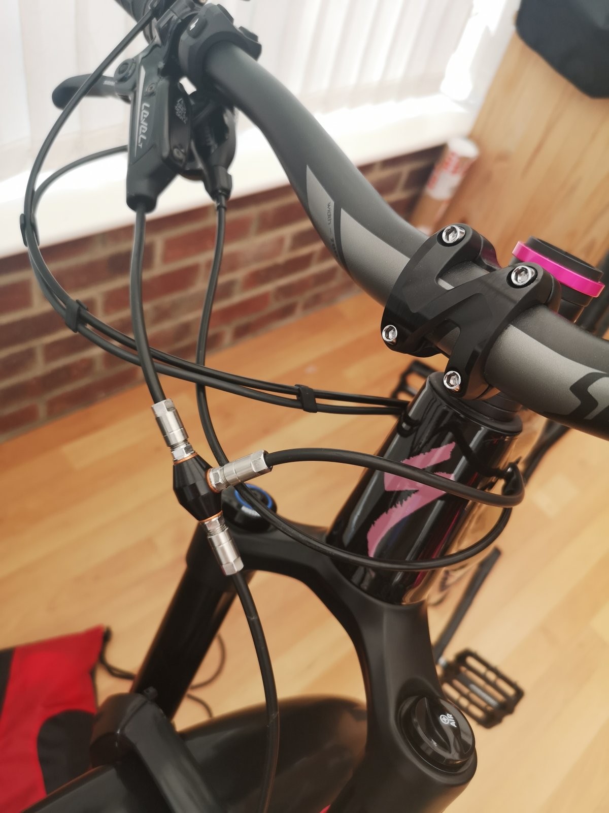

Bet you not seen this mod,...
My Mrs lost a lot of use in her left arm due to blood clots which means she can't operate any levers but can hold on so while she was in hospital I devised ways to keep her riding, the only problem I had at the time was that for all 4 operations she had I was required by the doctors to give them permission to cut off the arm if they couldn't save it. Anyway all came out as well as could be expected, well better than a plastic hand.
Here is a couple of pics of mods I did, these have deen done to her road bike and enduro bike too.

Great engineer thinking, I appreciate

I'm glad to hear shes doing well!
Have you seen the hope lever for people with disabilitys? Allows seperate control of either brake from a single lever. Might work better than having to pump 2x the fluid to make the brake work.
Cross Country - Tech 3 Duo
D
Deleted member 7464
Guest
I have bud but she doesn't want to have to operate 2 separate levers. It would mean having to change 3 bikes too.
Hope sorted the 1st brakeset out for me that I fitted to her enduro as I spoke to them when she was in hospital. I couldn't thank hope enough for what they did. ?????

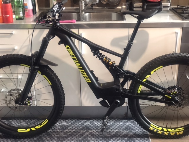

2020 Levo Comp
DT Swiss Hybrid H1700
2.5 Maxxis Assegai F&R
Race Face Turbine R 35 Stem
OneUp 35 Carbon Bars
OneUp EDC Tool
Fidlock Water Bottle Mount
Wolftooth Seat dropper trigger
Hope Seatpost clamp 38.5
Central Coast Mudguard
Spz Mini pump/Zefal Doodad holder & Spz mini co2 SWAT
MSW Wrap
Ergon GA3 Lg Grips
Race Face Chester Pedals
Ergon SM-E Saddle

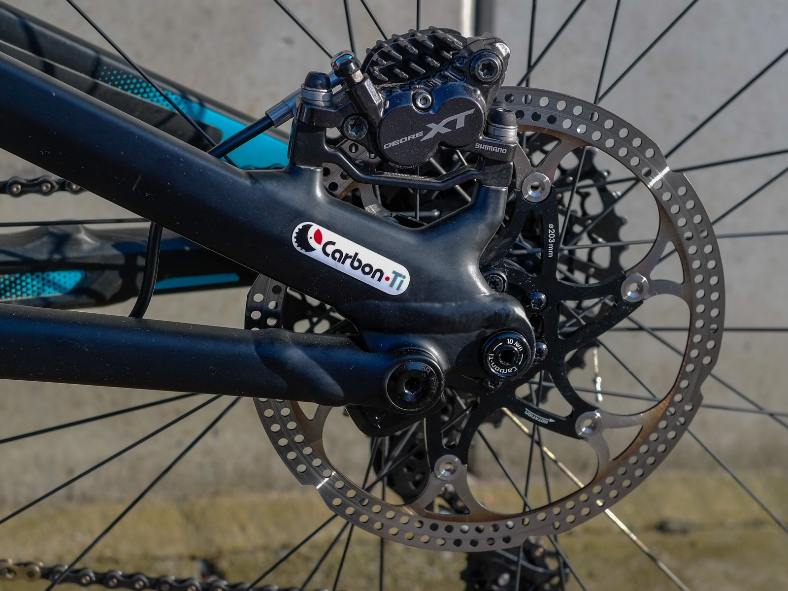

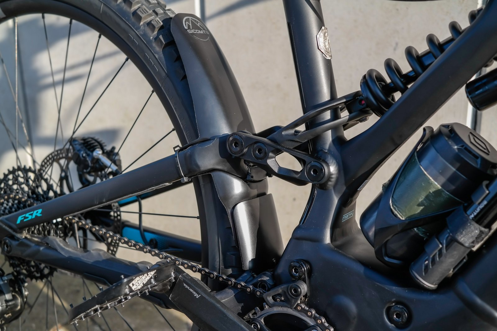

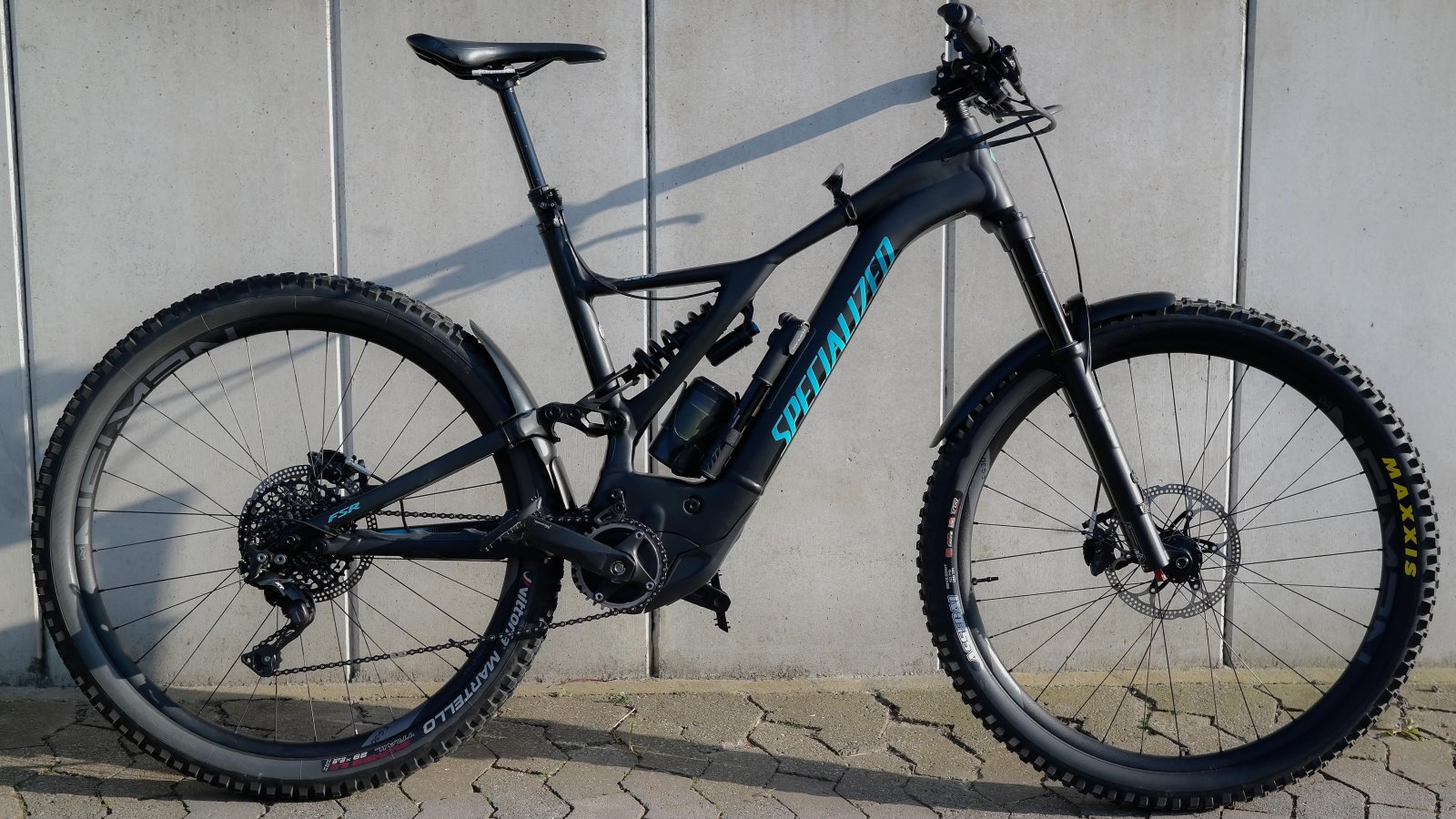

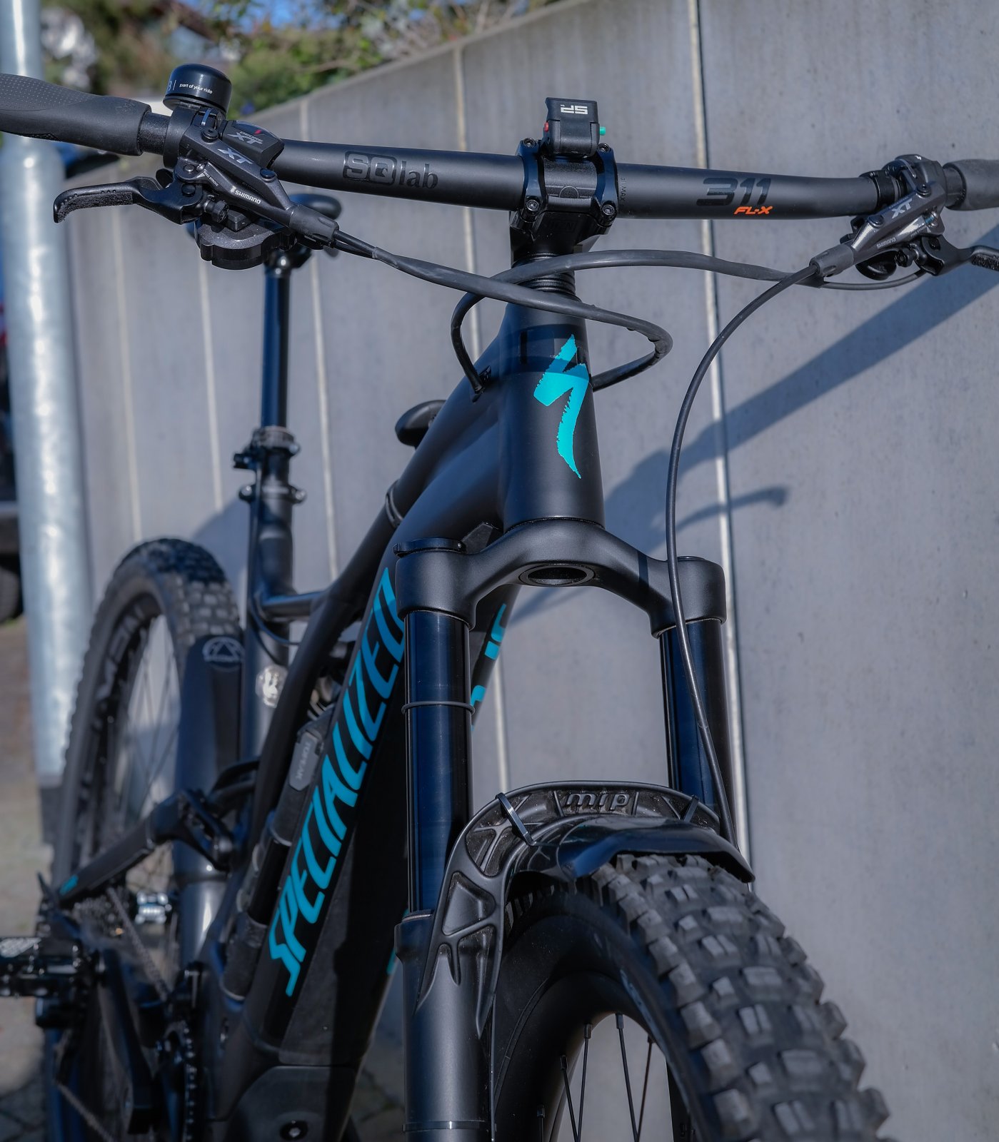

My 2019 Levo base model
Fork: MRP Ribbon Coil with MRP Race Axle
Rear Shock: Marzocchi Bomber CR with Cane Creek VALT
Brakes: Shimano XT M8020, Discs: Clarks CFR-10FA
Stem: Nukeproof Horizon
Handlebar: SQlab 311 FL-X Carbon, Grips: SQlab 711 (the older ones)
Dropper Post Remote: OneUp V2
Crankarms: Miranda Kappa 0, 160mm
Pedals: Specialized Boomslang
Chainring: Carbon-TI, X-Monosync Titanium, 32T
Rear Derailleur: Shimano XT M8000 GS, Shifter: Shimano XT
Cassette: Sunrace MS8, 11-46, Chain: Connex 11SB
Wheels (custom made): DT 350 Hybrid hubs on
29” NEWMEN Evolution SL E.G.30 rims, 32 holes, rear with CARBON-TI Thru Axle
Tires: MAXXIS Assegai 29x2,5 EXO+, VITTORIA Martello Trail 29x2,6
Inserts f/r: Rimpact Original
Mudguards: Mudhugger FRX long, SicoMTB V2
Dropper Post: Vecnum moveLOC 2, 140mm
Saddle: Ergon SME3

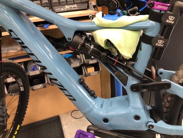

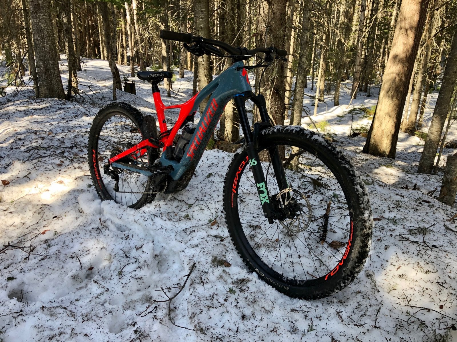

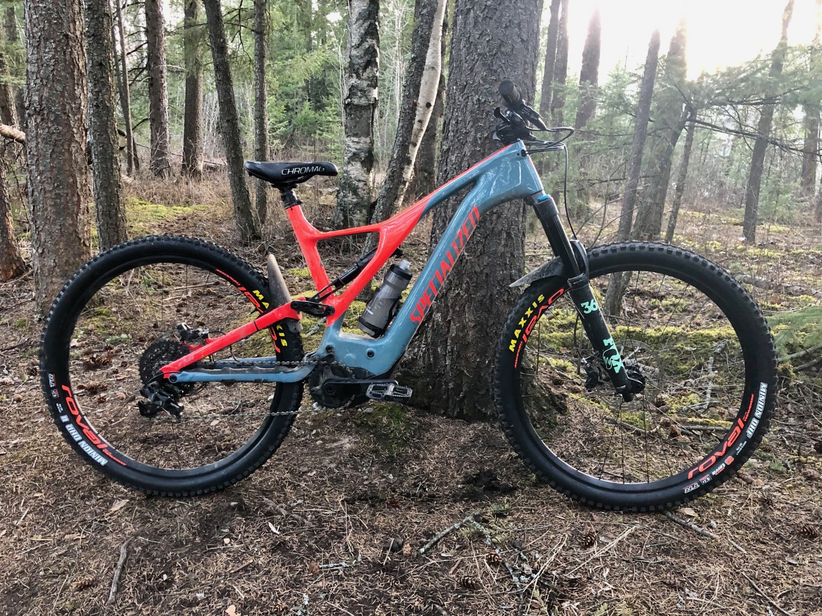

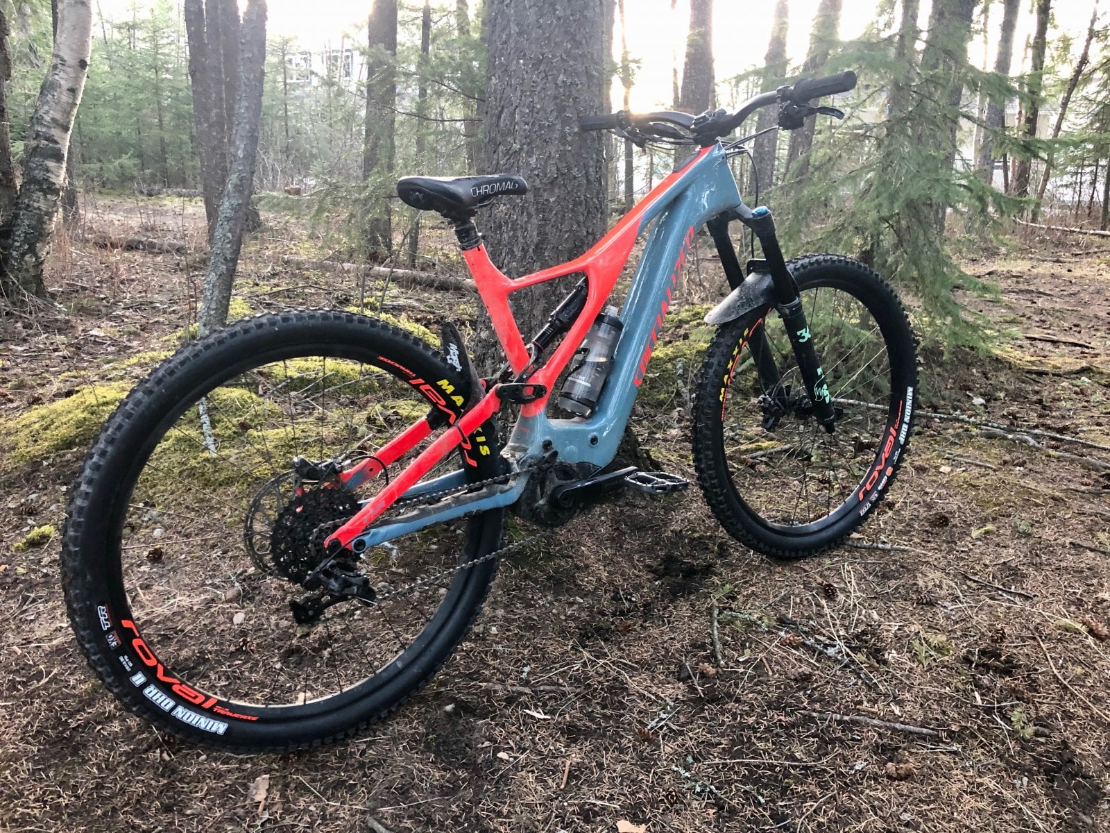

This is the start of my Custom Enduro Turbo Levo Build
-2019 Specialized Turbo Levo Expert
-2020 Fox 36 Float 160mm 44mm offset
-One Up Carbon 35mm Rise Handlebars
-One Up 35mm EDC Stem
-Maxxis Minion DHF 2.5 Front
-Maxxis DHR2 2.3 Rear
-One Up EDC Stem Tool Kit
-One Up Plastic Pedals
-Chromag Overture Seat
-DMR Death Grips
-Lezyne CO2 Canister (Under the Seat)
Next up will be a OneUp Dropper, Carbon wheels and Shimano Xt 4 piston Brakes
More information in my build Thread.

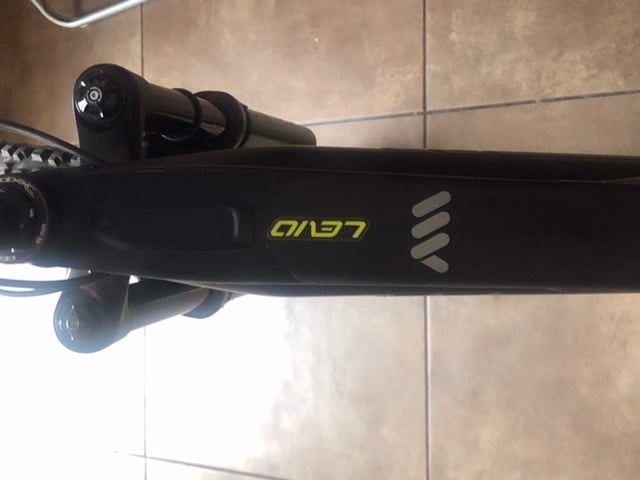

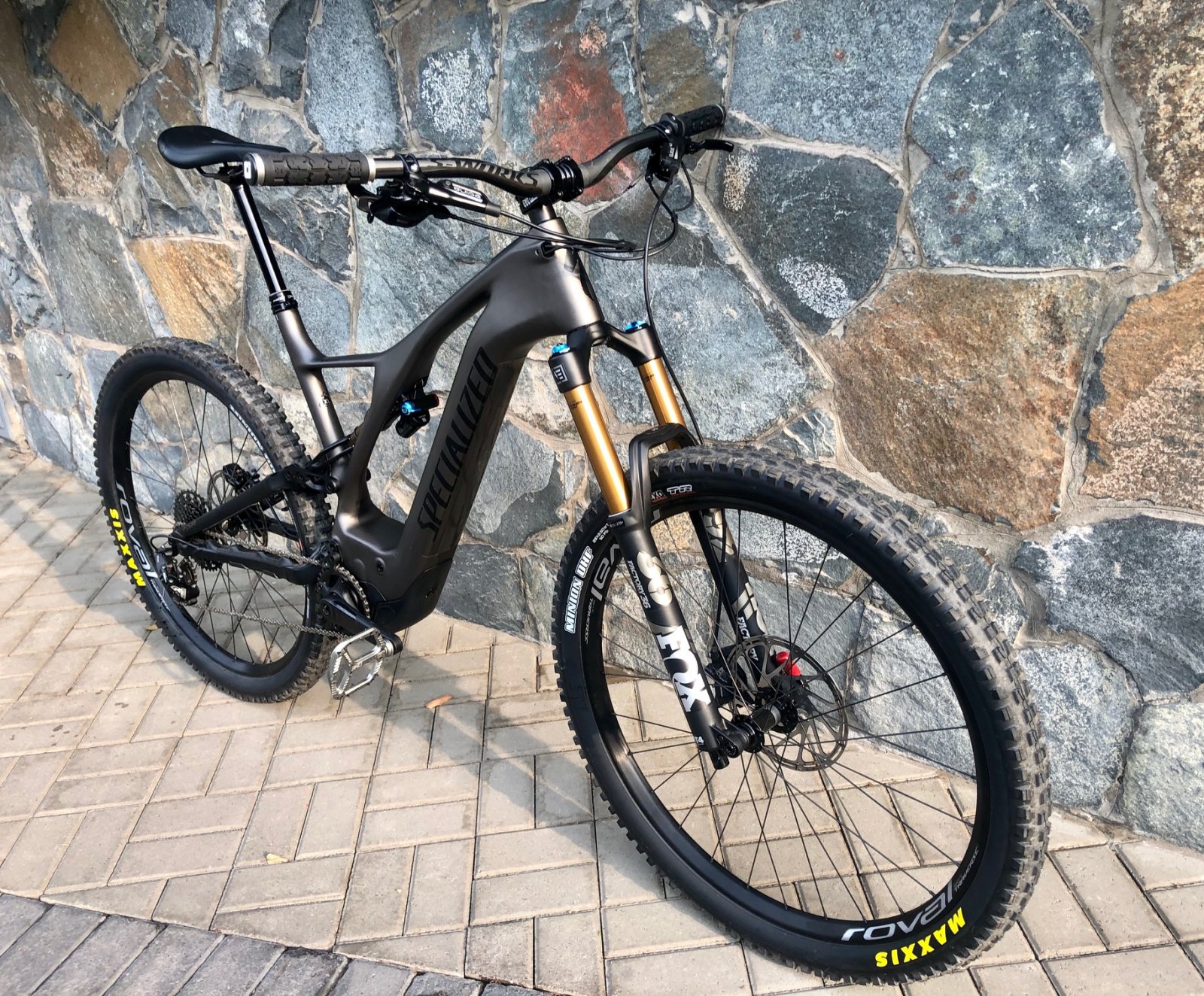

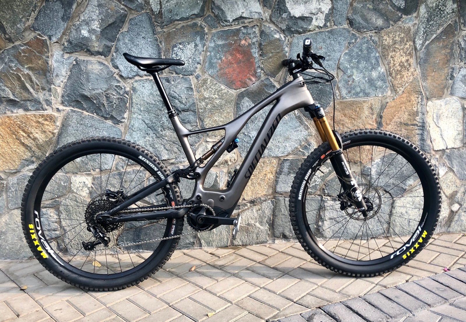

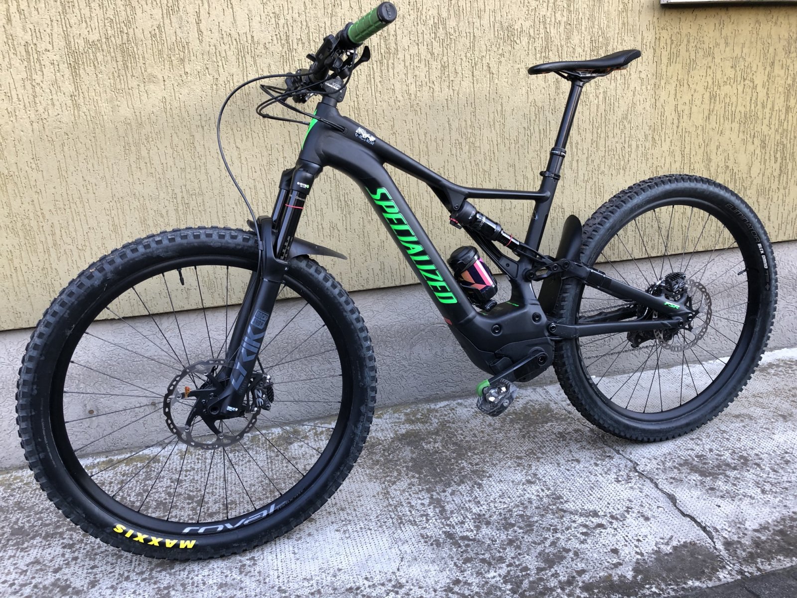

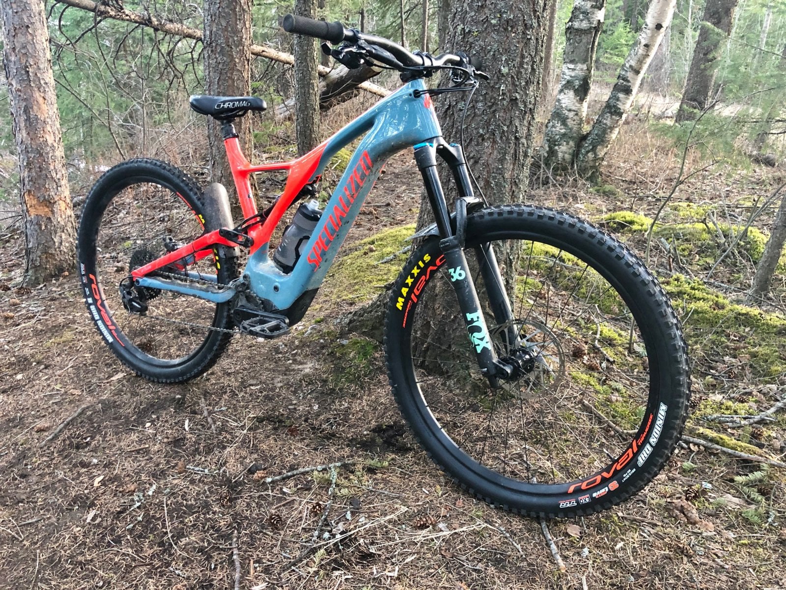

I had some fun last week “modding” my 2020 Comp Carbon, yep you read that right, 2020 Comp CARBON. Love this bike!
Tell me what you think guys.
View attachment 22151 View attachment 22152 View attachment 22153
COMP CARBON 2020 Gunmetal
Fox Factory 36
DPX2 Factory
S-Works 3.8 carbon bar
Deity 50mm stem
Ergon SM E-Mountain saddle
Alu One UP pedals
ODI Rogue grips
Alu Specialized dropper remote lever
Fidlock magnetic cage / YT bottle
Levociraptor
DHR 2.4
DHF 2.5
Slik Fox & Roval decals

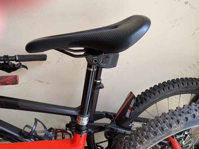

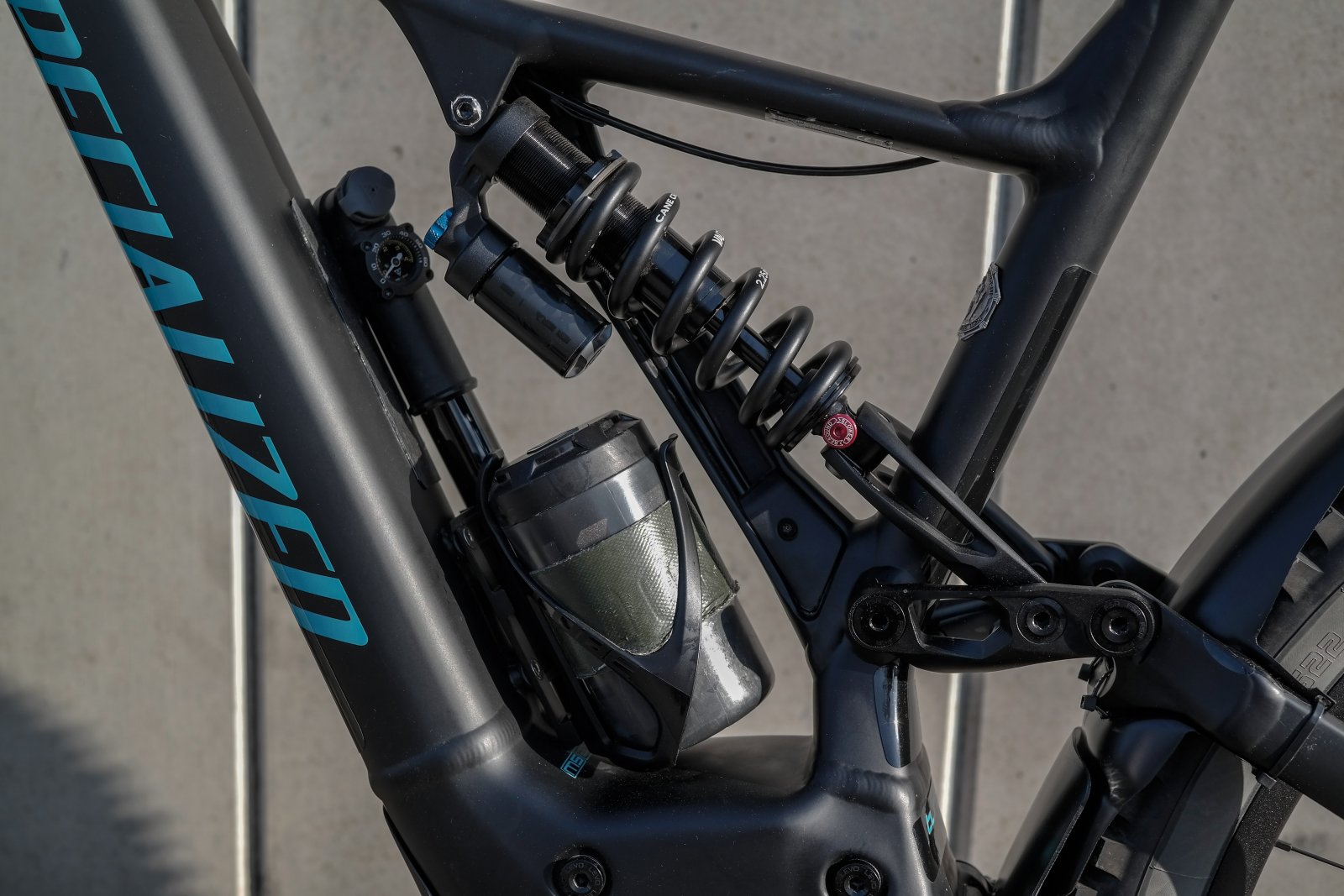

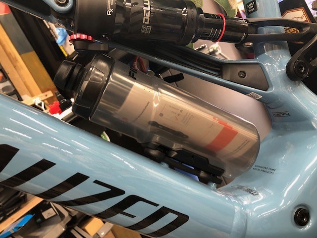

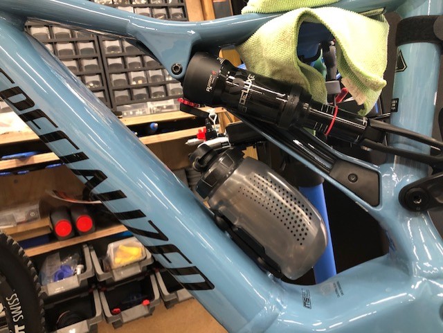

Hi, I have been looking at the fidlock bottle cage but was worried about the clearance since I have the dpx2. What size bottle can you fit in there and does it rub on the shock?
Squatch
Feb 20, 2020
26
28
Washington State
If it helps...... Here is a picture of the Fidlocks with a Deluxe Shock. The small bottle fits fine and the large bottle just touches the lever.

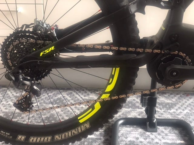

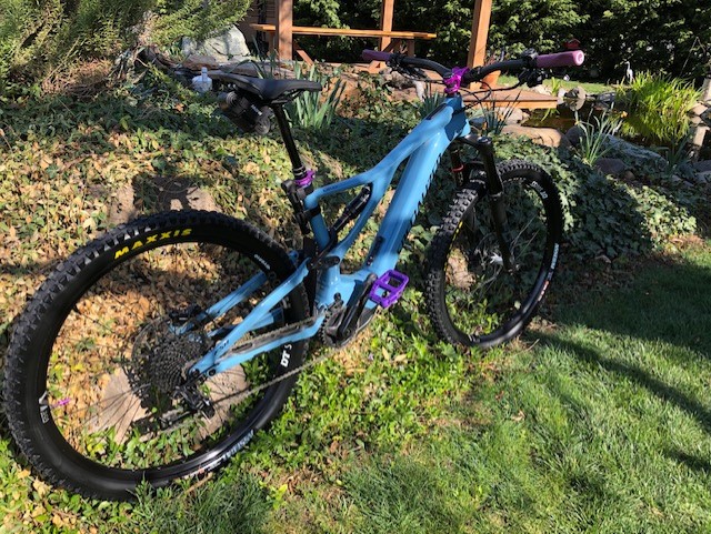

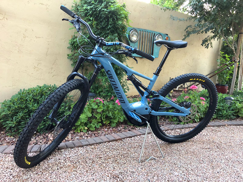

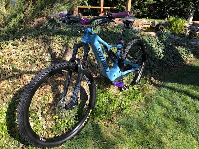

Owned my 2020 Levo Comp for about 4 months....few mods so far to suit my liking....
Diety 760mm bars (50mm rise)
Pivot Phoenix Padloc grips
Pivot Phoenix WTB seat
36T Praxxis chain ring
Rsilvers chain guide mod
Homebrew Kydex skidplate
29x2.6 Traxxis Minions (DHF, DHRII) tubeless
