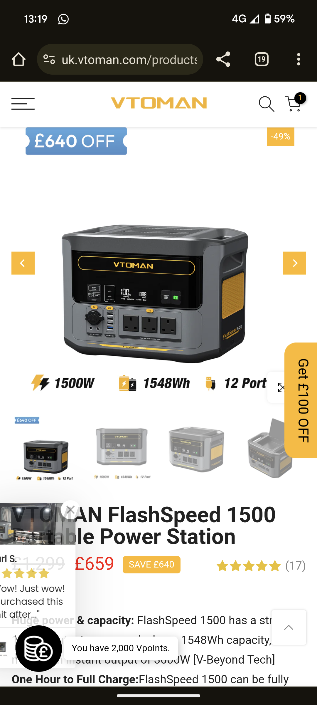

Edit oh the jump? I would suggest the flashspeed being similar in price and newer.
kefconstruction
Apr 21, 2023
160
140
Hull
This is the one I'm looking at
