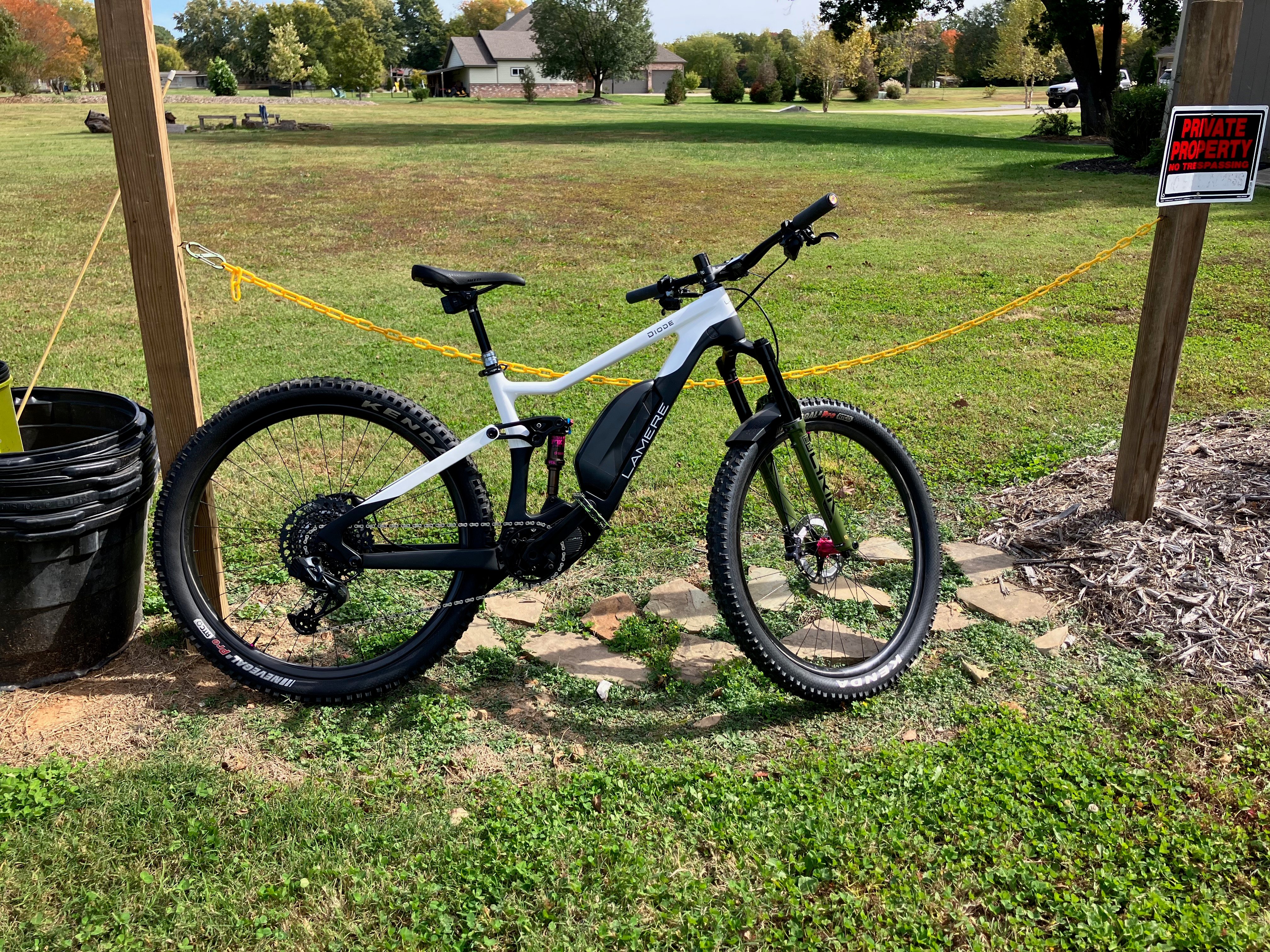

I rode this 28mph Shimano powered bike at Outerbike Bentonville 2023 - I think a one-off custom build
HandsomeDanNZ
Jun 16, 2024
290
561
Auckland NZ
I've said it a few times, but my Shimano EP6 was set to max 45km/h assistance from the shop - by a Shimano rep.
There are a few 45km/h Shimano-powered bikes available here in NZ, where we don't have legal speed restrictions.
It's not customised, it's just an available firmware setting that the shop or manufacturer can choose to install
