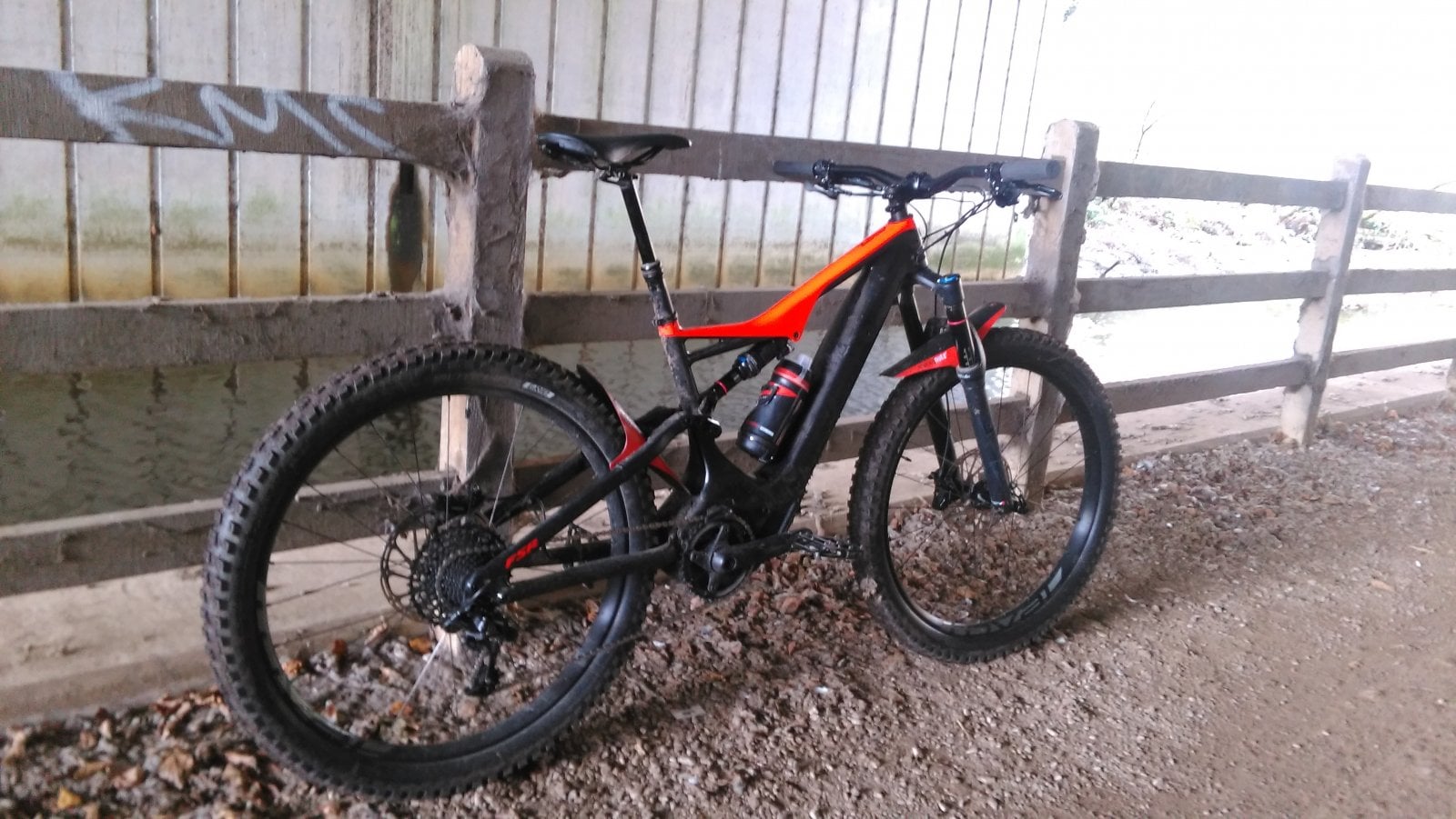

Please help me find a mudguard that fits on my 2019 Levo Comp (see pic below)

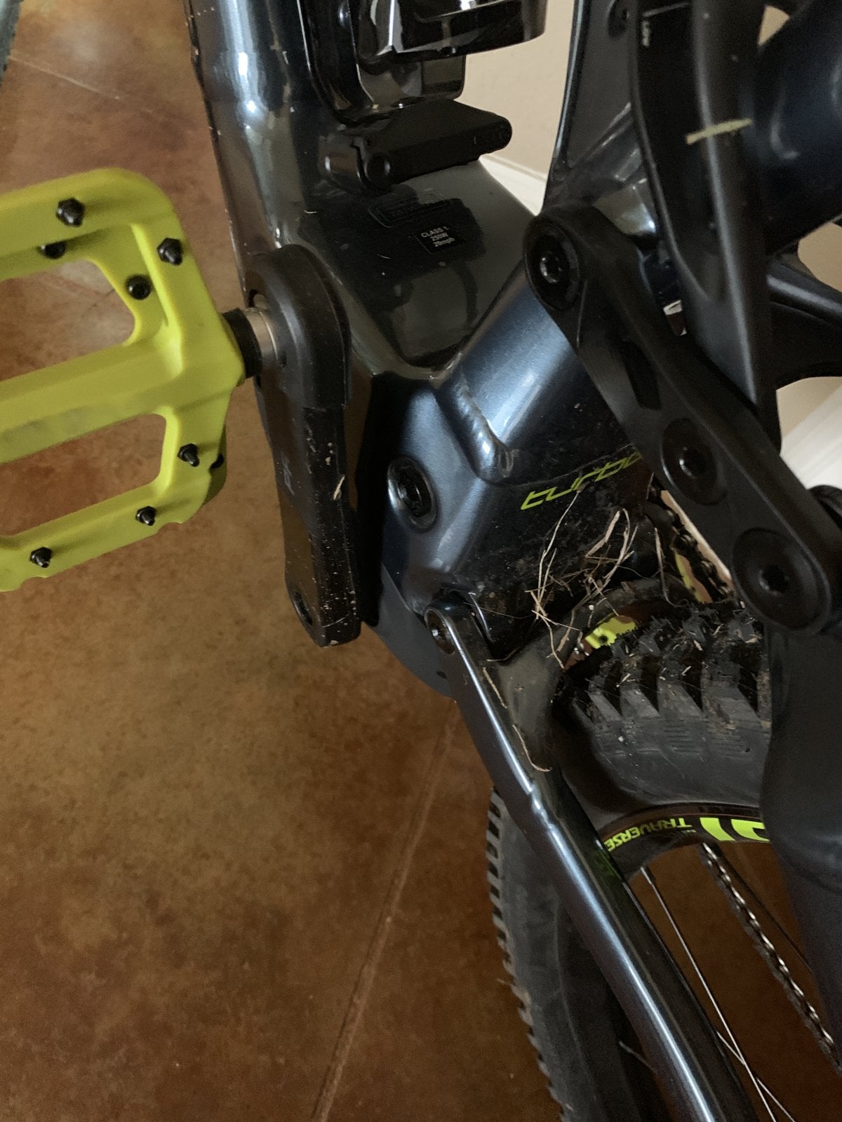

Are you looking for a mudguard, or something specific to stop the crap getting in the motor casing?

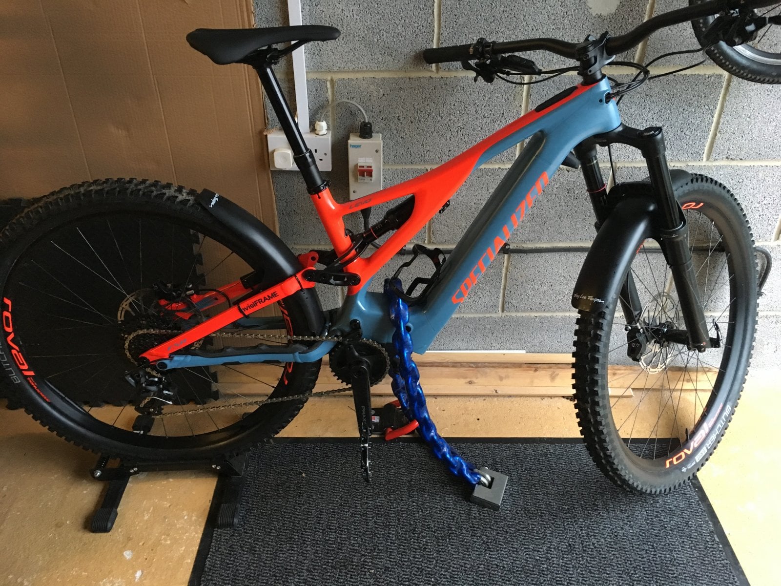

I have actually changes my mudguard set up now as I found a better fitting solution. I now have a mud-hugger SRX on both the front and rear in Sam Hill style. Even on the rear it works really well and is a much better looking fit in my view. A little tight on the rear for clearance but it fits and keeps a lot of mud off the rear area of the motor. Here is a pic.

I like that! Thank you.

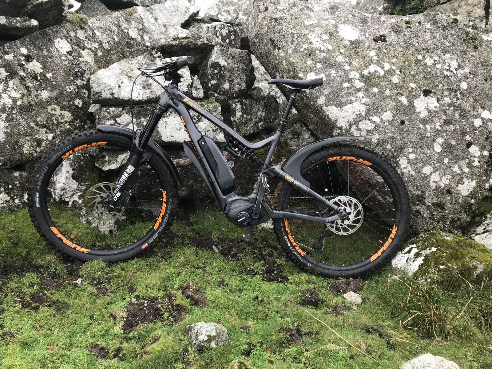

Mudhugger is about the only effective rear guard I know of that works with suspension , but it’s aimed at keeping your back clean and has little effect on the lower area behind the motor .
The front one I have in the pic is the best front I’ve come across from pro guard , they do a neat little rear that protects lower area for those who feel a proper rear mudguard is uncool ?

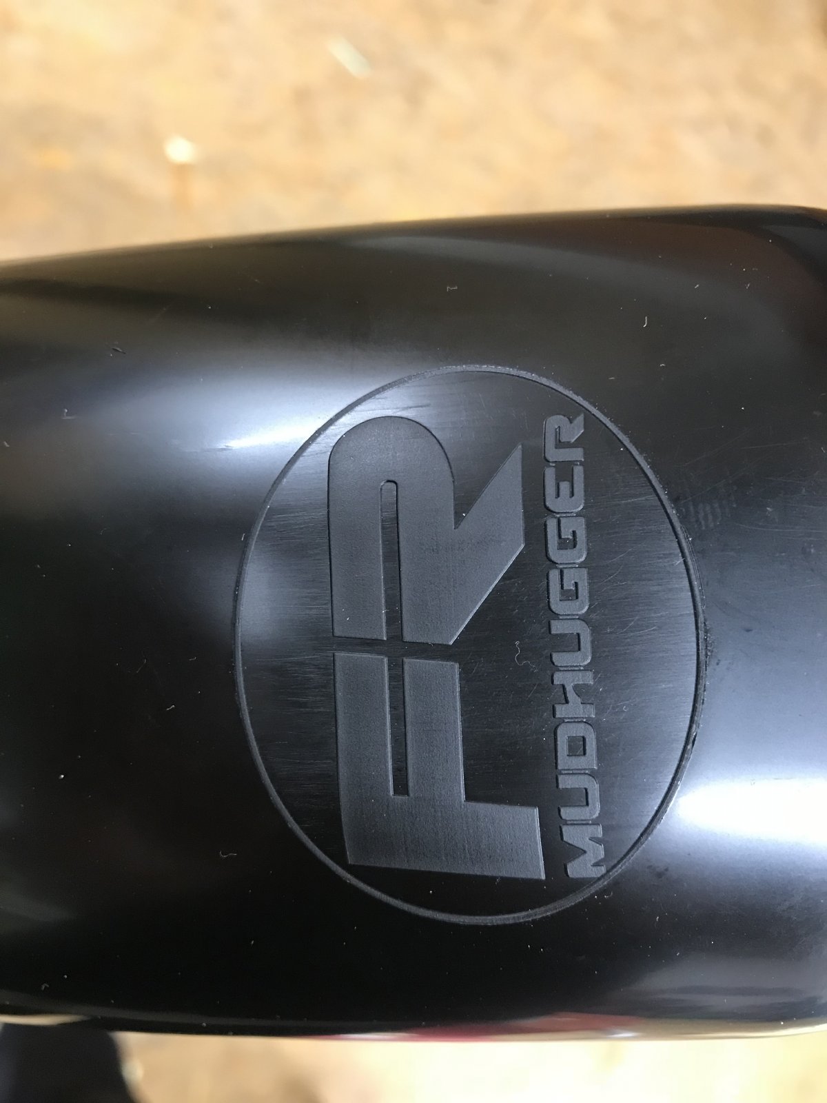

The Levo MY19 is a bit more tricky than the 2017/2018 as clearance is not as good. On my MY17, I have a Mudhugger Shorty but the clearance of the Shorty is not great with the MY29 Levo. Instead, I have installed the MH FR that was kindly provided by Jamie @ MH. Have been riding with this for a few weeks now and have not had any issues with clearance.

I use some MuckyNutz fat bike guards. When it is wet, i use one on my saddle rails too but it doesn't do too much! Front one keeps shite out my eyes and rear just keeps the bike a bit tidier.
After seeing the tight fitting guards above, mine look awful but they look better in person than they do in my picture (in my defense :p )

Thanks, all! After looking at the suggestions above, I got a Mudhugger FR and cut it slightly (the material is very easy to cut through) to fit the rear; and a Muckynutz Full Face Fender for the front. They were easy to install and work great on my 2019 Levo.

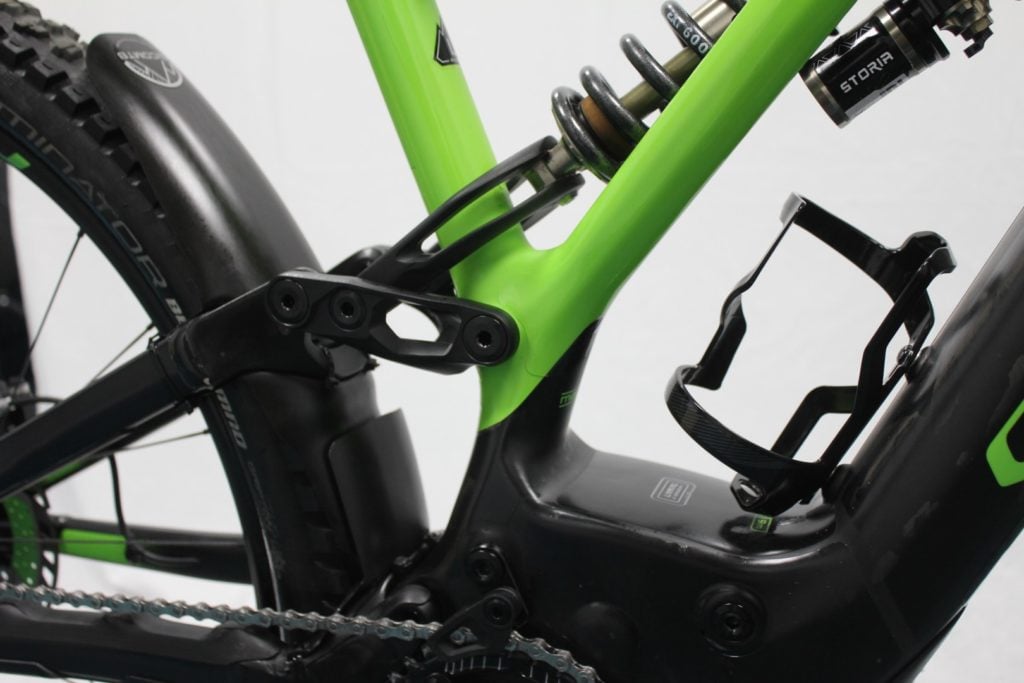

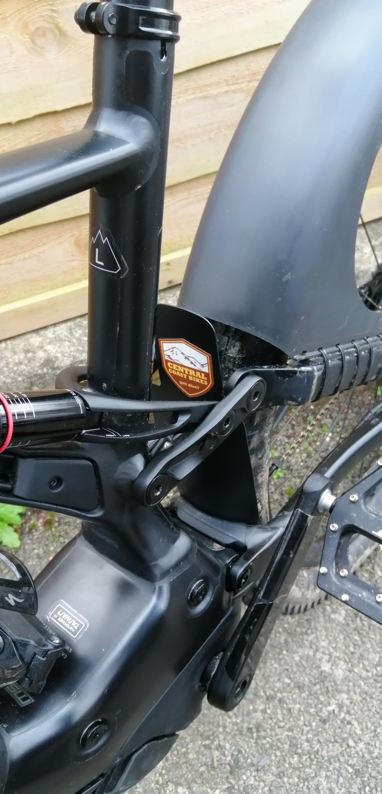

You could try the Central Coast Bikes lower mudguard (see photo). This mounts using two bolts on the motor housing. I've then fitted a mudhugger onto the seat stay for full coverage. I bought the lower mudguard from ebay for about £16.

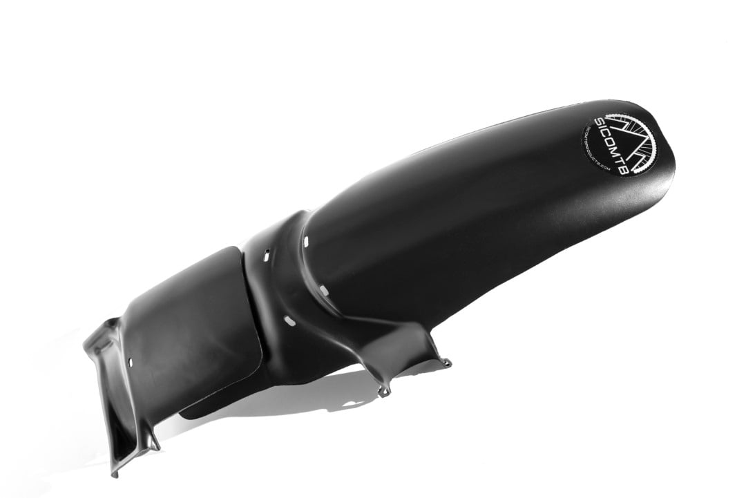

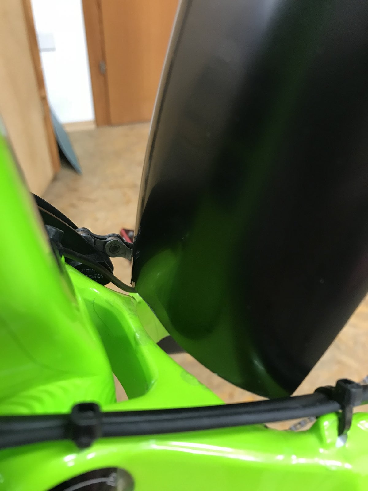

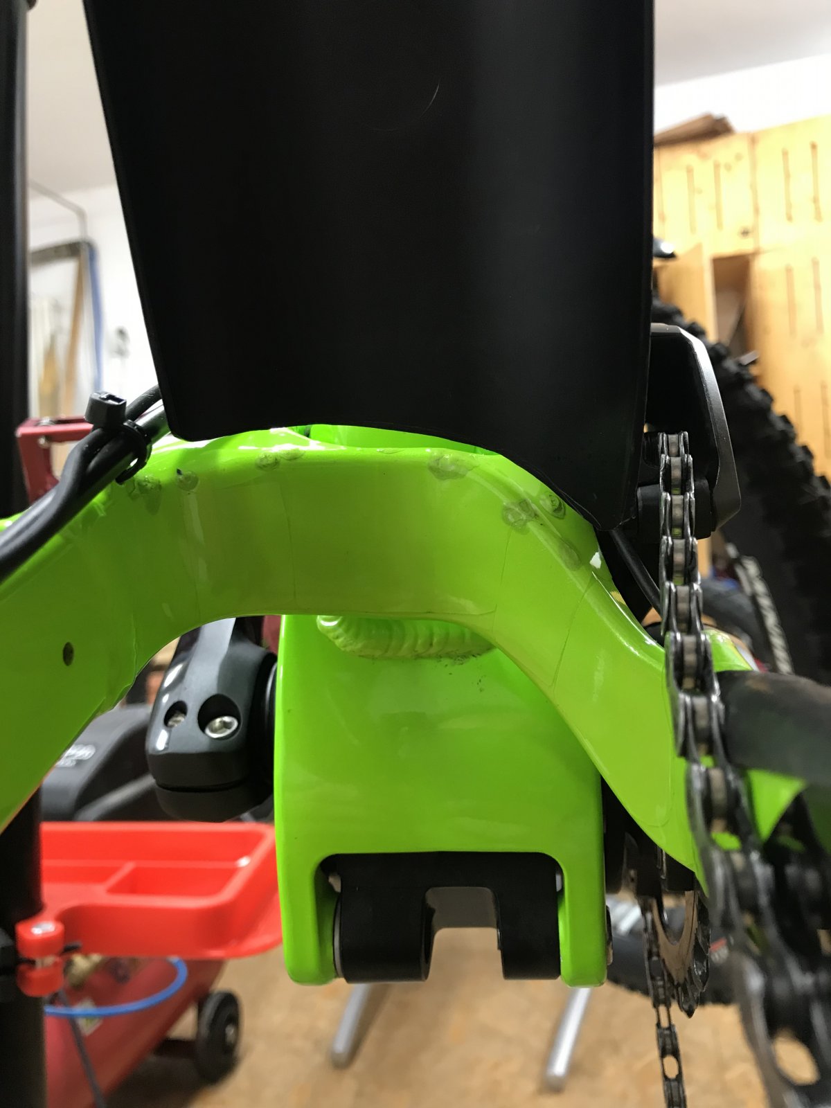

If you'd like something a bit more comprehensive and doesn't require any modifications or bodging, we do a two piece rear mudguard that is designed for the 2019 Levo. View attachment 26521 View attachment 26522
I have been using this for a while on my 2020 Levo Comp and I am very satisfied there. The space between the tire is tight but just enough.
Only if you want to thoroughly clean the Levo does the rear wheel have to come out. Mud sticks to the mudguard that you cannot get sprayed away with the garden hose because the space is so narrow.
A very good product!

I went for the Central Coast design over the SicoMTB because I live in the UK. The SicoMTB design looks wonderful, but the mudguard isn't long enough to cover the rear wheel, so I would get plastered with mud in the winter. The Central Coast + Mudhugger combination doesn't look as nice, but the extra long Mudhugger keeps my back clean during the wettest of rides.
SicoMTB
Trader
Feb 24, 2020
7
16
Hey Dave! We're based in the UK too! Interesting to hear you've been looking for a longer mudguard. A lot of our customers have been asking for a shorter version, so we've got a shorter one in the works. Shame we couldn't help but glad you got it sorted! (y)
