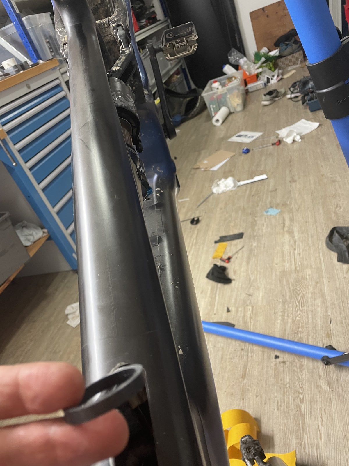

i had extreme knocking/ rattling sounds, always on shaking root lines. sounded like a loose part knocking from inside the frame.
But Nothing to hear when shaking the bike in the stand.
I now searched all the frame internals several times and found that Specialized imtegrated me some secret Swat spare part:
That carbon spacer was in the top tube end near the seattube and rattled as hell !
Perhaps other rattling levos also have integrated secret spare parts by speci assembly line ?

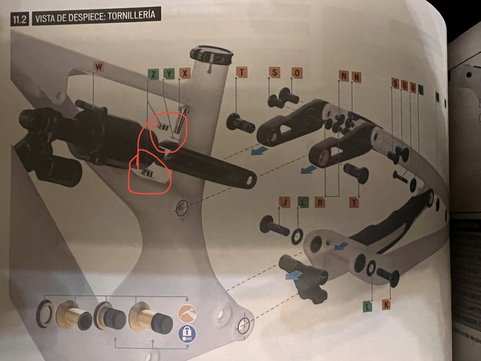

My rattle is gone 👍🏻🎉. I recently installed a cascade link on the bike. During the process when I took the original linkage off I noticed the plastic spacers that snap into the bearings, that one of them was sitting out a little bit. With the new link arms I ensured that the spacers were pushed all the way in and now there is no more rattle off the back when the bike drops over something sharp. It could have something to do with the old link bearings but they seemed fine. So maybe undo the bolts at the seat stays and shock yolk and check to make sure those spacers are pushed all the way in, and I would also recommend regreasing everything inside there as well.

I'm happy you were able to fix your turbo levo rattling! congratulations. but I'm not sure if I understood what is the spacer you are referring to. The one that is connected to the shock will be the one in the attached photo? Thanks for your help in advance!!!
Watch this video at the three minute mark and you will see the spacers that I’m referring to that push into the linkage. One of mine was not pushed all the way in. When I installed the cascade linkage the spacers pushed all the way in. This was the only thing that I’ve done that has stopped the clanking sound in the back. And the sound that I was trying to get rid of was not a rattle it was more of a clicking or clanking sound when the back tire rolled over something sharp.
Thank you very much for the video, I already understood what the spacer you mention is and you are telling me that it was not placed correctly. I will check if it is my case, thank you very much for your help.

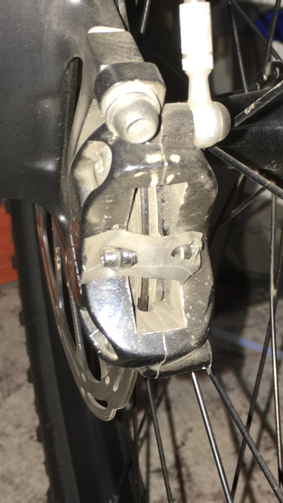

2022 Gen 3 expert carbon and a rattle, turns out it was the rear brake cable hitting the seat stay, near the caliper. Solution was put a sticky pad to dampen it.
On most bikes it is fixed on the chainstay such that it is pretty tight against the seat stay and protective film is stuck on the seat stay. If it is loose enough to rattle maybe check the fixings

it was as you said but between the fittingclamp and the caliper its was knocking the seatstay
