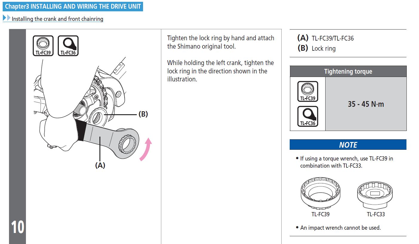

WAY to GO FEZZARI...
They are sending me a new motor and a shipping label to send the dead DU8000 back to Shimano. The motor is only 6 bolts and 3 wires on my bike, so it only takes 20 minutes to R&R***. I'm STOKED Fezzari got involved with this, put it on a fast track and got it sorted for me in an acceptable amount of time.
***You do need to have specialty tools or a nearby shop who will R&R the lock ring. See attached snip from manual.
Just a note: The lock ring is righty-loosen, lefty-tighten...
***You do need to have specialty tools or a nearby shop who will R&R the lock ring. See attached snip from manual. View attachment 18914
That's what I call great customer service.
