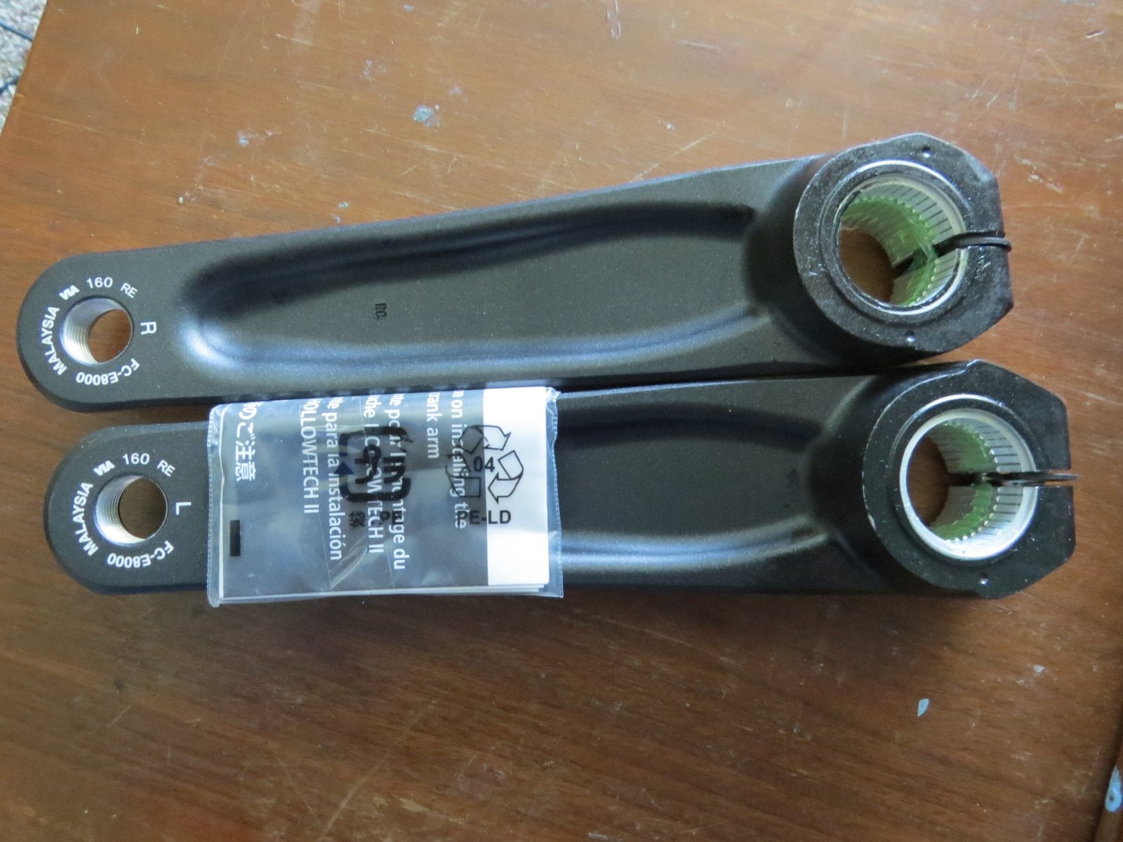

Blueskycycling.com here in the US has shorter shimano cranks arms, 160, 165, 170 and 175mm. I didn't know that the FC-8000 was available below 165 and ordered one for my Focus Jam2 C. Only $35.00 USD
Do you have a link because when I look the 8000 and 8050 cranks are'nt available in anything less than 165mm and not at the prices you state!
I'll keep you posted. It says 160mm and 5 in stock but I just received a response that they are out and had to "re-order", lol. I'm expecting them to say only 165mm is available very soon and I'll just try to get those. Here is the link: Shimano Steps FC-E8000 MTB E-Bike Crank Arms
Update: Bluesky sent me the wrong crank arms today, 175mm instead of 160mm. The part number on the 160mm size is AFCE8000MX and I've seen them on French, German and Japanese websites so I'm pretty sure they do exist. These are not the hollow tech style but solid crank arms. I heard from Blueskycycling that they are sending out the right one and I will post a pic of it when I receive it.

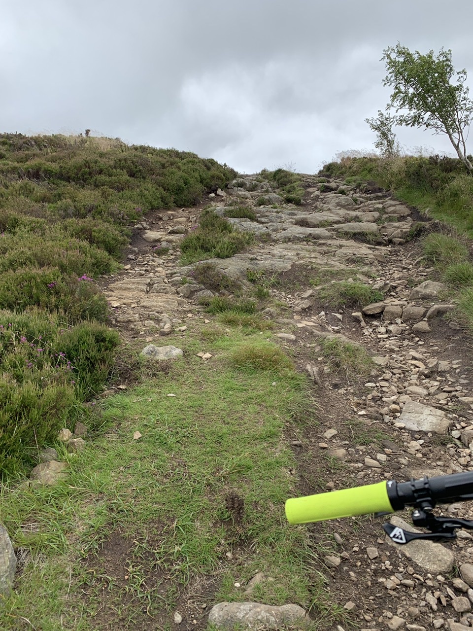

Just thought I'd update the thread.
Having ridden a lot since posting this a year ago, I'm happy to report that (albeit with a different bike) pedal strikes are a thing of the past, pretty much.
For the past 3 weeks I've been riding my local forest trails almost daily. I'm now very comfortable attacking the roots-into-rock garden section that always used to give me problems.
The key has been pedalling strategically (obviously!), line selection, level pedals over the obstacles, and keeping relaxed and supple on the bike in the attack position, so it can move laterally or vertically with minimal resistance, taking the hits through my core and quads rather than keeping the bike weighted too much.
It's very satisfying.
