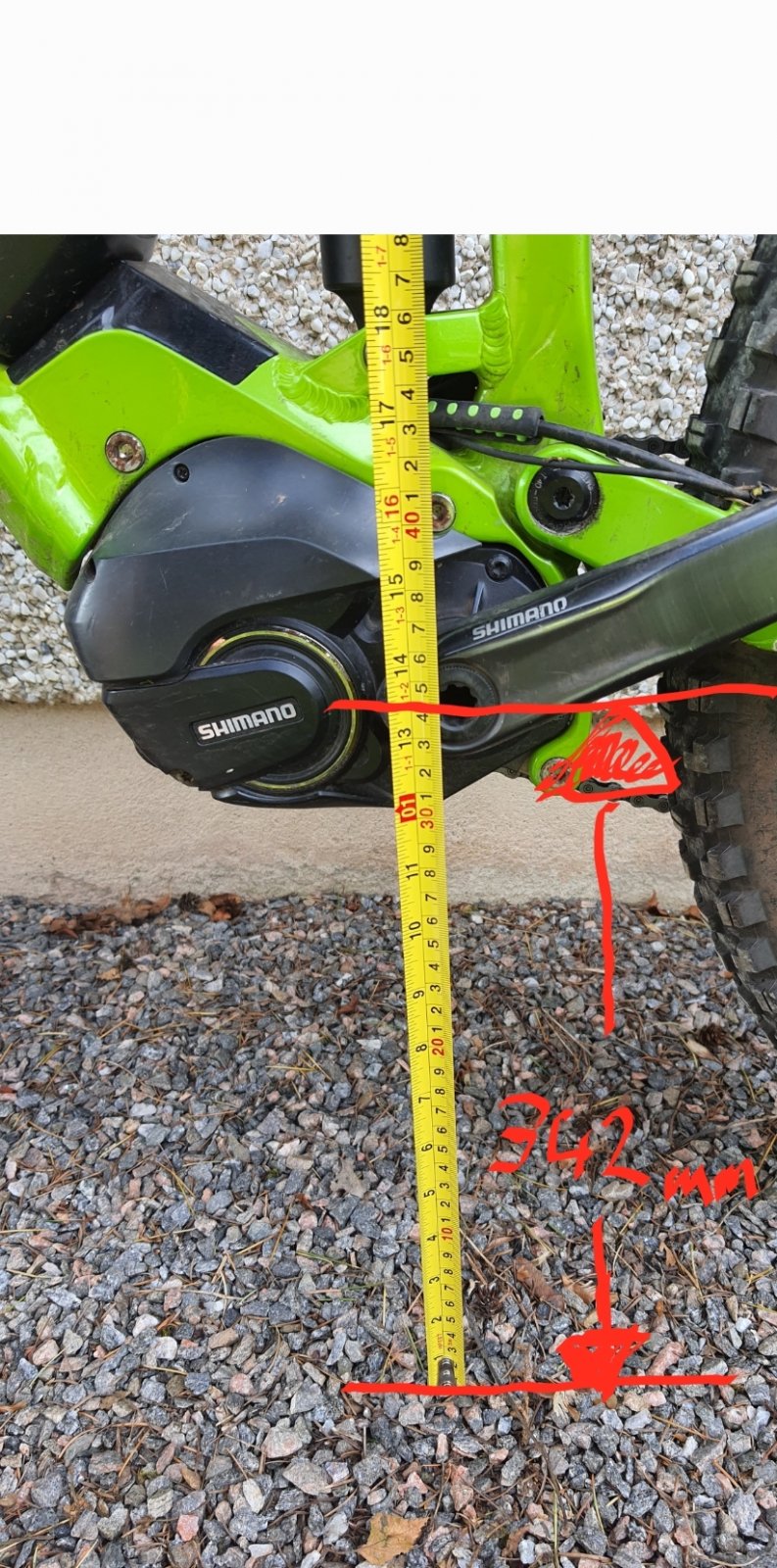

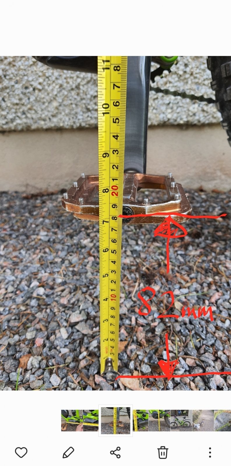

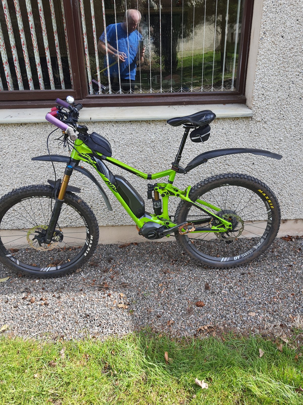

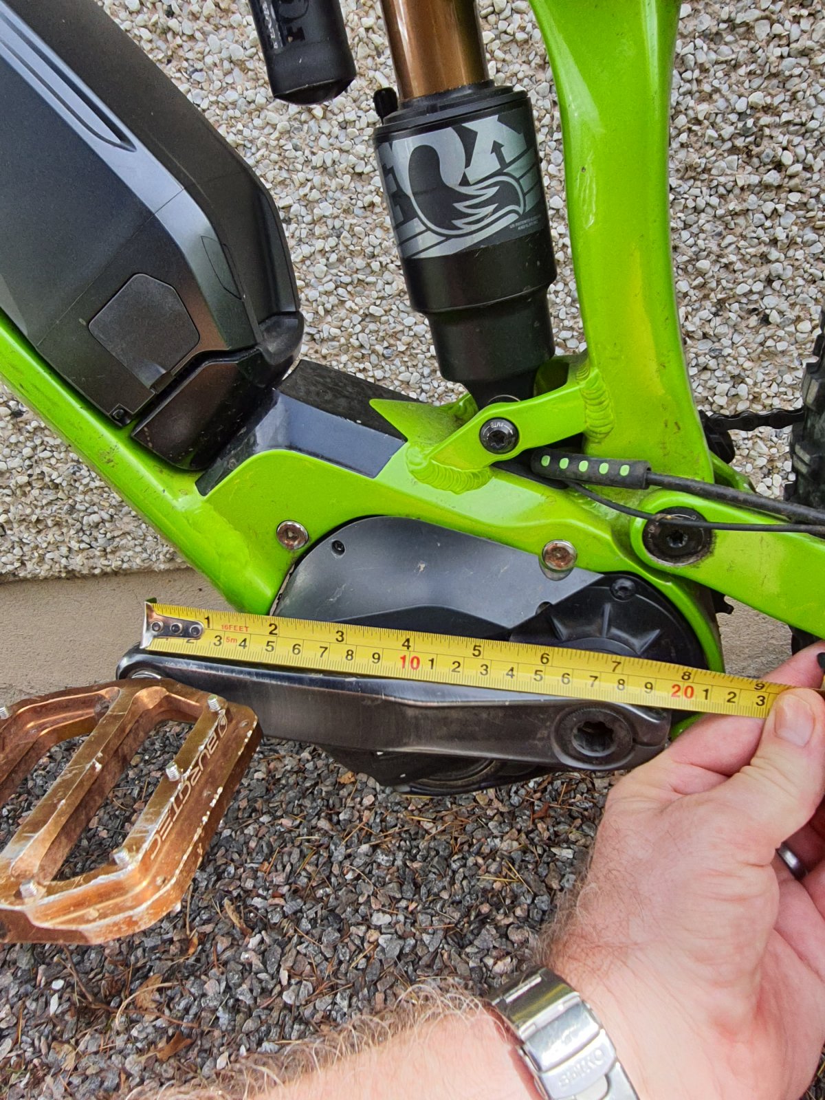

Here is my issue and Im hoping that some of you experienced riders and boffins out there can help me.
Since I got my Merida E160 900E in 2018, I find that i am experiencing a lot more pedal strikes than I did on my old Manual Cube sting, despite there being quite a good ground clearance. I wondered if the pedals cranks on an e bike were longer than those on a regular bike but thought that (due to the principles of leverage) and the electric assistance, e bike pedal cranks would be shorter!!! A straw poll amongst my friends with e bikes reveal that the ground clearance on our , full suspension bikes, is within a few mm of each other as are motor centre to ground distance, pedal crank length and pedal centre (in the crank pointing vertically downwards) to ground distance.
These strikes only occur when off road in forests and woods etc and more often than not, when I am turning or banked over slightly. I suspect it is because I am trying to keep the power on in the twisty bits where before I would always keep my inside pedal high and out of the way. I was wondering if any of you had experienced an increase in pedal strikes, or had any opinions to offer? Some pics attached to help with my question. Tui.

I'm going to suggest it is more technique than components or geometry. Your bike is actually slightly taller than my Santa Cruz Hightower, and it appears that you already have 170mm cranks. The only other thing I could think of is if your sag is set too large and the bike is squatting too much.

As you've found, your bike doesn't have a particularly low BB for a 160mm travel 27.5 FS mtb.
The Shimano steps system also doesn't use a different Q factor from normal bikes and your Burgtecs don't actually extend all that far from the crank (because of their extremely short axles)

8,969
9,366
That 82mm ground clearance is actually only 73mm after half the pedal thickness is taken into account. Then that too is reduced by another 48mm after 30% sag on your 160 travel bike. That leaves you with 25mm, or even less if your speed on a corner is depressing the suspension further!!! You don't have to lean over much to catch the ground with that amount of clearance! So stop pedalling when leaning over and maintain awareness of where stumps and rocks are so that even on the level you don't hit one.

Forget all your measuring, get yourself a pair of Miranda 155mm SH Delta's cranks, If you are a short ass, you can get 150mm. I'm 5'7". I have had them on three ebikes which came with 165mm cranks...end of pedal strikes and I ride full on downhill enduro. If you are using 170mm cranks it will be a nightmare as I know you will be pedal striking constantly..as I say Miranda 155mm. Trust me I know what I'm talking about. ?
