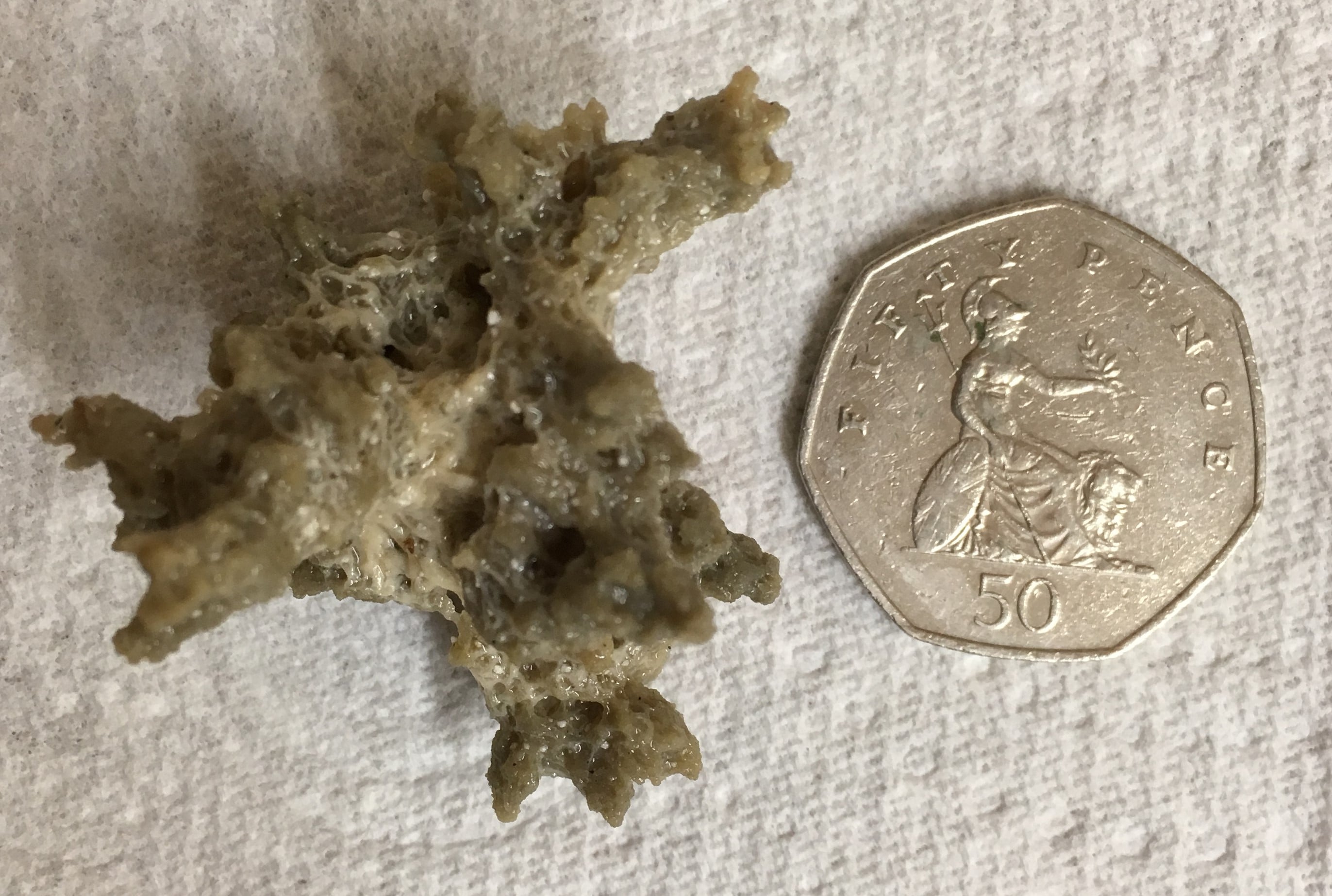

Have used Orange Endurance almost exclusively for c.7 years. Works well and doesn't clump (other than in punctures where it's supposed to😆). Needs top-up maybe 2-3 times a year.
I have recently used Peatys for 1st time (originally got for different useage i.e.not MTB) but too early to comment - particles seem quite large so presume might seal larger holes 🤞

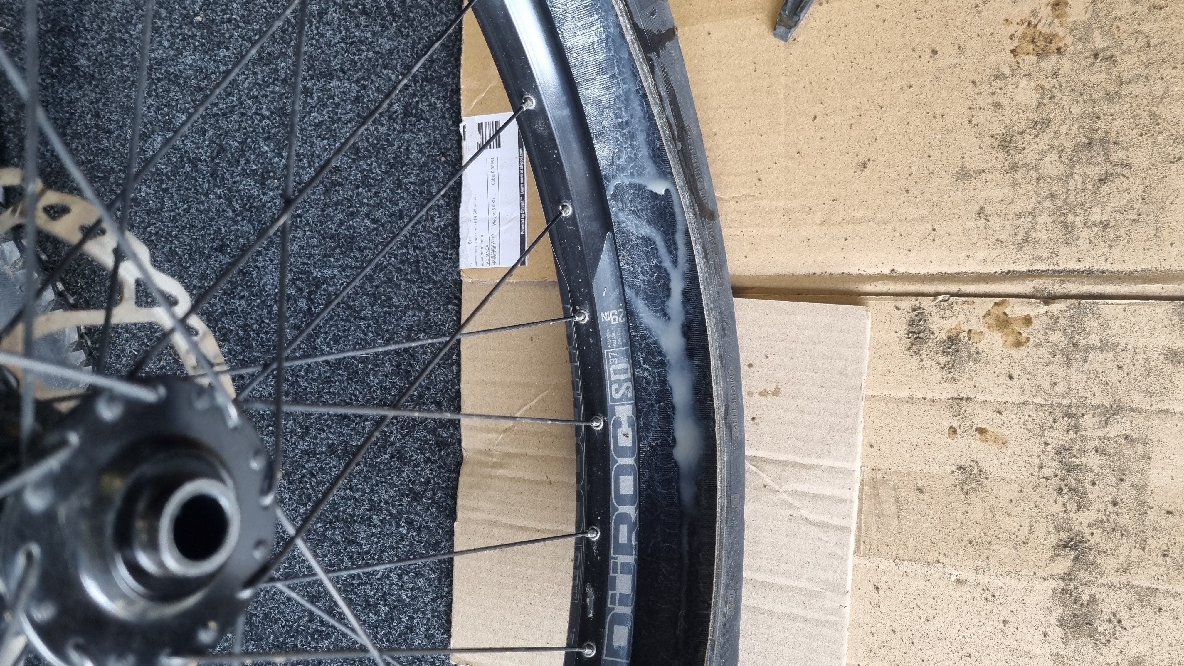

This is how much stans sealant was in my tyre when I changed it out the other day. Still sealed fine, but I presume it wouldn't have done much if something had punctured the tyre? Made me wonder why they recommend 100 to 150ml...
