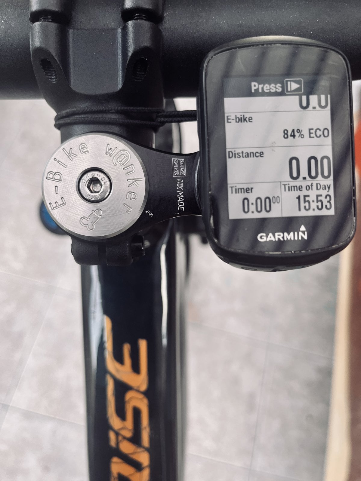

How did you get the EBike field to work with your Edge 130 ? I’ve been trying for hours and am ready to throw the device to the moon!
Well by some weird coincidence or wonderful witchcraftery, after posting the above and trying to pair the Garmin for hours last night and this morning, it’s suddenly come to life and all is good! 😀

Sussed out what the issue was and its really simple, and probably already been said before
Once the EBike field app is installed on your Edge 130+ and data field configured, when connecting to the bike, ensure you turn on your Garmin first and then power on the bike, not vice versa

You just to add the bike as a sensor, BUT start the garmin searching first, then power on the bike, the shimano motors will only connect to an app or device for the first like 15 seconds after they are powered on. Very annoying when you want to tweak a setting in e-tube..
Just set up my wife's 130. When you search for sensors it says it can't find any, but the e bike field has got a bike code number now and it seems to be working (though just in the garage it was only updating the mode and not giving a battery %age, but I see that same behaviour with the other app. Battery % doesn't seem to come through until you've been riding a while which is really annoying as it would be nice to know the bike is fully charged before you set off!)

Make sure you turn the Garmin on first, then set it as though you are about to go on a ride (searching for GPS etc), then turn the bike on. Battery % and power mode should show instantly. I was faffing with the app for hours last week but eventually sussed it all out

Sorry, I’ve read what you just quoted from me and my description was a little misleading
When I said pair the bike with the phone, that’s using the Shimano E-Tube project app
Jan’s E-bike field app is downloaded onto the Garmin 130+ - I did this using my laptop, Garmin Express and the USB cable
I’d already configured the e-bike field into the data field on the Garmin, that process is simple and can be easily done on the device
To then pair, it’s simply a case of turning the Garmin on, setting is as though you are about to go for a ride, ‘e-mountain’ on my 130, then turn the bike on
On my data field screen I immediately get the battery % and power mode shown on the single e-bike field I added
It should look something like this …

Yes it will say ‘off’ at first when I turn the bike on, then eco, trail or boost depending on which mode I select
On Garmin Express, in the settings on Jan’s app, you can choose how you want the info displayed. You might have a number from 0 to 3, 0 being off, 3 being boost ?
