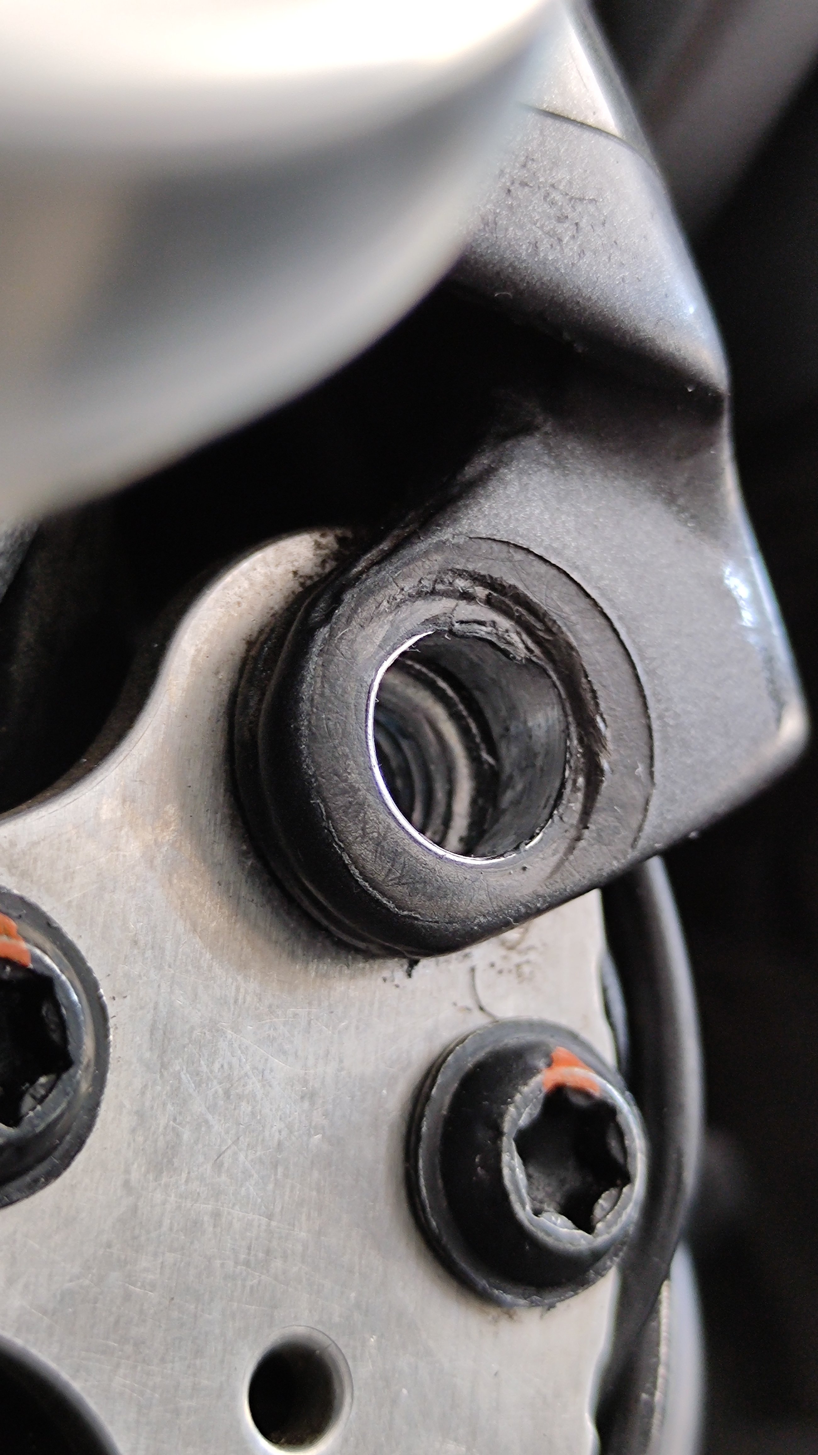

I took one of these bolts out today to check the mount.
Note that other than the factory fitment these bolts have always been tightened to 12nm. You can see how the carbon is deforming under the bolt head.
There is a metal insert bonded to the mount hole, but it's very thin.
Time will tell I suppose. I'm going to continue to ride as I am, mostly bike parks and keep on top of maintenance.
I'd urge anyone with the Cube stereo hybrid 160/140 to regularly check these bolts aren't coming loose.
I'd still be interested to see how other manufacturers are mounting the Bosch cx motor as I'm sure I've seen trek using a very similar set up.

You've highlighted the problem perfectly. Tiny amount of CF to hold the metal insert. 12nm seemingly a low value to grip a high stress area yet any higher torque and it'll crush what little CF there is.
It's a proper design flaw on a bike with 170/160 suspension for gnarly downhill riding yet built for canal paths.

The issue is that at the bb the frame designer is using lugs which not only have enable sufficient bolt torque but also the other forces created by the cranks.......and forces inflicted if the bash guard is hit.
In my opinion the proper way to deal with that would be to fix a metal framework to the carbon frame with probably 3 fixing points each side.....and then bolt that framework to the motor.

So are Cube completely oblivious or are failures only starting to show now? I believe this mount design has been around since 2018 and is also continued on the new Cube 155.
Mike makes a good point, could these failures also be caused by heavy hits to the underside of the motor, also seems likely.
What Mike describes is exactly what someone did who's frame suffered a failure. They fixed a metal bracket to the back of the frame that wrapped round the sides of the motor.

When my cube 160 started making noises at bottom bracket and I went to undo the bolts (+- 1 year of use), the precision torque meter showed 8nm - 12nm , after torquing back to 20 nm no more noises for another 1 year.
So, I'd say that 11 nm is not enough and maybe will let some play that in the end will wear the fixing points like the picture above of hattori's bike.
And here we are back full circle to 20nm, backed up with an email from Cube as @MrPeaski shows.
So 11 or 20, who knows 🤷‍♂️
Think I'll go 15nm with quality thread lock 😆
I suspect Cube will try to brush this under the carpet if it is a genuine frame issue, imagine the recall cost for all stereo hybrids sold since 2020!
And a fix won't be easy.
