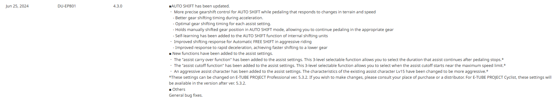

Also on the DU-EP801 you can use the new (and great) "race mode" in LV15 which was delivered with the latest motor firmware version 4.3.0, see here:
