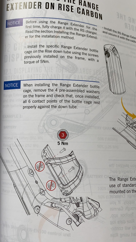

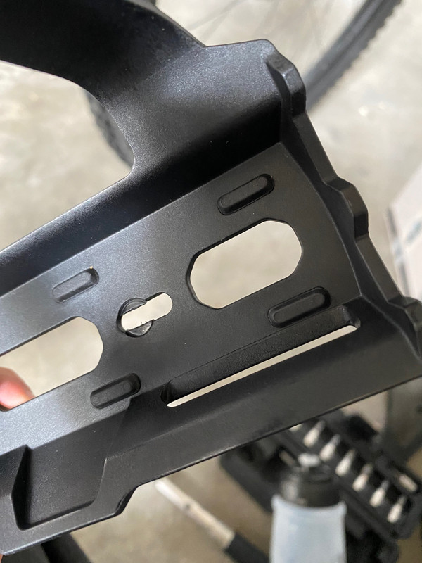

I have just received my orbea rise range extender and while installing I noticed the manual says to use 5nm of torque for the bolts.

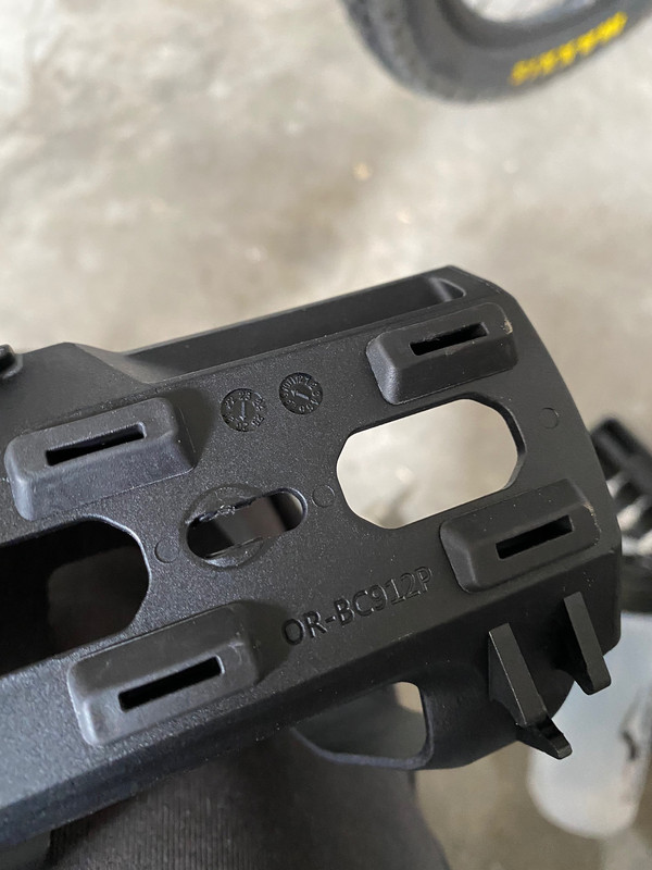

I tried that without noticing the battery support is all plastic and has no metal inserts or reinforcements. Before reaching the 5nm I noticed the screw had already deformed the plastic and made its way into the support.
I have already contacted orbea and LBS and I am waiting for a response, but NEVER install the extender support with more than 1NM!!! (use just your hand until it is hard, just the way you would do with a normal bottle support).
The part is cheap and can be easily replaced but this is very dangerous, I just hope I have not damaged the frame nor the original inserts.

generally with a plastic part like that I add a shakeproof washer that will dig into the plastic and stop the screw from loosening due to vibration, surprised they didn't supply them.
That is more or less how I have ended, with half of the screw head digged intro the plastic. One this is for sure, it won't get loose easily xD

2NM I have used but I should have used 1NM or less.

Yeah! I Think a small mark on the plastic should be ok but mine was too deep. Anyway I am only worried about the frame suffering from this torque but the plastic got the mark very easy so I really doubt it got any stress.
now it is really tight and is usable 100% but the support got deformed and I like it to be in good condition! I really expect a free replacement from orbea next week. will let you know if this happens.
just tigthen by hand a little tighter you would do for a bottle support.

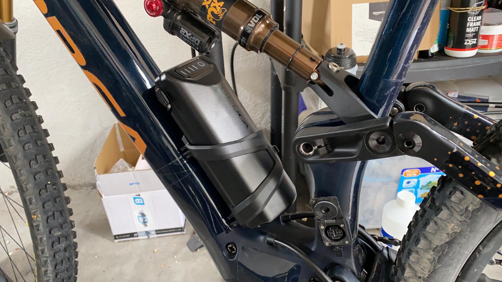

It is a great addon, small and very well constructed. It is lightweight, however you will notice it specially while climbing.
I like the fact that you connect it and you don't need to switch it on individually, it will be used as you switch on your bike.
You won't be able to charge both batteries at the same time, you will need two chargers for that :(

Can you post a pic of it connected up please?

Orbea answered my email saying that 5NM is the correct torque... unbelievable. They also attached a picture of the extender using washers while the original manual did not.
They did not even offer a replacement. However my LBS offered a free replacement.
I wish people will not use 5NM of they will damage more supports or even frames :(

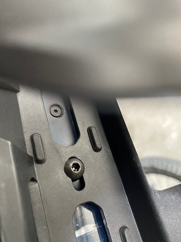

Now I wish I'd read this thread before. I'm still in the process of stripping and rebuilding our two bikes (replacing rear brake means motor and battery out). Now I'd not worry about cracking the frame - theres a solid mount on the other side of the carbon tube that you're screwing into which should spread the load. However, as you point out the Range Extender manual specifically says 'don't use washers' whereas the shop had supplied mine with one washer fitted.
First go, with the washers in and torque wrench set to 4nm one of the bolt heads snapped clean off - I mean, I know they're trying to keep the weight of the bike down but using aluminium bolts is a step too far (expecisallly for something like a bottle cage that actually gets subjected to pretty heavy loads).
I've replaced with steel bolts, but took the washers out and even at 4nm it has heavily bitten into the plastic.
It's lovely that Orbea provide such good instructions but no damn use if they're littered with errors.
I reckon definitely replace the ally bolts (they say to only use their bolts but its the length that's important - the battery is behind this) with steel. And use a washer. will take mine off again tomorrow and survey the damage.

it's a lovely thing and the cage is well engineered. Just needs proper bolts (the thing weighs 1.5kg, the 2g saving on bolts isn't going to kill you) and instructions.
Bolts are 5mm diameter (m5) and 10mm threaded length - a pretty standard bottle cage bolt which is why I guess I had some in my 'box of unused bolts'

Aluminum M5 bolts? Jeeze that's pretty ridiculous. Motor bolts are also aluminum, they've started deforming with only one removal. Hopefully I won't need another!
I also don't at all understand the obsession with specifying no washers? That seems like a really strange pedantic detail to focus on and document in the manual. Why would it cause any harm to use washers on a plastic part? Are they worried about the aluminum bolt galling with a washer? Or maybe they're worried about adequate thread insertion (just use a longer bolt?!)?
