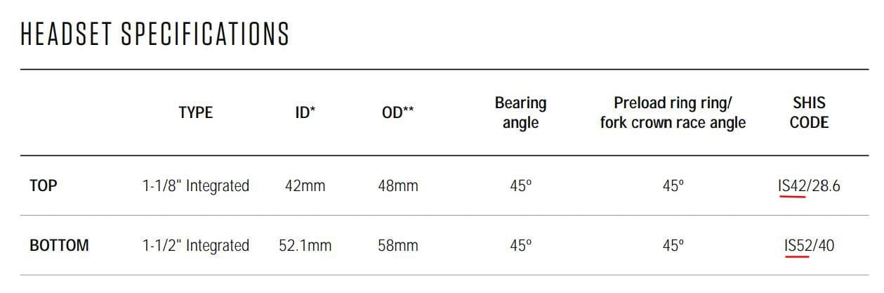

Hello, i have 2 issues with my rise. I need to swap my upper head bearing, how can i know exacly what model is and where can i buy one ?

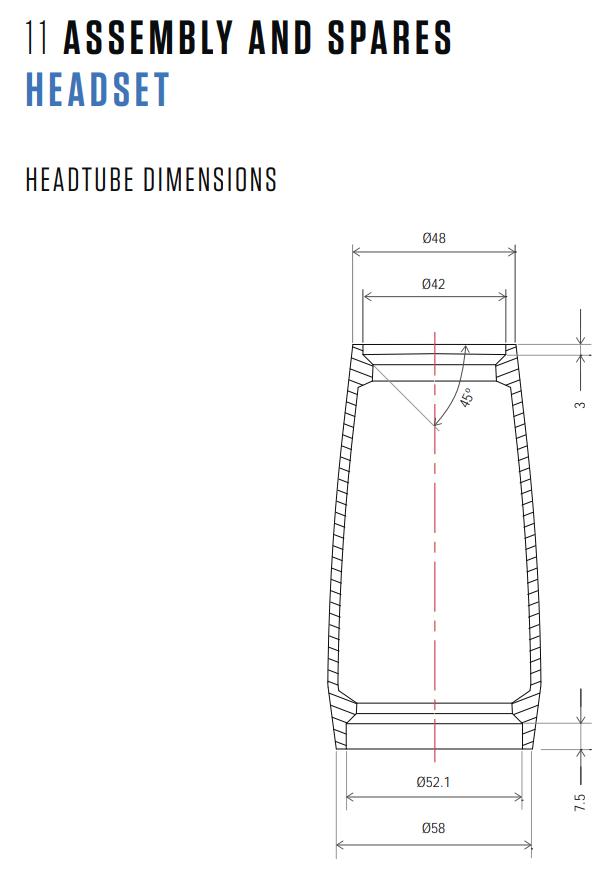

1) The Carbon Rise M10 shares the same headset bearings as the Rise LTD, M20, etc. I've attached below a screen capture of the Rise Blue paper detailing the headset and bearings. Your Rise M10 takes an IS42/28.6 upper headset bearing and a IS52/40 lower headset bearing.

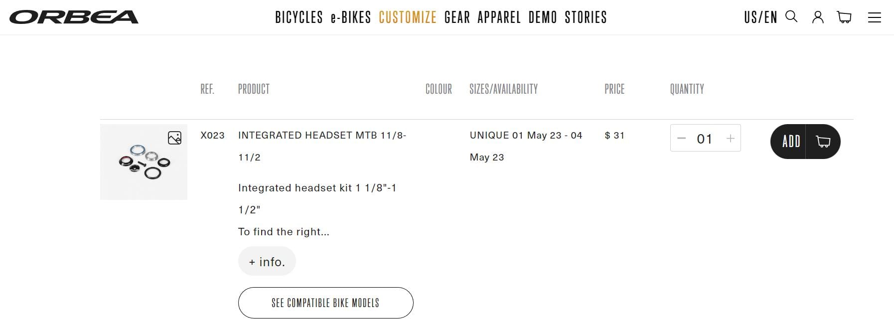

2) In regards to sourcing headset bearings. The least costly way to replace the headset bearings would be to order a headset bearing kit directly from Orbea.
Visit your regional Orbea website, click on "Gear", located on the top header and then when it opens, click on "Spare Parts." You can search for parts by either bike model or by entering your frame serial number. Your bike's serial number bar code is located on down tube, near the top. I've attached screen shots from Orbea's website showing the correct headset for your Rise.

Note: The Rise uses a headset manufactured by "Acros." Any headset bearing of the correct size will work as a replacement for a worn Acros headset bearing. To know which bearing to buy, you first need to understand that the fork on your Rise uses a tapered steering tube. Therefore, the inside diameter of the upper headset bearing is smaller than the inside diameter of the lower headset bearing. This is because the lower bearing must fit around the thickest part of the tapered steering tube. If you wished to buy an upper headset bearing for your Rise, you would look for an IS42 bearing (42mm outer diameter) with a 28.6mm inside diameter. If you wished to source a lower headset bearing, you would look for a IS52 (52.1mm outer diameter) bearing with a 40mm inside diameter.
