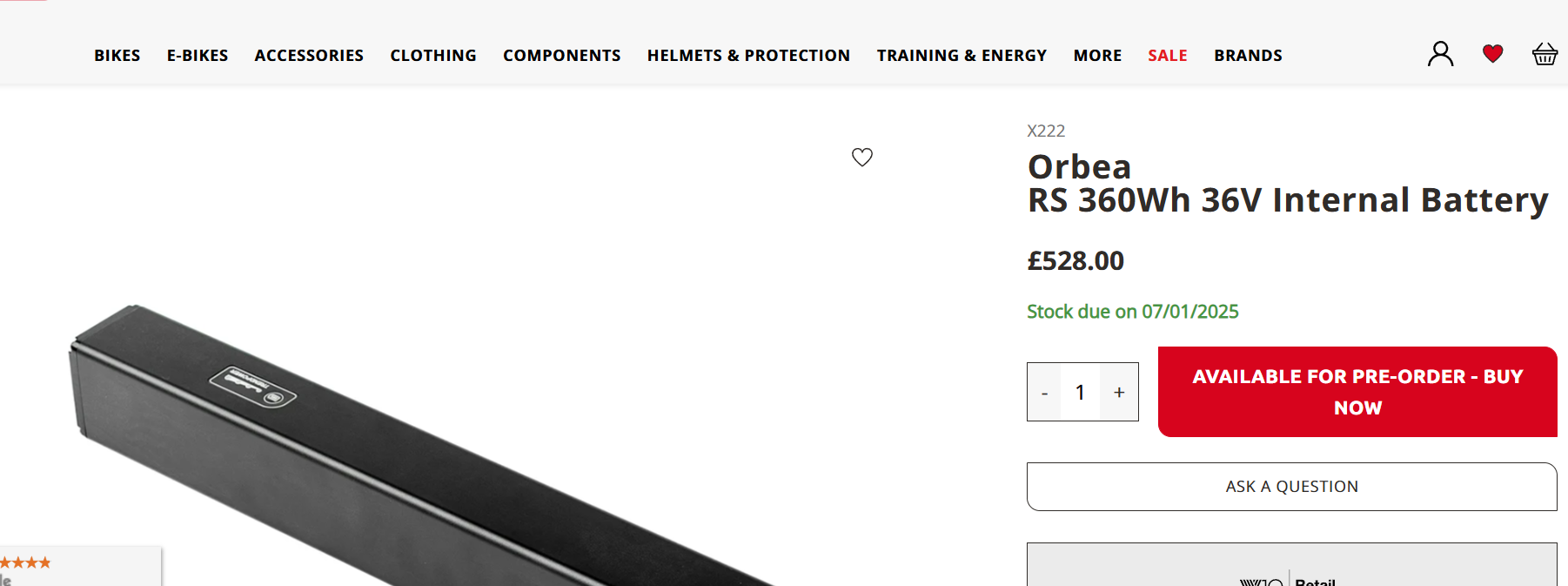

We’ve ordered the same from the same shop. Still expensive though!
Yep, I was quoted £450 nine months ago and now they are £528
