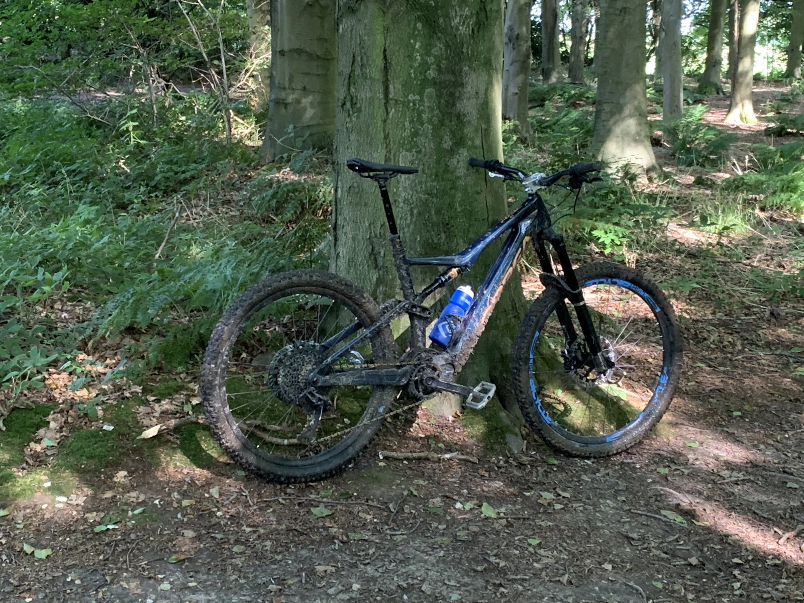

That woukd have been funny ... but alas no. I've had mine since new in November 2019. Having said that I'd be more inclined to make changes to the Wild FS than the Rise. I don't want them to be too similar ... a degree on the Wild and maybe the mullet set up as shown on here previously on both bikes. I am vertically challenged and my 5' 7" frame and legs has me receiving unwelcome contact with my rear tyre on occasion.
Either a mullet set up or 2 inch heel lifts. ?

I can relate. Same size here. Ill run full 9er on my enduro bike whrn im at the xc area. Everywhere else im mullet. Decoy is amways millet

Trying out the Mullet setup in local woods
