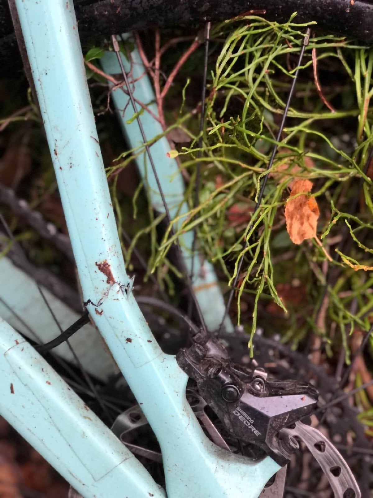

the chain stay on my friends orbea rise 2021 broke today when he was out cycling. He's had the bike for about 1 month and have ride it only on trails so no dh or enduro.
orbea has a lifetime warranty on their frames, but they could deny the warranty and then claim that he himself has caused the damage.
so what do you think? will orbea receive the guarantee

If the bike has been used as you suggest, it should be backed up by the condition of other parts of the bike

if its been ridden as youve said he wont have an issue, theyll likely ask it to be taken to a dealer for insection though, besides, after one month, you could probably claim some sort of consumer rights on it not been fit for purpose if they denied? but i doubt they will, my friend who works with orbea who got me my bike assured me theyre good with their warranty process so im sure he will be ok :)

He bought it from a store online and get it sent to him , but maybe he need to pack the bike and sent it back for inspektion.

I have yet to see a brand whose bicycles didn't crack at that spot, cracking next to brake mount is common enough among four-bar chainstays, to a point that some brands routinely switch between carbon and alloy stays within same year model (like Canyon Strive & Spectral) when that starts to happen too often.
It's also why some brands advice against larger discs in rear (200/220) for their trail models.
Though I find it interesting this is still a place where manufacturers try to save some weight, but I would absolutely not accuse Orbea of poor frame QC. And to be honest, our LevoSL has also pretty subtle chainstay, at least, visually slightly unnerving me.

I know alloy can snap too, but surely it is much less common event?
I don't think it's that clear-cut :- ). I think when it comes to stays, Alloy probably do snap less, but manufacturers may use them on otherwise carbon bikes rather for cheaper and easier warranty work.
With Canyon (Most of my bikes were Canyon and YT so I know most about these), it was pure-carbon Strive 2016-2017 which had cracking carbon seat-stays, but then in 2018 it was again alloy stays of Spectral that was cracking a lot for full first year. Strive was probably design issue as it was never fixed but wasn't too common (my survived everything and I'm heavy, but not heavy rear braker heh!) but they fixed the alloy stays of Spectral where it was claimed to be QC (adding more material to alloy is much easier than redesigning molds needed for composite).
Ultimately, there are even some cracked Transition bikes, and those used to be damn heavy in both alloy and carbon versions so maybe adding material isn't such a solution either. Now their latest super-enduro Spire is quite light-weight though.
I think all frames crack at least within the industry 2perc. margin, it's expected. We just hear more about the more affordable bikes because they are more common, and because they are mostly internet brands, people come to complain to forums first instead of (non-existing dealer), and it can heavily skew the perception.

The positive I see is that it’s the rear triangle vs the front. Much cheaper and easier to swap out, so hopefully Orbea takes care of you.

getting back to the original post, orbea are very good with warranty claims when they are legitimate, but be aware they WILL know if the failure is caused by crash damage/impact they have facilities for NDT analysis of the part.I know from trying to warranty a broken chainstay which happened to a customer in a crash at an enduro race. customer was fine with buying a new one but i tried to warranty it never the less.A week after sending the chainstay we received an email with full details of the testing even going as far as suggesting almost exactly the type of impact that caused the breakage. fortunately the owner of the bike was an engineer in the military and was familiar with the methods they used and was happy to pay the 150 euros for a new carbon chainstay.
If the break was a genuine failure they will sort it out 100% if its crash damage they will offer a crash replacement at a nominal cost.

If what you say is true, then Orbea will honour the warranty, but as for now, they won’t approve the warranty despite the pictures I sent them clearly show that the crack comes from inside the carbon and no force has come from outside. So I have to remove the back triangle and sent it to my dealer, who then send it to Orbea for further inspection.
So soon we know if Orbea is a serious company who takes responsibility for their products failure, or try to cheat the customer. I know how carefully I have been riding the 8 weeks I’ve had the Rise, and haven’t crashed a single time. It’s pretty obvious that it must be a production failure if some kind.

How on earth can you claim a picture " clearly shows its from the inside out" I always find it suspect when someone immediately goes to the internet for support rather than just getting it sorted at the dealer. if its legit it will be sorted if its crasg damage you will be offered a crash replacement, simple .
no amount of whining will change the outcome.

Simple, if there would be outside force, it would show. At least the people I’ve spoken to said it’s clear that the carbon broke from within. And since I know what happened I’m pretty annoyed being questioned by a company that on paper have good warranty. My dealer said that most brand would only need pictures for such obvious warranty claims. And as long as someone accuse me of not being truthful, I have my full rights to whine.

However I find Endurips posts to be a little entitled. To expect a manufacturer to send out a warranty triangle on the basis of some photos and the owners own feelings is not how it works. Not unless you have an exceptionally nice vendor who replaces the part purely as a gesture of goodwill and to get the owner off their backs.
To have the faulty part returned for testing is 'normal'. Yes I would be pissed too, but it is what it is. I wouldn't take it as Orbea suggesting that Endurip wasn't being truthful, but I would appreciate and understand that there are (unfortunately) processes to follow.

Unless you dealer has an FEA machine to hand they will no idea what caused the failure. like i have said if its a manufacturing defect you have nothing to worry about if it was impact orbea WILL know.
