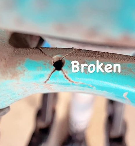

Just a heads up for owners of the early editions of the Rise H series models to keep an eye on the bridge that ties the chainstays together. Myself and two friends all purchased H30's when they were released and all three of us have had the same failure, a crack at one of the weep holes. Orbea is addressing the issue though not even handedly, one buddy received a new frame ( no motor ) while the other two of us are being sent new rear triangles. Turn the bike over and remove the rear tire to inspect, I suspect they are going to see a lot of these.
That is ugly!

What frame color received a new frame, and which colors received new rear triangle?
First guy in my crew with a blue and grey frame received a new frame. Seocnd guy with the same frame and myself with an orange and black frame received just a rear triangle. No explanation from Orbea as to the unequal treatment.
I've got the grey metallic stock H, so Hopefully I'll get a new frame...I'd take a Mulberry LOL
